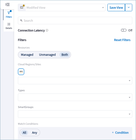

In Cloud Fabric > Topology > Overview, you can filter the resources that display for Network View.
image of filters pane
Filters allow you to narrow your focus to only the resources you want to see. You can then save the selected filters as a View. See Create a Topology View for details.
You can filter the topology map by using search and by selecting managed and unmanaged resources, CSP vendor and region, associated properties and tags, and conditions.
You can use the Search tool to filter the Topology map by name, ID, type, etc. using letters, numbers, or characters.
You can configure the following filter criteria:
Filter Description
Resources
  • Managed: shows VPCs/VNets and related resources that are managed by Aviatrix.
    Managed VPCs and VNets have been onboarded to the Aviatrix Platform and contain Aviatrix resources.
  • Unmanaged: shows unmanaged VPCs/VNets and related resources.
    Unmanaged VPCs and VNets have not been onboarded and therefore do not contain any Aviatrix resources.
  • Both: shows both of the above
Cloud Regions/Sites
Select one or more cloud providers: AWS or Azure
Select a region or regions that correspond with the selected cloud providers.
Types
Spoke VPC/VNet, Subnet, Virtual Machine (VM), Gateway VM
SmartGroups
Select a previously created SmartGroup. You can enter multiple values for SmartGroups.
You can also filter by condition. When you select + Condition, you must select the following:
  1. Condition type
  2. Qualifier
  3. Value
image of the condition fields
From the Condition Type field, you can choose a Properties or Cloud Tags condition type. These same properties are displayed on the Details pane when you select a resource in the map. For information about the properties you can filter on, see Topology Resource Property Reference.
After you choose a condition type, two more fields display. You then select an operator to associate with the condition type, and enter or select a value in the third field.
If the operator requires text input for the value, you must press Enter to generate the map output.
You can add up to ten filter conditions.
Condition Type Operator
Properties
The most common qualifiers are: contains, does not contain, equals, does not equal, starts with, does not start with, ends with, does not end with
Cloud Tags
Depending on the operator selected, different types of values can be selected. Some of the available options include the following:
  • Select or enter multiple values
  • Select true/false
  • Select a greater than/less than or equals/does not equal value
  • Select a contains/does not contain or starts with/ends with
  • Enter a time value (License Expiry, Launch Time)

You can apply any number of filters to search for resources in the map. You can also use the icons below the map to expand or collapse all VPCs and VNets.
If you do not see resources you expect to see represented in the map, expand the VPCs/VNets and check the filter settings.
If you click any badge in the Topology map that has grouped entities, hyperlinks for each entity display in the details panel. You can click the hyperlinks to display details for an entity.
