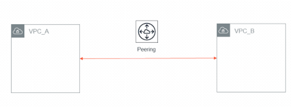

You can peer two VPCs together.

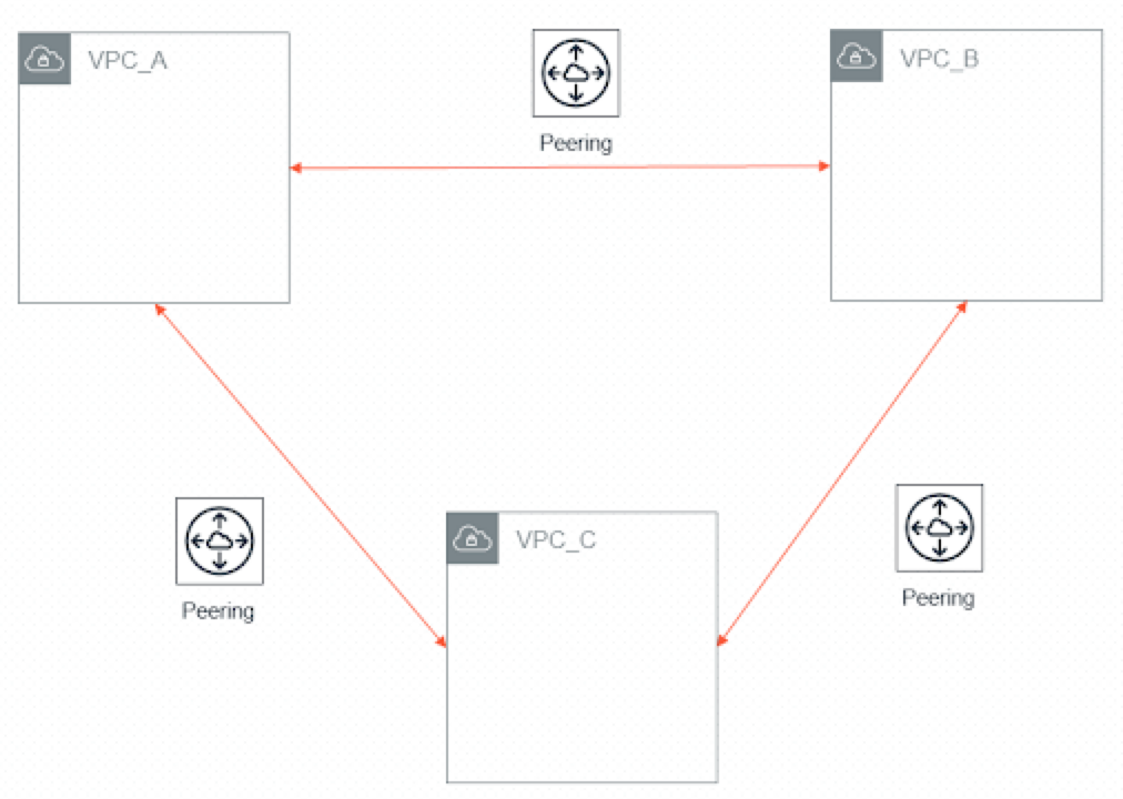

You can peer three VPCs together, where each VPC will have access to the resources from the other two VPCs because of its peering connections.

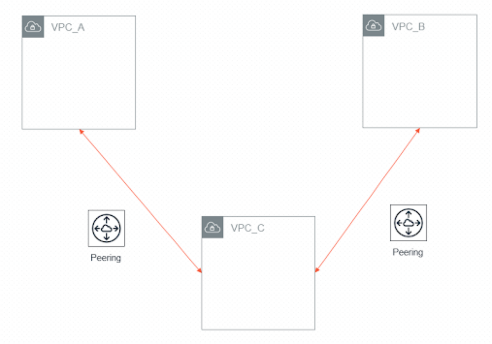

You can peer three VPCs together where one is in the middle, meaning that the middle VPC will have access to the resources from the other two VPCs, but the other two VPCs will not have access to each other.
