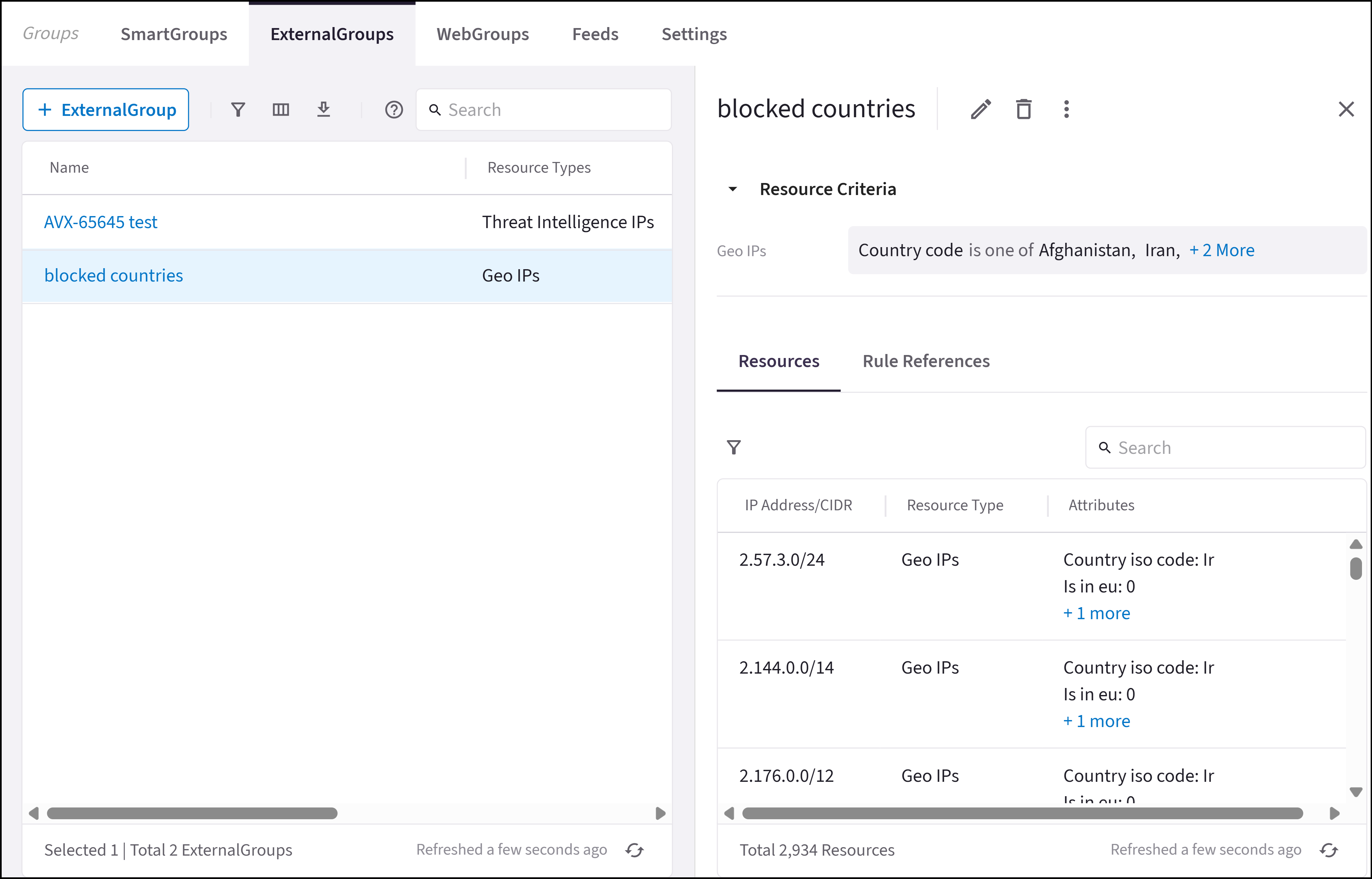

Viewing External Groups Details
On the Groups > ExternalGroups tab, click the name of an external group to view its resource criteria on the right-hand pane.
externalgroups detail
