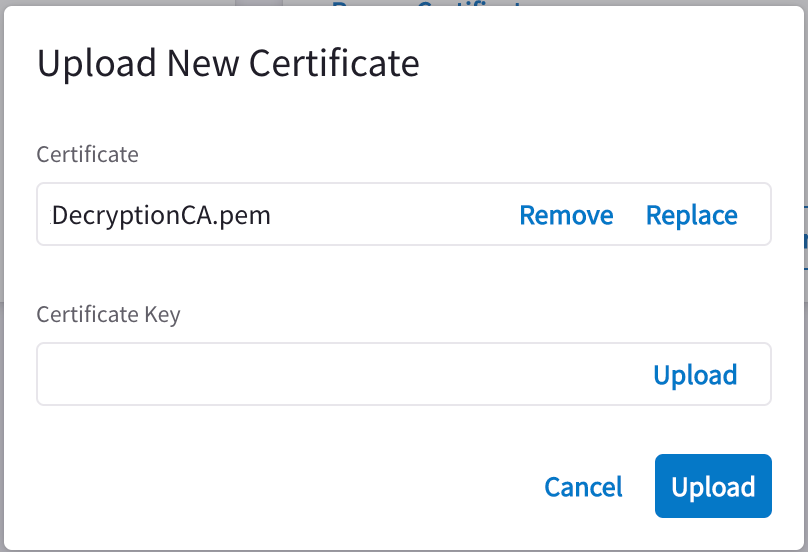

Uploading Your Own Certificate
It is best to upload your own certificate (must be in .pem format), since you likely have this certificate in use throughout your environment. You can remove the default Aviatrix CA certificate first, if desired.
On the Settings tab, on the Decryption CA Certificate card, click the arrow next to Download Certificate and click Upload New Certificate.
In the Upload New Certificate dialog, you can upload, remove or replace a certificate and its corresponding certificate key.
Both fields must be populated. Click Upload.

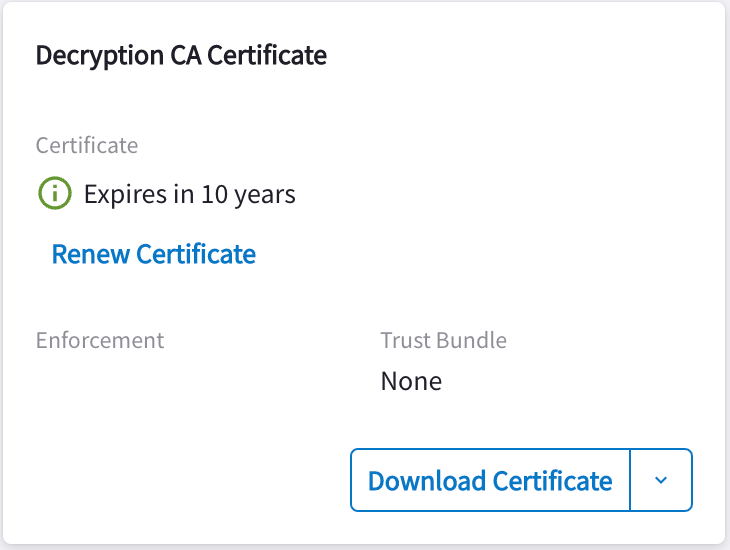

Renewing Your Certificate
You must renew your Aviatrix CA certificate when it is about to expire.
When you click Renew Certificate, the certificate renews automatically.
You can also upload your own CA certificate.

Editing Enforcement
Use the Enforcement option to determine how Distributed Cloud Firewall handles origin certificates that are not signed by a trusted Certificate Authority.
Aviatrix strongly recommends changing the enforcement level to Strict. |
To edit the enforcement level:
On the Settings tab, on the Decryption CA Certificate card, click the arrow next to Download Certificate and click Edit Enforcement.
In the Edit Enforcement dialog, select an Enforcement level:
Strict: terminate connection for incorrect signatures
Permissive: generate a syslog message if the certificate is not signed by a CA, but continue with the connection
Ignore: certificate signatures are not checked
