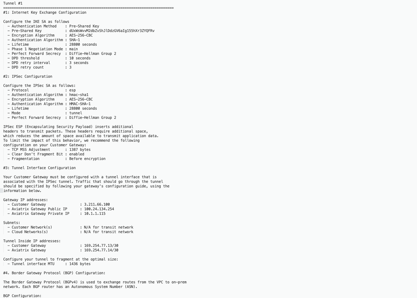

  3. To connect the Transit VPC gateway to Juniper SRX, navigate to Networking > Connectivity > External Connections (S2C) and follow these instructions.
  4. Download the configuration.
  5. Ensure that your JuniperSRX is configured based on the information in the downloaded file. The following is a sample configuration based on the Site2Cloud configuration above. Juniper SRX sample configuration
The tunnel IP addresses are configured accordingly with information from the downloaded configuration file.
