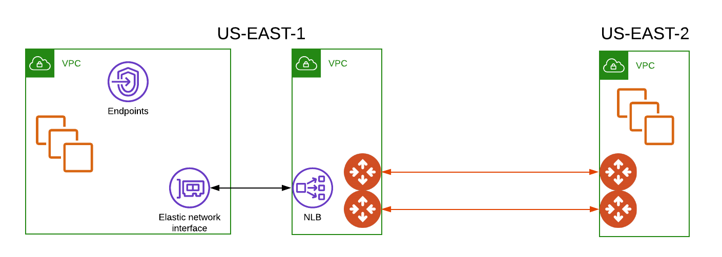

VPC Endpoints in AWS allow you to expose services to customers and partners over AWS PrivateLink. In situations where allowing resources to be accessed directly from the Internet is undesirable, VPC Endpoints can enable internal VPC connectivity to resources in other accounts. One limitation of Endpoints is that it is a regional construct, meaning you can’t use it to provide connectivity to resources across regions. In some cases it’s not possible to move these workloads. This is where Aviatrix can help overcome that limitation. The end design will look similar to the diagram below. VPC Endpoints Diagram
Environment Requirements
In this example there are:
  • Two VPCs in US-East-1. One customer/partner VPC (10.10.10.0/24) with an Endpoint, and our VPC (10.10.11.0/24) with an Endpoint Service tied to an internal Load Balancer.
  • One VPC (10.10.12.0/24) in US-East-2 that hosts our workload.
  • A set of Aviatrix Gateways: two in Aviatrix VPC in US-East-1, and two in the workload VPC in US-East-2. Deploying a set of HA Gateways is documented here.
Once deployed, a set of Site2Cloud tunnels will be built. Documentation for building a tunnel between Aviatrix Gateways is here. They should be built in an active-passive manner to avoid asymmetric routing in AWS.

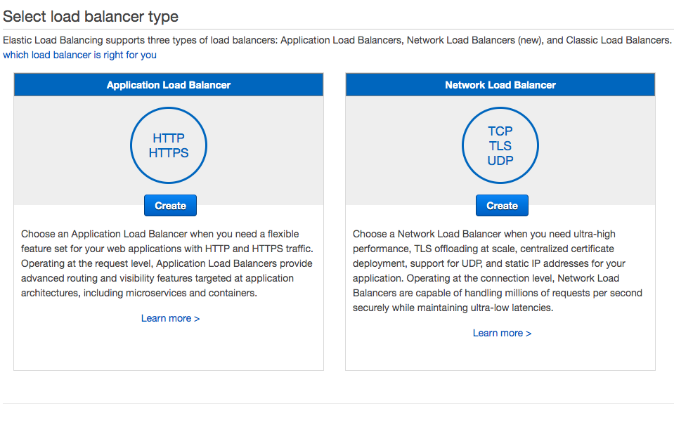

  1. From the EC2 section in the AWS console, choose Load Balancers.

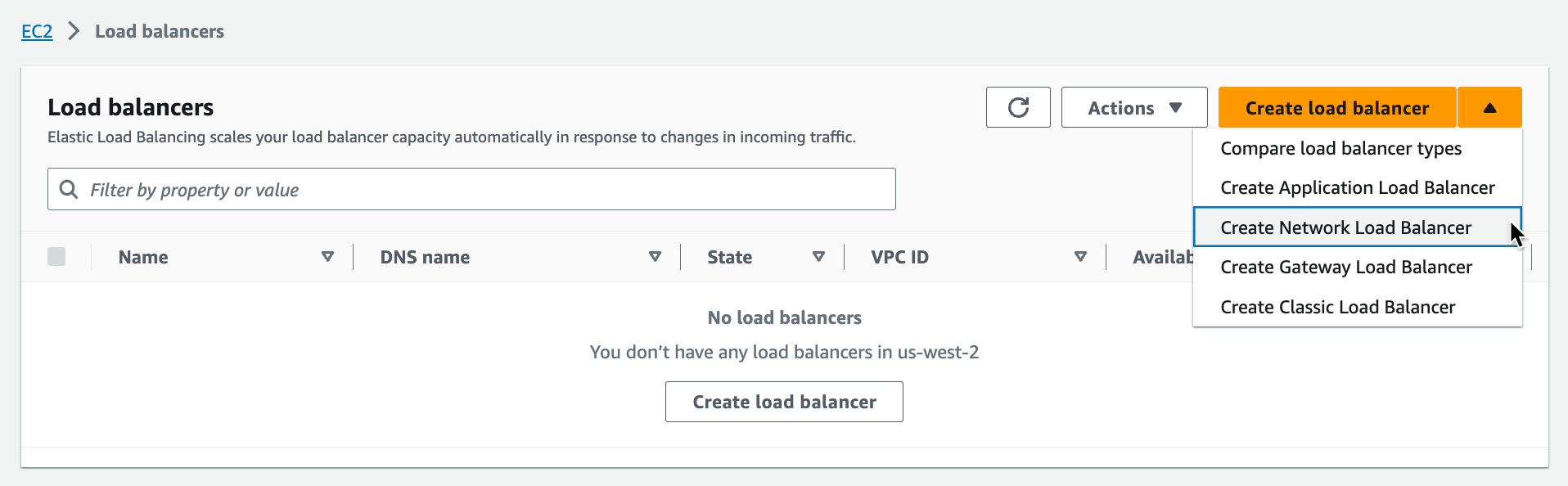

  2. Click Create Network Load Balancer. Create Load Balancer Select Balancer

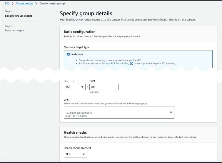

  8. Also in this area, create a new target group using port 80 (this opens a new tab in your browser). The target type is ‘instance’. Health Checks will be TCP-based. Config Routing

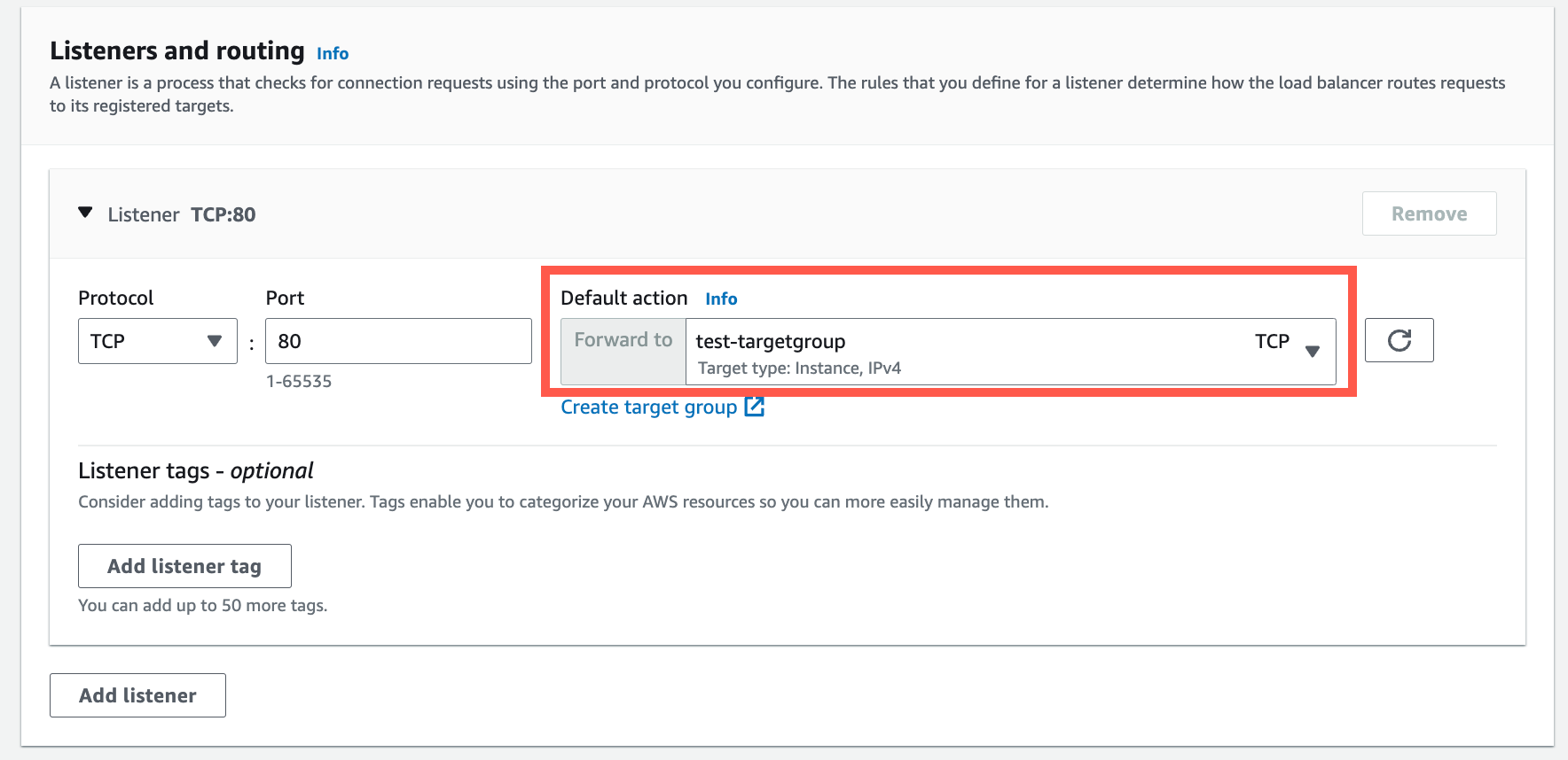

  11. Go back to the Load Balancer creation browser tab. In the Listeners and routing area, select the target group you created above. AWS Add Target Group

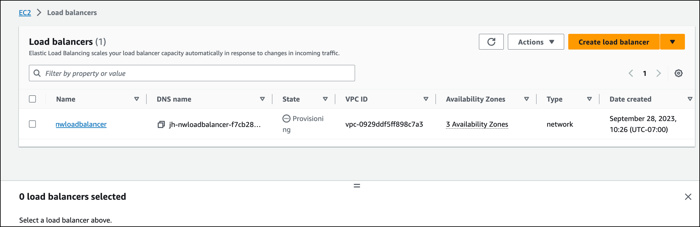

  12. Click Create load balancer. On the next tab you can view your load balancer. NLB Created

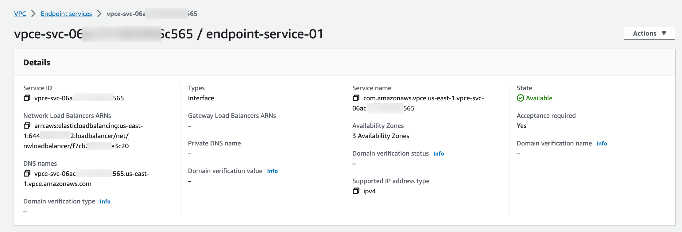

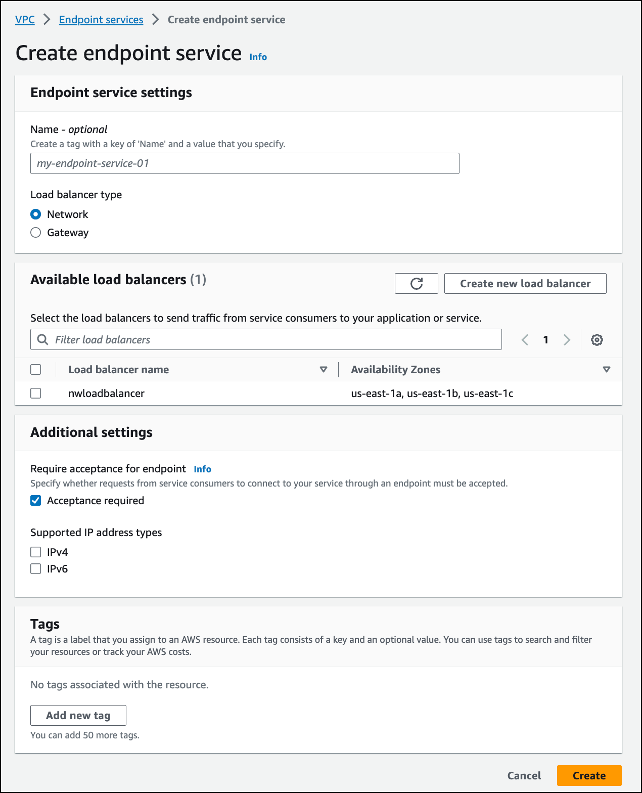

Attach an Endpoint Service to Load Balancer
  1. From the VPC dashboard area of the AWS console, click Endpoint Services.
  2. Click Create endpoint service. The new Load Balancer will be in the list as an available Network Load Balancer. Create Endpoint
  3. Enter a name for the endpoint.
  4. Ensure that the Network Load balancer type is selected.
  5. Under Available load balancers, select the load balancer you created.
  6. Under Additional settings, select the Acceptance required checkbox.
  7. Ensure that the IPv4 supported IP address type is selected.
  8. Click Create.
The Service ARN will be what our customer uses to register a service in their VPC. Endpoint Service

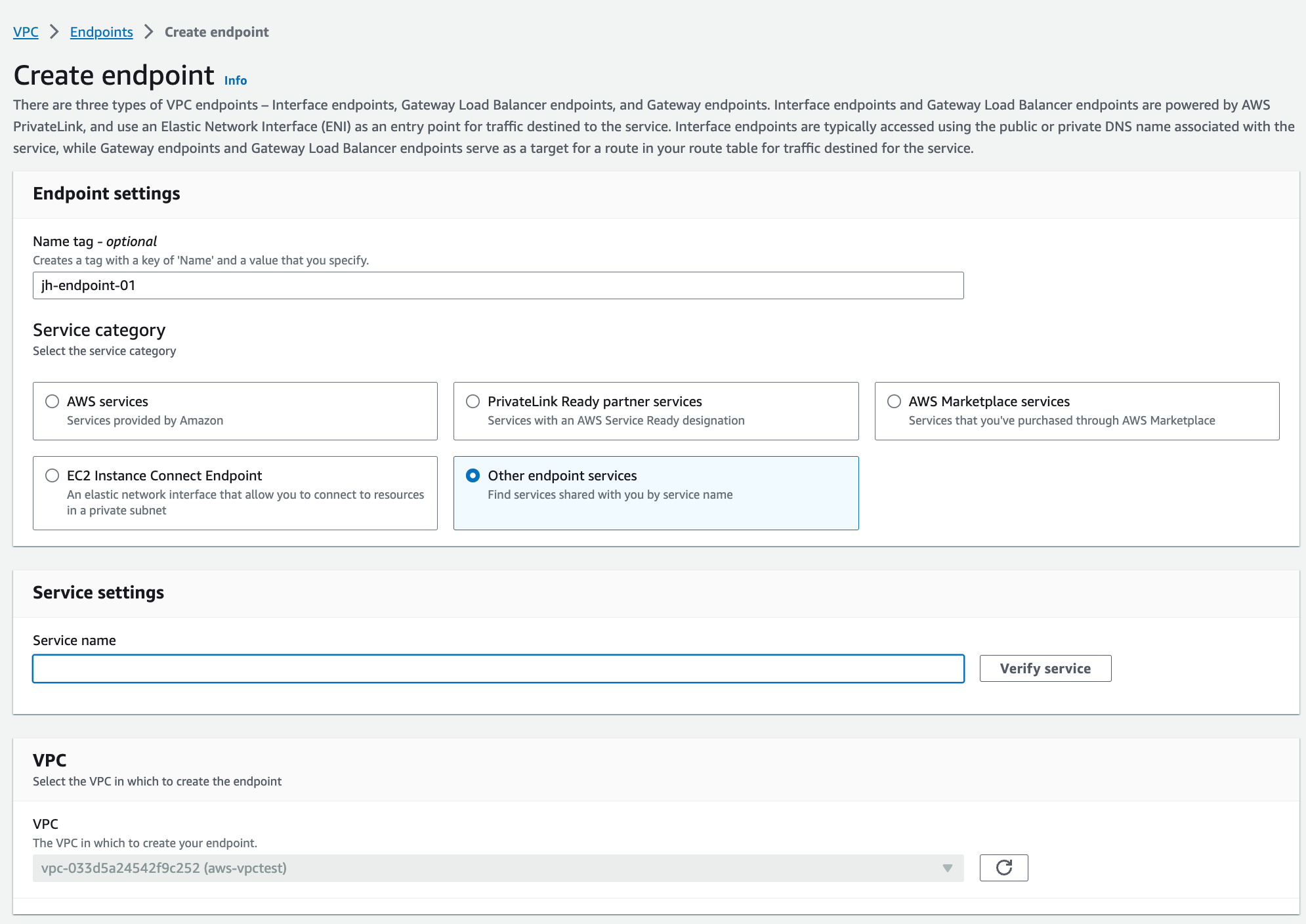

  1. In the VPC area of the AWS console, create a new Endpoint.
  2. Enter the ARN from the last step, and select the Customer VPC to expose an endpoint in. Once built, the Endpoint DNS names can be used to route traffic. Endpoint VPC
