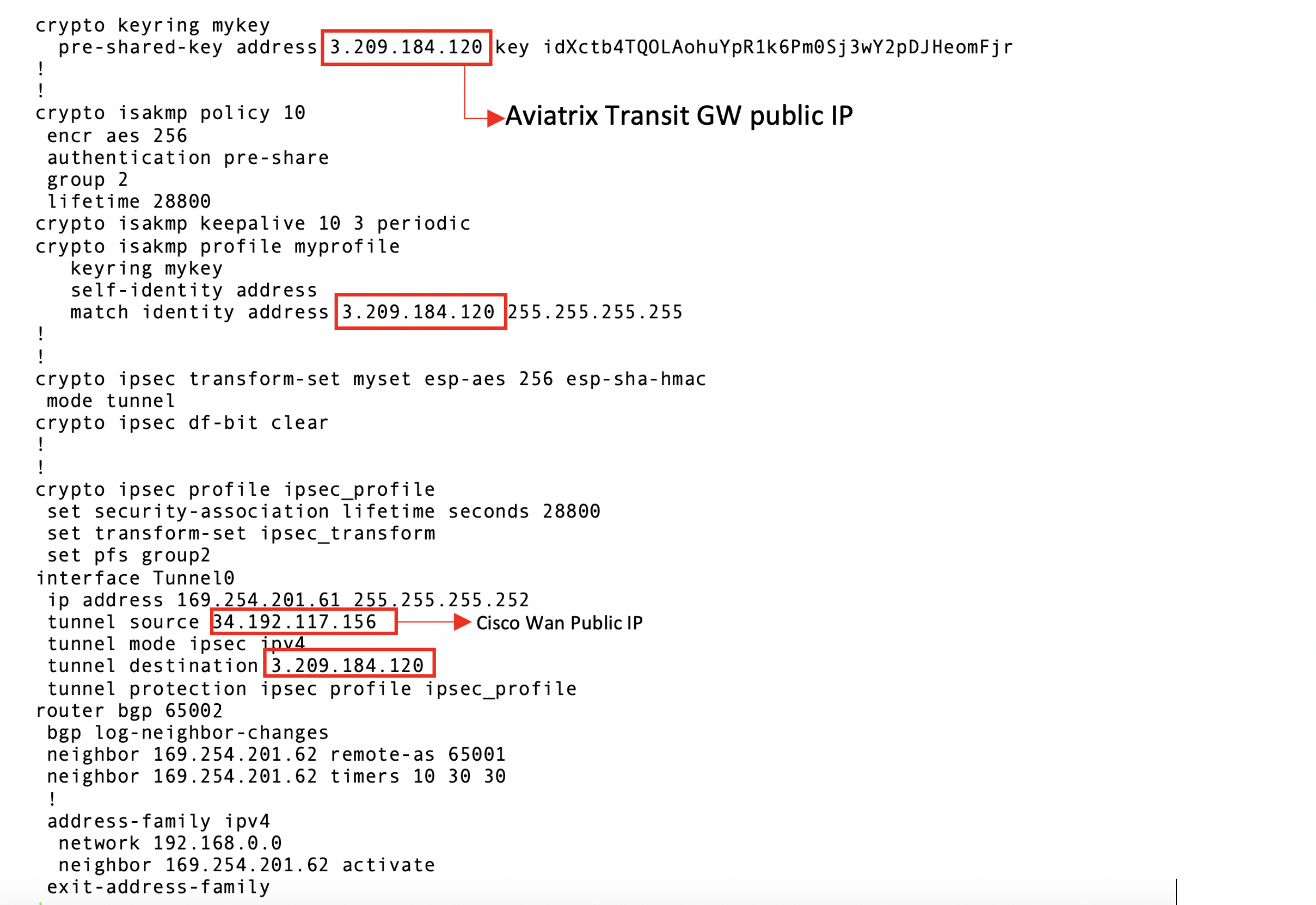

  4. Download the configuration.
  5. Ensure that your Cisco Router is configured based on the information in the downloaded file. The following is a sample configuration based on the Site2Cloud configuration above.
Cisco Router Configuration Sample
The tunnel IP addresses are configured accordingly with the configuration file downloaded above.
