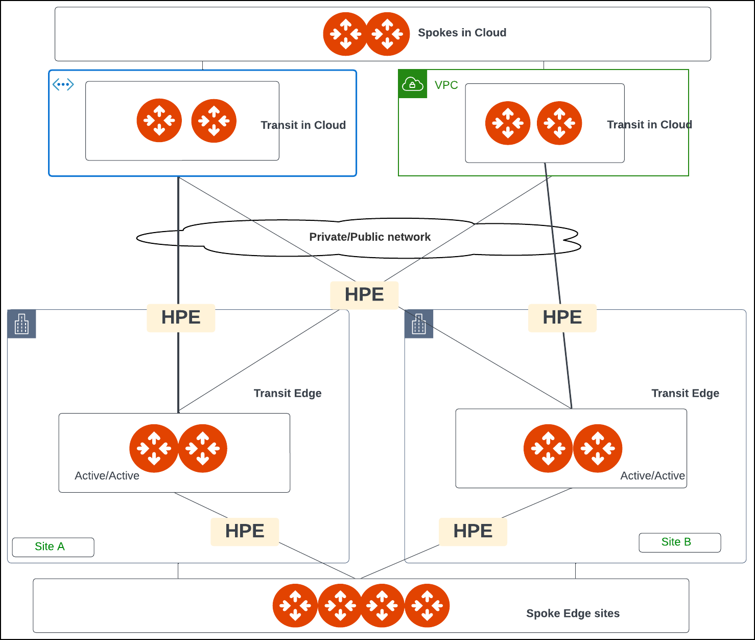

Topology
The following diagram shows an example of network connectivity for Edge Transit Gateway to Transit Gateways in the cloud and Edge Spoke Gateways at remote sites. Network connectivity topology for Edge Transit Gateway
