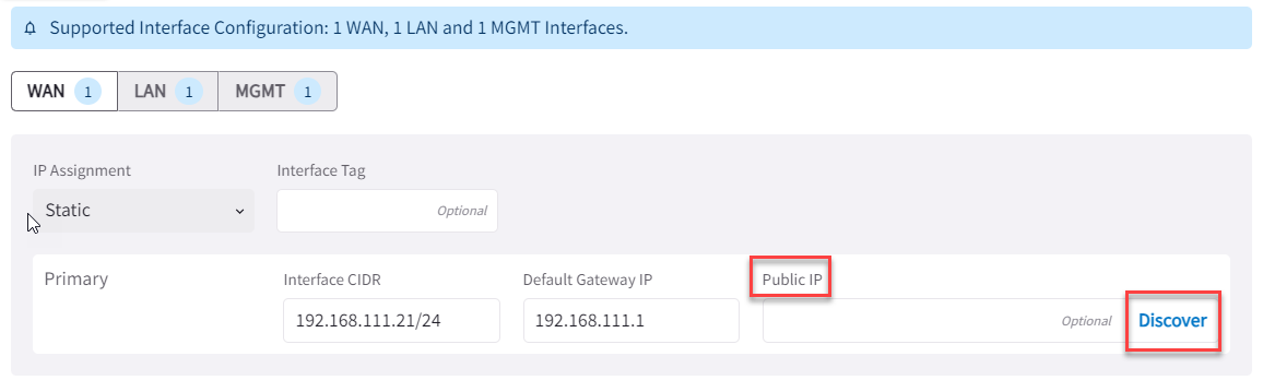

If the Edge to Transit Gateway attachment is over public network, you need to update the WAN Public IP on the Edge Gateway.
- Go to Cloud Fabric > Hybrid Cloud > Edge Gateways tab.
- Click Spoke Gateways.
- Locate the Edge Gateway, and click its Edit icon on the right.
- In Edit Edge Gateway, go to Interface Configuration and click WAN.
- In Public IP, click Discover.
- Verify the WAN Public IP and click Save.
