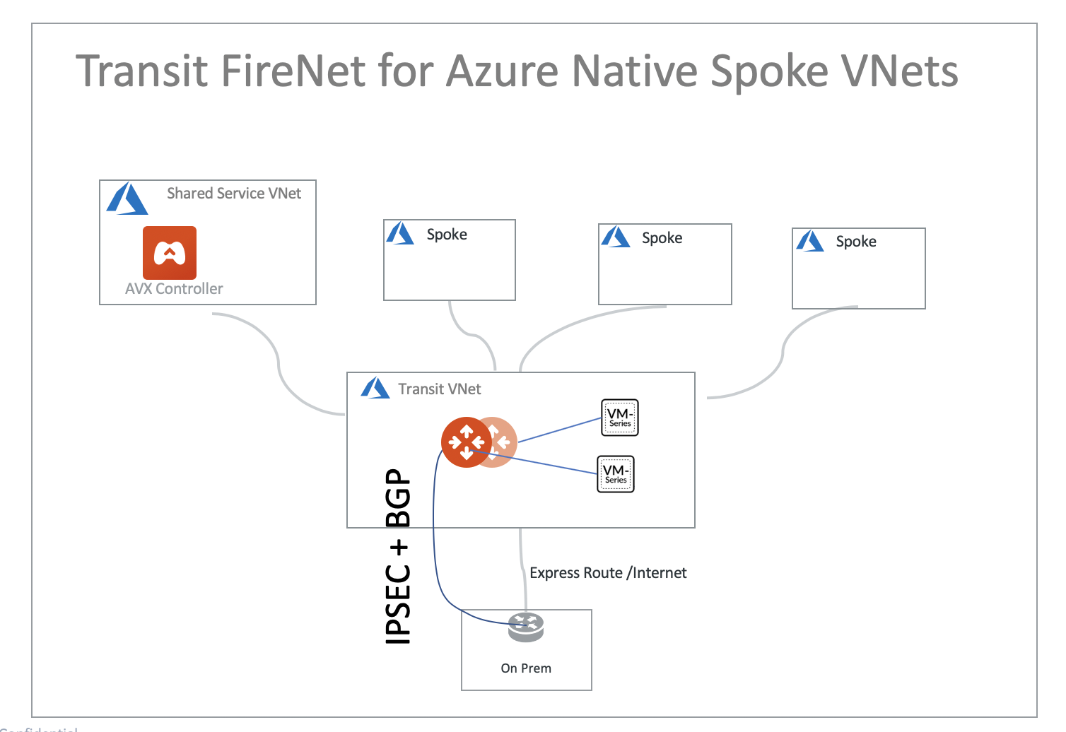

This document illustrates a simple architecture for Ingress traffic inspection firewall that leverages Azure Load Balancers, Transit FireNet, and Azure Transit with Native Spoke VNets. The solution also allows you to view the client IP address. The deployment is shown in the below diagram. Azure Ingress Firewall Setup Diagram The key idea is that from a FireNet point of view, the ingress inspection is simply a VNet-to-VNet traffic inspection. This is accomplished by:
  1. Placing an Internet facing Azure Application Gateway in a Spoke VNet (in the diagram, this spoke VNet is called Ingress Spoke VNet) to load balance traffic to the VNet where applications reside (Application Spoke VNet).
  2. Managing Spoke Inspection Policies for the Application Spoke VNet traffic that requires inspection with the Aviatrix Transit VNet.
In this unified architecture, firewalls can be used for Ingress, Egress, North-South and VNet-to-VNet filtering. The solution does not need Azure Load Balancers to directly attach to firewall instances which then requires firewall instances to source NAT the incoming traffic from the Internet. Firewall instances can scale out as applications scale for all traffic types.
This architecture works for Azure Application Gateway. You can create multiple load balancers in the Ingress Spoke VNet.

Azure Transit with Native Spoke VNets topology
Aviatrix Transit FireNet for Azure Encrypted Transit topology also supports this Azure Ingress Firewall Solution.

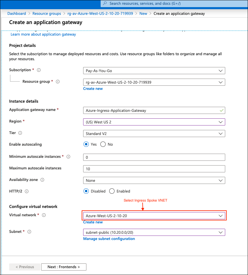

Creating Azure Application Gateway
In Ingress Spoke VNET, create an Azure Application Gateway. Make sure you select the following:

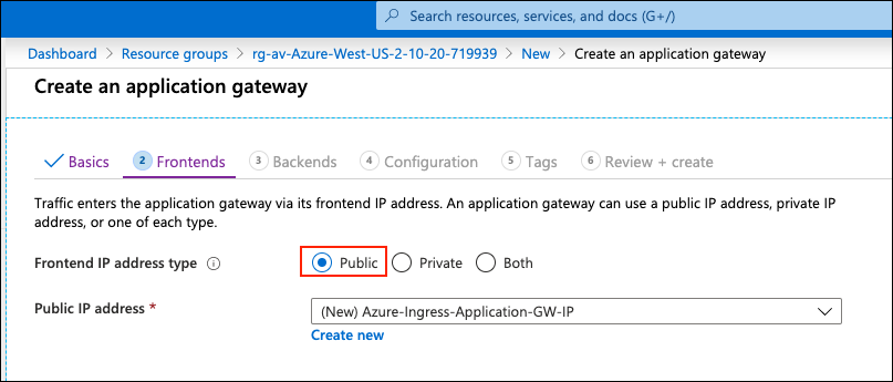

  1. Create an Azure Application Gateway in Ingress Spoke VNET. Azure Application Gateway Creation
  2. Under Frontends, select Public for the Frontend IP address type. Azure Application Gateway Frontend

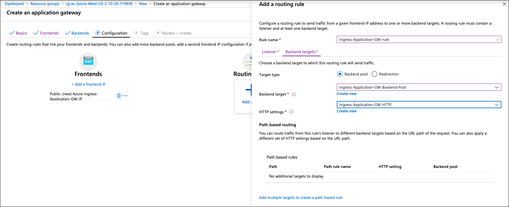

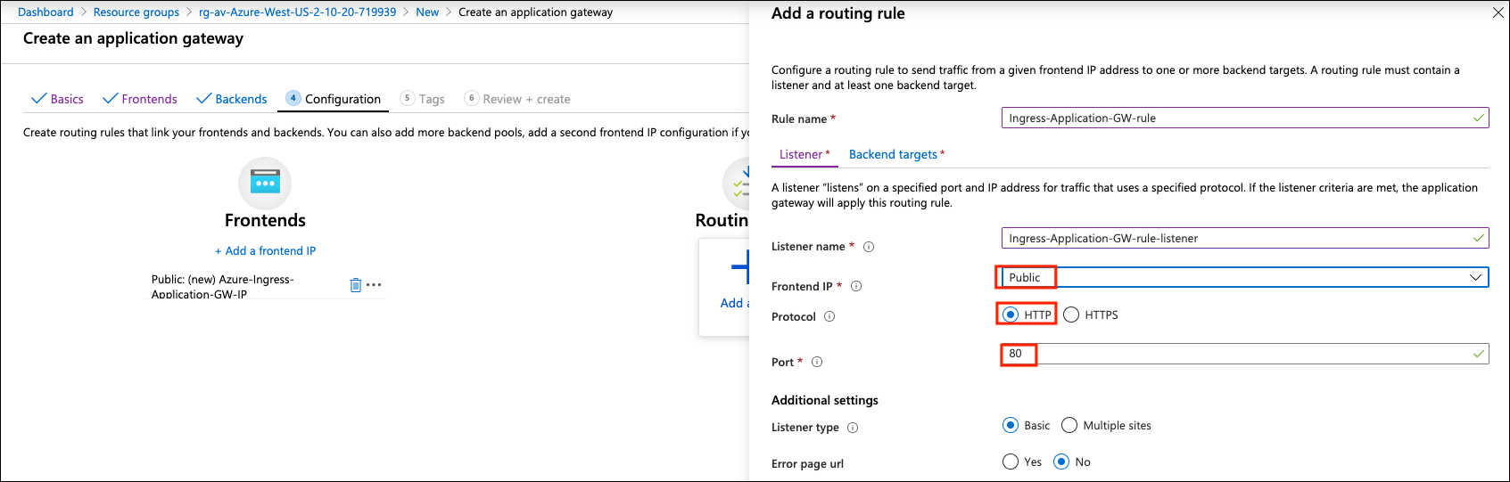

  4. Add a routing rule on the Listener depending on your requirements.
    Example settingExample value
    Frontend IPPublic
    ProtocolHTTP
    Port80
    Azure Application Gateway Routing Rule Listener

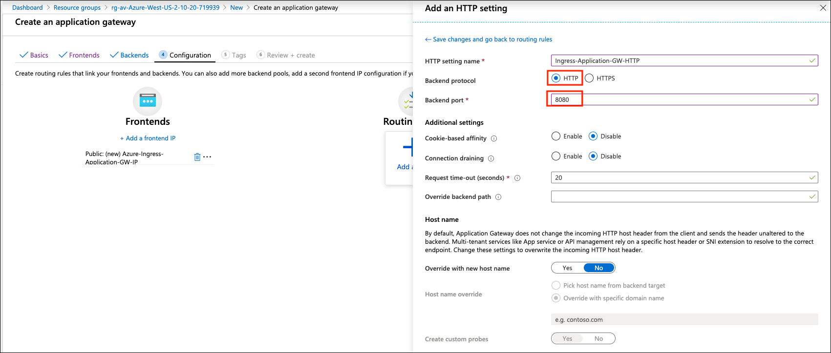

  5. Add a routing rule on Backend targets and create an HTTP setting depending on your requirement. Azure Application Gateway Routing Rule Backend Target
  6. Click Create new on HTTP settings. Azure Application Gateway HTTP Setting
    Example SettingExample Value
    Backend protocolHTTP
    Backend port8080
    Azure Application Gateway Backend Target

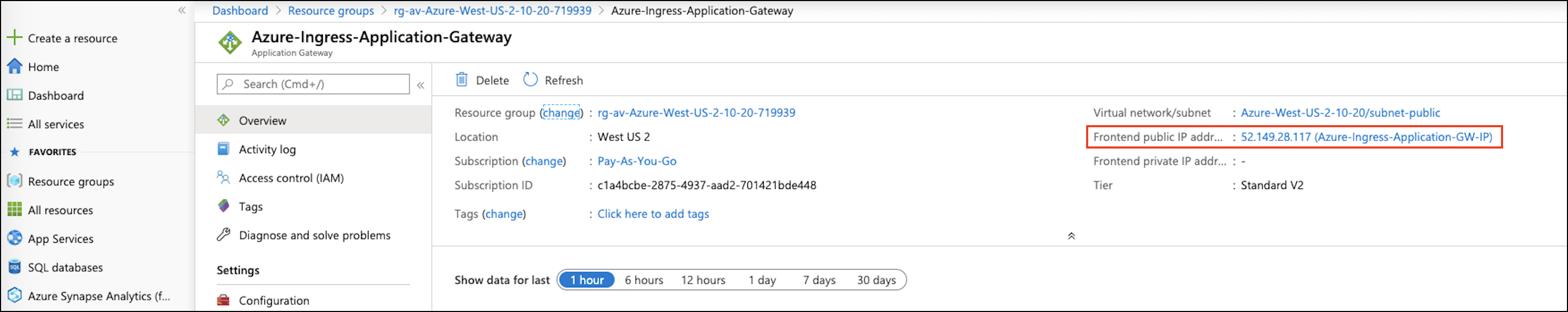

  1. Make sure Server (backend pool) status is in a Healthy state from the Azure portal page Application Gateway > Backend health. Azure Application Gateway Health Check

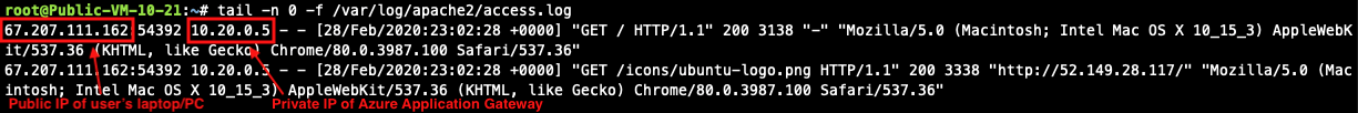

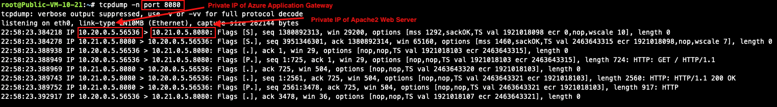

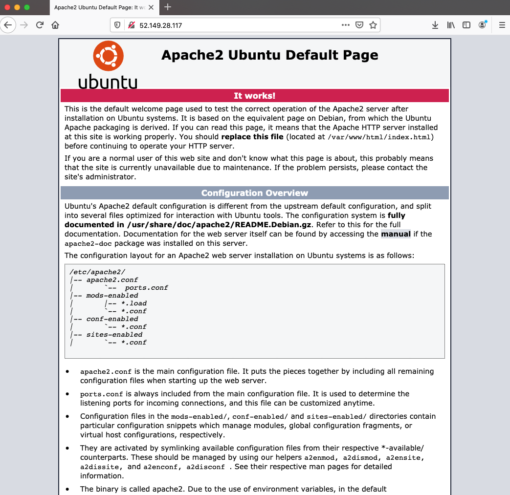

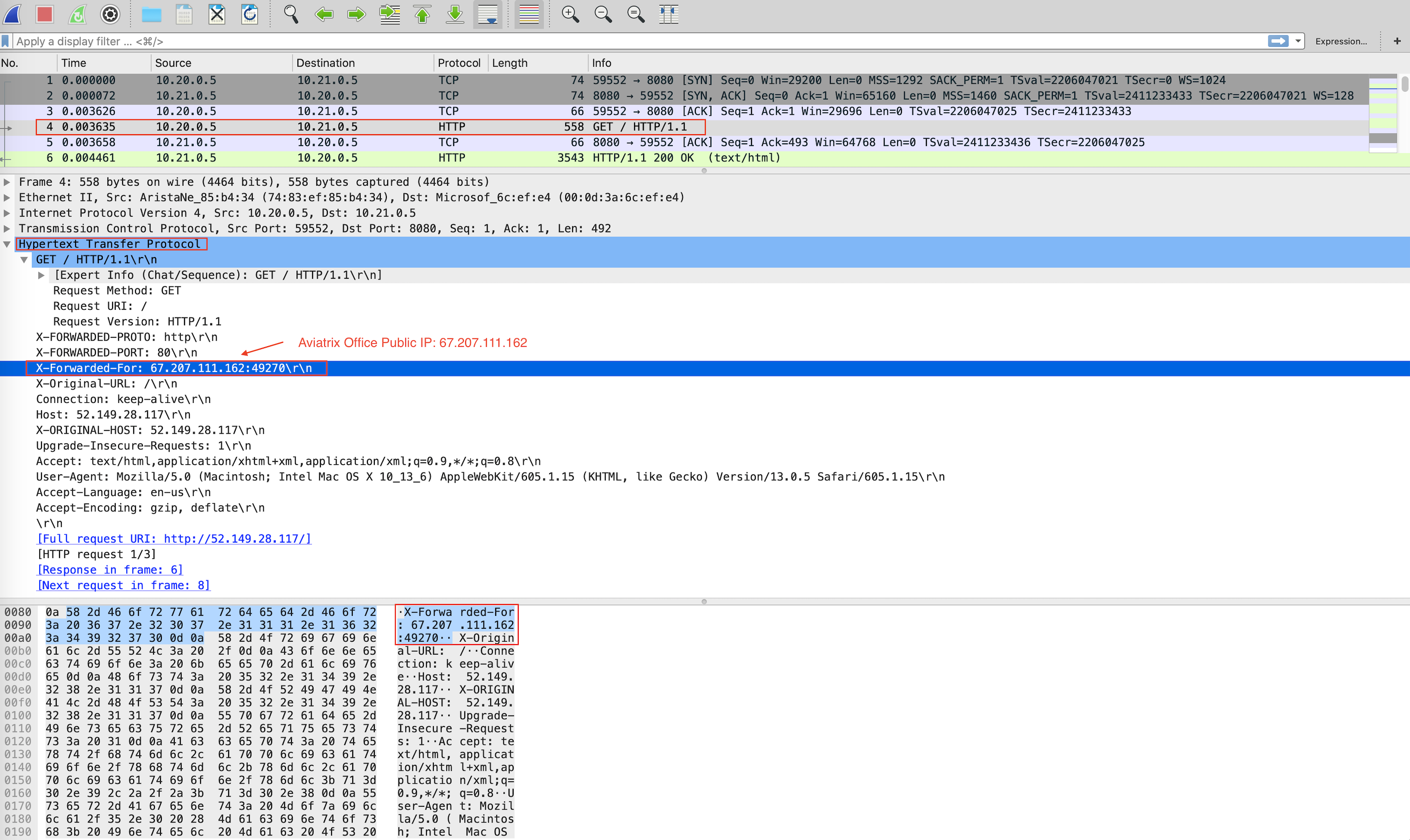

  2. Run a http request targeting the Azure Application Gateway Public IP or DNS name. a. Find the Frontend public IP address of the Azure Application Gateway from the Azure portal page Application Gateway > Overview. Azure Application Gateway Public IP b. Copy the Frontend public IP address of Azure Application Gateway and paste it on a browser from your laptop/PC. Azure Browser c. Perform tcpdump with port 8080 on Apache2 Web server. Azure Server tcpdump Azure Application Gateway automatically preserves client original IP address in the HTTP header field “X-Forwarded-For (XFF)”. Here is an HTTP packet example which is opened with Wireshark tool for your reference: Azure Server Wireshark

Capturing Client IP in Logs
To view the client IP address in the access log, follow the instructions in How to save client IP in access logs.
  1. Find and open Apache configuration file.
    #vim /etc/apache2/apache2.conf
  2. In the LogFormat section, add %{X-Forwarded-For}i as follows:
    LogFormat "%{X-Forwarded-For}i %h %l %u %t \"%r\" %>s %b \"%{Referer}i\" \"%{User-Agent}i\"" combined
    LogFormat "%h %l %u %t \"%r\" %>s %b" common
  3. Save your changes.
  4. Reload the Apache service.
    #systemctl reload apache2
  5. Review the public/original client IP on apache2 access log. Azure Server Apache Access Log
