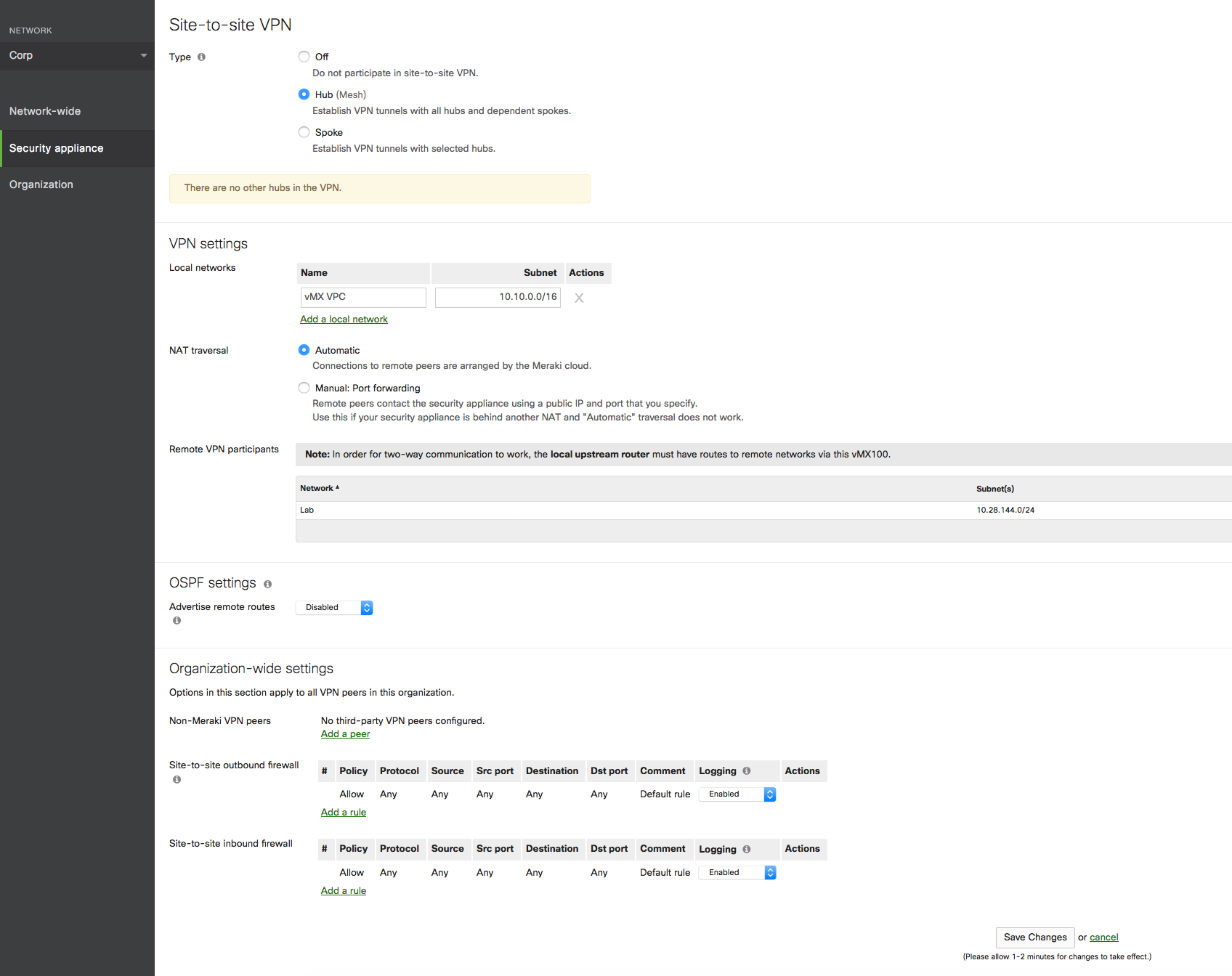

In this example, the Meraki vMX100 is already deployed in the us-west-2 (Oregon) region in a VPC with a CIDR of 10.10.0.0/16. The following is the configuration for vMX100 in AWS VPC.
Here is the configuration for the MX64 at on-prem.

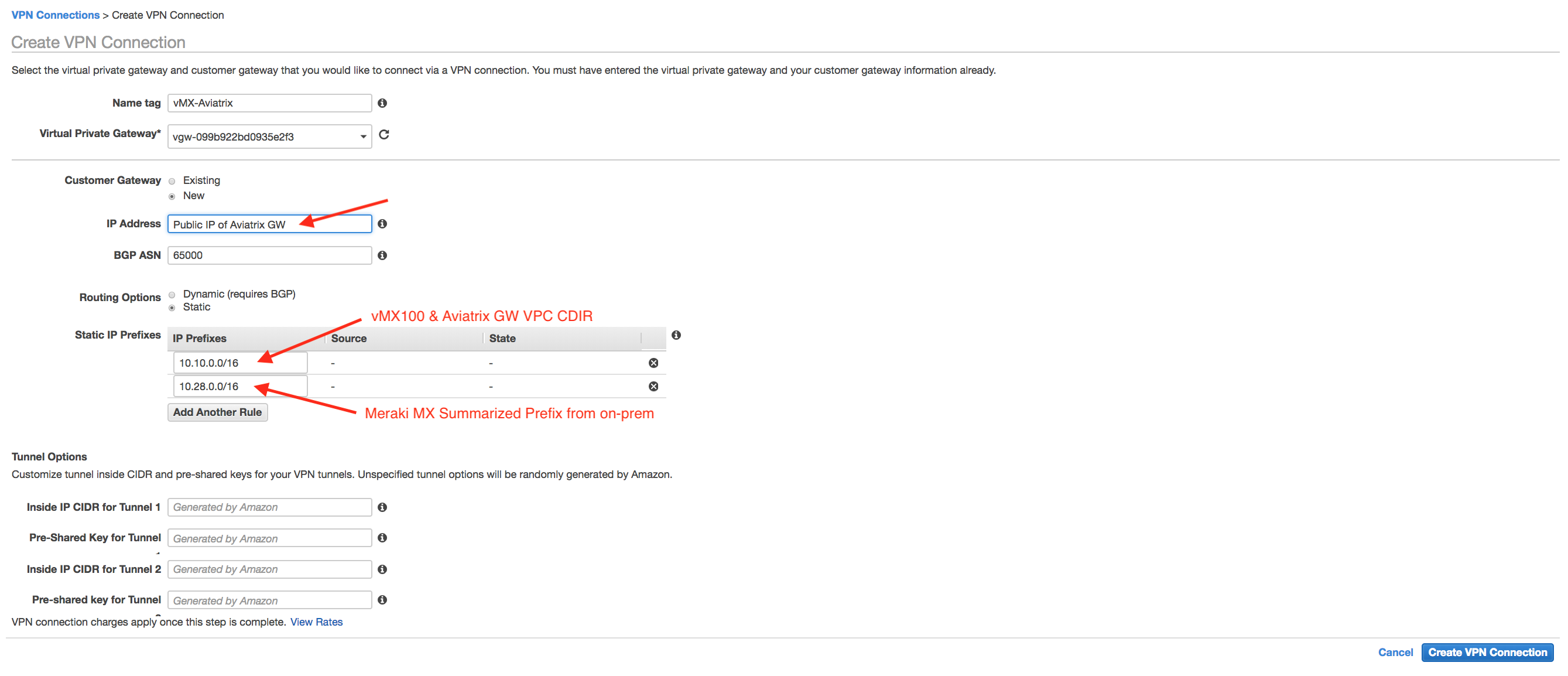

Go to the AWS console in the us-west-2 (Oregon) region. Click on Services and go to VPC Dashboard.
Click on VPN Connections at the left panel.
Click "Create VPN Connection" to create an IPsec tunnel to Aviatrix GW.
Select the VPN connection that you just created and click "Download Configuration" to download the "Generic" configuration.

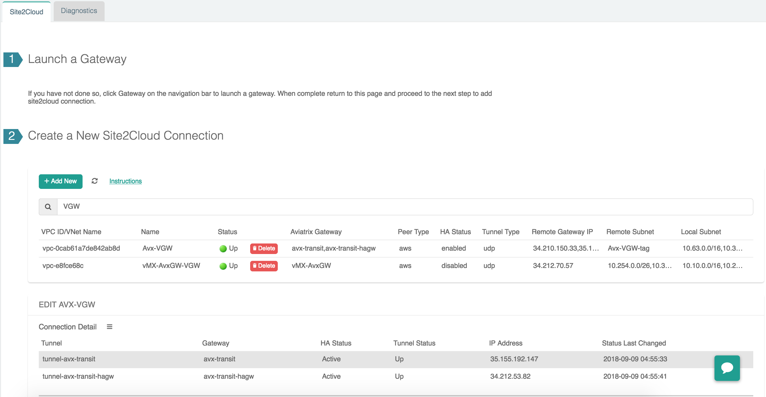

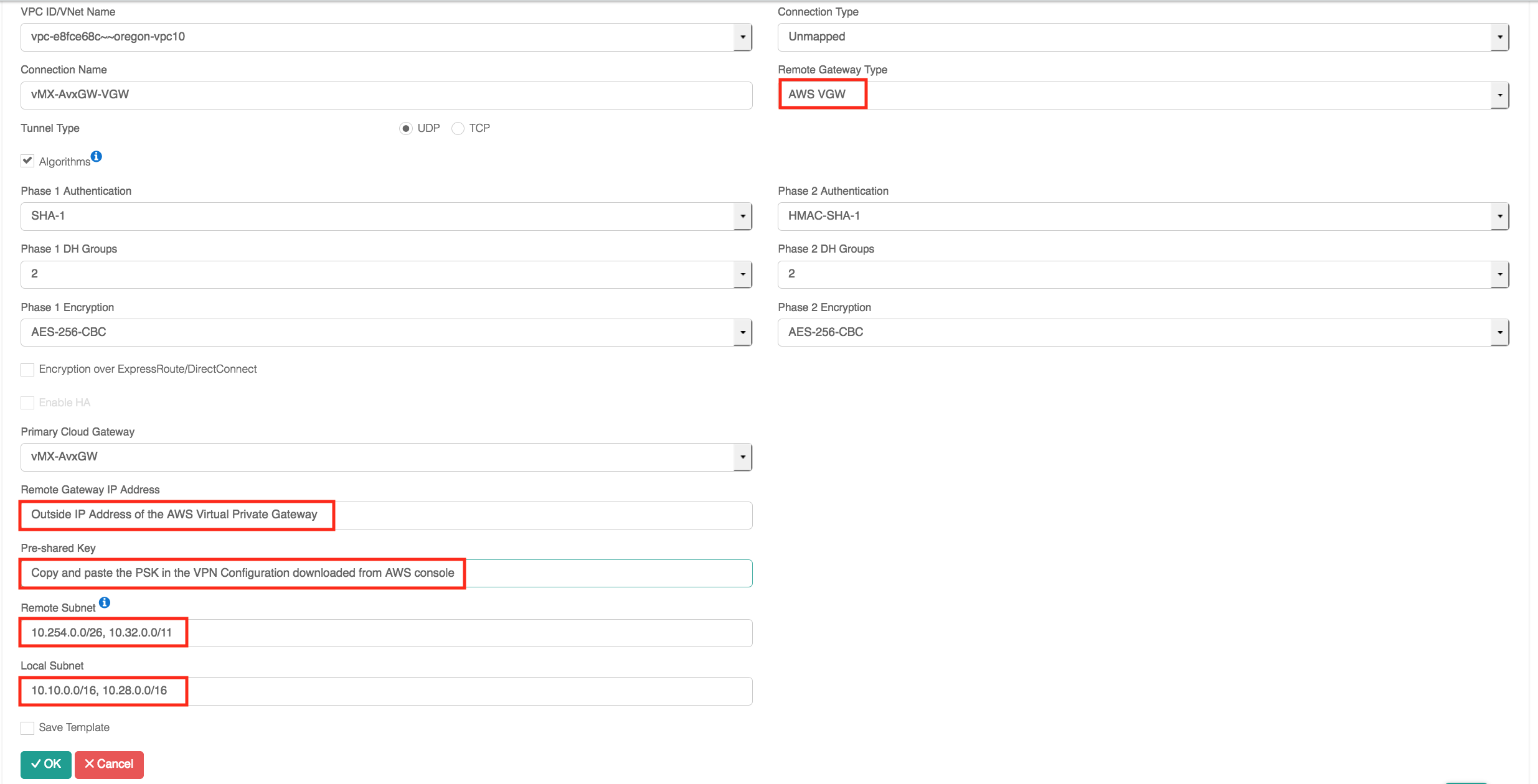

At the Aviatrix Controller UI, click Site2Cloud at the navigation panel.
Click "Add New" to configure the Site2Cloud connection to the same VGW that is already connected to Aviatrix Transit Networks.

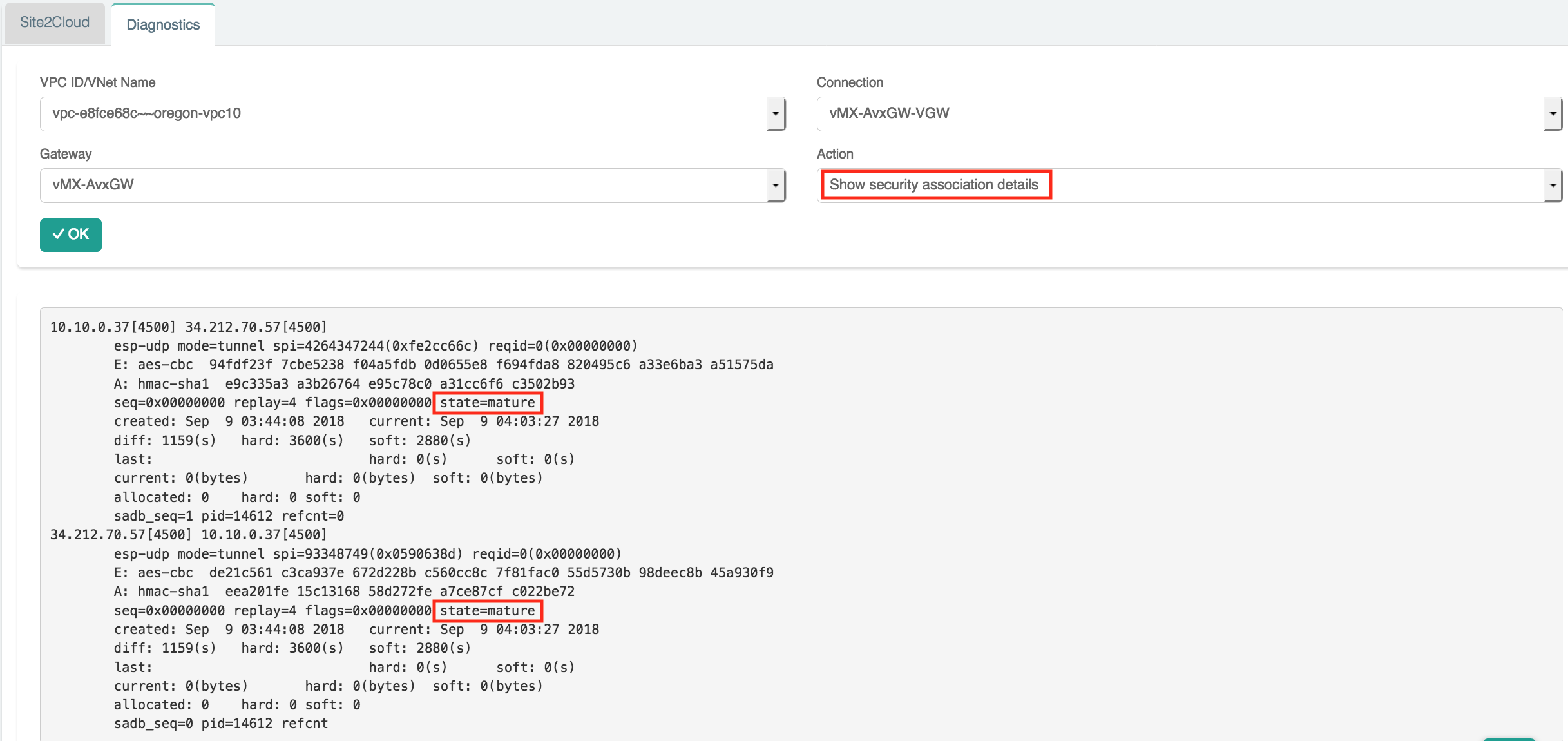

Click on the Site2Cloud > Diagnostics page and verify that the IPsec tunnel is established between Aviatrix GW and the VGW.

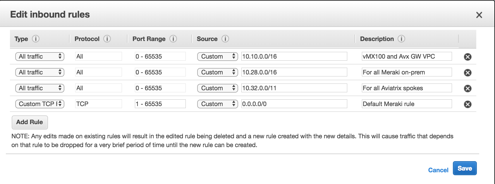

Click on the Security Group for the vMX100 and add Allow Inbound traffic from 10.10.0.0/16, 10.28.0.0/16 and 10.32.0.0/11. Let the default Outbound Allow All.
Select EC2 Aviatrix GW instance and click on its Security Group.
Add Allow Inbound traffic from 10.10.0.0/16, 10.28.0.0/16 and 10.32.0.0/11. Let the default Outbound Allow All.

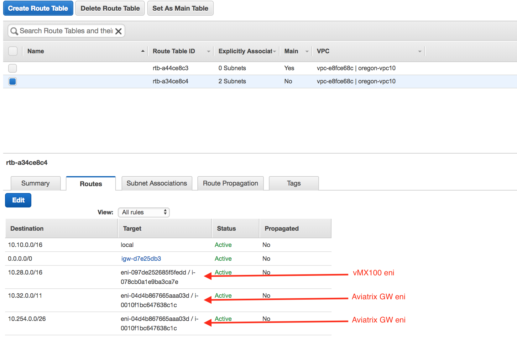

Go to AWS VPC Dashboard and edit the route table of the VPC where vMX100 and Aviatrix GW are deployed. Configure both the public and private route tables such that 10.28.0.0/16 is pointed to vMX100 eni. The 10.32.0.0/11 and 10.254.0.0/26 are automatically added when we create the Site2Cloud connection to the VGW in the previous section.

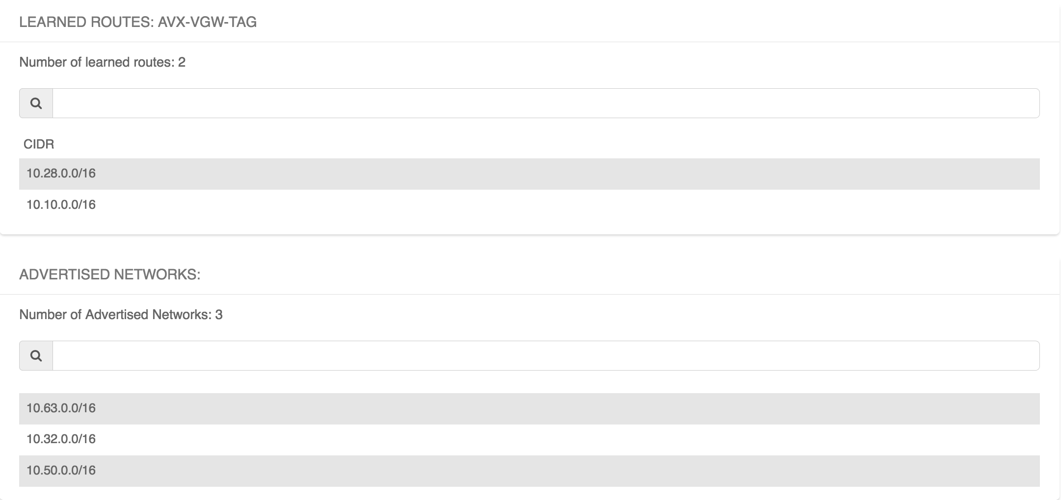

Select Site2Cloud connection for the Aviatrix Transit Network. You should observe that both IPsec tunnels to VGW are UP. There will be 2 learned routes from VGW (10.10.0.0/16, 10.28.0.0/16) and 3 advertised networks from spokes (10.32.0.0/16, 10.50.0.0/16, 10.63.0.0/16).

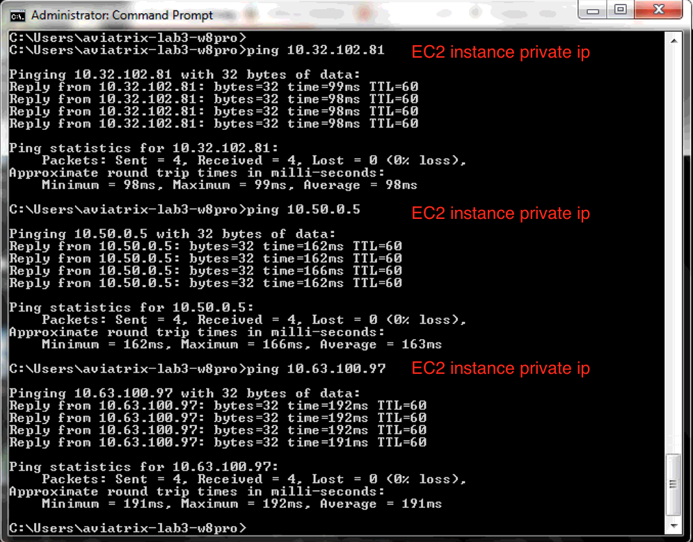

In this example here, I have 3 EC2 instances in each Spoke VPC (10.32.102.81 in private subnet, 10.50.0.5 in public subnet, 10.63.100.97 in private subnet). My on-prem client is 10.28.144.19. The following screenshot shows the end to end connectivity from on-prem to each spoke.

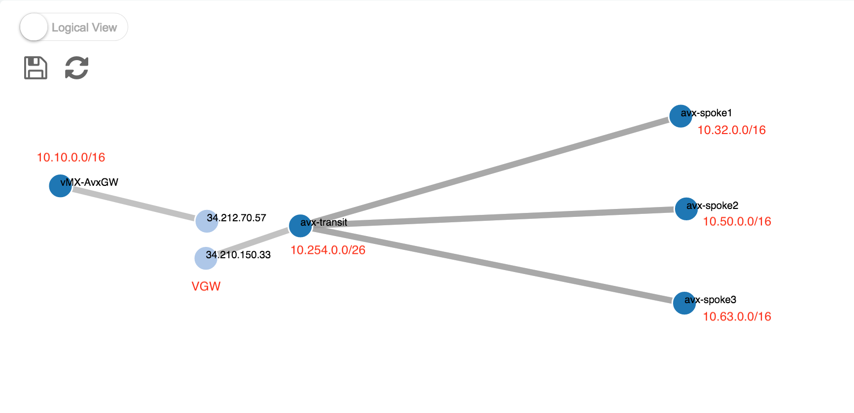

Here is a logical view of the networks from Aviatrix Controller UI.
