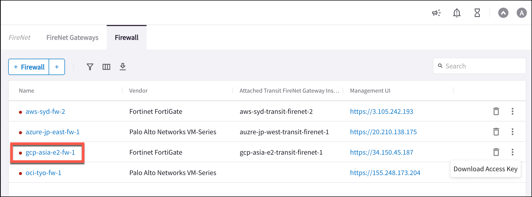

After the firewall launch is complete, you click the Management UI link displayed on the FireNet > Firewall tab to access the FortiGate Next Generation Firewall instance. fortinet-access-key

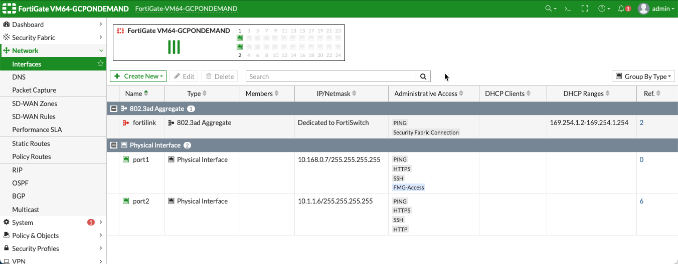

Use the default username and password to log in. Since this is the initial setup of this FortiGate UI, you may be prompted to specify your hostname; change your password; upgrade your firmware; and complete your dashboard setup. After completing those steps, go to Network > Interfaces in the FortiGate UI and review the interface configuration. This interface configuration was completed by the Aviatrix CoPilot during the firewall launch. review_fggcp_interfaces

Before configuring the static routes you must configure the port 2 (LAN) interface as follows. The port 1 (WAN) interface does not need to be configured; it is the default management port and is configured during the deployment.
  1. In the FortiGate UI, navigate to Interfaces > port2. Configure the interface as follows:
    • Alias: LAN
    • Administrative Access > IPv4: FortiGate requires administrative access to reply to health probes from a network load balancer (load balancers are created automatically in GCP when you set up your Transit FireNet connection). Select the HTTP, HTTPS, SSH and PING checkboxes. When you select HTTPS this opens TCP port 443 to check the health of the firewall.
  2. Click OK.

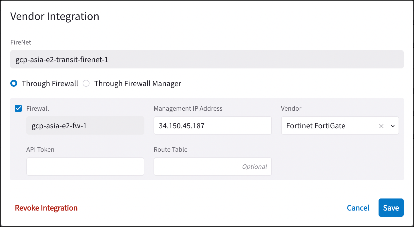

  5. You now need to make sure that the FireNet configuration information for this firewall is pushed to the firewall management interface. On the FireNet > FireNet Gateways tab, next to the FireNet where you launched this firewall, click the vertical ellipsis and select Vendor Integration. vendor-integration-fortigate
  6. Enter the vendor firewall information:
    • Through Firewall or Through Firewall Manager (latter typically only used for Palo Alto firewalls using Panorama).
    • Firewall Management IP Address: IP address of your firewall.
    • Vendor: Fortinet FortiGate.
    • API Token: paste the API token string from step 1 here.
    • Route Table (optional).
  7. Click Save. Aviatrix Controller is now enabled to make automatic route updates to the FortiGate routing tables.

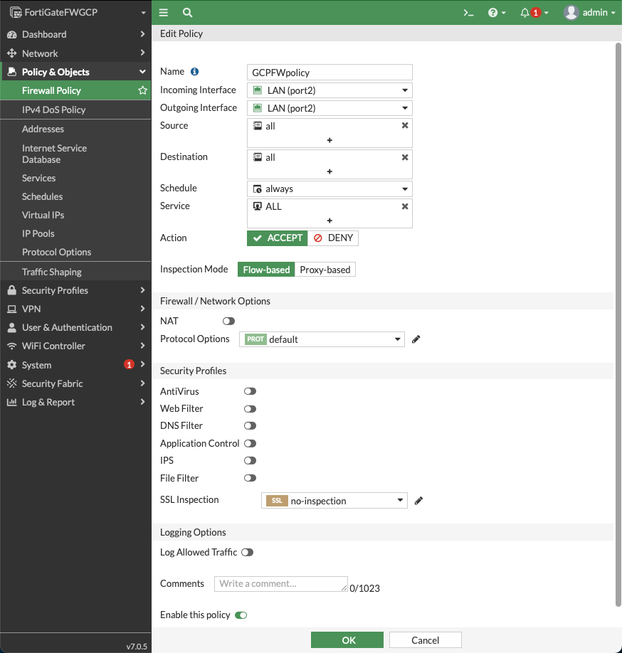

Configuring Basic Policy to allow VPC to VPC Traffic
You can configure a basic traffic security policy that allows traffic to pass through the firewall.
  1. In the FortiGate UI, navigate to Policy & Objects > Firewall Policy and click Create New to configure the policy as per the following screenshot.
  2. In the New Policy dialog, configure the following for the basic traffic security policy:
    • Name: configure any name
    • Incoming Interface: port2
    • Outgoing Interface: port2
    • Source: all
    • Destination: all
    • Schedule: always
    • Service: All
    • Action: Accept
    • NAT: disabled
    gcp-fortigate-vpc
  3. Click OK.
After validating that your traffic is being routed through your firewall instances, you can customize the security policy to your requirements.

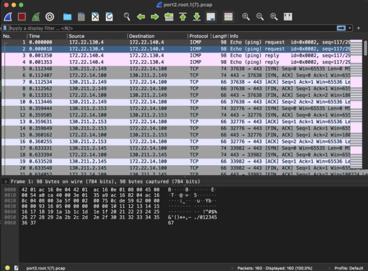

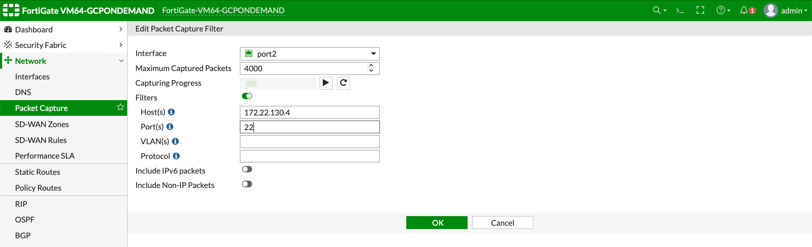

You can configure a packet capture in the FortiGate UI to test traffic flow. fortgcp-packetcapture In this example, the spoke10 instance (172.22.130.4) pings the spoke20 instance (172.22.140.4). fortgcp-packetcapture2 You can also use CoPilot AppIQ to check traffic flow and troubleshoot any issues.
