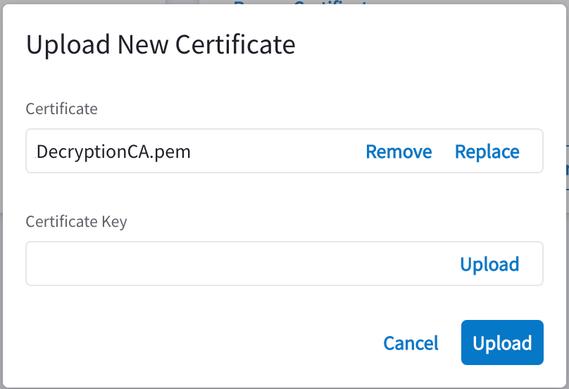

Uploading Your Own Certificate
It is best to upload your own certificate (must be in .pem format), since you likely have this certificate in use throughout your environment. You can remove the default Aviatrix CA certificate first, if desired.
  1. On the Settings tab, on the Decryption CA Certificate card, click the arrow next to Download Certificate and click Upload New Certificate.
  2. In the Upload New Certificate dialog, you can upload, remove or replace a certificate and its corresponding certificate key.
300
  1. Both fields must be populated. Click Upload.

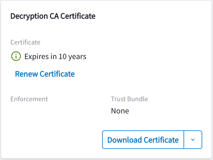

Downloading the Aviatrix Certificate
You can download the currently applied Aviatrix CA certificate and add it to your trust bundle. To download the CA certificate provided by Aviatrix:
  1. Navigate to Security > Distributed Cloud Firewall > Settings.
  2. On the Decryption Trust CA Certificate card, click Download Certificate.

Renewing Your Certificate
You must renew your Aviatrix CA certificate when it is about to expire. When you click Renew Certificate, the certificate renews automatically. You can also upload your own CA certificate.
