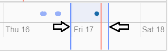

    The bottom of the time series visualization shows changes that were recorded over the last week. There, you can drag the time-window control lines (blue vertical lines) to encompass a day (or multiple days) to quickly zoom into change sets for that time period. Keep zooming into a time period until you see a View icon. The View icon indicates a change set at that point in time. Click on the View icon to load the change set. It may take a few seconds to load. After it loads, the View icon is replaced by a blue box with the title of the change set (the title reflects the number of changes in the change set). Hovering over the blue box displays the end time of the change set.

  • Time-window control lines In the overview timeline (bottom half of the panel), after you zoom into a time period by clicking on the Expand icons or by using your track pad, two time-window control lines (blue vertical lines) display near the current time (the red line). Drag the time-window control lines where needed to focus in on the day or days you want to locate change sets in. time-control-image
