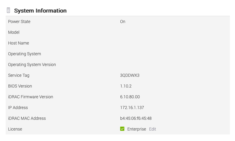

Obtain the Serial Number of your edge device. To onboard and register the edge device with the Aviatrix Edge platform, you will be required to provide the device Serial Number.The device Serial Number can be found from the iDRAC. Login to the iDRAC. On the Dashboard, look for System Information/Service Tag:
