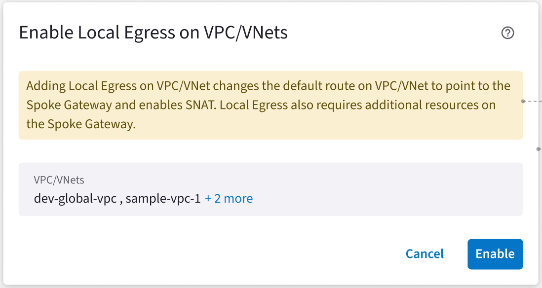

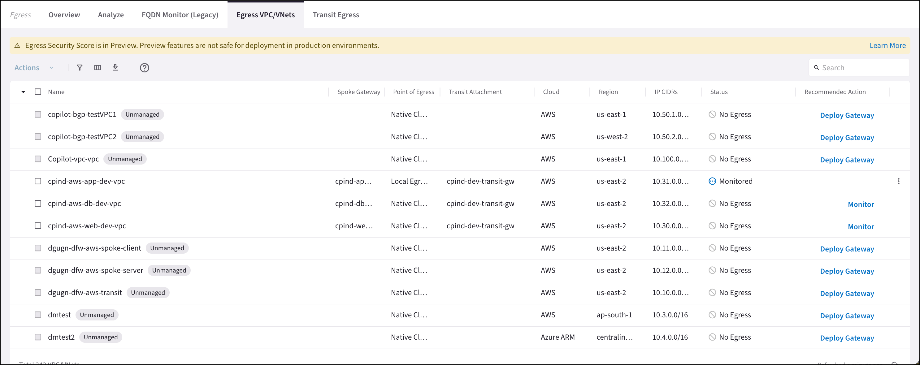

On the Security > Egress > Egress VPC/VNets tab, do one of the following:
- Select one or more VPC/VNets and then select Enable Local Egress from the Actions menu.
- Click the vertical ellipsis next to a VPC/VNet and select Enable Local Egress.
- Click Enable to acknowledge that enabling local egress changes the default route and enables SNAT.
If you select a VPC/VNet that is part of a Transit Egress this overrides the
Transit Egress. You cannot enable egress on Global VPCs because SNAT is not
currently supported for Global VPCs.
- Select one or more VPC/VNets and then select Disable Local Egress from the Actions menu.
- Click the vertical ellipsis next to a VPC/VNet and select Disable Local Egress.
