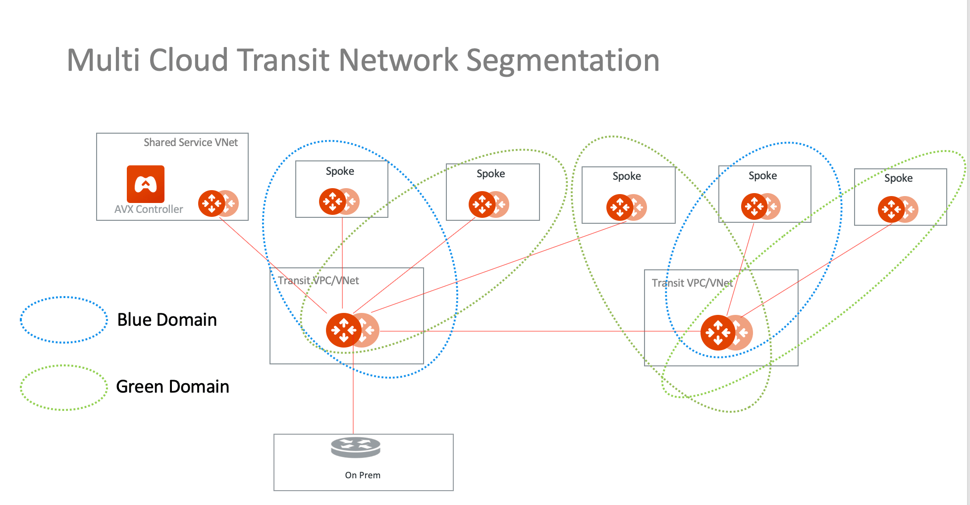

About Network Domains
When you identify groups of Spoke and Edge VPC/VNets in your infrastructure with the same requirements from a networking point of view (network reachability), you may want to group them so that you can apply connection policies at the group level. You can group them as members of an Aviatrix network domain. A network domain is an Aviatrix enforced network of one or more Spoke or Edge VPC/VNets. You use the network domains with connection policies. This achieves the network isolation for inter-VPC/VNet connectivity that you want for your network. You can have up to 200 network domains on each Aviatrix Transit Gateway. The following diagram shows two network domains, one named Blue and one named Green.
