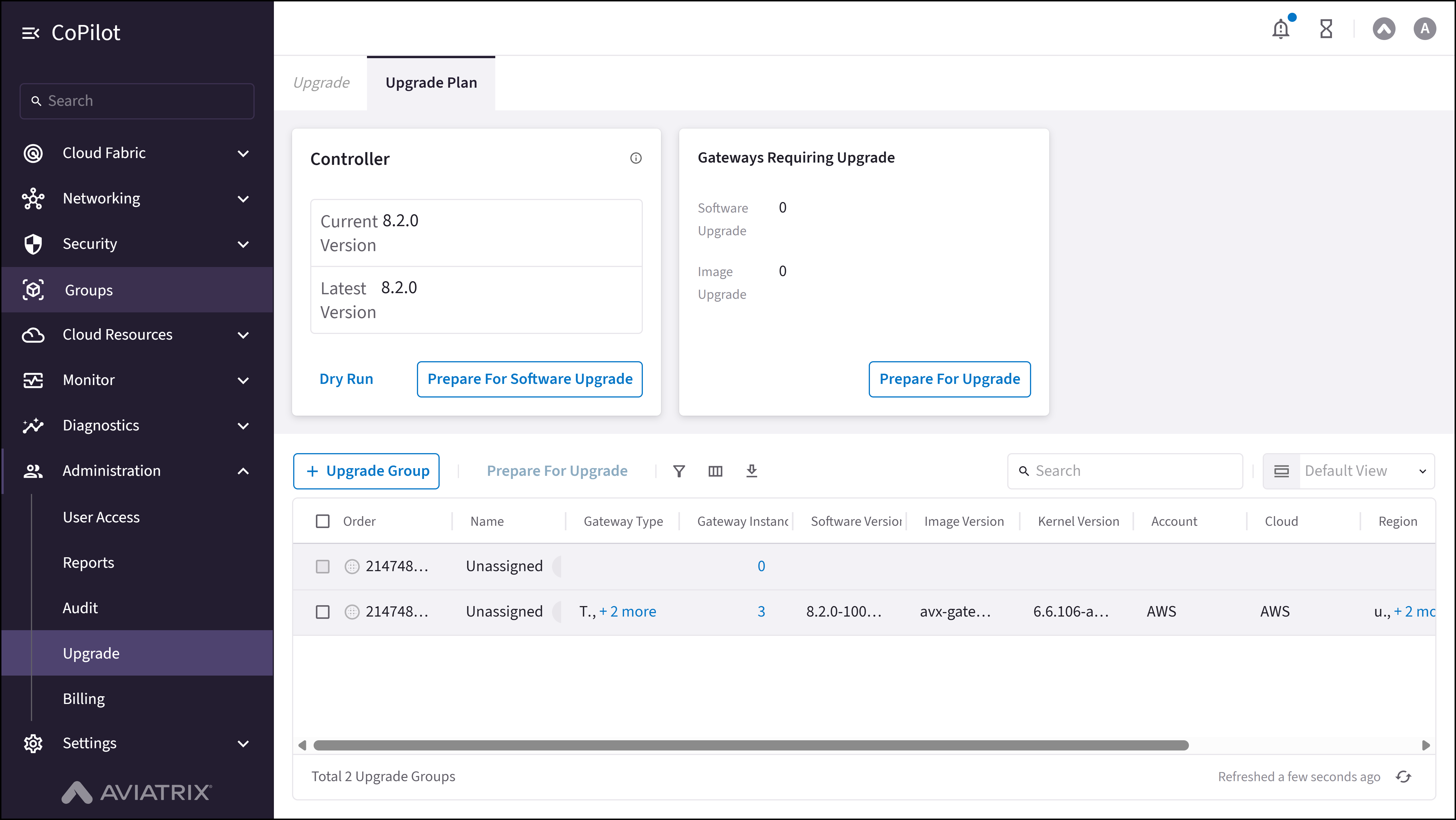

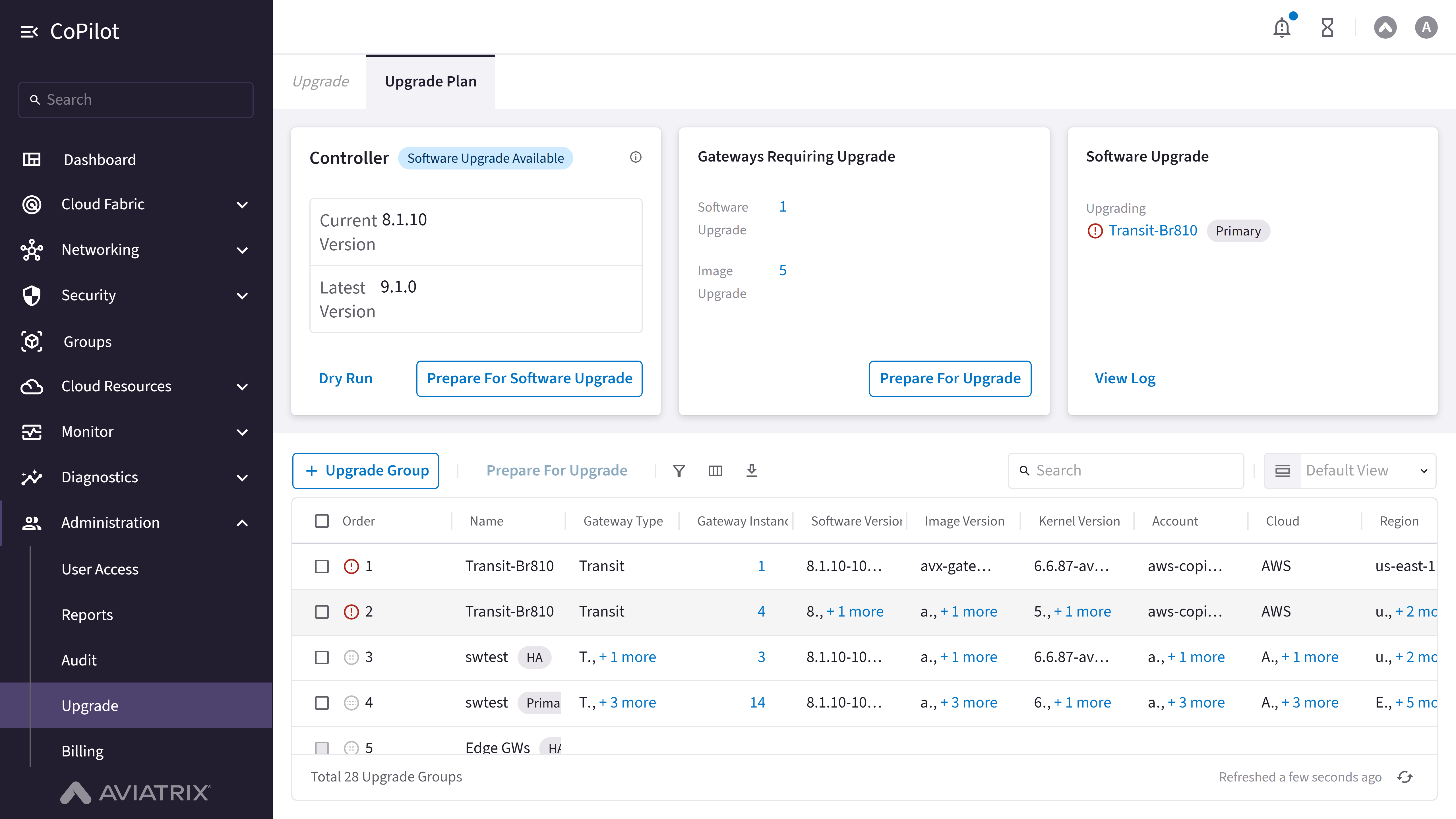

To view the upgrade plan:
  1. Go to Administration > Upgrade.
  2. The page appears with Controller version info, Dry Run, Prepare For Software Upgrade, Gateways Requiring Upgrade, upgrade groups table, and Upgrade Group.
  3. Optionally, use Show filters, Select columns, Export, Search, or View Gateway Instances to inspect groups.
The upgrade plan shows controller and gateway upgrade status and upgrade groups.
