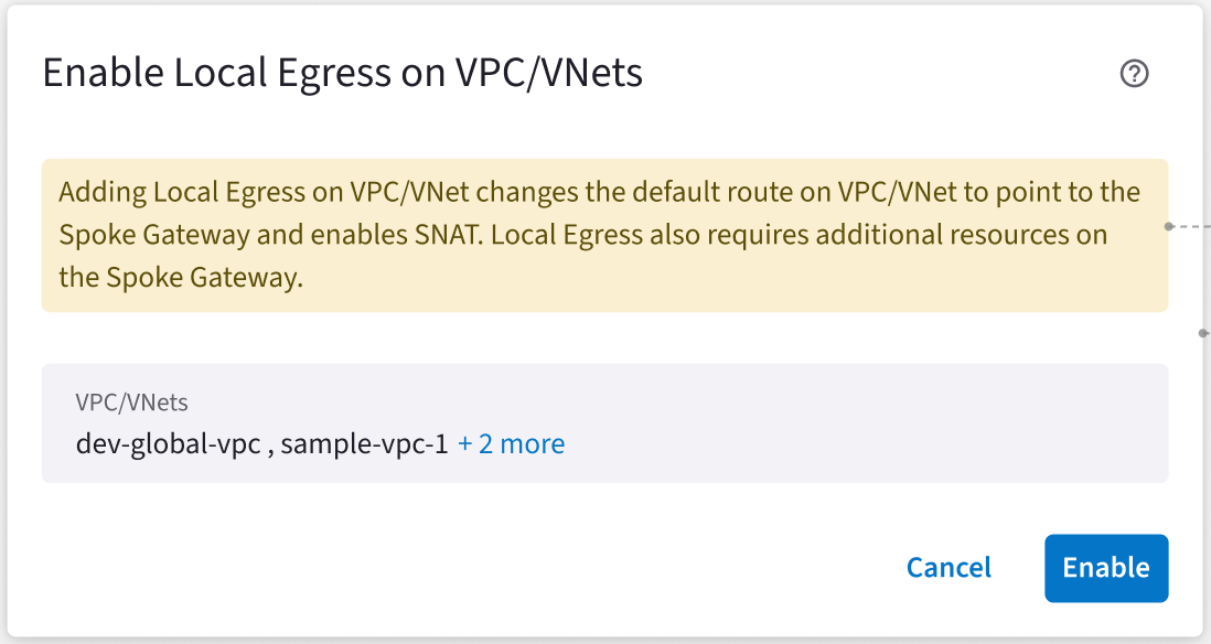

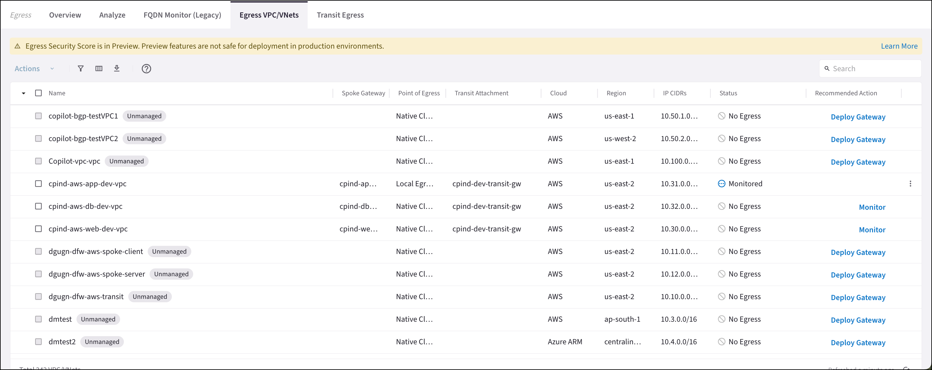

On the Security > Egress > Egress VPC/VNets tab you can enable Local Egress on selected Spoke VPC/VNets that do not already have Egress enabled, and that are not attached to a Transit FireNet gateway. egress vpc vnets tab The following occurs when you add Local Egress on a VPC/VNet:
  • The default route on the VPC/VNet changes to point to the Spoke Gateway.
  • SNAT is enabled.

  2. On the Security > Egress > Egress VPC/VNets tab, do one of the following:
    • Select one or more VPC/VNets and then select Enable Local Egress from the Actions menu.
    • Click the vertical ellipsis next to a VPC/VNet and select Enable Local Egress.
    The Enable Local Egress on VPC (VNets) dialog displays. 300
  3. Click Enable to acknowledge that enabling local egress changes the default route and enables SNAT.
After enabling local egress, the status of the VPC/VNet changes from No Egress to Unprotected.
If you select a VPC/VNet that is part of a Transit Egress, enabling Local Egress overrides the Transit Egress. You cannot enable egress on Global VPCs because SNAT is not currently supported for Global VPCs.
