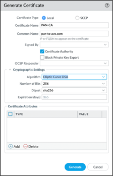

  1. In the Palo Alto VM-Series firewall UI, navigate to Device > Certificate Management > Certificates > Device Certificates.
  2. Click Generate at the bottom of the window. The Generate Certificate dialog displays.
  3. Fill out the following information:
    • Certificate Name: a name that makes sense to you, such as PAN-CA
    • Common Name: a descriptor that makes sense to you, such as pan-to-avx.com
    • Signed By: select Certificate Authority
    • Cryptographic Settings:
      • Select Elliptic Curve DSA (ECDSA); this is currently the only algorithm supported by Site2Cloud cert-based authentication.
      • Select 256 bits
      • Select sha256 digest
generate cert
  1. Click Generate. This creates the root CA certificate that will be used to sign the PAN to Aviatrix certificate you will create in the next step.

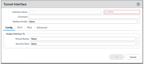

  2. Navigate to Network > Interface > Tunnel and click Add to create a new tunnel interface and assign the following parameters.
create tunnel interface
Field Value
Interface Name
tunnel.1
Virtual Router
Select the existing default virtual router
Security Zone
Select the layer 3 internal zone from which traffic originates
If the tunnel interface is in a zone different from the one where the traffic will originate, a policy needs to be created to allow the traffic to flow from the source zone to the zone containing the tunnel interface.

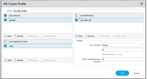

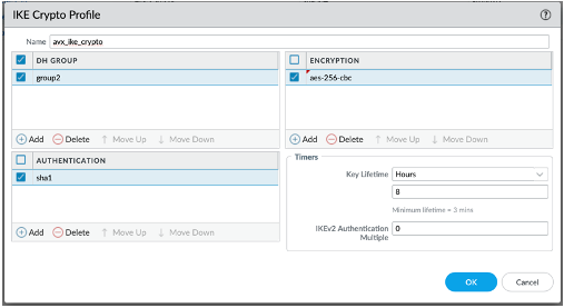

Setting up IKE Crypto Profile and IKE Gateways
  1. In the Palo ALTO VM-Series UI, navigate to Network > Network Profiles > IKE Crypto, click Add and define the IKE Crypto profile (IKEv1 Phase-1) parameters.

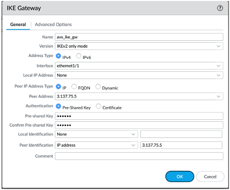

  1. If using PSK (Pre-shared Key) for authentication with Site2Cloud, navigate to Network > Network Profiles > IKE Gateways to configure the IKE Phase-1 Gateway. These parameters should match the Site2Cloud configuration downloaded under Setting up External (S2C) Connection.
According to the Palo Alto Networks official documents, it is not necessary to add the Peer Identification. However, Aviatrix recommends adding it, to make sure the tunnel is working. In the event that the IPsec tunnel is up but traffic is not passing between the Cloud and on-premises, you may want to enable NAT-T in Palo Alto Networks Firewall.
Field Value
Interface
Palo Alto Networks WAN port
Peer IP Address
Aviatrix Gateway public IP
Pre-shared Key
Key from Site2Cloud configuration downloaded in Certificate-Based Authentication
Peer Identification
Peer public IP address (if the Controller version is below 5.0, it should be the peer private IP)

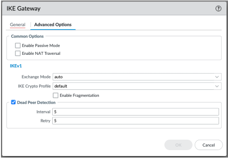

  1. Under Advanced Options, select the IKE Crypto profile created in step 1 of this procedure.
    ike gw 2

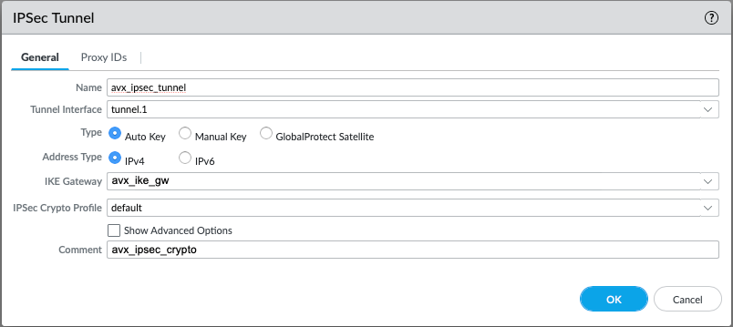

  1. Under Network > IPsec Tunnels, click Add to create a new IPsec Tunnel. At the General window:
    Field Value
    Tunnel Interface
    Tunnel interface created earlier
    IKE Gateway
    IKE gateway created earlier
    IPsec Crypto Profile
    IPsec crypto profile created earlier

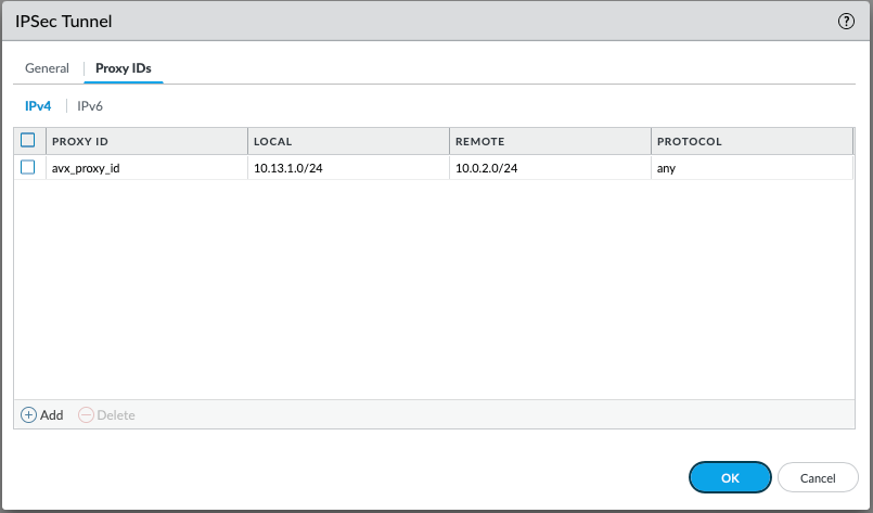

  1. At Proxy IDs window:
    Field Value
    Local
    VPC2 private subnet CIDR
    Remote
    VPC1 private subnet CIDR
    Protocol
    Any

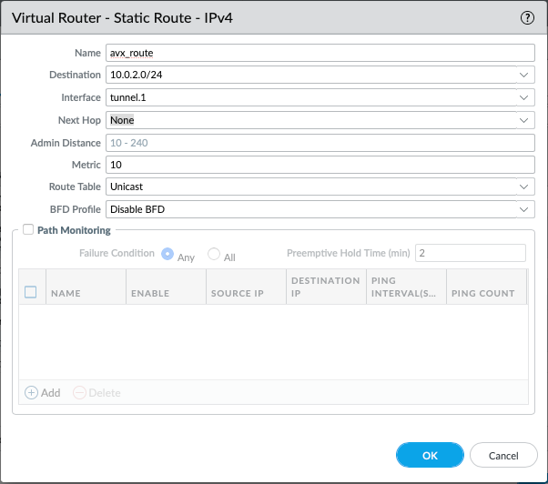

  2. Under Network > Virtual Routers, click on the virtual router profile, then click Static Routes > default, and add a new route with the VPC1 private subnet as the destination.
    Field Value
    Destination
    Interface
    Tunnel interface created at Step 5.1

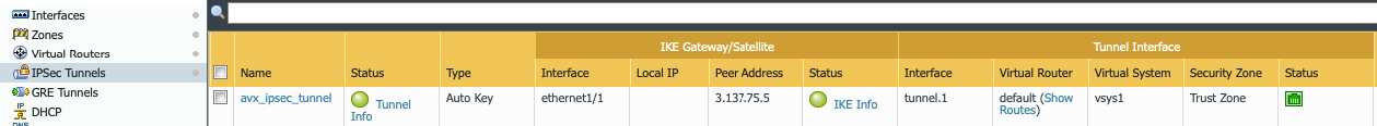

  3. Commit the configuration. The IPsec tunnel status turns green.
