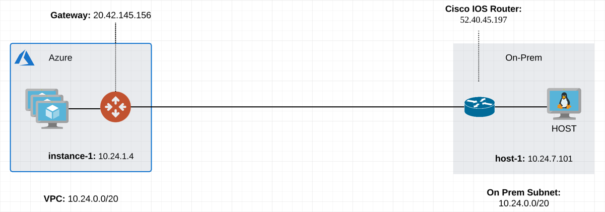

The scenario is described in the following diagram:
VPC CIDR = 10.20.0.0/20, instance-1 in VPC-1 has an IP address 10.24.1.4. On-Prem CIDR = 10.20.0.0/20, host-1 in On-Prem has an IP address 10.24.7.101.

This solution uses a Site2Cloud route-based IPsec tunnel using Virtual Tunnel Interface (VTI) between VPC and On-Prem Router. The packet flow is demonstrated as below:
instance-1 sends a packet to host-1 with a virtual destination IP address, for example 192.24.7.101. From instance-1’s point of view, the destination instance is a virtual address - 192.24.7.101.
When the packet arrives at the VPC-1 gateway, the gateway performs DNAT on the packet to translate the virtual destination IP address to 10.24.7.101 which is the host-1 physical IP address.
The gateway at VPC then translates the packet source IP address (10.24.1.4) to a virtual source IP address (172.24.1.4).
The packet then arrives at the on-prem Cisco IOS Router with a destination IP address of 10.24.7.101 and a source IP address of 172.24.1.4. From host-1’s point of view, instance-1’s address is a virtual IP address - 172.24.1.4.
When host-1 sends a packet to instance-1, the destination is the virtual IP address 172.24.1.4.
When the packet arrives at the VPC-1 gateway over the IPSEC tunnel, the VPC gateway translates its destination IP address from virtual address 172.24.1.4 to 10.24.1.4.
The VPC gateway then translates the source IP address of the packet from 10.24.7.101 to virtual address 192.24.7.101.

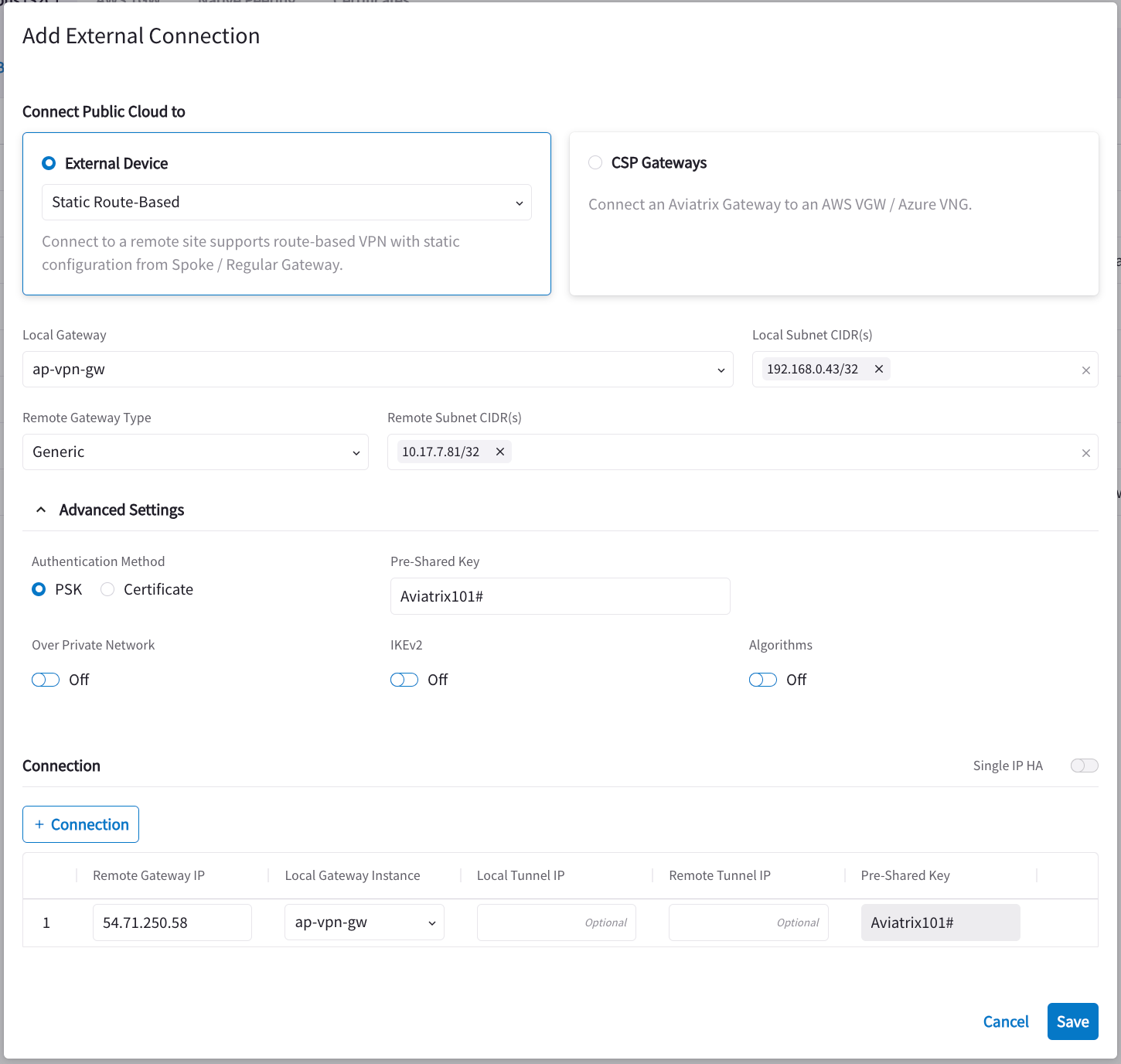

In CoPilot, go to Networking > Connectivity > External Connections (S2C) tab, and create Static Route-Based Unmapped connection.
VPC/VNet-1 gateway-1 side
For the VPC/VNet-1 gateway side, the Local Subnet field should be 192.168.0.43/32, and the Remote Subnet field should be 10.17.7.81/32, as shown below.

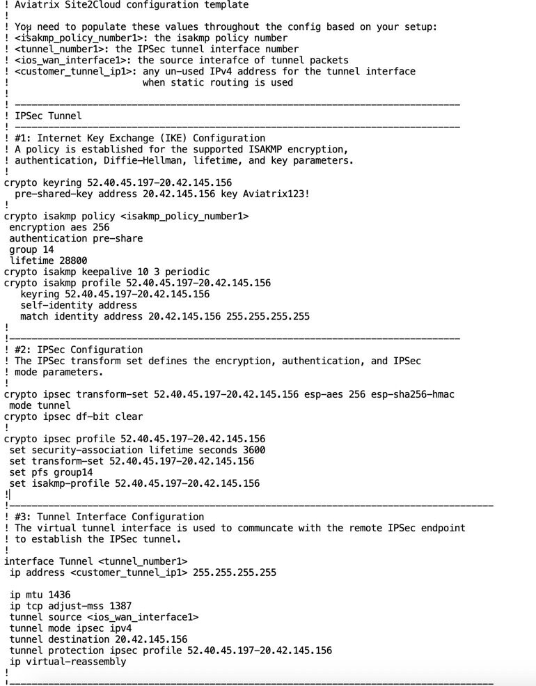

The following is a sample configuration based on the Site2Cloud configuration above.
Either ssh into the Cisco router or connect to it directly through its console port.
Apply the following IOS configuration to your router:
! Aviatrix Site2Cloud configuration template ! ! You need to populate these values throughout the config based on your setup: ! <isakmp_policy_number1>: the isakmp policy number ! <tunnel_number1>: the IPsec tunnel interface number ! <ios_wan_interface1>: the source interface of tunnel packets ! <customer_tunnel_ip1>: any un-used IPv4 address for the tunnel interface ! when static routing is used ! ! -------------------------------------------------------------------------------- ! IPsec Tunnel ! -------------------------------------------------------------------------------- ! #1: Internet Key Exchange (IKE) Configuration ! A policy is established for the supported ISAKMP encryption, ! authentication, Diffie-Hellman, lifetime, and key parameters. ! crypto keyring 52.40.45.197-20.42.145.156 pre-shared-key address 20.42.145.156 key <key> ! crypto isakmp policy 1 encryption aes 256 hash sha256 authentication pre-share group 14 lifetime 28800 crypto isakmp keepalive 10 3 periodic crypto isakmp profile 52.40.45.197-20.42.145.156 keyring 52.40.45.197-20.42.145.156 self-identity address match identity address 20.42.145.156 255.255.255.255 ! !--------------------------------------------------------------------------------- ! #2: IPsec Configuration ! The IPsec transform set defines the encryption, authentication, and IPsec ! mode parameters. ! crypto ipsec transform-set 52.40.45.197-20.42.145.156 esp-aes 256 esp-sha256-hmac mode tunnel crypto ipsec df-bit clear ! crypto ipsec profile 52.40.45.197-20.42.145.156 set security-association lifetime seconds 3600 set transform-set 52.40.45.197-20.42.145.156 set pfs group14 set isakmp-profile 52.40.45.197-20.42.145.156 ! !--------------------------------------------------------------------------------------- ! #3: Tunnel Interface Configuration ! The virtual tunnel interface is used to communicate with the remote IPsec endpoint ! to establish the IPsec tunnel. ! interface Tunnel1 ip address 10.10.10.10 255.255.255.255 ip mtu 1436 ip tcp adjust-mss 1387 tunnel source GigabitEthernet1 tunnel mode ipsec ipv4 tunnel destination 20.42.145.156 tunnel protection ipsec profile 52.40.45.197-20.42.145.156 ip virtual-reassembly ! !--------------------------------------------------------------------------------------- ! #4: Static Routing Configuration ! The static route directs the traffic to the Aviatrix remote subnets via the tunnel ! interface. ! ip route 172.24.0.0 255.255.240.0 Tunnel1 !---------------------------------------------------------------------------------------
