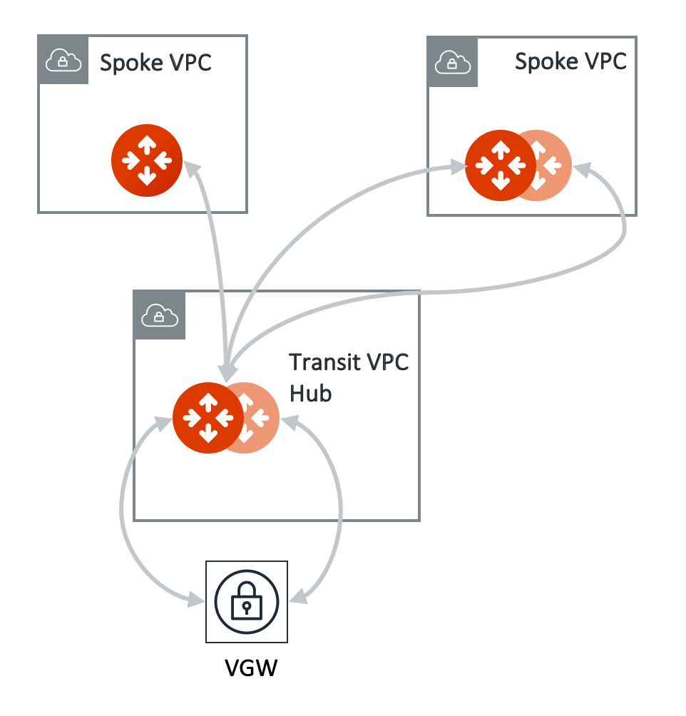

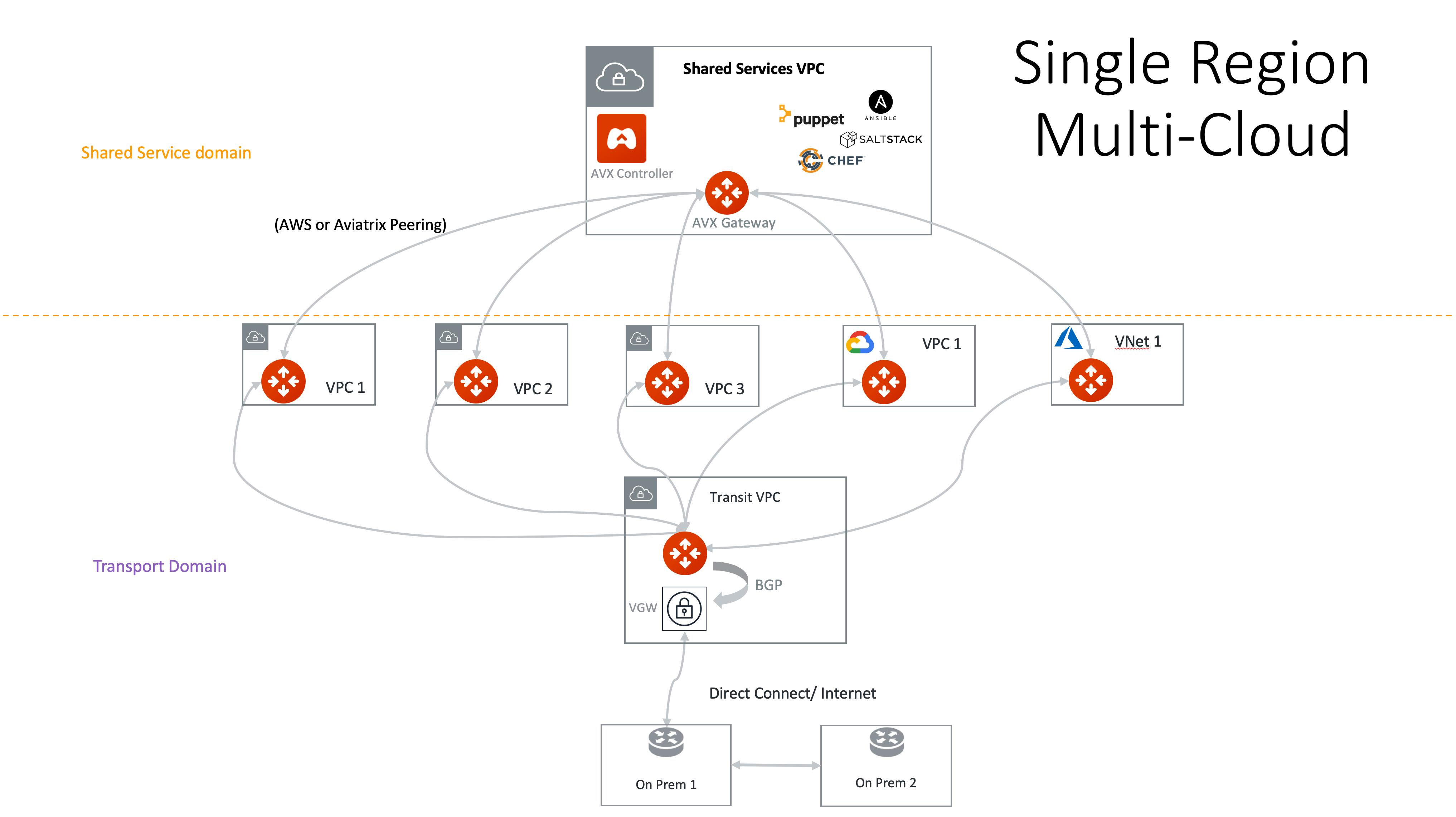

This document provides instructions to build a hub-and-spoke network model across multiple clouds in a single-region with Aviatrix Spoke and Transit Gateways.
The hub-and-spoke model consists of an Aviatrix Transit Gateway and a set of Spoke Gateways, as shown in the diagram below. The network traffic flows between the Spoke VPCs through the Transit VPC.

Identify a VPC or VNet in a region where you want to launch the Transit Gateway, and name it Transit VPC or VNet.
We recommend using the Aviatrix Create a VPC tool with the option Transit + FireNet to create a Transit VPC/VNet that has all the necessary subnets and route tables fully populated. For a Transit network in AWS, see Prerequisites for a Transit Network in AWS.
Create a VGW or reuse an existing VGW.
The VGW should not be attached to the Transit VPC or VNet if you plan to launch Transit Gateway in the same VPC or VNet. This VGW can be attached to a different VPC or VNet if this VPC or VNet CIDR is different from the Transit VPC or VNet where the Transit Gateway is launched or in a different region and account. This VGW should be connected to on-premises either over Direct Connect or over the Internet.

While the instructions below reference AWS, the workflow applies to any public cloud in which Aviatrix Transit Network is supported.
Follow these steps to build a single-region multicloud Transit Network:
