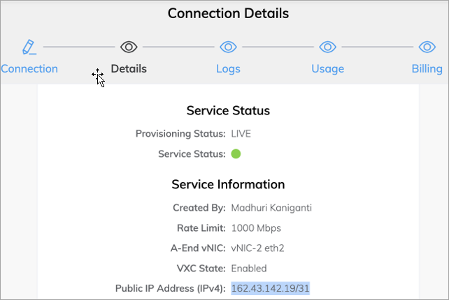

Locate the public IP assigned by Megaport after Internet VXC is attached to the Aviatrix Edge Gateway eth2 interface.

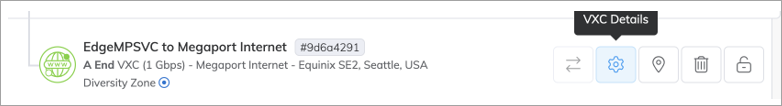

From Megaport Portal, go to Internet VXC attached to the Edge Gateway.
Click on the VXC Details and note down the public IP address (IPV4).

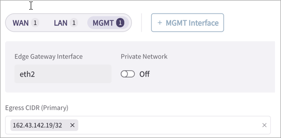

In Aviatrix CoPilot, navigate to Cloud Fabric > Edge > Gateways tab.
In the table, locate the Edge Gateway and click its Edit icon on the right.
In the Edit Edge Gateway dialog box, scroll to Interface Configuration section, and click MGMT.
Update the Egress CIDR with the Public IP of the Edge Gateway VM from the Megaport VXC Details. Use public IP/32 format, for example 162.43.142.19/32.
Click Save.
