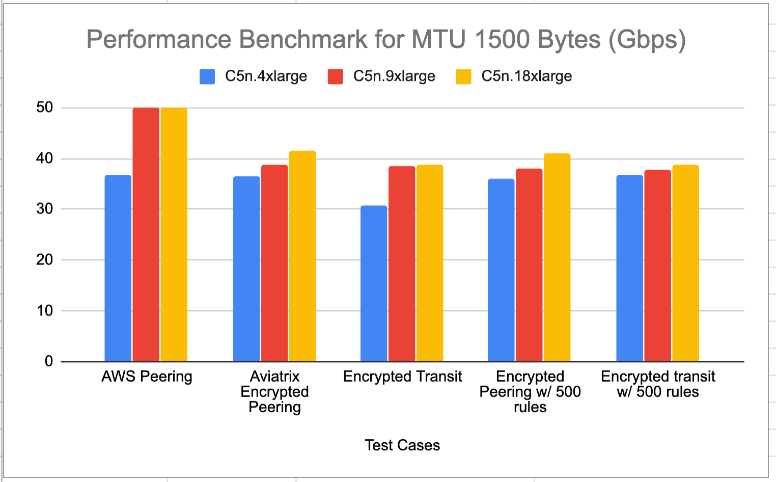

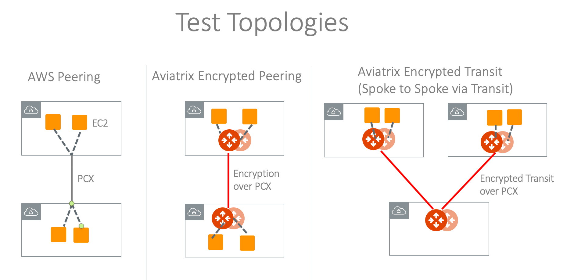

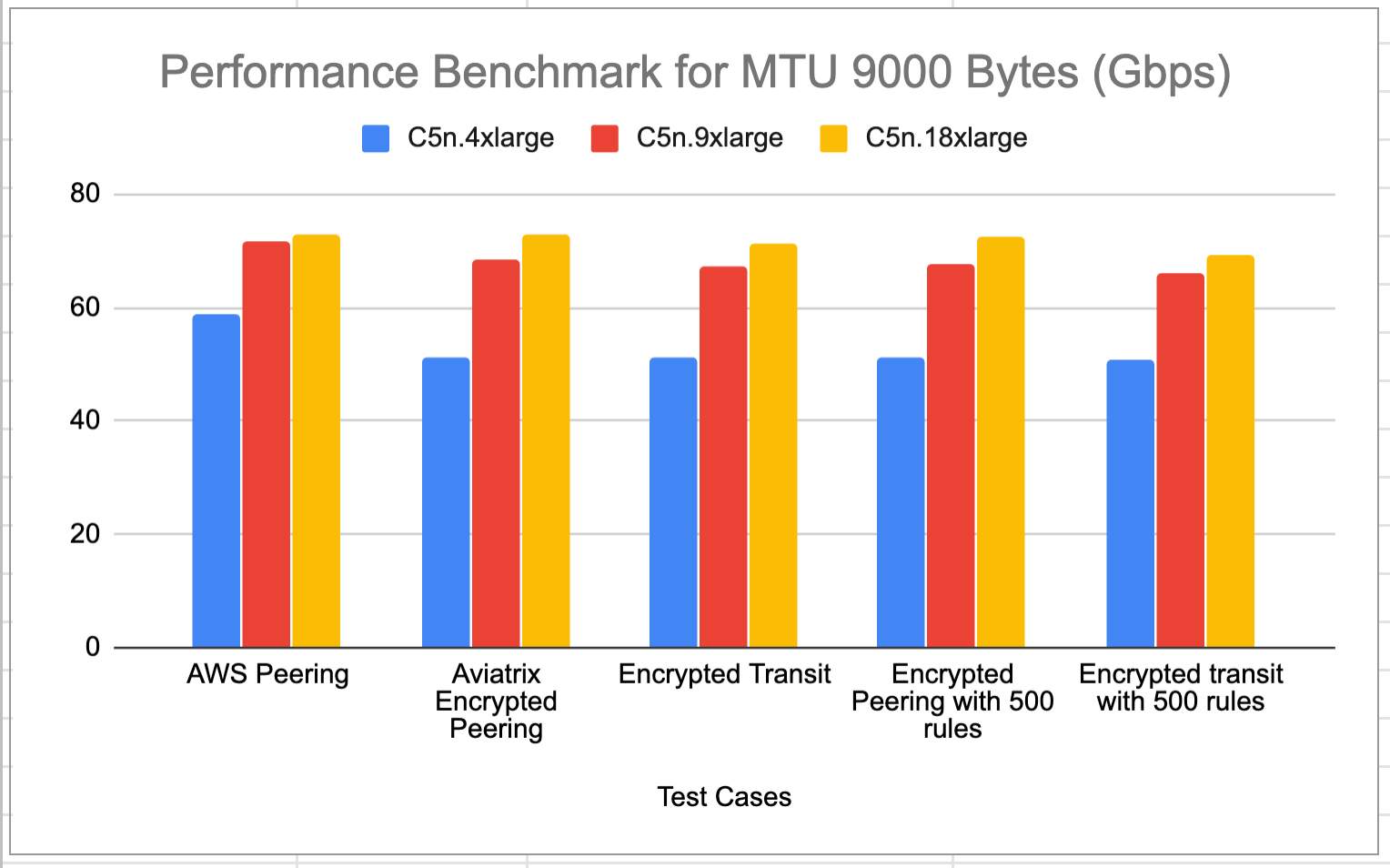

Aviatrix ActiveMesh HPE achieves line rate performance with encryption in AWS when Jumbo Frames are deployed (the default setting for AWS instances). The test benchmark baseline is the native AWS peering where no Aviatrix Gateways are deployed in the VPCs. Adding 500 stateful firewall rules have little impact to the performance. The test topologies are shown below. test_topologies The test is conducted by using iperf3 tool with TCP 128 streams. The two VPCs are in the same region.
MTU = 9000 Bytes (AWS default setting)
jumbo
MTU = 1500 Bytes

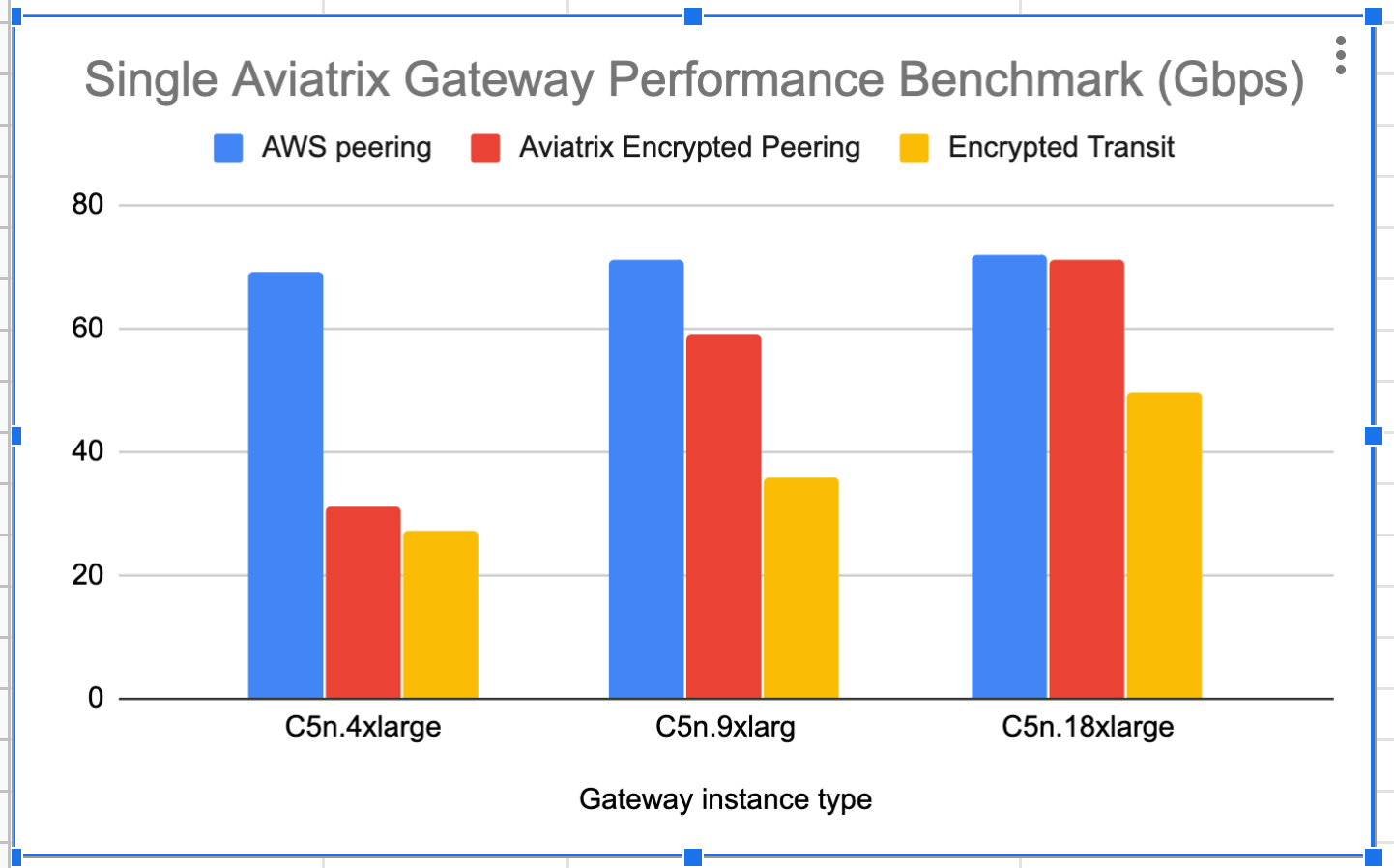

Single Gateway in AWS Performance Test Results

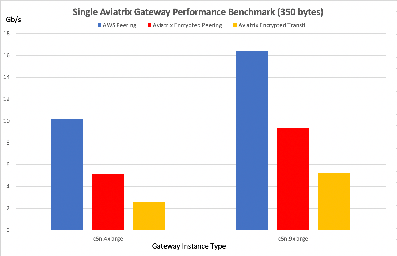

This test is done without HA enabled in either Spoke or Transit Gateways. The traffic is end-to-end from user instance > Spoke Gateway > Multi-Cloud Transit Gateway > Spoke Gateway> Instance. For MTU = 9000 Bytes, the result is shown in the diagram below. single_gateway_jumbo For MTU = 350 Bytes, the result is shown in the diagram below. single_gateway_350B

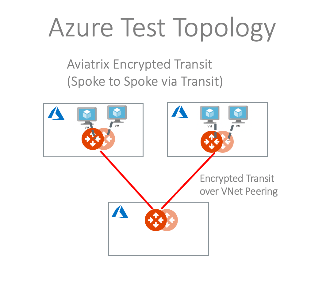

The performance results below are from tests conducted with the topology of Test VMs > Spoke > Transit > Spoke > Test VMs in the same region with active-mesh deployment. Test VMs’ route tables are load balanced to point to either primary Spoke Gateways or HA Spoke Gateways to take advantage of the active-mesh deployment. The test topology is shown below. azure_test_topology

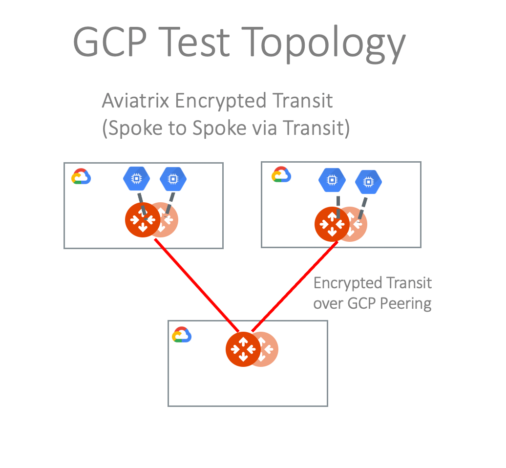

The test topology is shown below with the following conditions:
  • VM - Spoke - Transit - Spoke - VM
  • HA enabled
  • HPE mode enabled
gcp_test_topology
