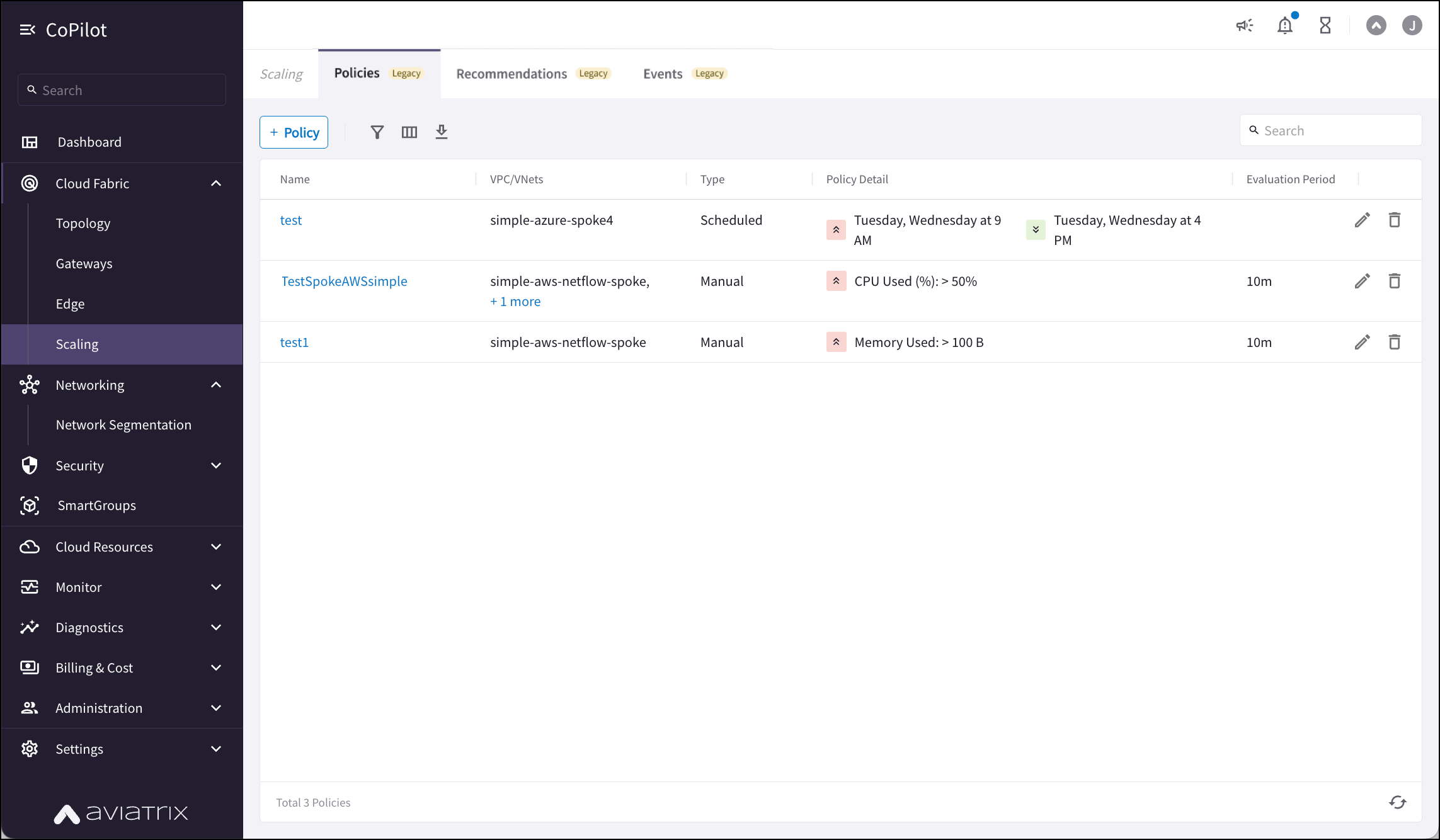

Creating a Policy
The Policies tab is marked as Legacy if you configured Gateway Scaling policies prior to CoPilot 4.15. If you did not configure any Gateway Scaling policies prior to CoPilot 4.15, this tab is not displayed. In CoPilot under Cloud Fabric > Scaling > Policies, you create policies that monitor VPCs/VNets to determine when to generate a recommendation or when gateway scaling should occur. If network architecture is changed after a policy is created (for example, High Performance Encryption is enabled on a VPC that is included in a policy), the scaling event related to the policy may fail. If an error occurs during policy creation or execution you should first check for any network architecture changes. On this tab you can:
  • Create policies
  • Edit policies
  • Filter policies
  • Download the contents of the tab as a CSV
  • Delete policies: click the trash can icon (you are asked to confirm the deletion)
  • View events for selected automatic policies
  • View events or show recommendations for selected manual policies
Policies are never invalidated. scaling policy tab

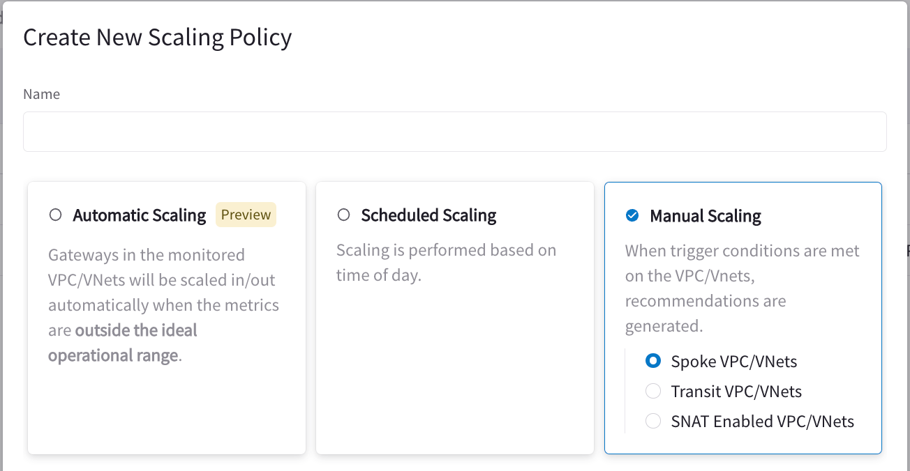

Creating a Manual Scaling Policy
On the Cloud Fabric > Scaling > Policies tab, click +Policy. The Create New Scaling Policy dialog displays. 400 After selecting Manual Scaling, configure the following: Click Save to save the policy and begin monitoring the selected VPCs/VNets.

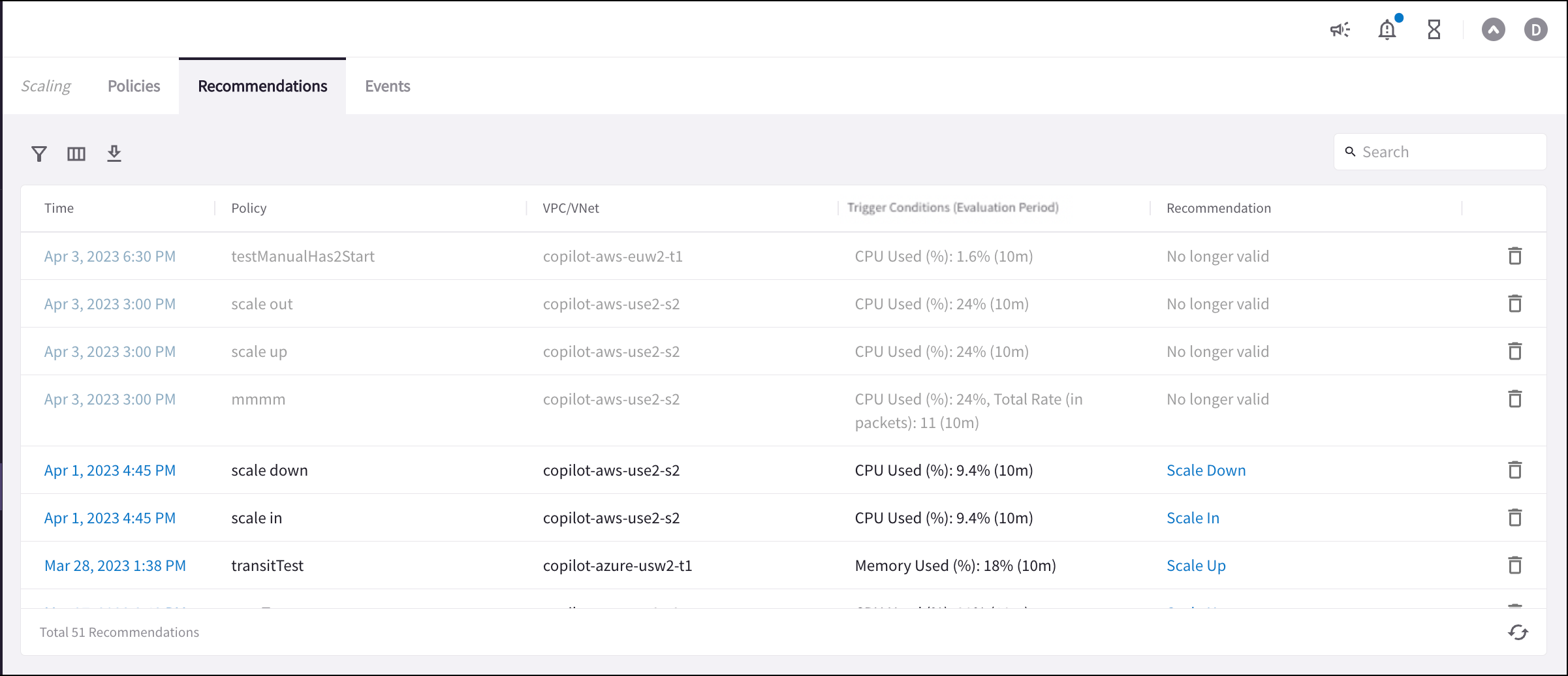

The Recommendations tabs is marked as Legacy if you configured Gateway Scaling policies prior to CoPilot 4.15. If you did not configure any Gateway Scaling policies prior to CoPilot 4.15, this tab is not displayed. After receiving a notification email indicating that trigger conditions have been met and sustained for the configured Evaluation Period (if you entered this information when creating the policy), you can choose to implement the manual scaling recommendation. A recommendation is generated per VPC/VNet rather than per policy. On the Cloud Fabric > Scaling > Recommendations tab, you can choose to scale up or down (Transit VPCs), or up/down in/out (Spoke VPCs) depending on the Operation you selected when creating the related policy. After the recommendation has executed it is removed from the Recommendations list and is displayed as an event on the Scaling > Events tab. scaling recommendation Clicking a recommendation in the Time field for a policy on the Recommendation tab shows the policy details and the performance of the metrics that have been triggered over the selected time period. After viewing this historical detail you can decide if you want to apply the recommendation. A recommendation is not valid when it falls outside of the triggered conditions. A recommendation can become valid again if it once again falls in the triggered conditional range, and there is at least one VPC remaining in the manual policy. If the VPC is removed from the policy it will not trigger again. To implement a recommendation:

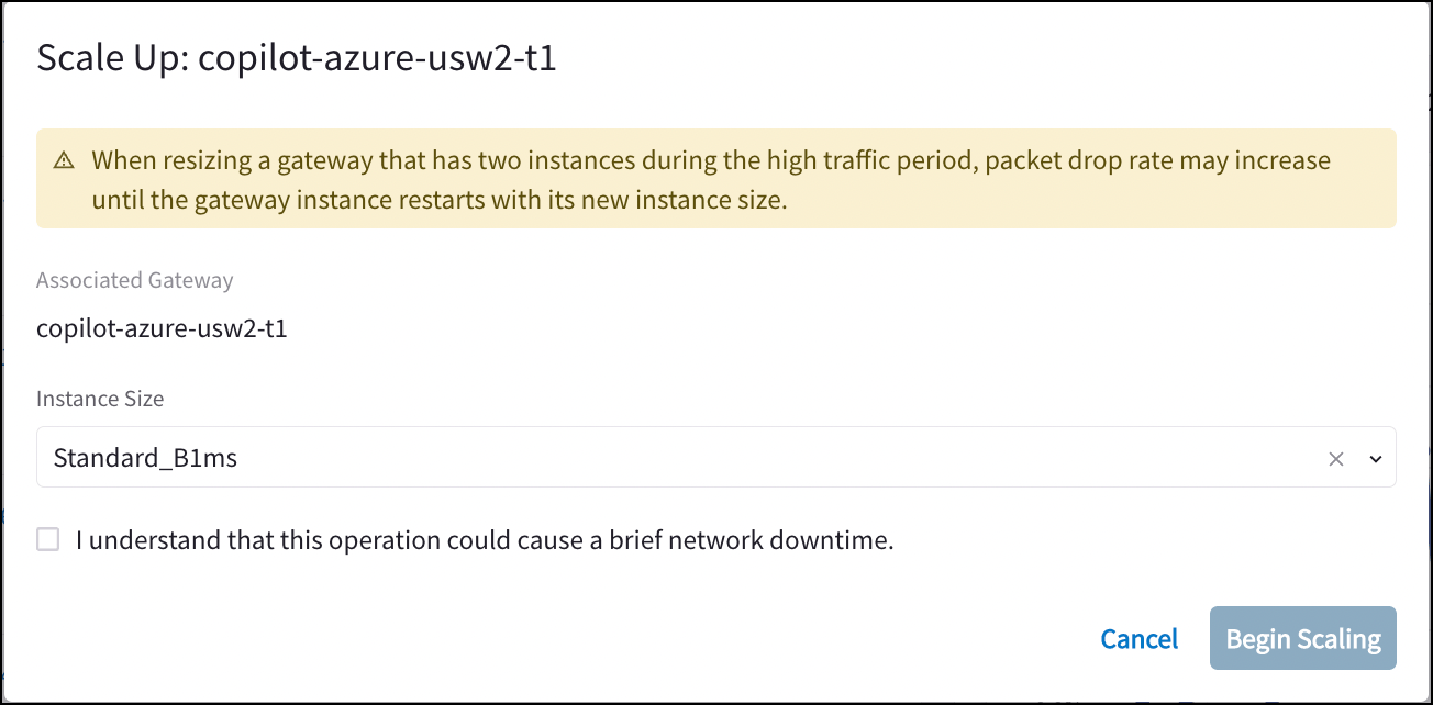

  1. Click Scale Up, Scale Down, or Scale In next to a recommendation in the list.
  2. If you scale up or down by increasing or decreasing current gateway size:
    • Select the new instance size.
    scaling manual instance size
    • Acknowledge that this operation could cause a brief network downtime.
    • Click Begin Scaling.

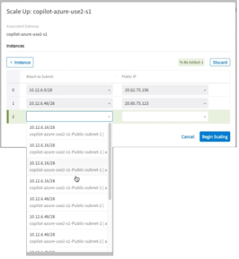

  3. If you scale in or out by adding or removing instances: Scale Up:
    • Click +Instance.
    • Select an available subnet.
    • Select an existing IP, or allocate a new IP to the instance.
    scaling instance Scale Down:
    • Click the Delete icon next to the instance to delete (at least one row must remain).
You cannot add an instance if no subnet is available in that VPC/VNet.
After scaling has occurred:
  • a message displays on the Scaling > Recommendations tab indicating this, and that the VPC/VNet that triggered the recommendation has been removed from the policy.
  • The related recommendation is removed from the Recommendations list.
  • An event is generated and added to the Events page.

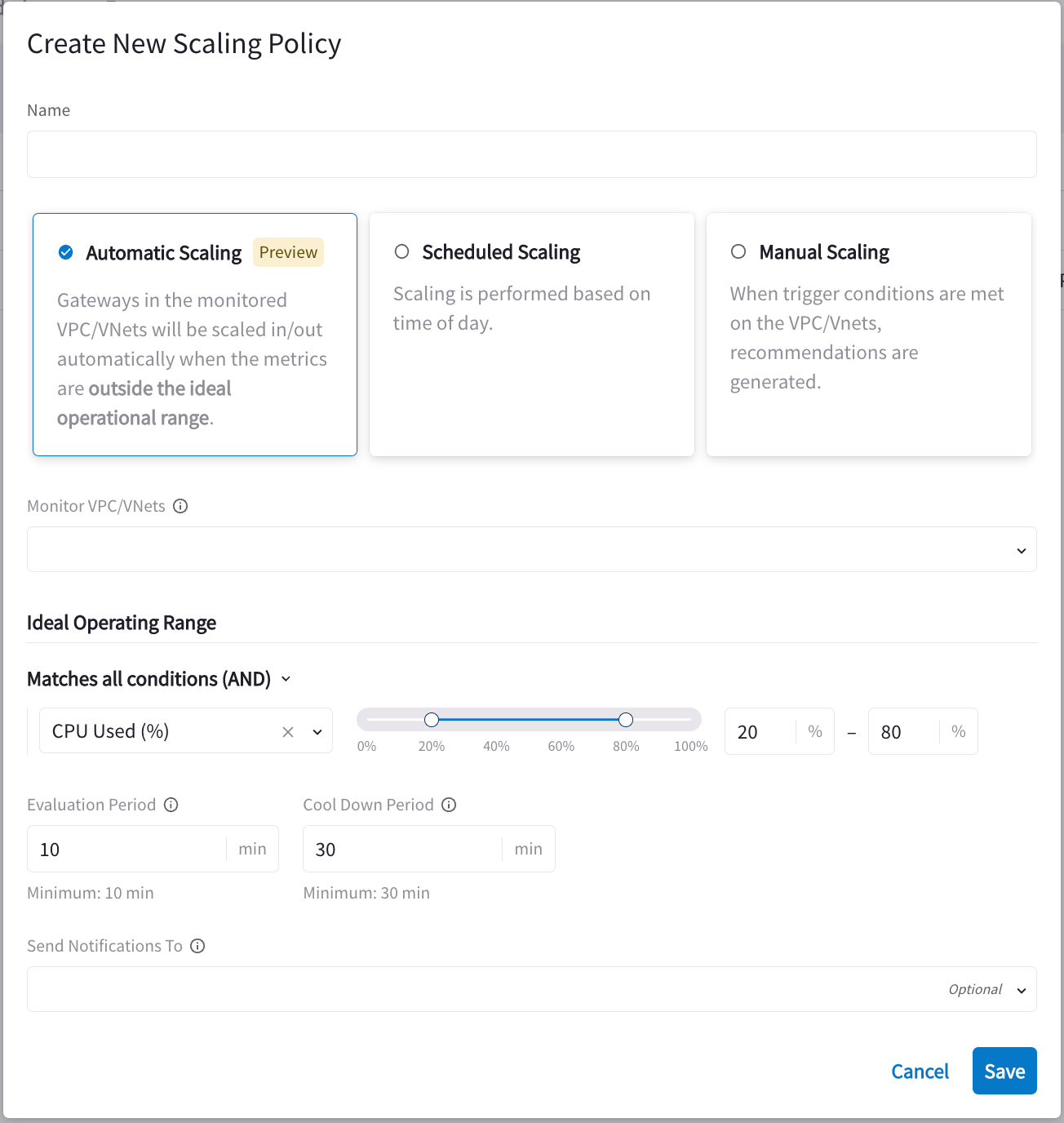

Creating an Automatic Scaling Policy
When you apply automatic scaling, gateways are added and removed to handle system load. If system load is within the ideal operating range, the number of gateways will not change. If system load is lower than the ideal operating range, scaling down will only commence if the number of existing gateways is greater than your base (starting) number of gateways. If your base (starting) number of gateways has already been reached, no action is taken. Aviatrix recommends applying one automatic scaling policy per VPC/VNet.
VPCs/VNets cannot have both automatic and scheduled scaling applied.
To create an automatic scaling policy: On the Cloud Fabric > Scaling > Policies tab, click +Policy. The Create New Scaling Policy dialog displays. 640 After selecting Automatic Scaling, configure the following: Click Save. After automatic scaling is performed on a VPC/VNet that VPC/VNet is removed from the policy. Only a gateway that has been added using automatic scaling can be removed using automatic scaling. User-created gateways are not removed by automatic scaling. If two metrics configured in your automatic scaling policy give contradictory recommendations, the policy defaults to scaling Up or Out - in other words, increasing gateway number or size. For example, if the CPU Used metric states that the scaling event should scale out, but the Memory Use metric stated that the policy should scale in, the policy defaults to scaling out.

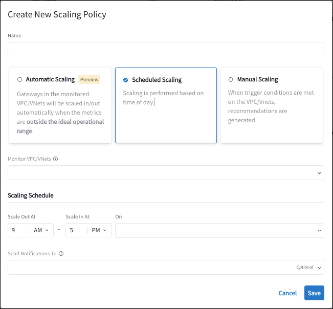

Creating a Scheduled Scaling Policy
You can create a scheduled scaling policy to add a gateway instance during a scheduled time period, and remove it when the scheduled time period ends. The gateway instance is created in the first available empty subnet. Gateways can only be removed if they were previously added using gateway scaling.
Scheduled scaling occurs in the local time zone in which the browser is deployed. For example, if the scheduled scaling event is set to begin at 9 am, it begins at 9 am according to the local browser time zone.
On the Cloud Fabric > Scaling > Policies tab, click +Policy. The Create New Scaling Policy dialog displays. 500 After selecting Scheduled Scaling, configure the following: Click Save. Select Scheduled Scaling. Under Scaling Schedule, select a time to begin scaling out, and a time to begin scaling in. Select the days when this scheduled scaling will be performed. In the Send Notifications To field, select the email address or webhook which should receive the notification when the scaling begins and ends. If this field is left blank you will not receive alerts.

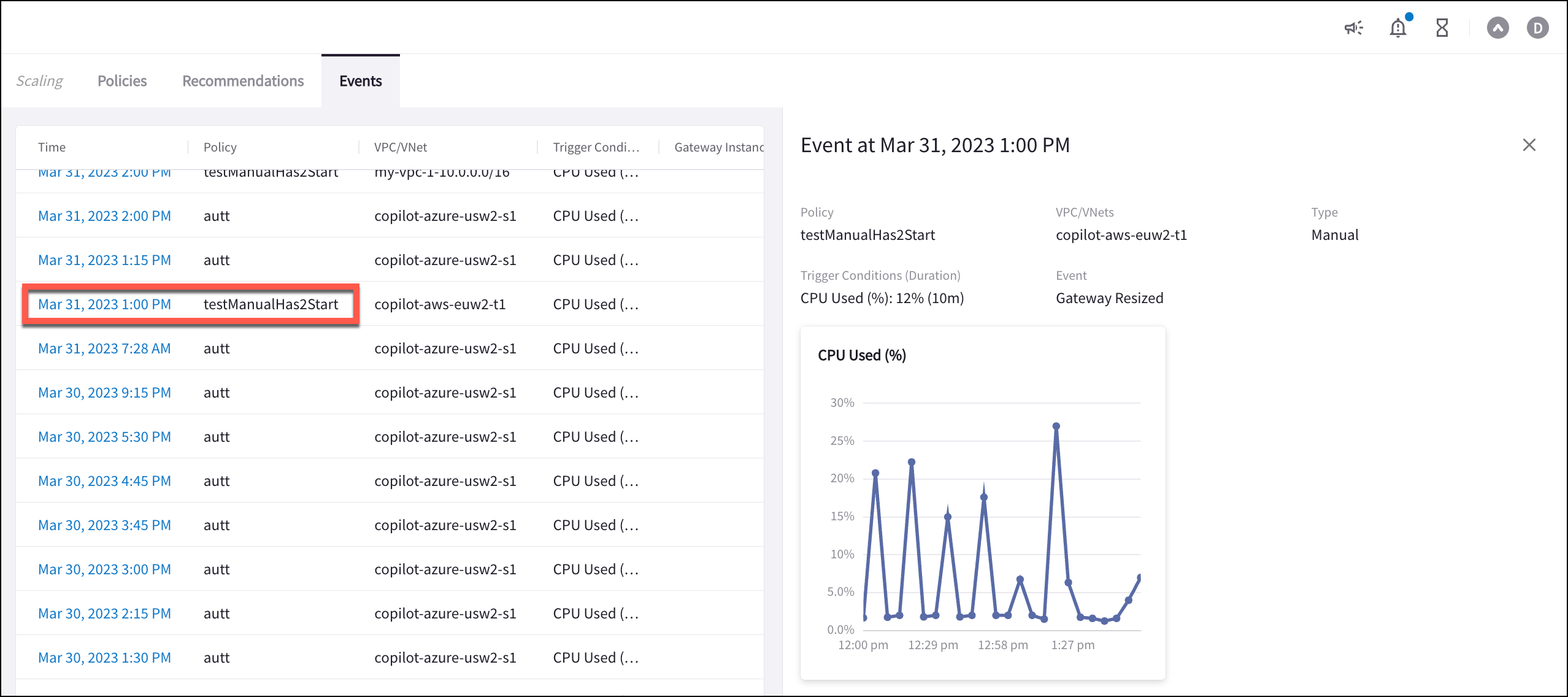

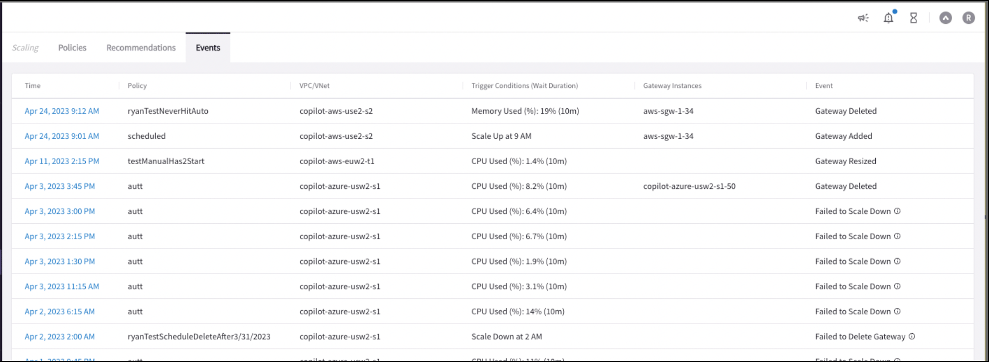

Viewing the Events Tab
The Events tab is marked as Legacy if you configured Gateway Scaling policies prior to CoPilot 4.15. If you did not configure any Gateway Scaling policies prior to CoPilot 4.15, this tab is not displayed. The Events tab lists when auto or manual scaling events occurred, and if the action related to the event succeeded or failed. gateway scaling events The Events tab shows the following information:
  • Time of the event
  • Policy name
  • VPC/VNet name
  • Trigger Conditions (Evaluation Period)
  • Gateway Instances
  • Event name
Clicking an event time in the list shows Trigger Condition details and if the policy type is Manual or Automatic. gateway scaling events details
