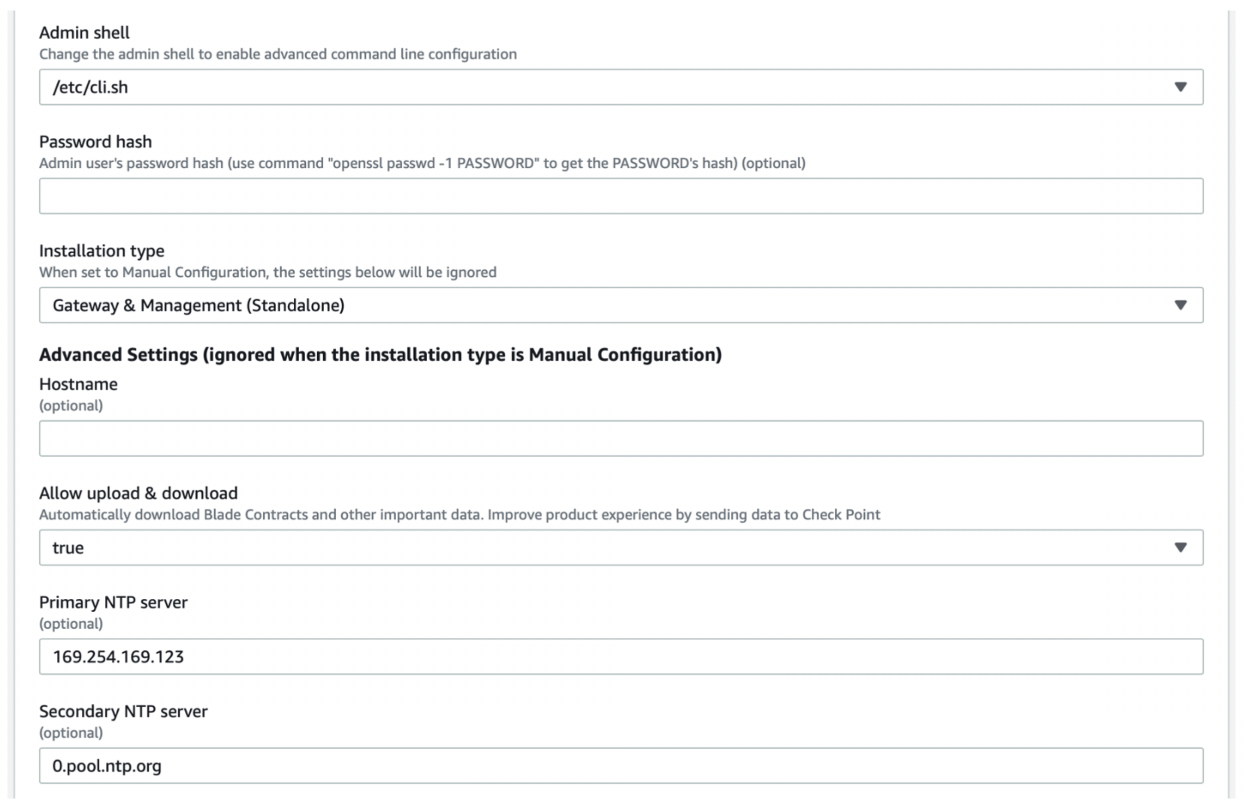

- For the purpose of this installation guide, we are going to consider only version R80.10 in standalone mode using the latest CloudFormation template available at the time this document was written.

After you have prepared your FireNet VPCs and added the necessary Transit FireNet gateways, you can prepare your Check Point firewall as follows.Deploying Check Point Instance From AWS Marketplace

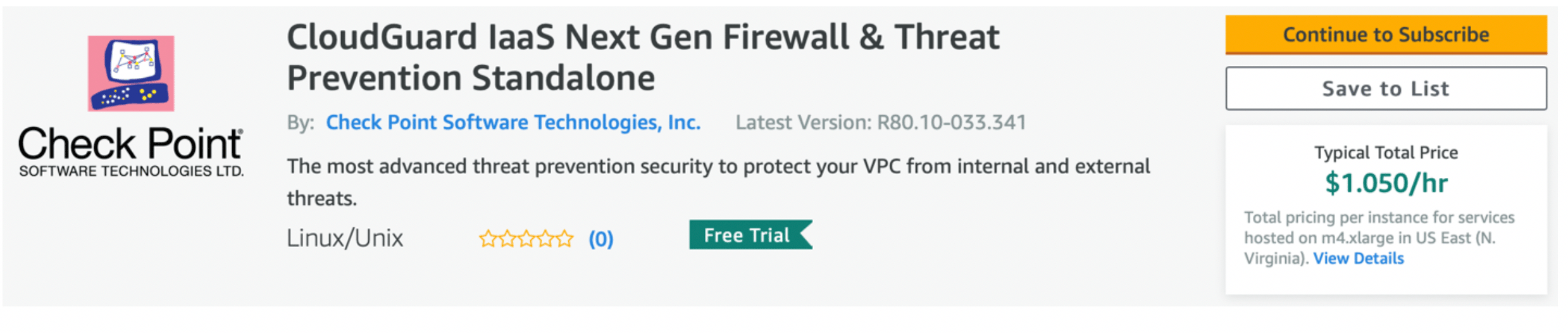

Go to aws.amazon.com/marketplace and search for the chosen instance model/version in AWS Marketplace. Click Continue to Subscribe.

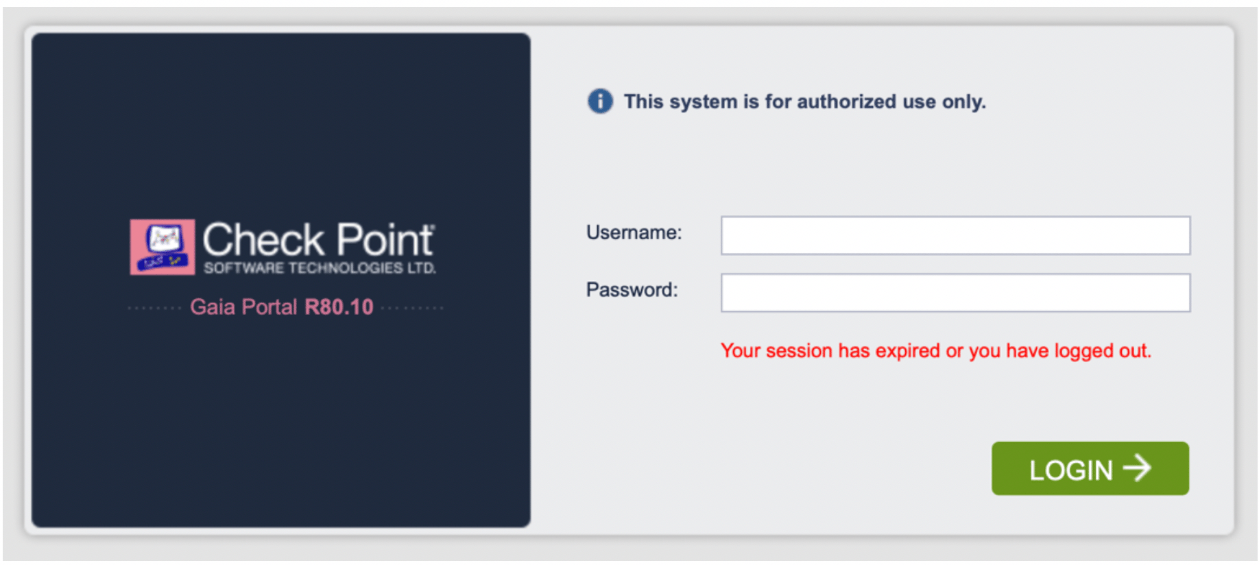

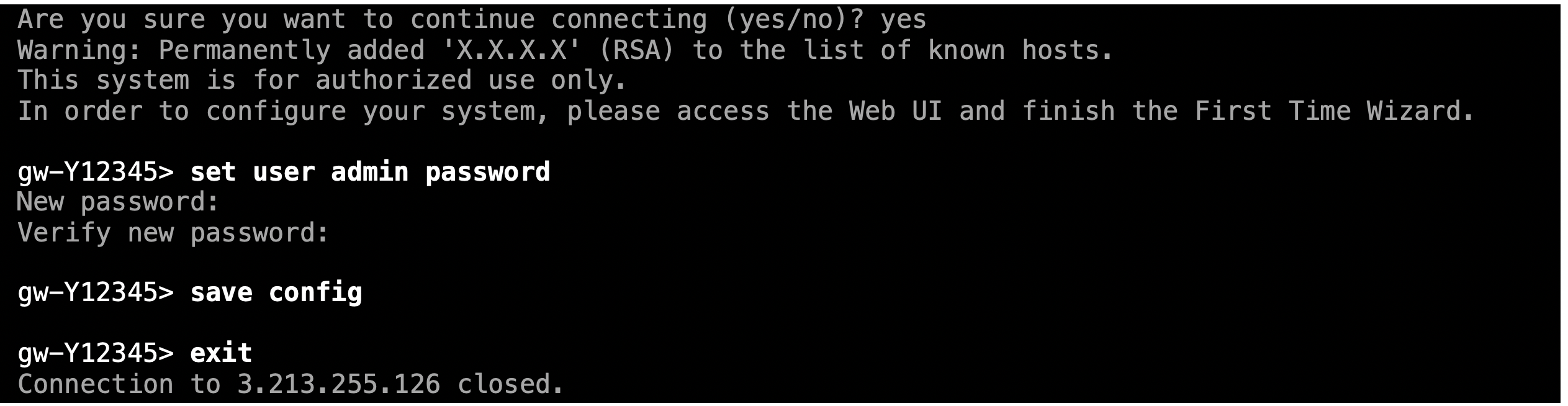

Open a browser and go to https://management_eip/ to log into the Gaia Portal. You should be prompted with a screen like the one below. Enter the user name as admin and the password you configured in the previous step.

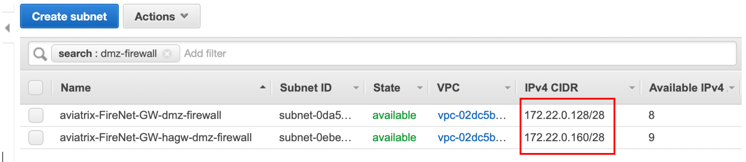

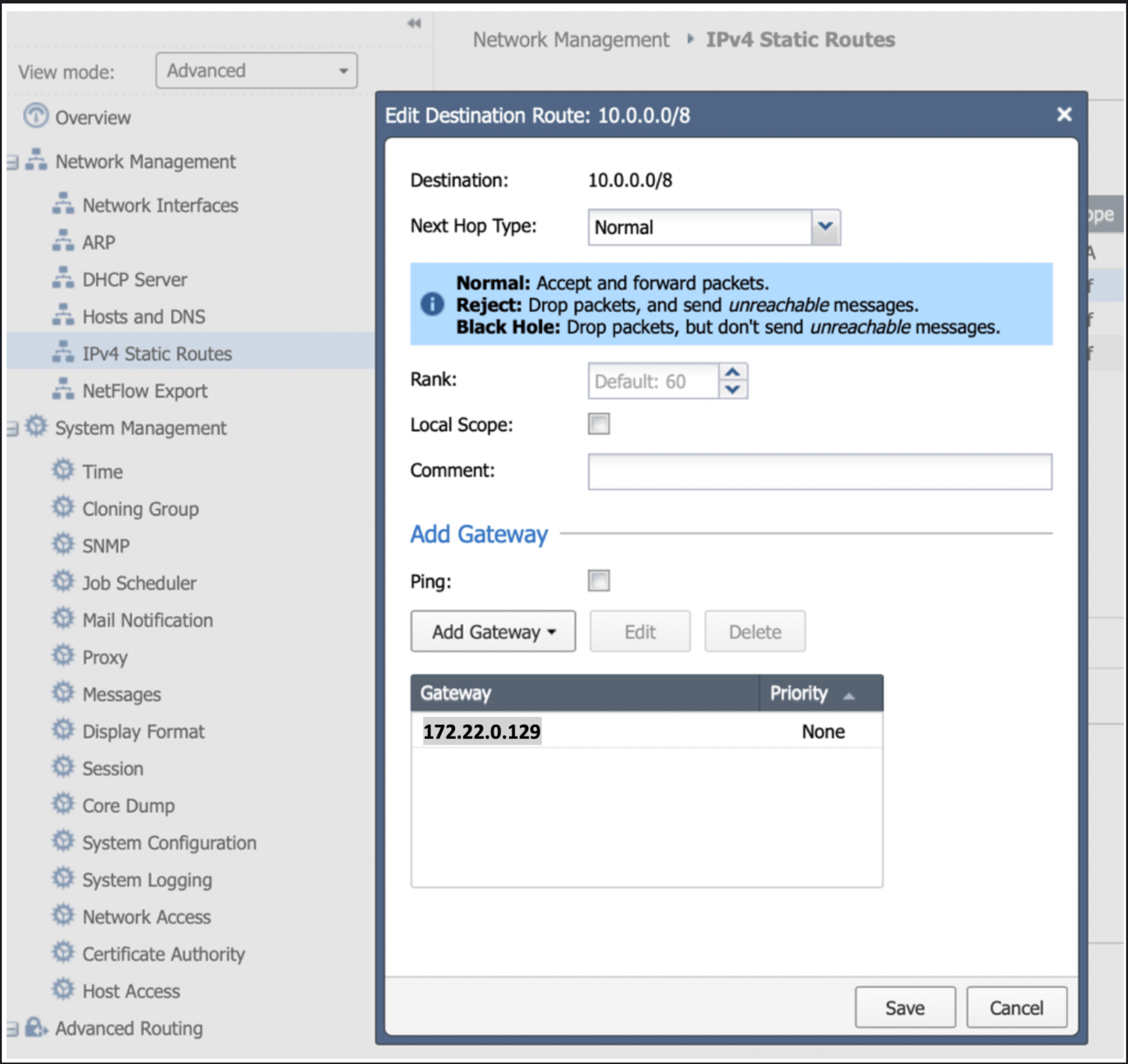

The next step is to update the route table. In this example, you add three return routes, each for a RFC 1918 address pointing back to the VPC router of the subnet aviatrixdmz-firewall (or aviatrixhagw-dmz-firewall if you are attaching the instance to the backup gateway instead). Go to the AWS console > VPC > Subnets and filter by “dmz-firewall” – that will allow you to determine the VPC router IP, which is the first host of each subnet.

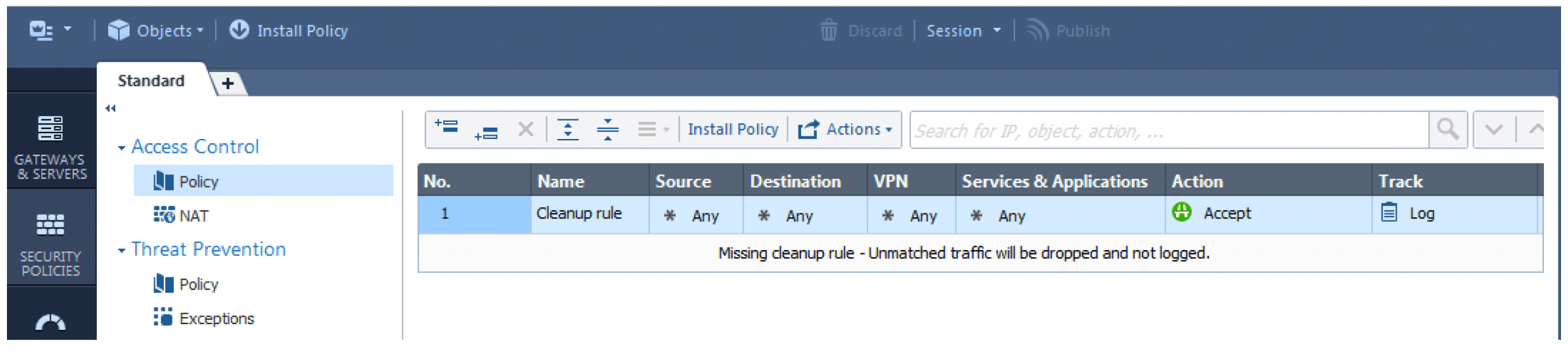

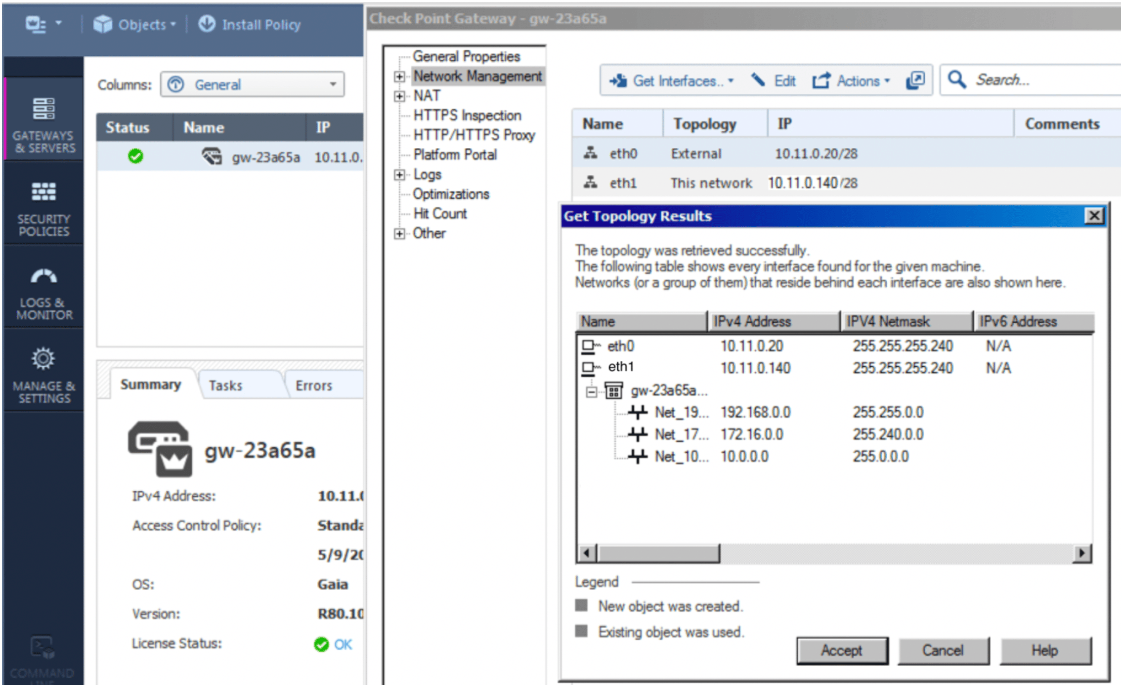

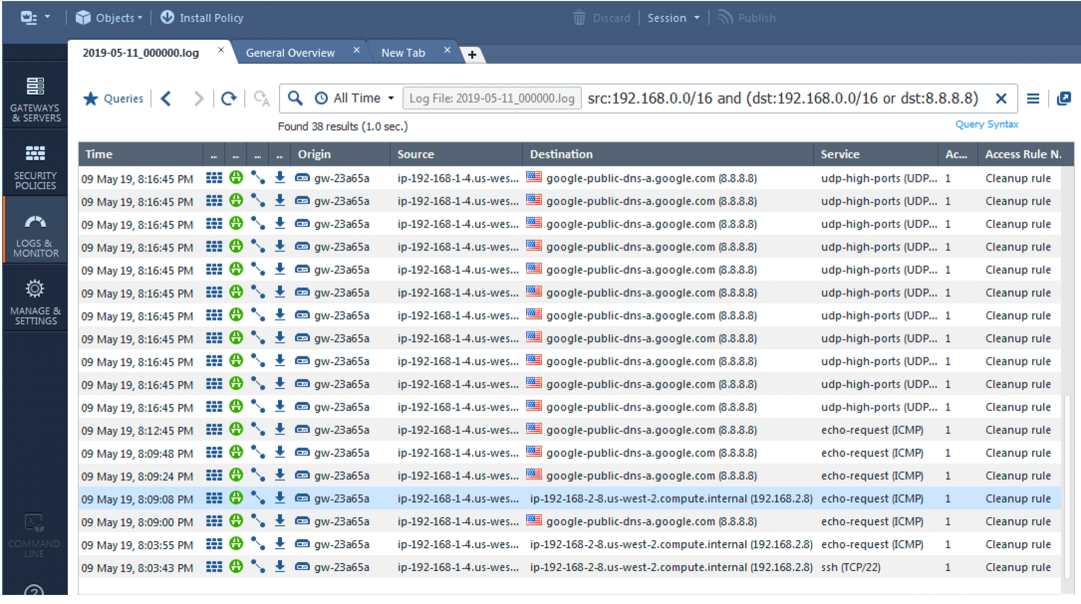

Download and install the SmartConsole (if you have not done so already) using this link: R80.10. On SmartConsole you need to define a security policy that will allow the traffic to be inspected/logged and update the topology. In the SmartConsole go to via Security Policies and then Policy and change the default policy to accept and log traffic. This should be customized to comply with your project requirements. Install the policy on the gateway(s) in question. Your basic policy should look like this:
