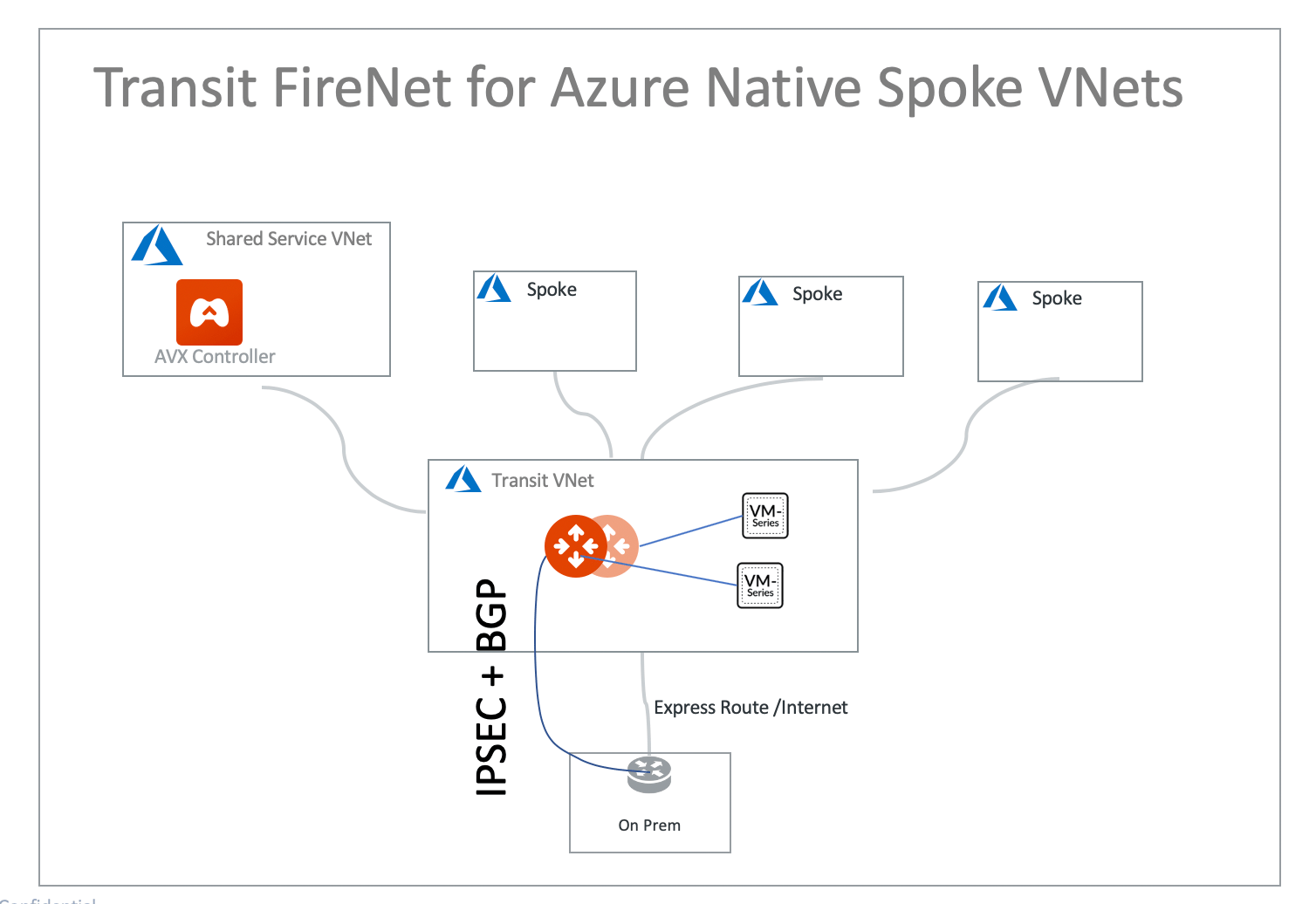

This document illustrates a simple architecture for Ingress traffic inspection firewall that leverages Azure Load Balancers, Transit FireNet , and Azure Transit with Native Spoke VNets . The solution also allows you to view the client IP address. The deployment is shown in the below diagram. Azure Ingress Firewall Setup Diagram The key idea is that from a FireNet point of view, the ingress inspection is simply a VNet-to-VNet traffic inspection. This is accomplished by:
  1. Placing an Internet facing Azure Application Gateway in a Spoke VNet (in the diagram, this spoke VNet is called Ingress Spoke VNet) to load balance traffic to the VNet where applications reside (Application Spoke VNet).
  2. Managing Spoke Inspection Policies for the Application Spoke VNet traffic that requires inspection with the Aviatrix Transit VNet.
In this unified architecture, firewalls can be used for Ingress, Egress, North-South and VNet-to-VNet filtering. The solution does not need Azure Load Balancers to directly attach to firewall instances which then requires firewall instances to source NAT the incoming traffic from the Internet. Firewall instances can scale out as applications scale for all traffic types.

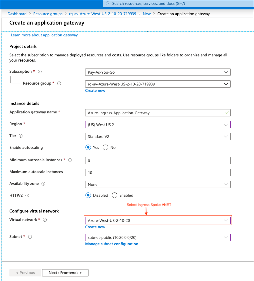

In Ingress Spoke VNET, create an Azure Application Gateway. Make sure you select the following:
  1. Create an Azure Application Gateway in Ingress Spoke VNET. Azure Application Gateway Creation

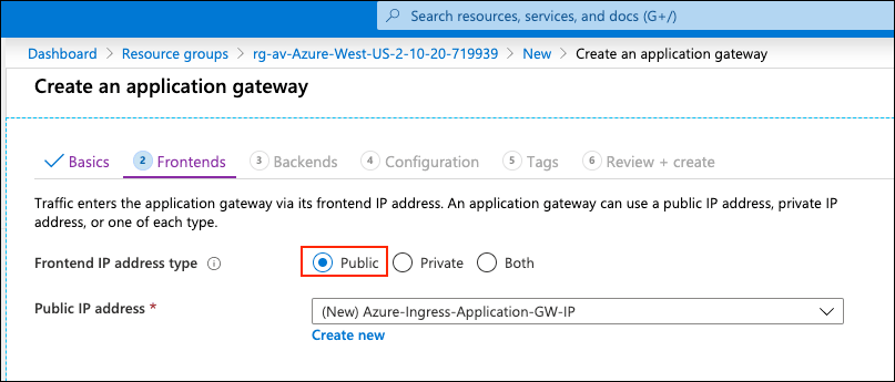

  2. Under Frontends, select Public for the Frontend IP address type. Azure Application Gateway Frontend

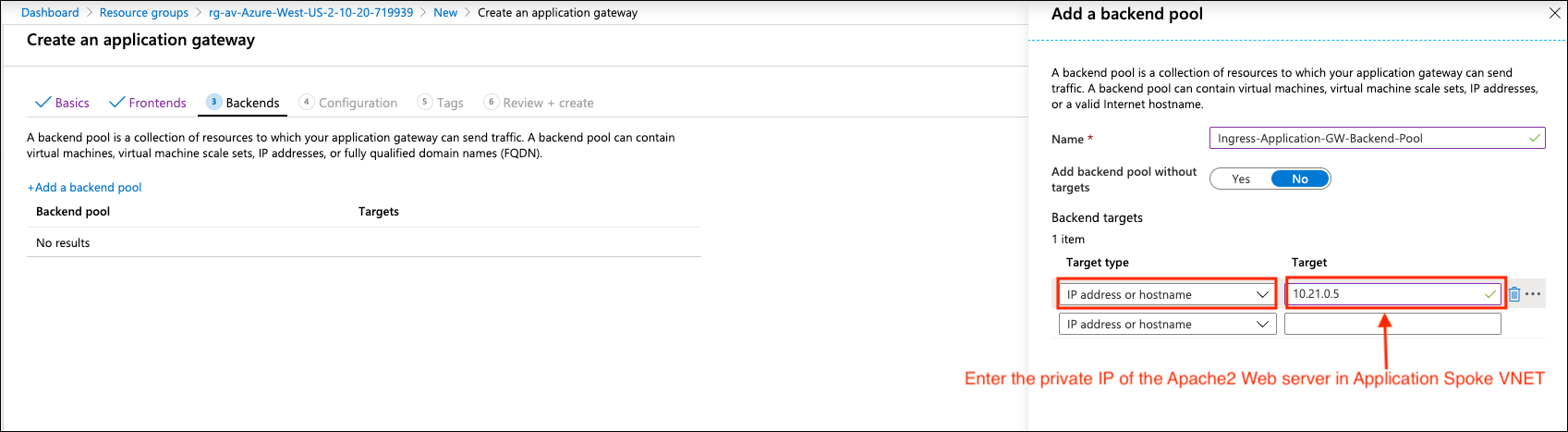

  3. Select IP address or hostname for Target type and configure the private IP of Apache2 Web Server for Target in section Backends. Azure Application Gateway Backend

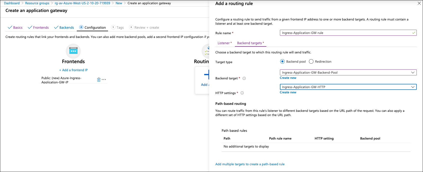

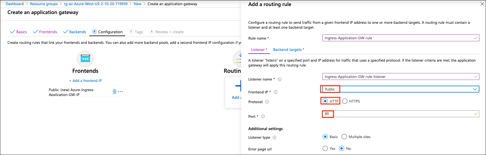

  4. Add a routing rule on the Listener depending on your requirements. Azure Application Gateway Routing Rule Listener

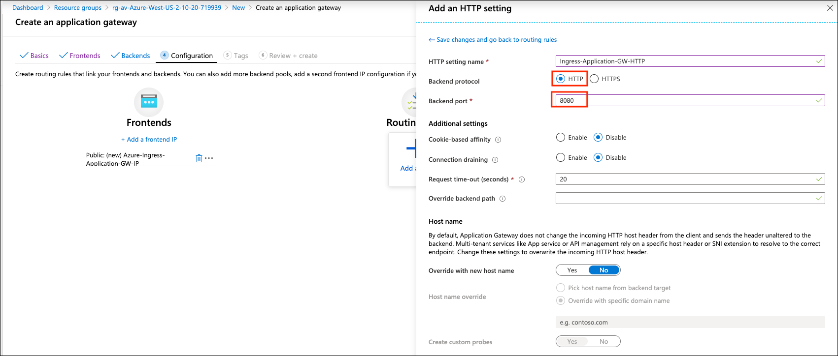

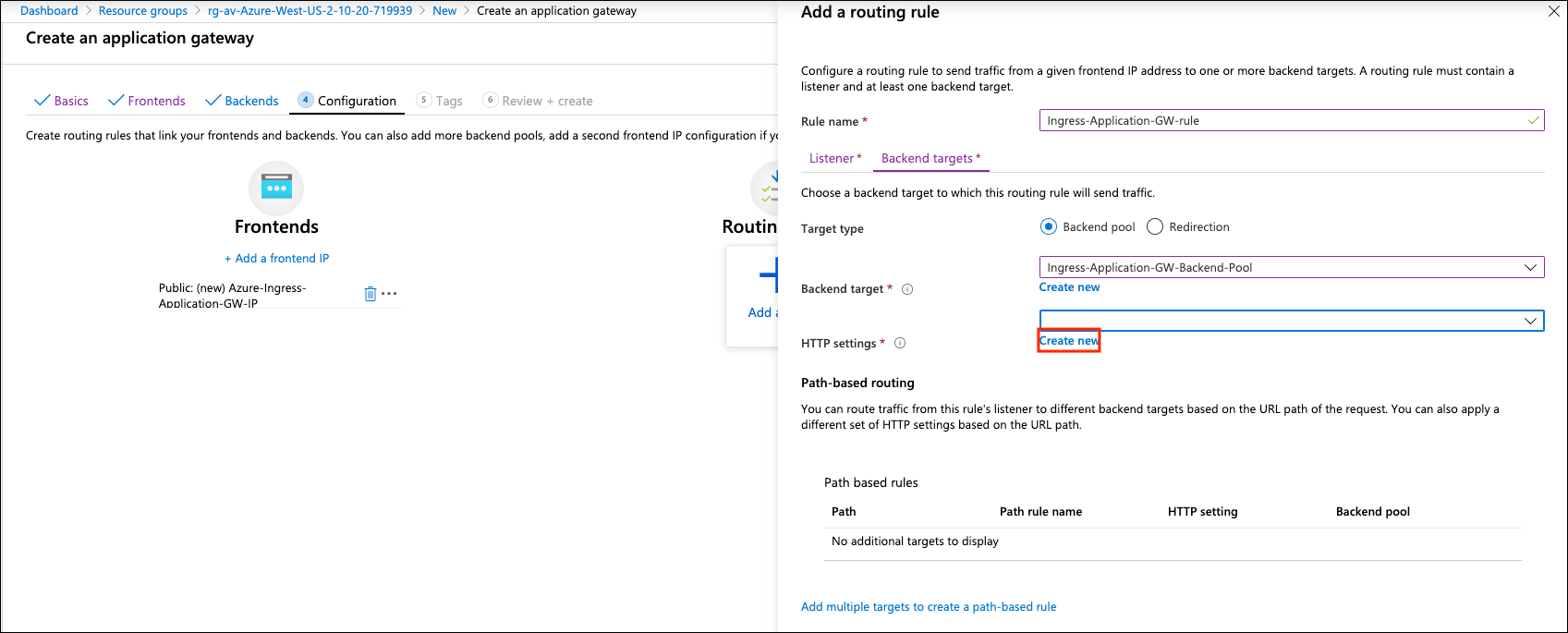

  5. Add a routing rule on Backend targets and create an HTTP setting depending on your requirement. Azure Application Gateway Routing Rule Backend Target
  6. Click Create new on HTTP settings. Azure Application Gateway HTTP Setting Azure Application Gateway Backend Target

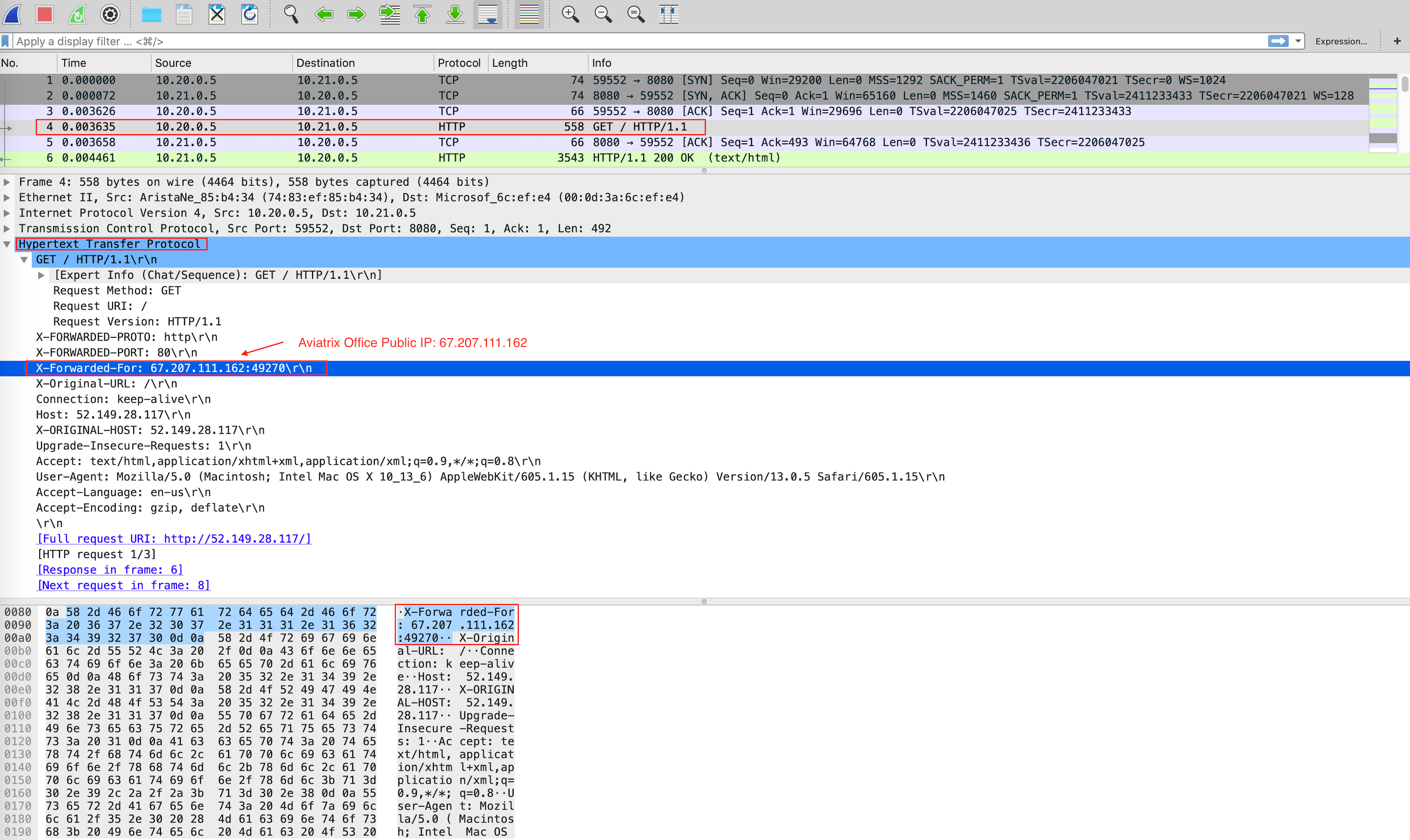

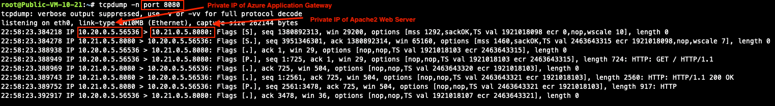

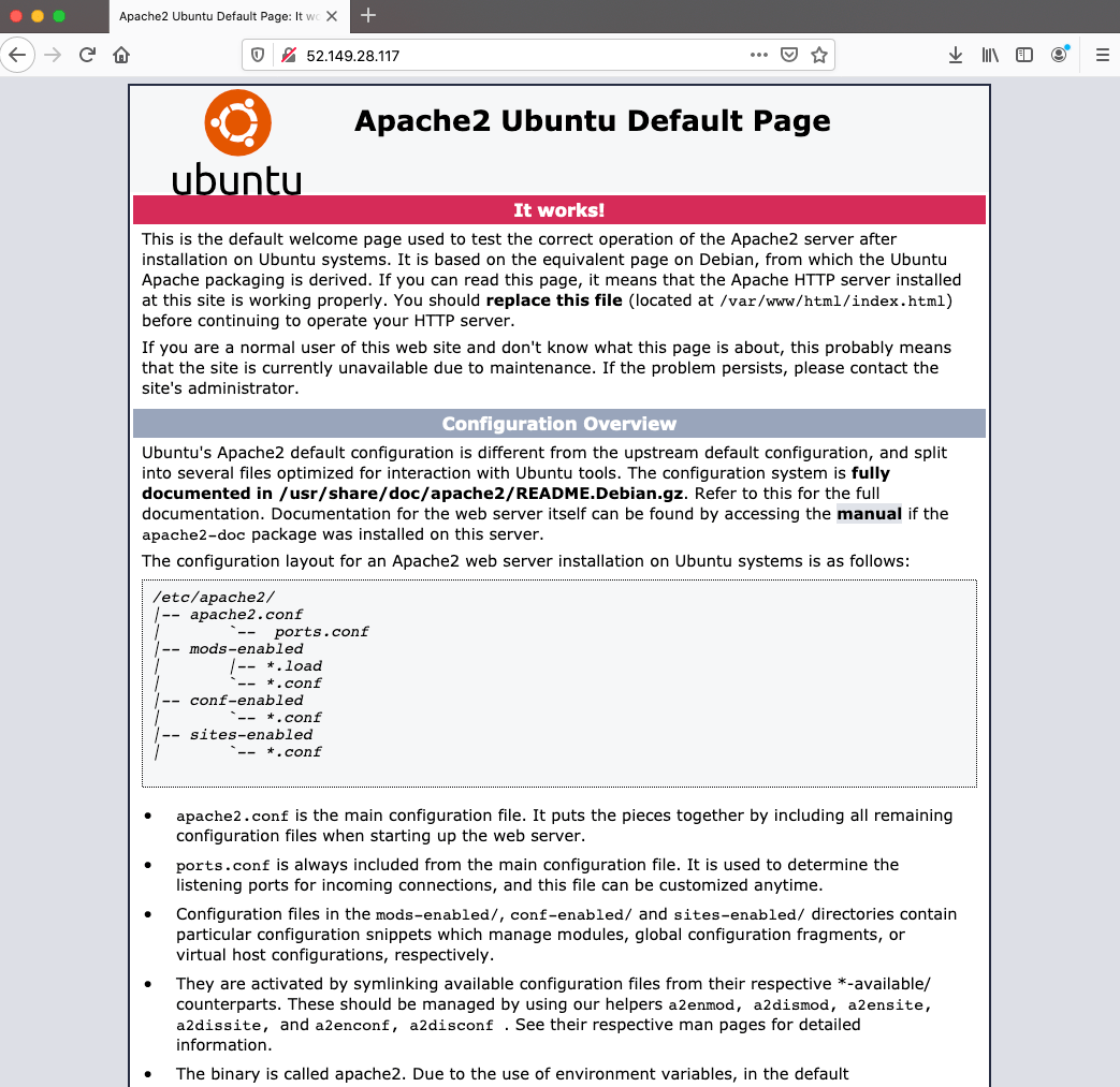

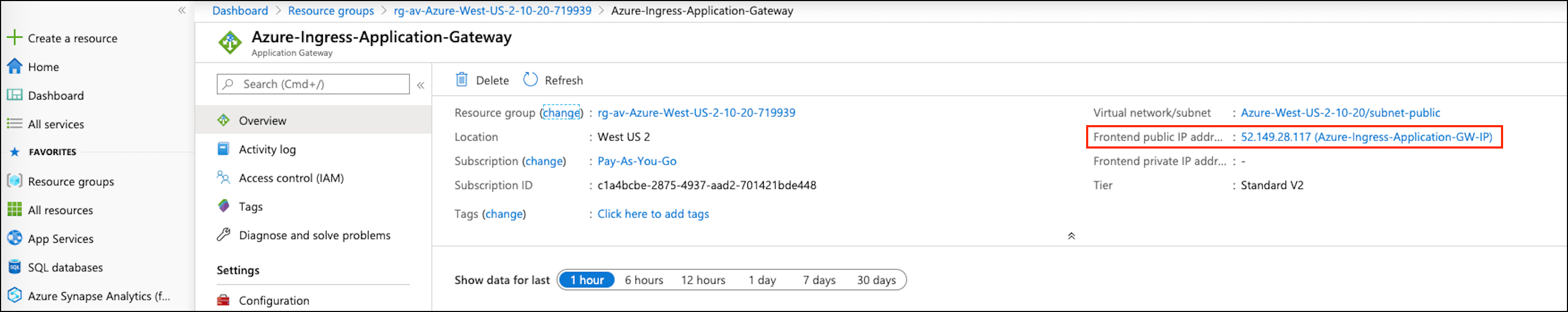

  2. Run a http request targeting the Azure Application Gateway Public IP or DNS name. a. Find the Frontend public IP address of the Azure Application Gateway from the Azure portal page Application Gateway > Overview. Azure Application Gateway Public IP b. Copy the Frontend public IP address of Azure Application Gateway and paste it on a browser from your laptop/PC. Azure Browser c. Perform tcpdump with port 8080 on Apache2 Web server. Azure Server tcpdump Azure Application Gateway automatically preserves client original IP address in the HTTP header field “X-Forwarded-For (XFF)”. Here is an HTTP packet example which is opened with Wireshark tool for your reference: Azure Server Wireshark

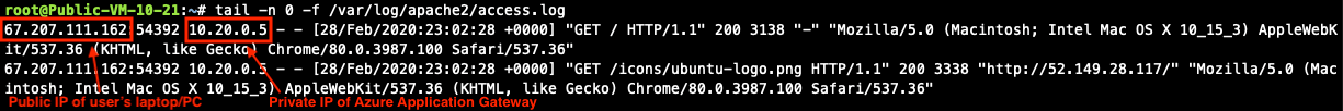

To view the client IP address in the access log, follow the instructions in How to save client IP in access logs.
  1. Find and open Apache configuration file.
  2. In the LogFormat section, add %{X-Forwarded-For}i as follows:
  3. Save your changes.
  4. Reload the Apache service.
  5. Review the public/original client IP on apache2 access log. Azure Server Apache Access Log
