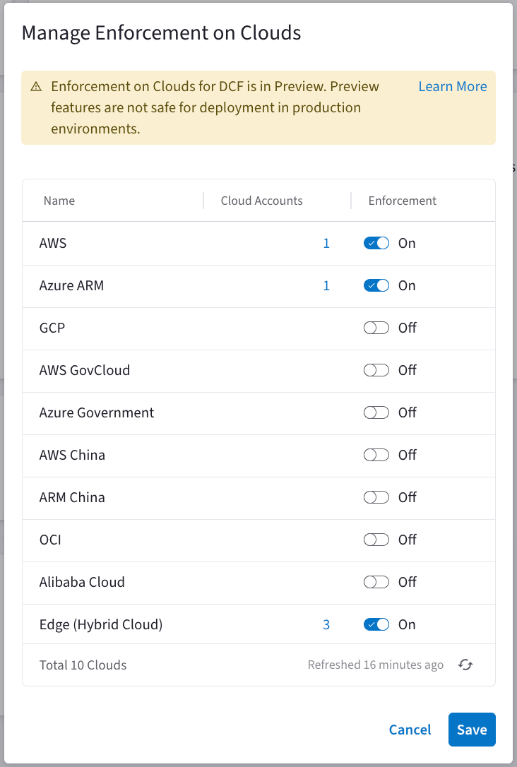

Enforcement on Clouds
If using Controller 8.1, you can control the enforcement of Distributed Cloud Firewall (DCF) rules on various clouds.
If using Controller 8.0 or lower, DCF is enabled by default on these clouds: AWS, AWS GovCloud, Azure, Azure Government, and GCP.
After the DCF feature is enabled, DCF rules are enforced for any clouds that have enforcement turned On.
Managing Enforcement on Clouds
  1. Click Manage on the Manage Enforcement on Clouds card under Security > Distributed Cloud Firewall > Settings to enable or disable enforcement of DCF rules on various clouds. You must have Enforcement turned On for at least one cloud to save your changes.
manage enforcement on clouds
  1. After selecting which clouds will enforce DCF rules, click Save.
  2. If you turn off enforcement for a cloud, you are prompted to select a checkbox confirming that you understand DCF protection will be disabled on that cloud. You then click Disable.

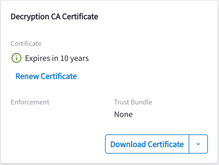

Decryption CA Certificate
This feature described below is available with Controller 7.1.1710 or greater. Aviatrix strongly recommends replacing the default Aviatrix CA certificate with your own CA certificate.If you are using Controller 7.0, you can only download the provided default Aviatrix CA certificate; you cannot replace it with your own CA certificate.The decryption CA certificate (the Aviatrix certificate, or your own) must be distributed to all of your client machines so that signature checks are successful.Decryption CA certificates must be private.
The CA certificate is used when you create a policy that has TLS Decryption enabled. You can:
  • Upload your own certificate
  • Download the Aviatrix CA certificate, if you want to use it
  • Renew the certificate
  • Download the default trust bundle (or upload your own trust bundle)
  • Determine which level of enforcement to apply to CAs that are not signed by a root certificate in the trust bundle
  • Remove a certificate and replace it with a new one

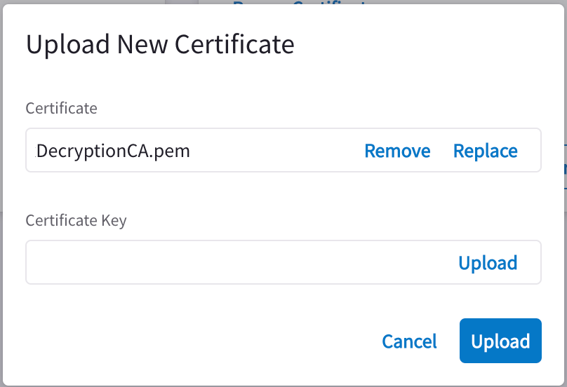

Uploading Your Own Certificate
It is best to upload your own certificate (must be in .pem format), since you likely have this certificate in use throughout your environment. You can remove the default Aviatrix CA certificate first, if desired.
  1. On the Settings tab, on the Decryption CA Certificate card, click the arrow next to Download Certificate and click Upload New Certificate.
  2. In the Upload New Certificate dialog, you can upload, remove or replace a certificate and its corresponding certificate key.
300
  1. Both fields must be populated. Click Upload.
Downloading the Aviatrix Certificate
You can download the currently applied Aviatrix CA certificate and add it to your trust bundle. To download the CA certificate provided by Aviatrix:
  1. Navigate to Security > Distributed Cloud Firewall > Settings.
  2. On the Decryption Trust CA Certificate card, click Download Certificate.
300
  1. Ensure that the downloaded file is saved to the appropriate location on your computer, and any client machines involved in your Distributed Cloud Firewall (DCF) configuration.
Renewing Your Certificate
You must renew your Aviatrix CA certificate when it is about to expire. When you click Renew Certificate, the certificate renews automatically. You can also upload your own CA certificate.
