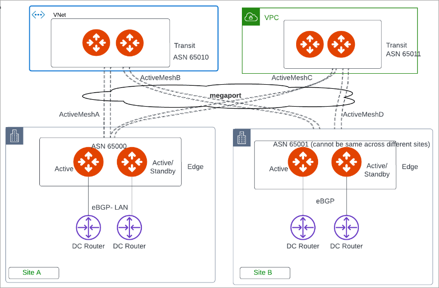

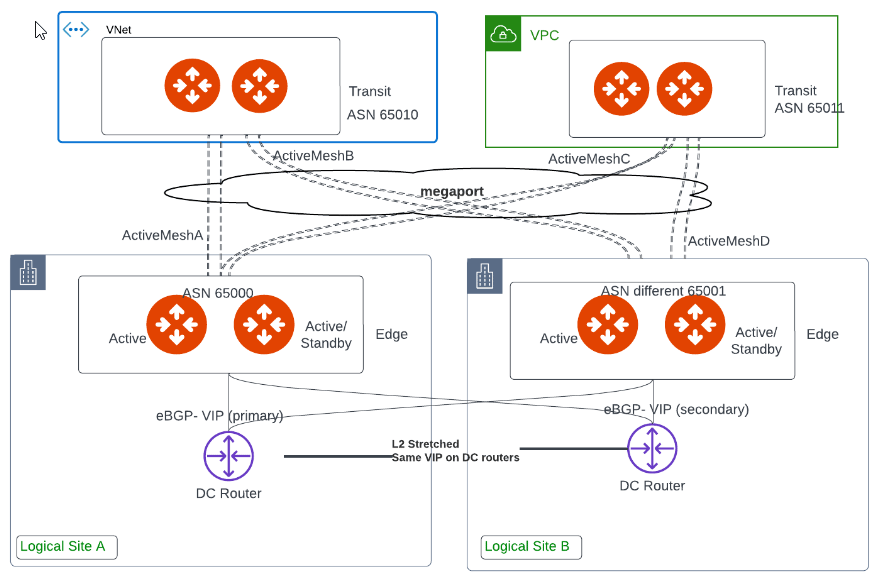

Edge Spoke Gateways can connect to a LAN side router using BGP over LAN or to an external device such as a server or firewall using static routes. Edge Spoke Gateways support active-active and active-standby connections to provide LAN side high availability. This feature is supported on all Edge platforms. This diagram shows Edge Spoke Gateways deployed on multiple edge sites with active and standby peering connections to different LAN routers. Edge Spoke Gateways deployed on multiple edge sites with active and standby peering connections to different LAN routers This diagram shows Edge Spoke Gateways deployed on the same site with active and standby peering connections to different LAN routers. Edge Spoke Gateways deployed on the same site with active and standby peering connections to different LAN routers

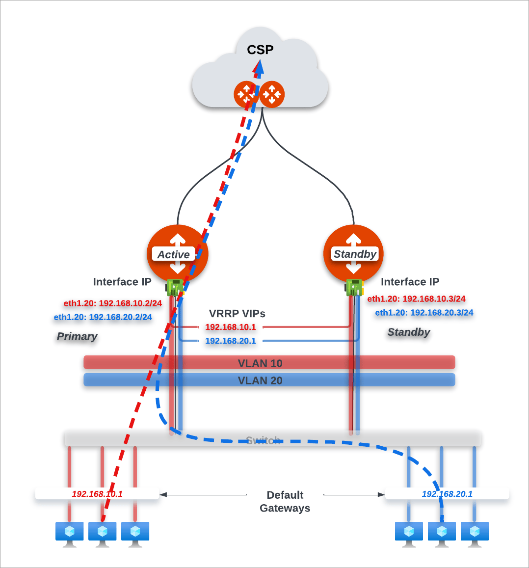

Edge Spoke Gateways support Virtual Router Redundancy Protocol (VRRP) protocol to provide high availability for Virtual Local Area Network (VLAN) connectivity. You can deploy Edge Spoke Gateways in on-premises locations with the VRRP protocol enabled. This feature is supported on the Aviatrix Edge Platform and Self Managed platforms.
If you deploy an Edge Spoke Gateway with VRRP enabled, then all Edge Spoke Gateways in the same edge site must be created in active-active high availability mode.
The diagram below illustrates a VRRP configuration with Edge Spoke Gateways as the default LAN router. LAN traffic flows to the VRRP active gateway to the cloud. When the VRRP active gateway is down, traffic flows to the VRRP standby gateway to cloud. Edge Spoke Gateways VRRP configuration with multiple VLANs To learn more about VLAN and VRRP support, see About Extending VLAN Segmentation to the Cloud.

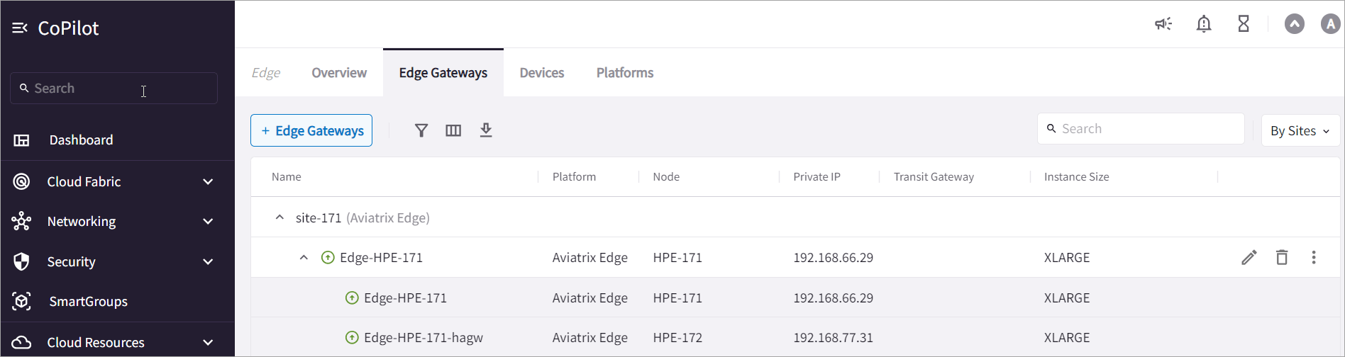

The figure below shows an active-standby Edge deployment with two gateways (one primary and one HA Edge Gateway) for the same edge site. The HA gateway name is auto-generated in the format <primary-gateway-name-hagw>. Active-standby Edge deployment with two gateways showing primary and HA Edge Gateway
