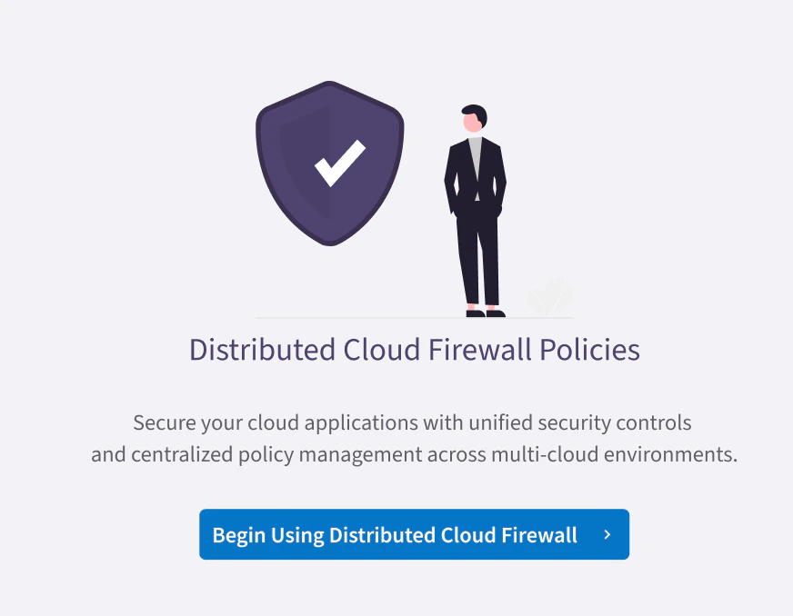

  1. Go to the Security > Distributed Cloud Firewall > Policies tab.
  2. Click Begin Using Distributed Cloud Firewall.
  3. Click Begin again to confirm the action and enable the feature.

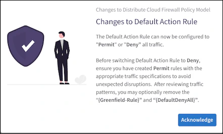

Starting with Controller version 8.1, the Default Action Rule is automatically created when DCF is enabled. Legacy rules such as Greenfield and DefaultDenyAll are no longer generated; the Default Action Rule replaces their function. The Default Action Rule cannot be deleted. When you upgrade to Controller 8.1 or earlier, the existing DefaultDenyAll rule is converted to a non-system rule, which you can delete. If you use Controller 8.0 or earlier, both a Greenfield Rule and a DefaultDenyAll rule are deleted.
After enabling the Distributed Cloud Firewall feature, a Default Action Rule is created. This is a system rule used to enforce zero trust principles by controlling how traffic is handled in the absence of explicit rules. This rule must be set to Deny after it is created, to ensure that traffic is not permitted by default. The action of the Default Action Rule is enforced globally and is evaluated after all user-defined and system-defined rules/rulesets.

  1. On the Security > Distributed Cloud Firewall > Policies tab, click Begin Using Distributed Cloud Firewall.
  2. You may have to click Begin again to confirm the action. This Default Action Rule is then created on the Policies tab in the User Ruleset (formerly the V1 Policy List ruleset).

  1. On the Security > Distributed Cloud Firewall > Policies tab, click Acknowledge on the splash screen that informs you about the Default Action Rule.
  2. The Default Action Rule is displayed on the Policies tab in the V1 Policy List ruleset. The Default Action Rule replaces the pre-existing DefaultDenyAll rule, if you used the DCF feature prior to Controller 8.1. You can delete the old DefaultDenyAll rule if it exists.
Default Action Rule
  1. Change the action of the Default Action Rule to Deny.
  2. You can delete the pre-existing Greenfield-Rule if it exists, assuming that you have reviewed traffic patterns first.

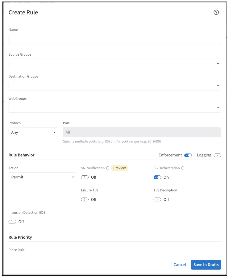

  1. In CoPilot, go to Security > Distributed Cloud Firewall > Policies.
  2. Select a ruleset from the Ruleset list.
  3. Click + Rule. The Create Rule dialog displays.
40%
  1. Use the Distributed Cloud Firewall Field Reference to create your rule.
If the Rule Behavior Action is Deny, the SNI Verification toggle is not displayed. The SNI Verification feature is only available with Controller 8.0.

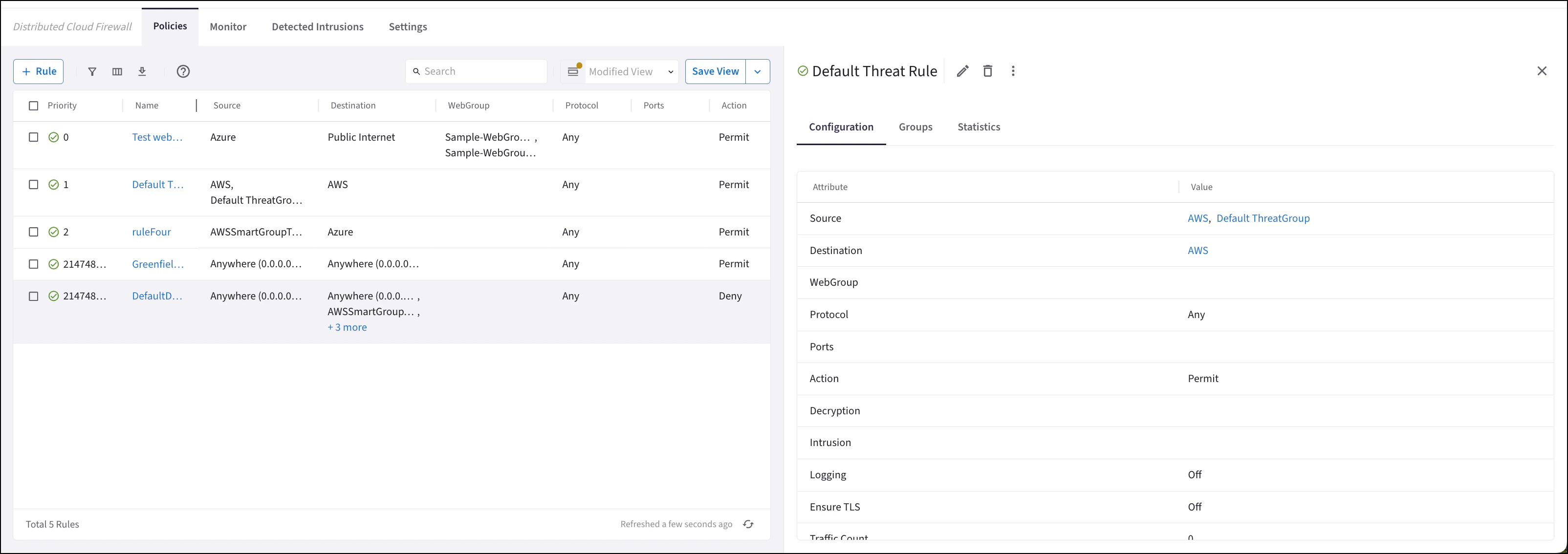

Viewing DCF Rule Details
You can click a DCF rule on the Security > Distributed Cloud Firewall > Policies tab to view its configuration details, source and destination entities, and statistics in the right-hand pane. dcf rule details The Groups tab in the details pane shows the Source Entities, Destination Entities, and WebGroups used in the rule. The Statistics tab shows the number of hits for the rule, and the last time it was hit.
