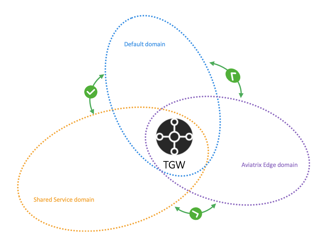

To use the AWS TGW (Transit Gateway) feature, you must first create an AWS Transit Gateway. This step creates an AWS Transit Gateway in a specified region with a specified AWS account. Aviatrix CoPilot also automatically creates the Default_Domain, the Shared_Service_Domain and the Aviatrix_Edge_Domain and the corresponding AWS Transit Gateway route tables. The three domains are connected. If you attach a VPC to the Default Domain or Shared Service Domain, the VPCs can communicate with each other and can access on-prem environments through the Aviatrix Edge Domain. The three domains are connected, implying that if you attach a VPC to the Default Domain or Shared Service Domain, the VPCs can communicate with each other and can access on-prem through the Aviatrix Edge Domain. To create an AWS Transit Gateway:- Go to Aviatrix CoPilot > Networking > Connectivity > select the AWS TGW tab.

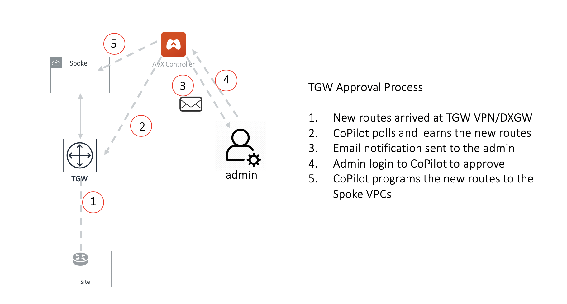

Approval tab
TGW Approval
- Go to Networking > Connectivity > select the AWS TGW tab > select the AWS TGW > select the Approval tab.
- Click on the AWS TGW Attachment dropdown to select the attachment to review.
- Make sure Learned CIDR Approval is enabled.
- All routes appear, both unapproved and already approved.
- To approve an unapproved route, click Approve in its row. Now, the route can be propagated.
- To disapprove an approved route, click Remove in its row.

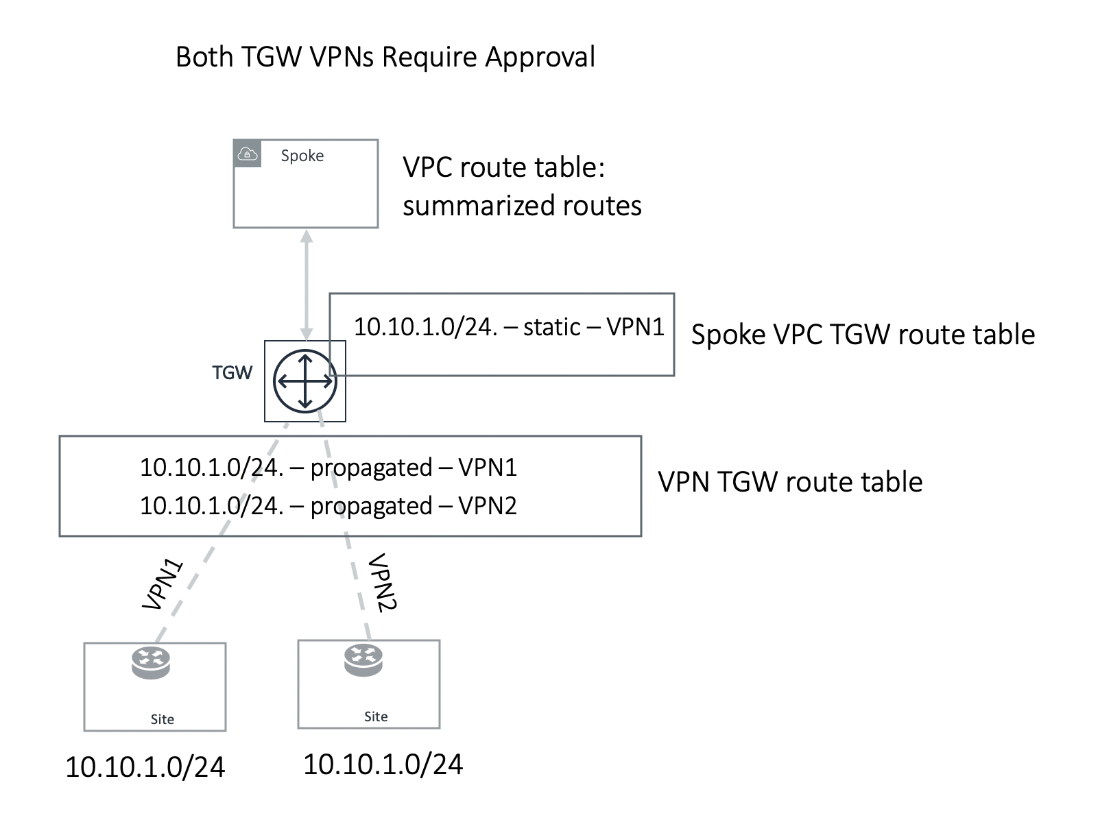

How the Approval Feature Works
When Learned CIDR Approval is enabled, TGW route table route propagation to the connected Network Domain is turned off. That is, the TGW VPN/DXGW learned routes are statically programmed into the TGW route table of connected Network Domains after the routes are approved. This is illustrated in the following two examples.Example 1: Two TGW VPN/DXGW in the same domain

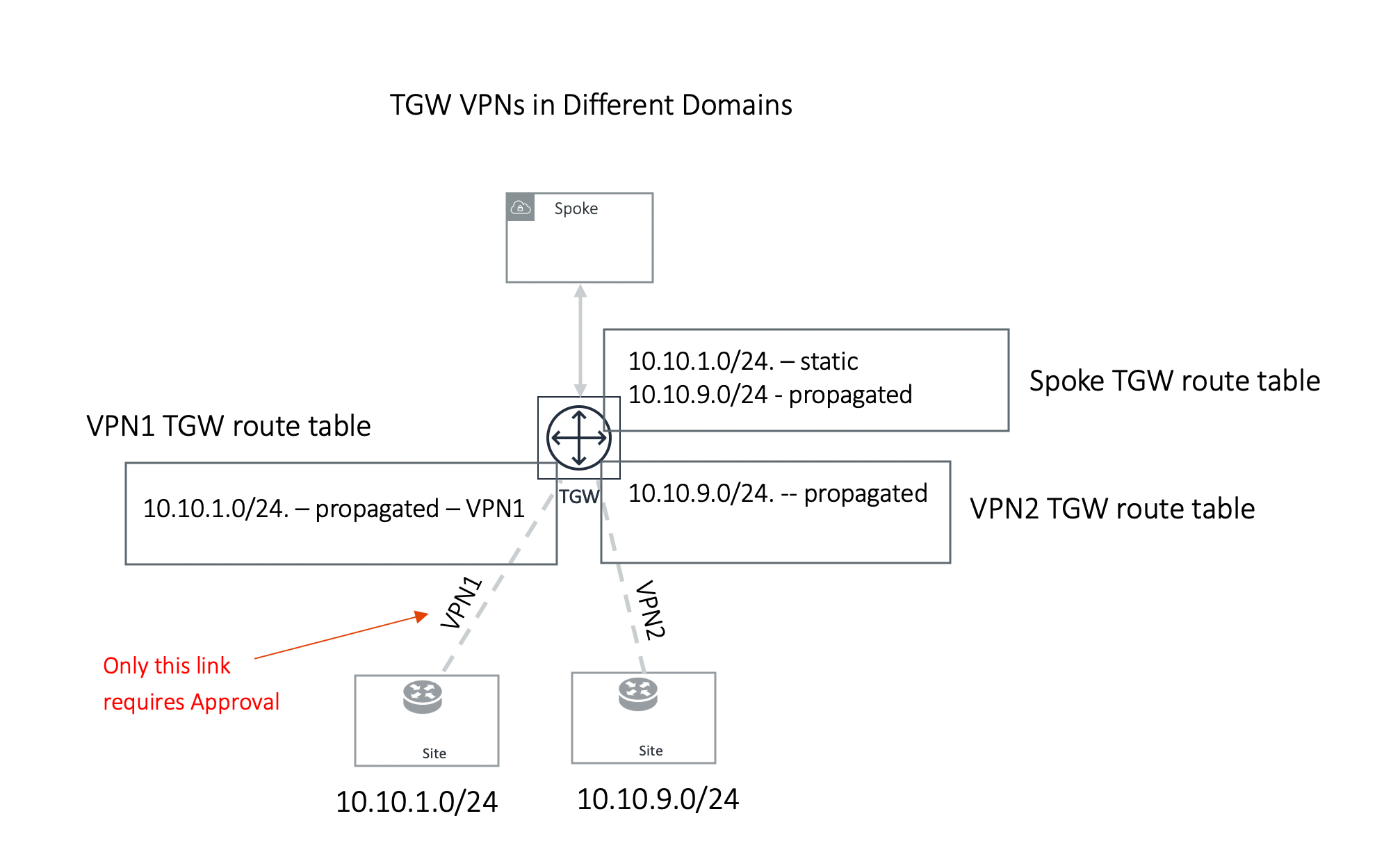

Example 2: One TGW VPN requires approval and another one does not
