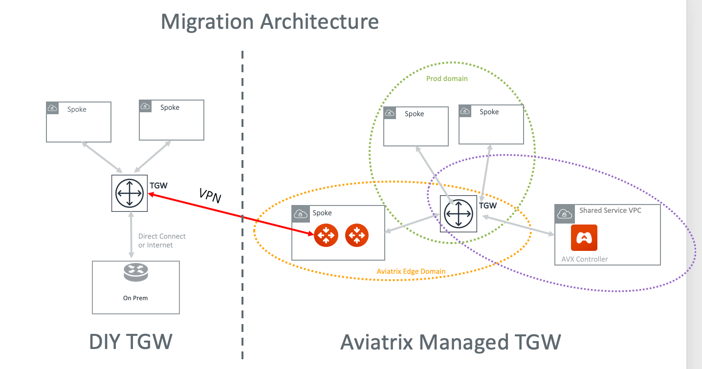

The Solution
There are multiple ways to migrate. For example, you can simply detach a spoke VPC from the existing TGW and attach it to Aviatrix-managed TGW and then build hybrid connection if necessary. In this implementation, the migrated spoke VPCs can communicate with the not yet migrated VPCs during migration process, and in addition the migrated spoke VPCs can communicate with on-prem network, thus reducing the downtime, as shown in the migration architecture below. migration_architecture The key idea is to build an IPsec tunnel between TGW VPN and Aviatrix Transit Gateway, so that migrated VPC can communicate with not yet migrated VPCs and also to on-prem.

Once all VPCs have migrated to Aviatrix-managed TGW deployment, the migrated VPCs communicate with on-prem via Aviatrix Transit GW to the existing TGW and then to on-prem. At this point, you can move existing TGW Direct Connect to Aviatrix Transit GW or to Aviatrix managed TGW directly.
