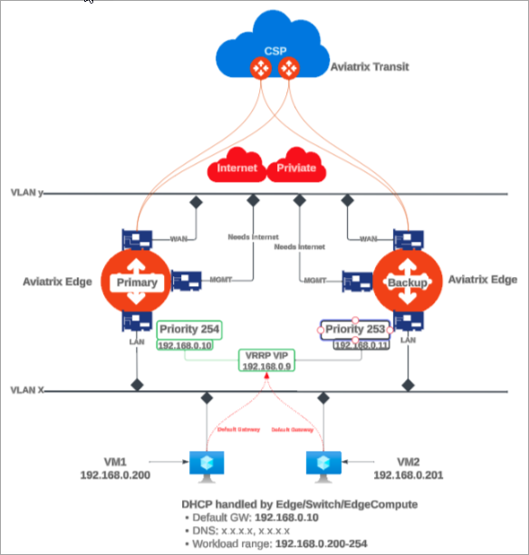

Single VLAN Topology
The topology below illustrates an Edge site with a single VLAN, Virtual Router Redundancy Protocol (VRRP), and the Edge Spoke Gateway deployed as the default LAN router. Single VLAN topology diagram showing an Edge site with VRRP and Edge Spoke Gateway as the default LAN router In this diagram:
  • The VRRP and VLAN segment is configured on the primary Edge Spoke Gateway.
  • The VLAN segment is automatically created symmetrically on the secondary Edge Spoke Gateway.
  • The VRRP Virtual IP is used by the LAN hosts as the Default Gateway IP.
  • VRRP support requires that the Edge Spoke Gateway is created with Active-Active high availability peering connection to the Transit Gateway(s).
  • The Edge Spoke Gateways advertise the CIDRs associated with the LAN and VLAN sub-interfaces to the Aviatrix Transit Gateway(s). You can disable CIDR propagation, if not needed. See Disabling LAN and VLAN CIDR Propagation to the Transit Gateway.

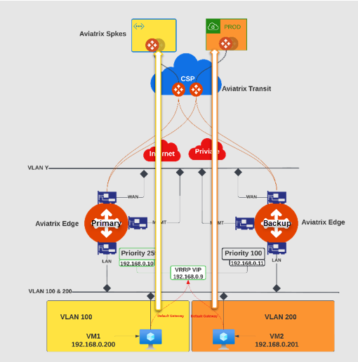

Aviatrix Edge Spoke Gateway enables you to segment your on-premises network traffic through network domains and connection policies. The Edge Spoke Gateway routes on-premises and inter-VLAN traffic flow based on the network domain connection policies. To segment the on-premises network traffic, you associate the VLAN segment and its workload in the CSP to the same network domain. For example, the diagram below illustrates on-premises network traffic flow between the yellow and orange domains that are segmented.
  • VLAN 100 is associated to the same network domain as its workload in the CSP.
  • VLAN 200 is associated to the same network domain as its workload in the CSP.
VLAN segmentation diagram showing on-premises VLAN 100 and VLAN 200 associated to their respective network domains and CSP workloads To create network segmentation between VLANs and Spoke VPCs Or VNets, you associate the VLANs and Spoke VPCs or VNets to network domains. When network segmentation is configured with multiple Edge Spoke Gateways using VLAN, the same VLAN ID is associated to the network segment across all the gateways for the edge site.
