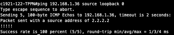

Traffic from on-premise router Cisco IOS to cloud VM
Issue ICMP traffic from on-prem loopback interface to a Virtual IP of cloud instance

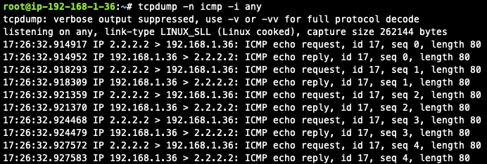

Execute packet capture on the cloud instance

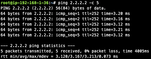

Traffic from cloud VM to on-premise router Cisco IOS
Issue ICMP traffic from cloud instance to on-prem loopback interface address
