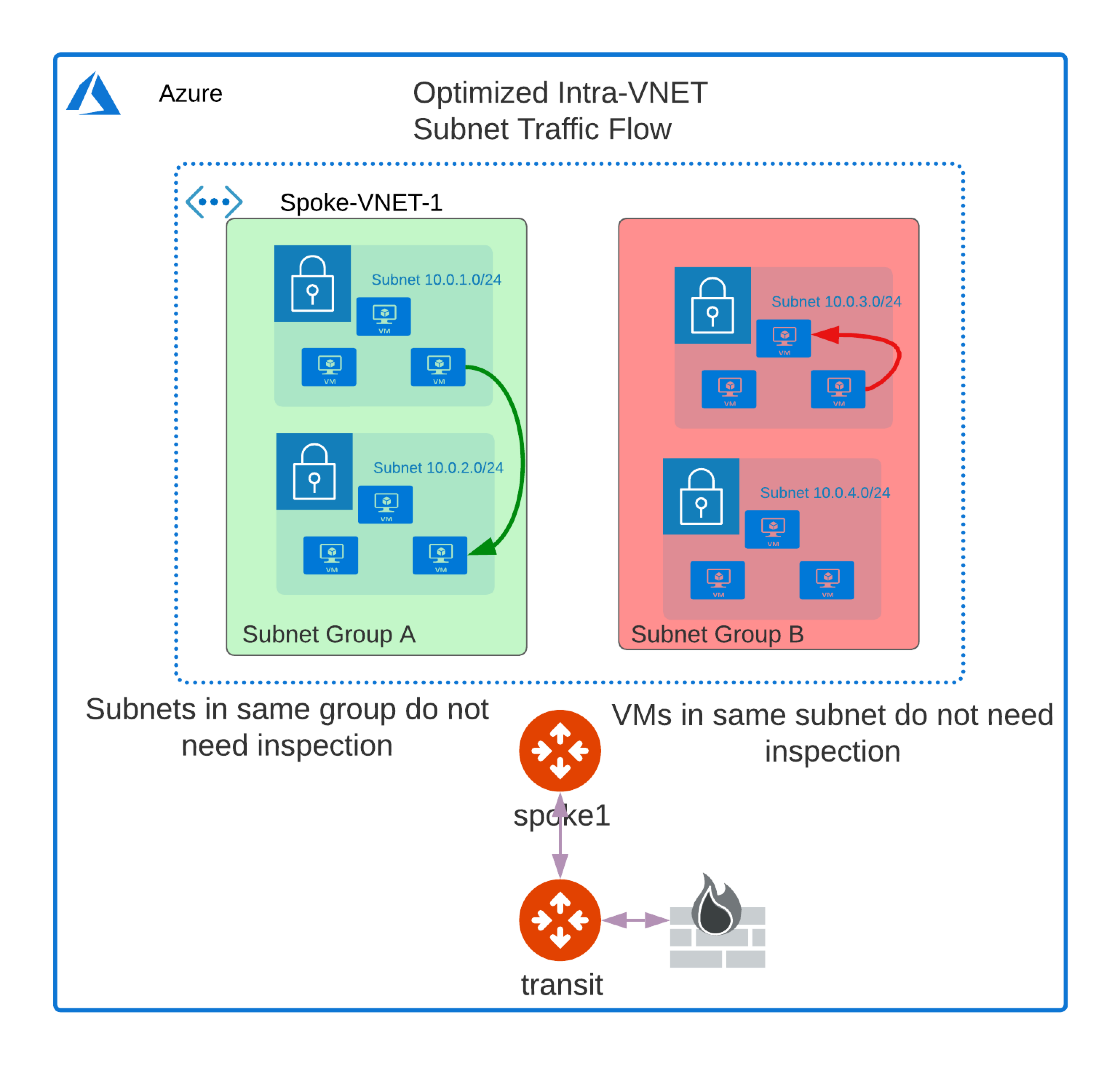

A subnet group defines a logical grouping of subnets in a VNet. A subnet group is local to a VNet and does not span across multiple VNets. Traffic between subnets in the same subnet group flows through the Azure native virtual network and is not inspected by the firewall in the Aviatrix Transit FireNet configuration. If you want to inspect traffic between subnets in the same VNet, the subnets must be in different subnet groups.

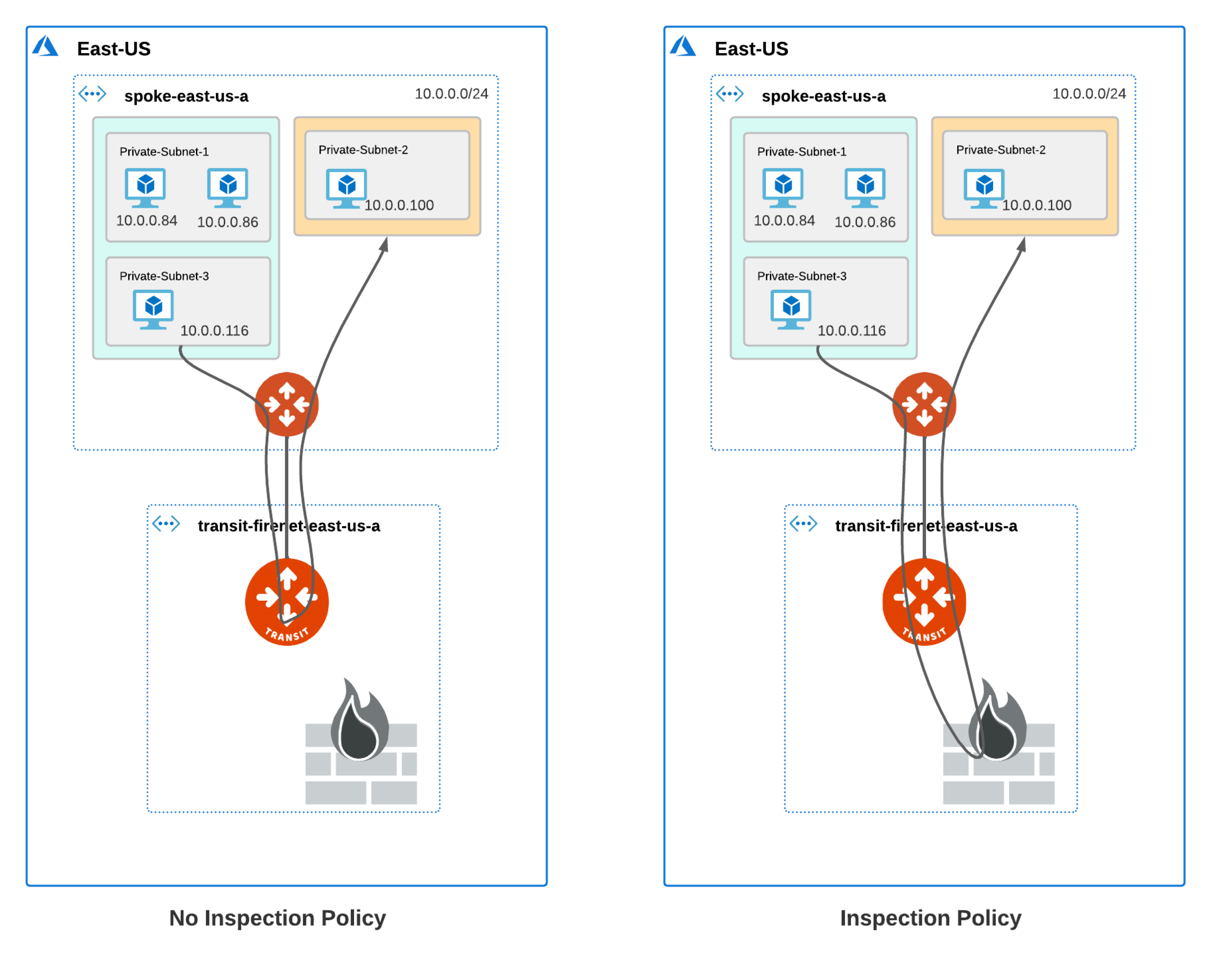

When subnet groups are created in a VNet, traffic from the subnet groups is redirected to the Aviatrix Transit FireNet Gateway for inspection, if you enable the inspection policy for the subnet groups.
Traffic for subnets that are part of a subnet group but do not have an inspection policy traverse the Aviatrix Transit FireNet gateway but are not redirected to or inspected by the firewall.
Intra-VNet Subnet Inspection for Subnets in the same Subnet Group
Traffic between VMs in the same subnet or subnet group is not inspected. If you want to inspect traffic between VMs in different subnets in the same VNet, the subnets must be in different subnet groups. For more information, refer to Connectivity Scenarios Between VMs in Subnets.

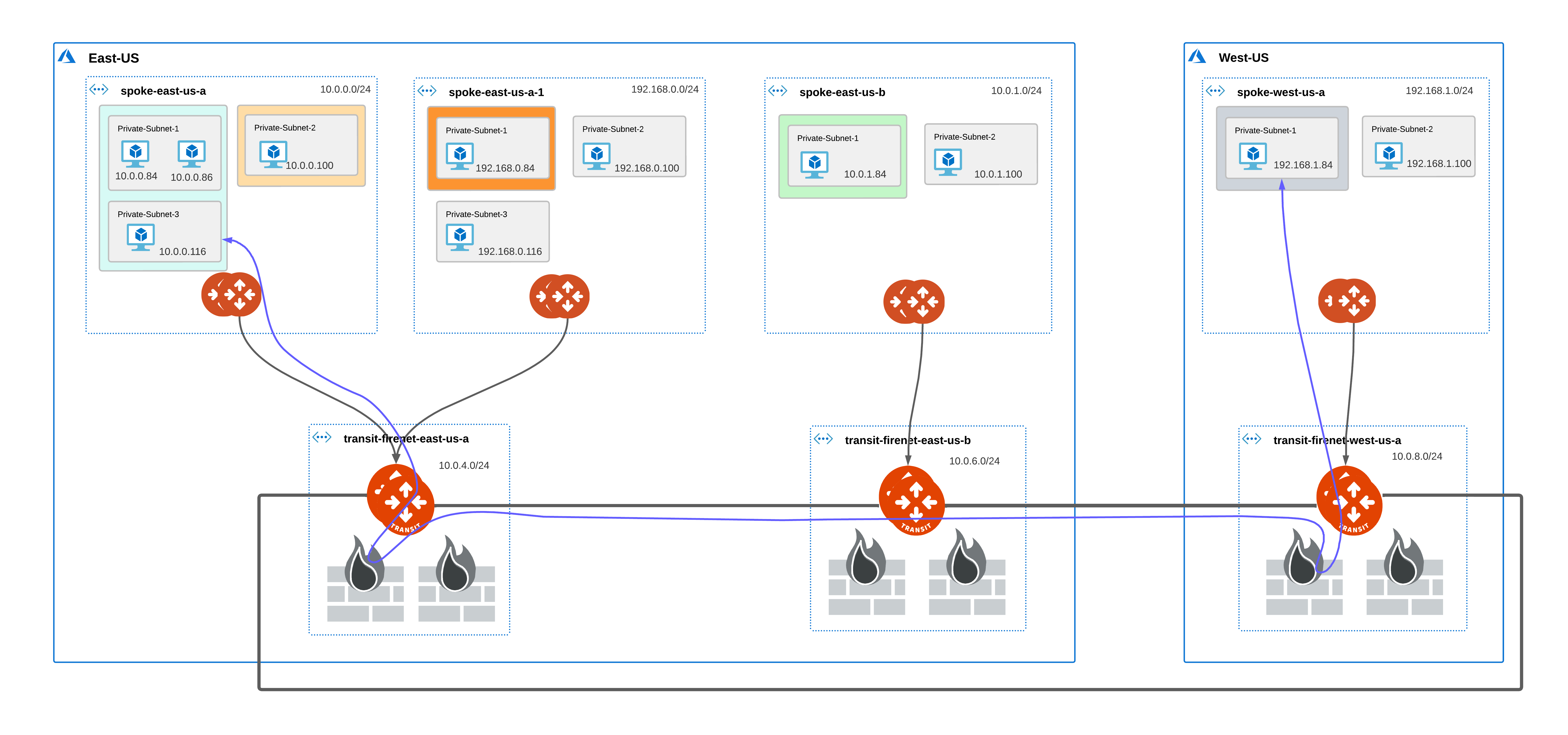

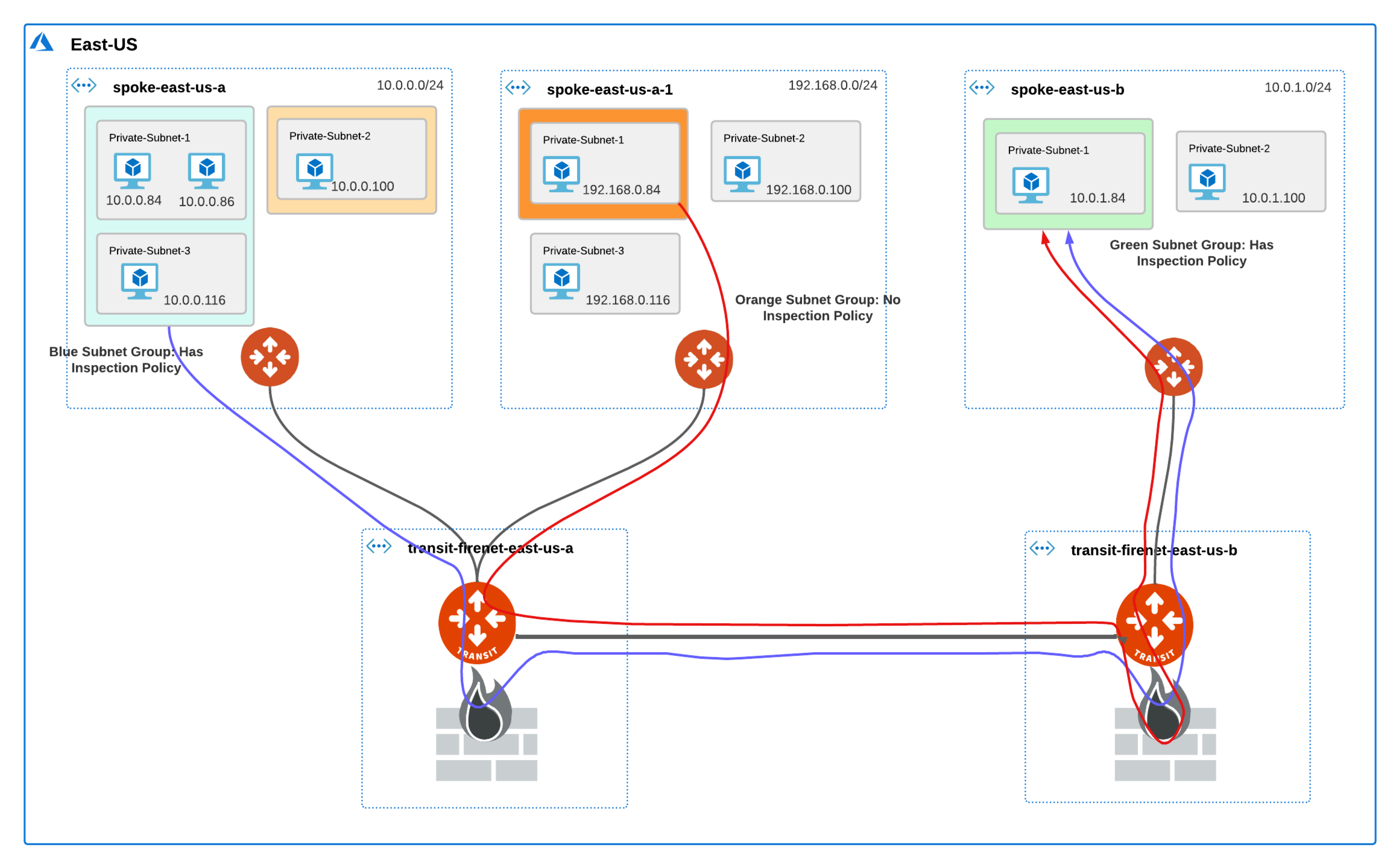

Single Region Inter-VNet Subnet Inspection Over Transit Peering
In this scenario, the blue and green subnet groups have an inspection policy, and the orange subnet group does not. The traffic between the blue and green subnet groups traverses the firewall on either side. Since the orange subnet group does not have an inspection policy, the traffic between the orange and green subnet groups is not inspected by the firewall connected to the Transit FireNet to which the orange subnet group’s Spoke is attached. However, since the green subnet group has an inspection policy, the traffic between the orange and green subnet group traverses the firewall connected to the peer Transit FireNet.
Multi-Region Inter-VNet Subnet Inspection Over Transit Peering
The traffic traversal is similar to the Inter-VNet Subnet Inspection Over Transit Peering scenario.

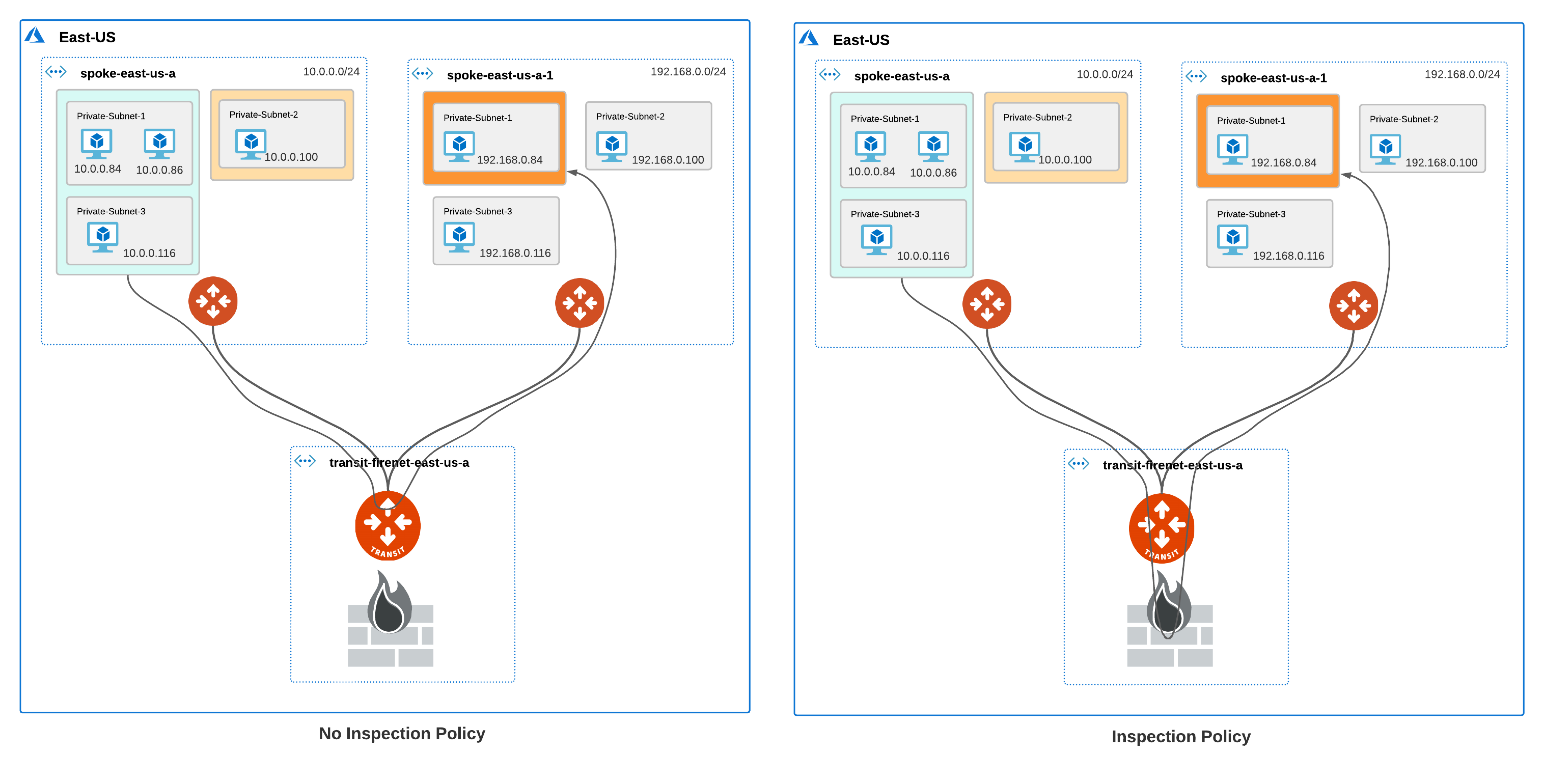

Inter-VNet Subnet Inspection over Transit Peering
The connection behavior is the same as Inter-VNet Subnet Inspection.
