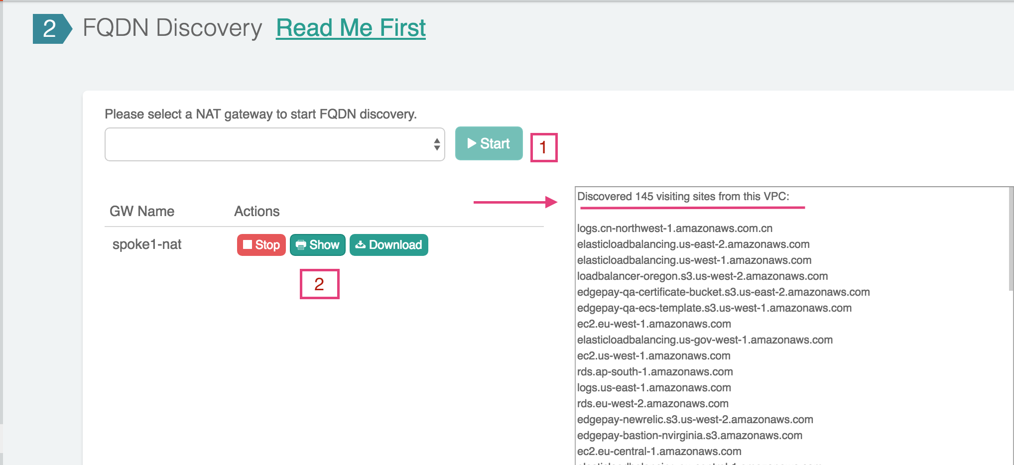

In the Aviatrix Controller, go to Security > Egress Control > Egress FQDN Discovery.
Select a gateway from the dropdown menu and click Start. After the monitoring starts, click Show at any time to see the captured destination sites. Only HTTP (port 80) and HTTPS (port 443) results will display in the report.
Click Stop to stop the Discovery process.

While the Egress FQDN Discovery is in progress, click Show at any time to see the captured destination sites.

Click Download during or after the Discovery and the destination list will be downloaded. You can later import the list to configure the FQDN Filter.
