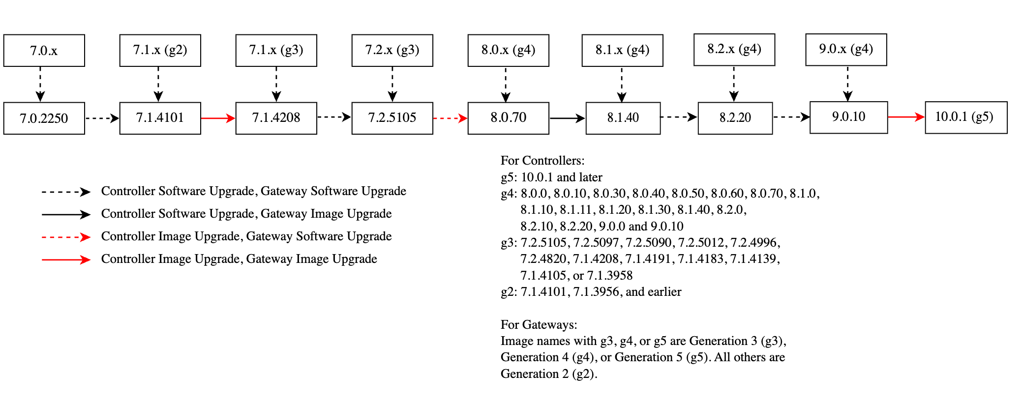

Major Upgrade Paths Overview
The following diagram illustrates the major upgrade paths for the Aviatrix Controller and Gateways. Major Upgrade Paths for Controller and Gateways
Azure gateway users starting at 8.1.x or later: The software upgrade steps listed above do not deliver the MANA driver fix. Along your path, the gateway portion of at least one step landing on a MANA-compatible release (8.1.50, 8.2.30, or 9.0.20) must be performed as an image upgrade instead of a software upgrade. For example, on the 8.1.x → 9.0.20 path, replace the gateway portion of step 1 (to 8.1.50), step 2 (to 8.2.30), or step 3 (to 9.0.20) with an image upgrade. This requirement does not apply to AWS-only environments, or to upgrade paths starting at 8.0.x or earlier (where an image upgrade is already a required step). For details, see the MANA Field Notice (FN-2026-AZ-001) .
1 7.0.x refers to any 7.0 release earlier than 7.0.2250.2 7.1.x refers to any 7.1 release earlier than 7.1.4101.3 7.2.x refers to any 7.2 release earlier than 7.2.5105.4 8.0.x refers to any 8.0 release earlier than 8.0.70.5 8.1.x refers to any 8.1 release earlier than 8.1.50.6 8.2.x refers to any 8.2 release earlier than 8.2.30.7 9.0.x refers to any 9.0 release earlier than 9.0.20.8 If you are using a private marketplace in Azure, you must subscribe to the gateway image offer in the Azure marketplace first. See Subscribing Gateway Offers to Azure Private Marketplace for Aviatrix Deployments .9 If you are using a private marketplace in Azure, you must subscribe to the controller image offer for 7.2.x in Azure marketplace first. See Subscribing Controller Offers to Azure Private Marketplace for Aviatrix Deployments.

    If your Controller has been upgraded to 7.1.3958 or later, you can perform a software upgrade to 7.1.4208 (latest 7.1 version). Then perform a software upgrade to 7.2.5105. If your Controller is already on 7.2.x, skip this step. Then perform a software upgrade to 7.2.5105 (latest 7.2 version). Then, perform an image upgrade from 7.2.5105 to 8.0.70. Then you can perform a software upgrade from 8.0.70 to 8.1.50. Then you can perform a software upgrade to 8.2.30. Then you can perform another software upgrade to 9.0.20. Then, perform an image upgrade from 9.0.20 to 10.0.10. Then, perform a software upgrade from 10.0.10 to 10.1.11 (latest Controller version).

    If your gateways have been upgraded to 7.1.3958 or later, you can perform a software upgrade to 7.1.4208 for the latest 7.1 software release. If your Controller is already on 7.2.x, skip this step. You can then perform another software upgrade to 7.2.5105 for the latest 7.2 software version. Then you can perform a software upgrade from 7.2.5105 to 8.0.70. Then, you can perform an image upgrade from 8.0.70 to 8.1.50. Then you can perform a software upgrade to 8.2.30. Then you can perform another software upgrade to 9.0.20. Then, perform an image upgrade from 9.0.20 to 10.0.10. Then, perform a software upgrade from 10.0.10 to 10.1.11 for the latest software version.
