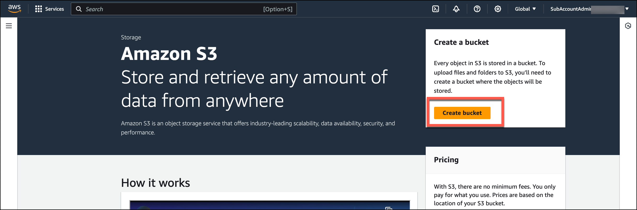

  1. Create AWS S3 bucket. s3 create

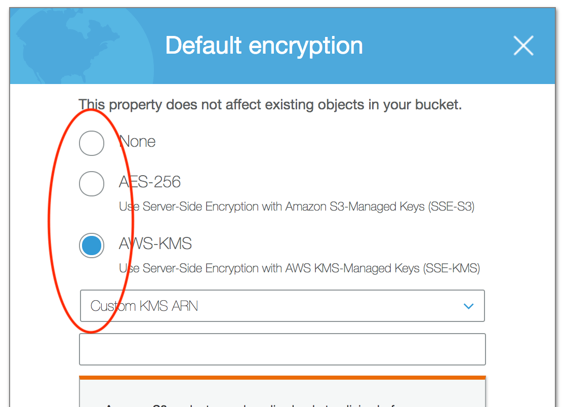

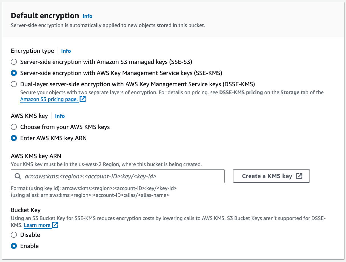

  2. After configuring other bucket properties, configure bucket server side encryption by selecting either Server-side encryption with AWS Key Management Service keys (SSE-KMS) or Dual-layer server-side encryption with AWS Key Management Service keys (DSSE-KMS). s3 select default encryption
  3. Click Create a KMS key to create a new key. A separate tab opens where you can configure and save the key.
  4. After the key is saved, go back to the Create bucket tab and enter the key in the AWS KMS key ARN field. s3 select encryption
