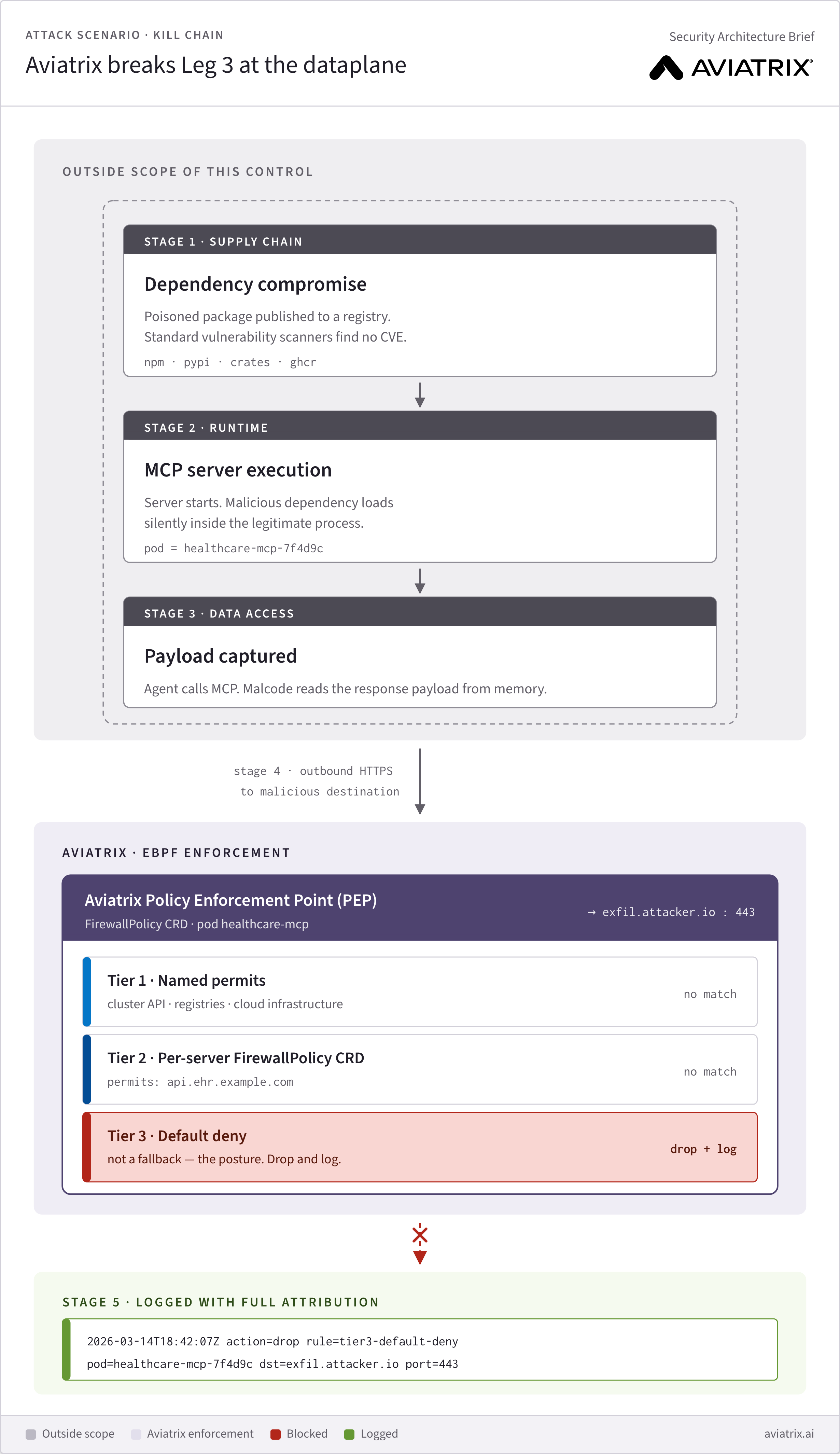

September 2025: Postmark-MCP. A rogue npm package (a near-identical clone of the legitimate Postmark MCP server) was discovered silently forwarding every email it processed to the attacker’s external server. The MCP gateway saw normal, authenticated email operations. The exfiltration happened on an outbound connection the gateway never saw. Workload-level egress containment would have blocked that connection: the server was not declared to reach any destination other than the Postmark API, so every connection to the attacker’s endpoint would have been denied and logged.
March 2026: TeamPCP supply chain attack. The TeamPCP cascading supply chain attack compromised four widely deployed AI and security tooling packages (Trivy, Checkmarx KICS, LiteLLM, and the Telnyx Python SDK) across five package registries in twelve days. LiteLLM operates under the same trust model as MCP servers: trusted code, making real outbound API calls, executed in trusted pipelines. The attack moved through trust, not around defenses. The detection apparatus documented it after the fact.

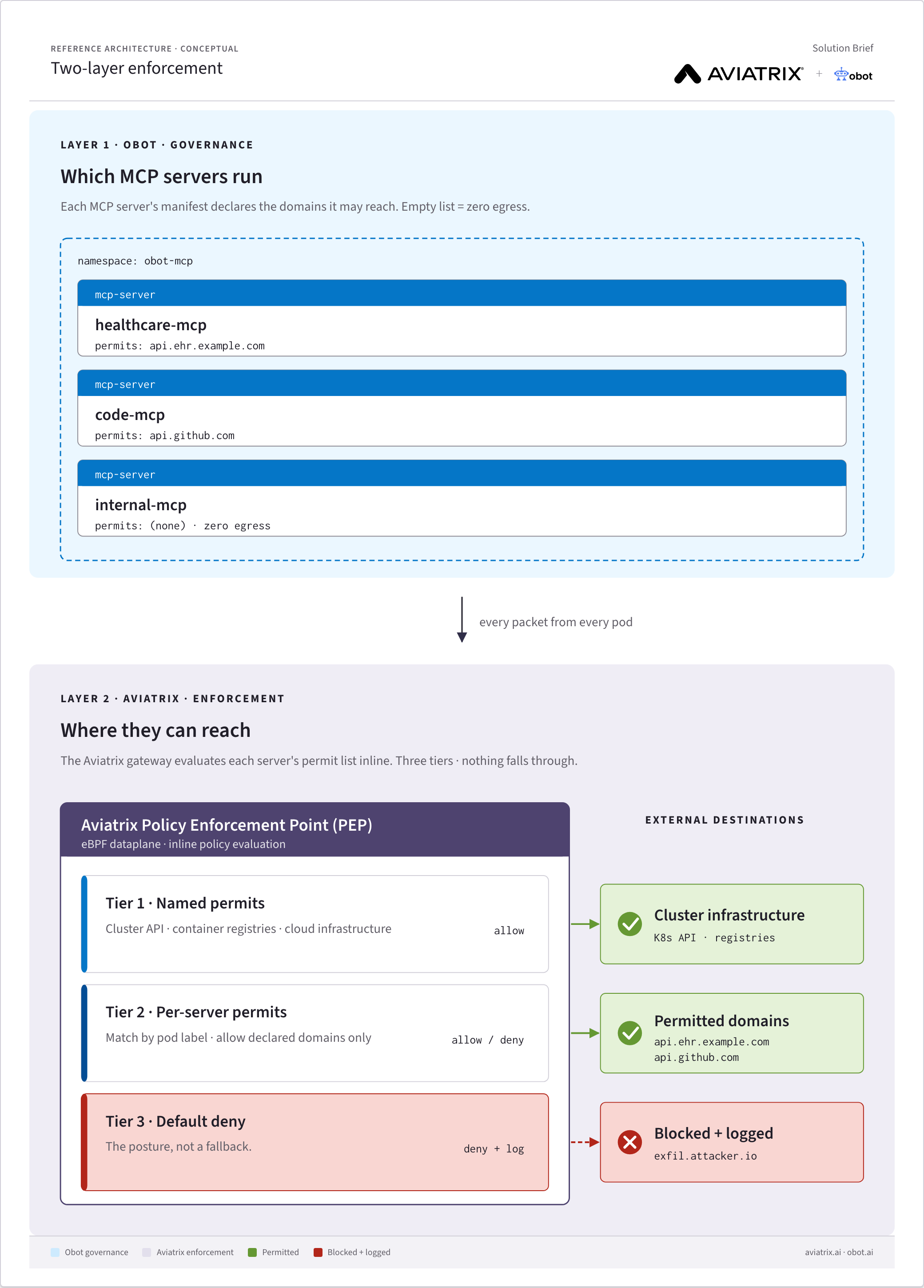

Aviatrix DCF enforces egress containment at the VPC boundary, specifically at the spoke gateway where Kubernetes pod traffic exits the cluster via node NAT gateways. This enforcement point is below the application layer, transparent to the workload, and impossible to bypass from within the pod. Every MCP server starts denied. Only explicitly declared egress destinations are reachable. A server with no declared policy fails closed, not open. Containment policy targets individual MCP server pods by Kubernetes label, not by ephemeral IP address. WebGroups filter outbound connections by FQDN, which is essential for MCP servers communicating with SaaS APIs on CDN-backed or rotating addresses that IP-based controls cannot handle reliably. When a supply chain compromise attempts to open a connection to an attacker-controlled endpoint, there is no route; the attempt is blocked at the gateway and logged in CoPilot.
Attack scenario: dependency compromise attempts exfiltration; Aviatrix DCF intercepts and blocks at the VPC boundary
For Obot-managed deployments, containment is lifecycle-coupled: Obot declares each server’s permitted egress destinations, and the Aviatrix controller picks up that declaration and enforces it at the network boundary. When the server is deleted, the policy is deleted. For self-managed deployments, the same policy model applies via Kubernetes CRDs or Terraform. Either way, the enforcement primitive is the same: a per-server default-deny perimeter with an FQDN-based allow-list, enforced at the VPC boundary, visible in CoPilot across every cluster and cloud.
Two-layer enforcement: Obot governs which MCP servers run and their declared egress policy; Aviatrix DCF enforces that declaration at the network boundary

Identity-based workload selectors that target containment policy to specific MCP server pods by Kubernetes labels, not by ephemeral IP addresses. This ensures that policy follows the workload as it scales and reschedules across nodes.
WebGroups
Domain-based egress filters that match traffic by FQDN rather than IP address, essential for MCP servers communicating with SaaS APIs on rotating or CDN-backed addresses. WebGroups are the mechanism that makes domain-based allow-lists enforceable.
