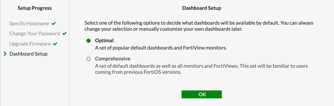

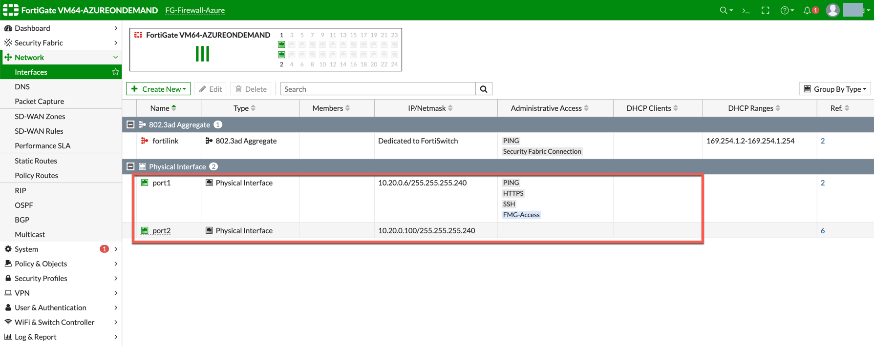

Once logged in with username and password provided during launch, it will ask you to do an initial setup as shown below: fg_first_login_2 fg_first_login_3 Go to Network > Interfaces and review the interface configuration before move forward. This interface configuration is done by Aviatrix Controller during the launch. review_fg_interfaces

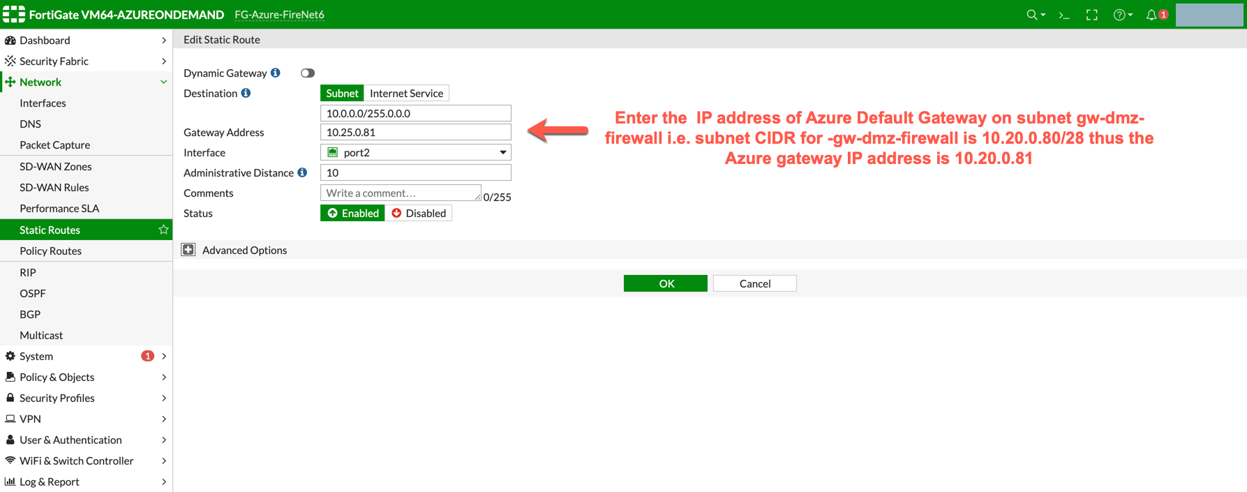

Creating Static Routes for Routing of Traffic VNet to VNet
For simplicity, in this example we configure the firewall to send all RFC 1918 packets to LAN port. Go to Network > State Routes to create a Static Route as the following screenshot. az_fortigate_static_routes Click Create New. Enter the destination route in the Destination box. In the Gateway Address box, enter the Azure default gateway IP on subnet -dmz-firewall-lan (i.e. subnet CIDR for -dmz-firewall-lan is 10.20.0.80/28, thus the Azure default gateway IP on this subnet is 10.20.0.81).
dmz-firewall-lan subnet can be found in the Aviatrix Controller. Go to Aviatrix Controller > Gateway > Select Gateway and click Edit > click More details to check all subnets.
The interface will be the LAN (port2). Configure an appropriate admin distance if you expect overlapping routes that need to be prioritized. Enter comments as necessary. Repeat the above steps for RFC 1918 routes.

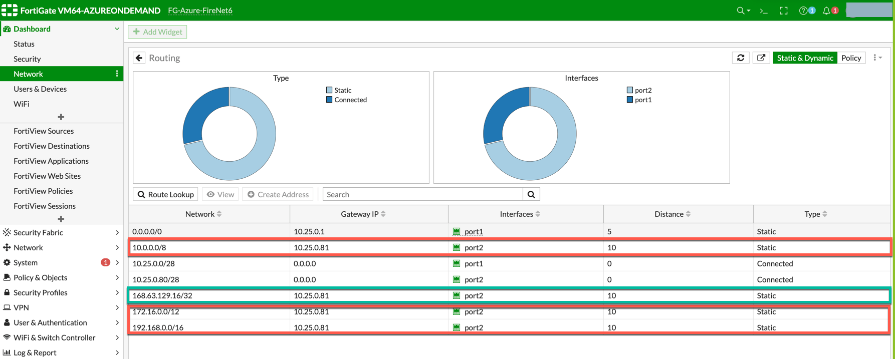

The Load Balancer static route 168.63.129.16/32 needs to be added manually pointing to the lan interface (port 2). 168.63.129.16/32 is the health probe source address.
Those static routes could also be reviewed on the page Dashboard > Network > Routing. RFC 1918 routes are highlighted in red whereas the load balancer static route is highlighted in green. az_fortigate_static_routes_review

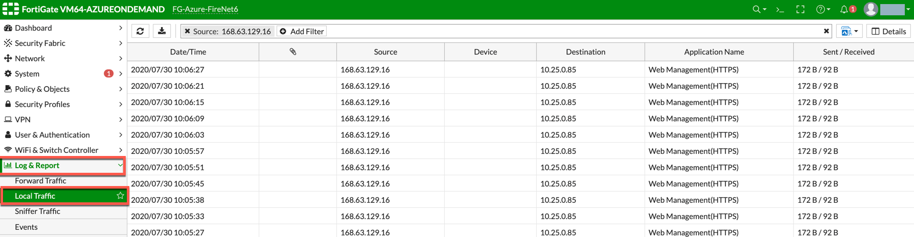

health-check The health check probes can be verified in FortiGate by navigating to Log & Report > Local Traffic.
Example Health-Check Logs in FortiGate
health-probe-logs

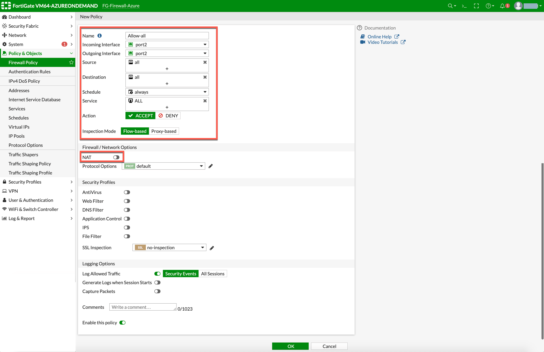

VNet to VNet In this step, you will configure a basic traffic security policy that allows traffic to pass through the firewall. Given that Aviatrix gateways will only forward traffic from the TGW to the LAN port of the Firewall, you can set your policy condition to match any packet that is going in/out of LAN interface. In the FortiGate UI, navigate to Policy & Objects > Firewall Policy > Create New / Edit to configure policy as the following screenshot. az_fortigate_policy_vpc_to_vpc After validating that your traffic is being routed through your firewall instances, you can customize the security policy to tailor to your requirements.

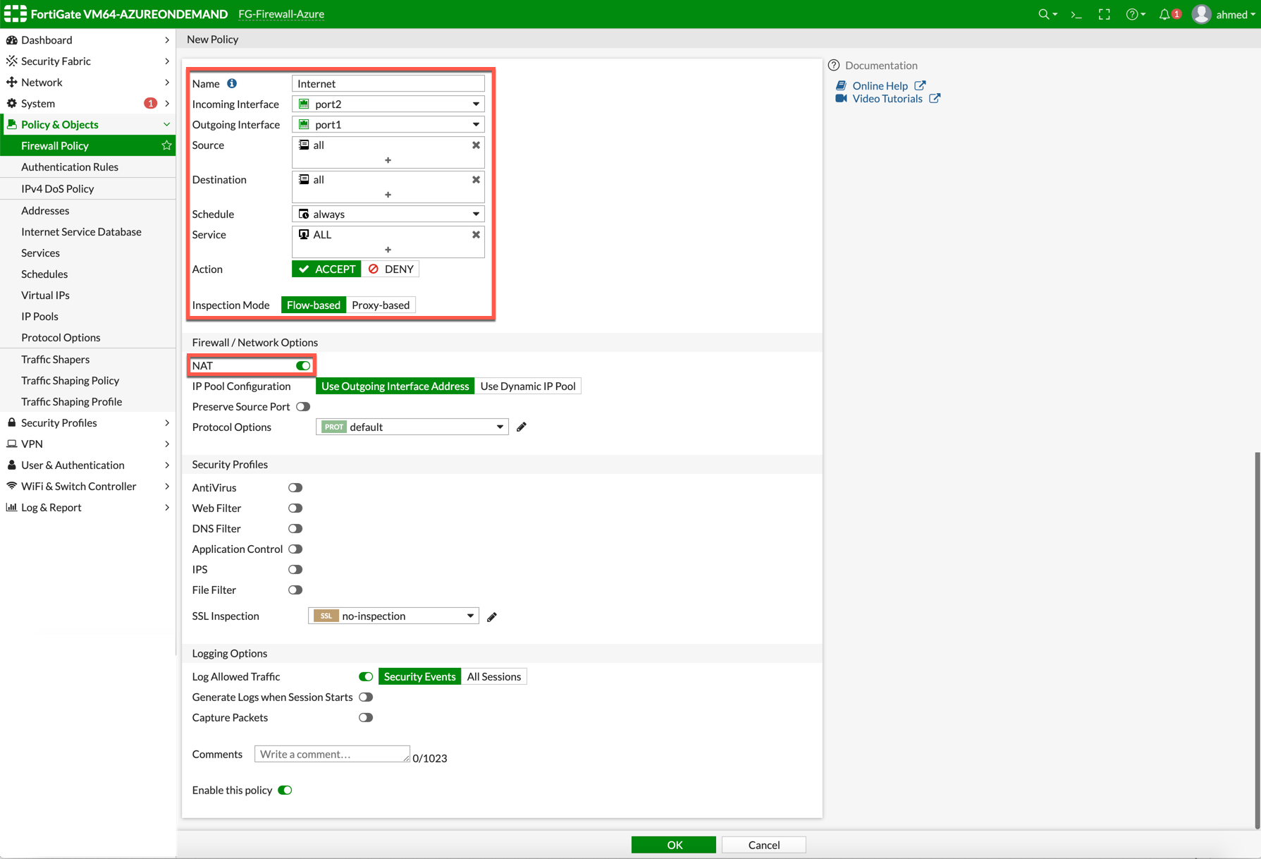

In this step, you will configure a basic traffic security policy that allows internet traffic to pass through the firewall. Given that Aviatrix Gateways will only forward traffic to the LAN port of the firewall, set your policy condition to match any packet that is going into LAN interface and out of the WAN interface. First you enable egress inspection: In CoPilot, select Security > FireNet. On the FireNet Gateways tab, select a Transit FireNet in the list and click the Edit icon. In the Edit FireNet dialog, under FireNet Configuration, toggle the Egress slider to On. Verify the Egress status on the Firewall Network > List > Firenet page in the Egress column for this firewall. In the FortiGate Next Generation Firewall console, create the new policy: Navigate to Policy & Objects > IPv4 Policy > Create New / Edit to configure policy as per the following table. az_fortigate_policy_vpc_to_internet NAT function needs to be enabled on this VNET to Internet policy. After validating that your traffic is being routed through your firewall instances, you can customize the security policy to tailor to your requirements.

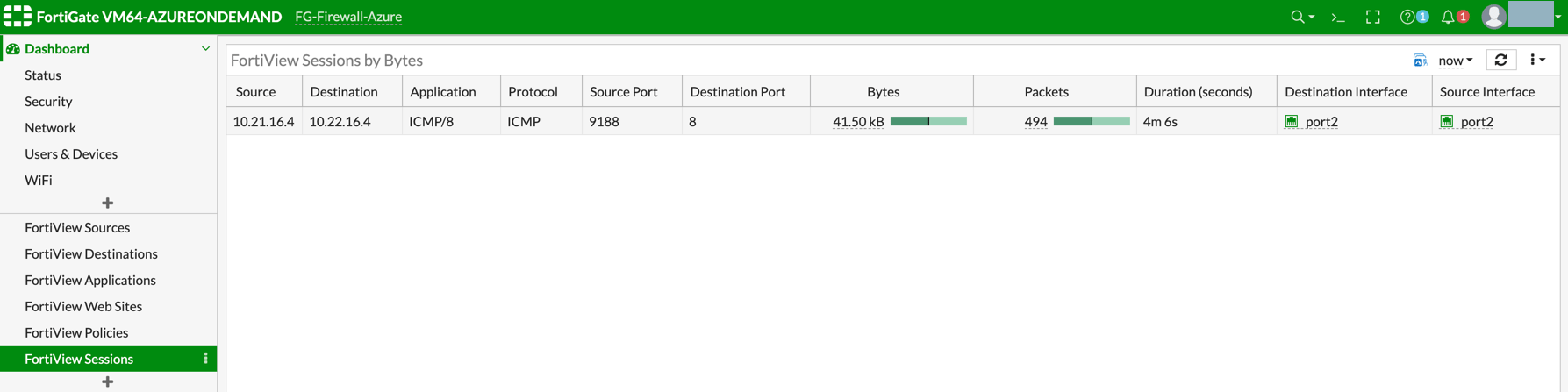

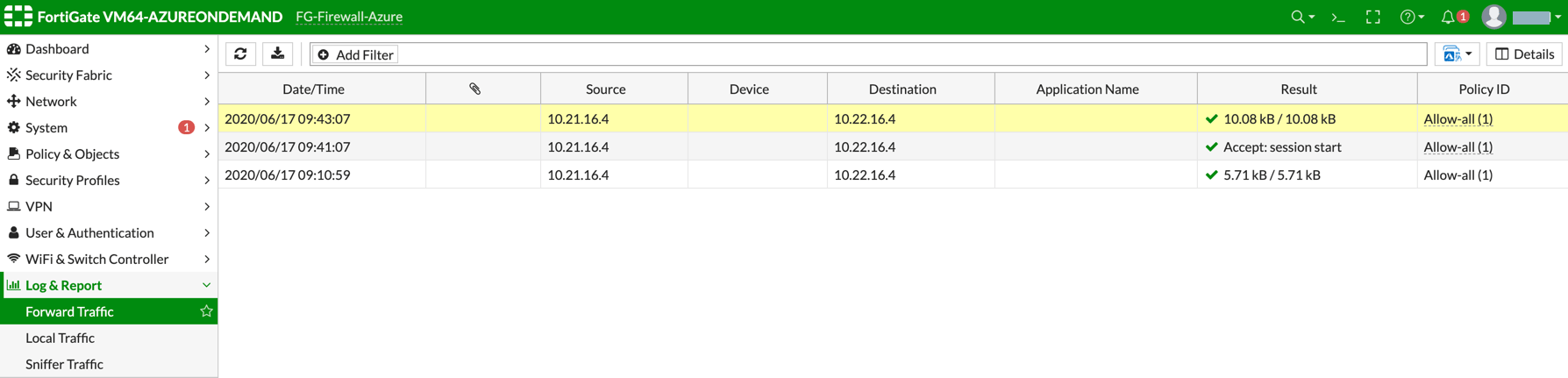

Launch one instance in PROD Spoke VNet and another in DEV Spoke VNet. Start pinging packets from an instance in DEV Spoke VNet to the private IP of another instance in PROD Spoke VNet. The ICMP traffic should go through the firewall and be inspected in the firewall. az_fortigate_view_traffic_log_vpc_to_vpc az_fortigate_view_traffic_log_vpc_to_vpc_2

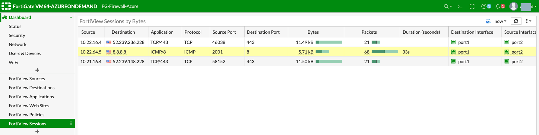

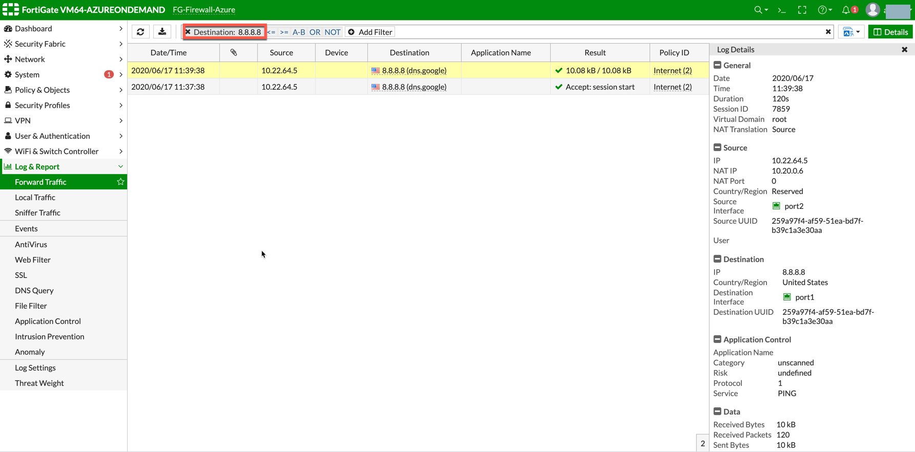

Launch a private instance in the Spoke VNet (i.e. PROD Spoke VNet) and start pinging packets from the private instance towards the Internet (e.g. 8.8.8.8) to verify the egress function. The ICMP traffic should go through and get inspected on the firewall. az_fortigate_view_traffic_log_vpc_to_internet az_fortigate_view_traffic_log_vpc_to_internet_2
