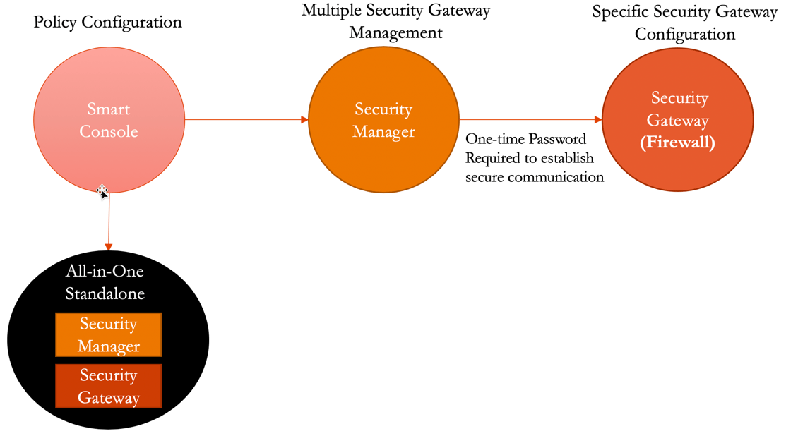

Before validating the Check Point traffic in Azure it is important to understand the basic Check Point architecture (reference diagram below) so that you can configure Check Point Security Gateway properly. cp_arch_reference As per above the following steps will be required to configure security polices successfully:
  1. Launch Check Point Security Gateway - Configure Interfaces and Static Routes and other specific Security Gateway configuration.
  2. Download, install, and configure Check Point Security Management (Optional).
  3. Download, install, and configure Check Point Smart Console - Launch Smart Console using Security Manager IP, add/authenticate one or more security gateways, configure security rules/polices, and push it to security gateways.

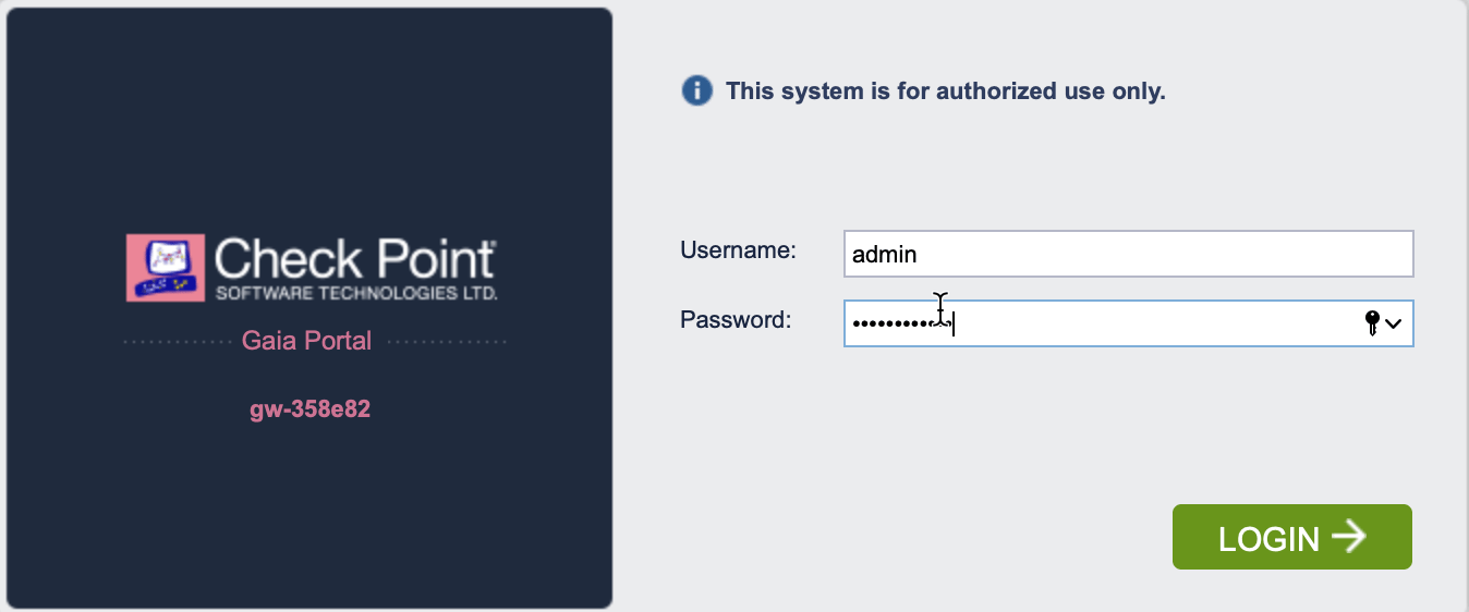

Logging in to the Check Point Firewall Gaia Portal
After the firewall launch is completed in Aviatrix CoPilot, go to Security > FireNet > Firewall and click on the firewall link in the Management UI column. This step applies to AWS and Azure. The URL takes you to the Check Point Firewall Gaia Portal you just launched. v2_cp_login_UI
Launching Check Point firewall instances from Aviatrix CoPilot automatically initiates its onboarding process.

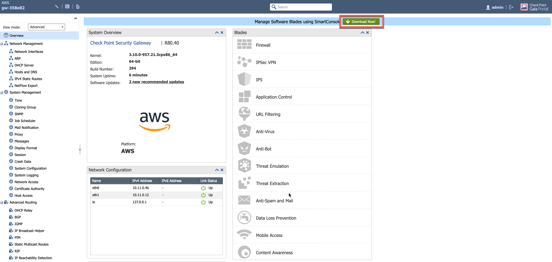

The Check Point Single Gateway ‘All-In-One’ image is used in this example and does not require Check Point Security Manager. All other Gateway images require Check Point Security Manager. If you are not using the ‘All-In-One’ image, skip this step and follow the Deploying and Installing the SmartConsole steps. The SmartConsole must be downloaded on a Windows-based computer. Log in to the Check Point Gateway and download the SmartConsole on a Windows-based computer. Option 1: click Download Now! with the message “Manage Software Blades using SmartConsole” on the Overview page as shown below. v2_CheckPoint_Gaia_Portal_SmartConsole_DL Option 2: download it by using this link: R80.40.

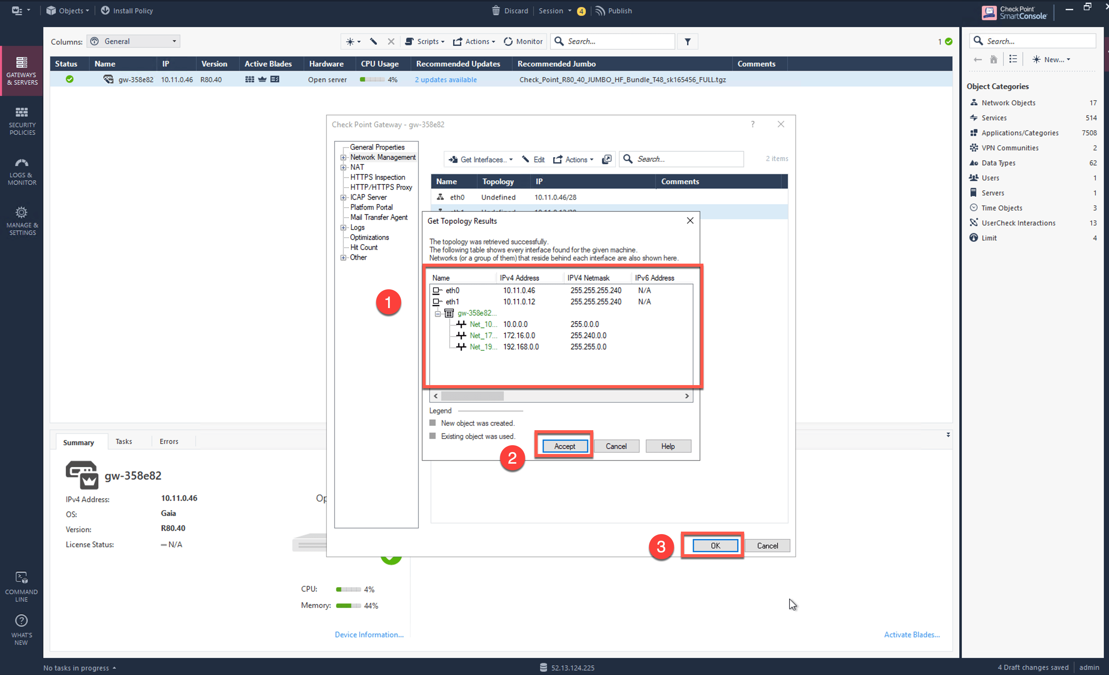

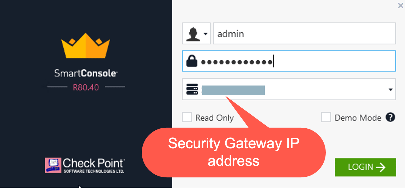

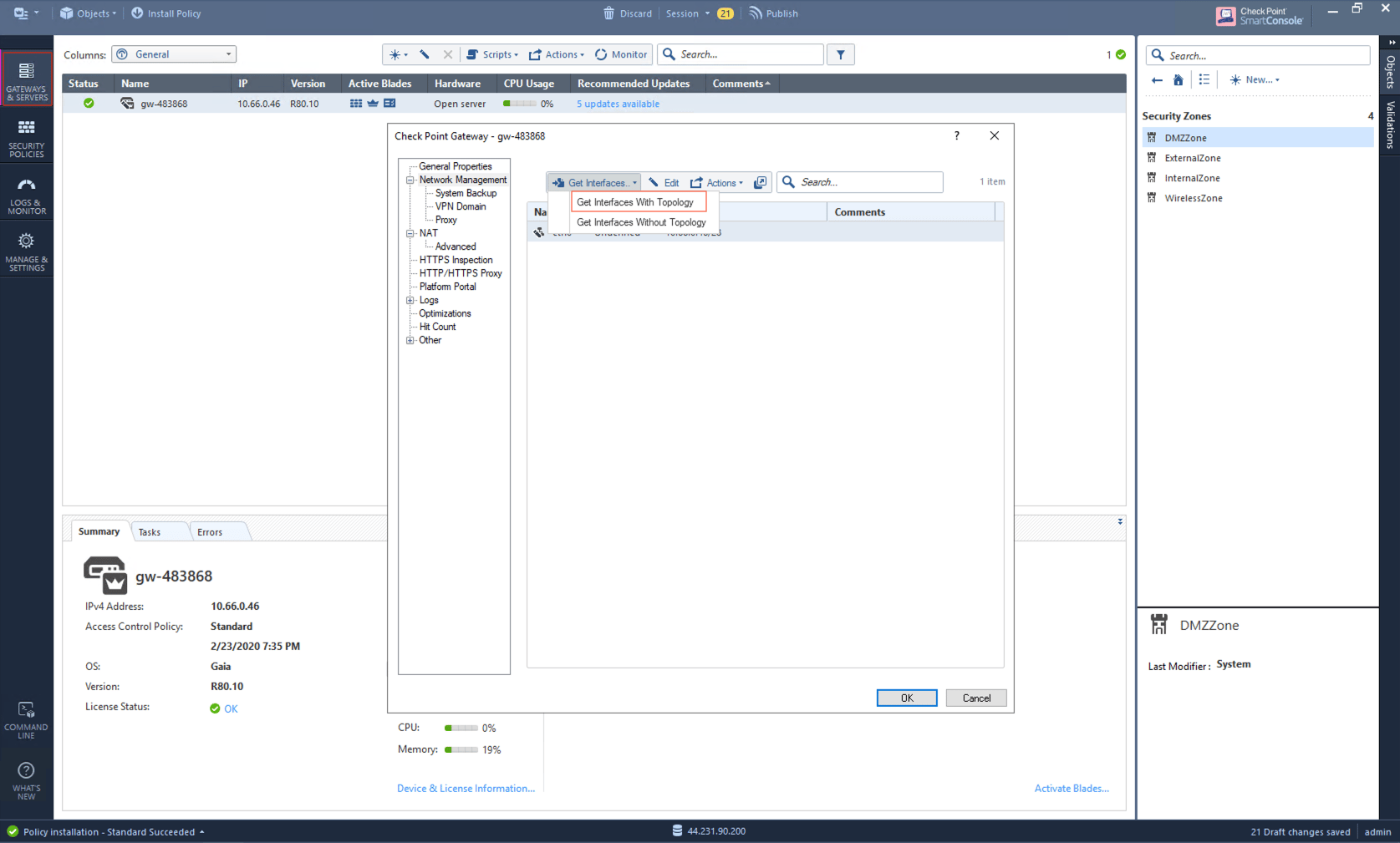

The Check Point SmartConsole is a Windows-based application used to configure and manage polices. These policies can be applied to one or more Security Gateways. Install the SmartConsole and log in with the Gaia Portal username, password and IP Address of the Check Point Gateway. 400 smartconsole_gateway_login_aws Execute the “Get Interfaces With Topology” function to sync up the settings that we have configured via the Gaia Portal.
  1. Select Gateways & Servers on the left.
  2. Double-click on the Check Point Firewall.
  3. Select Network Management on the left.
  4. Click Get Interfaces to expand options.
  5. Click Get Interfaces With Topology.
v2_CheckPoint_SmartConsole_syncup_01

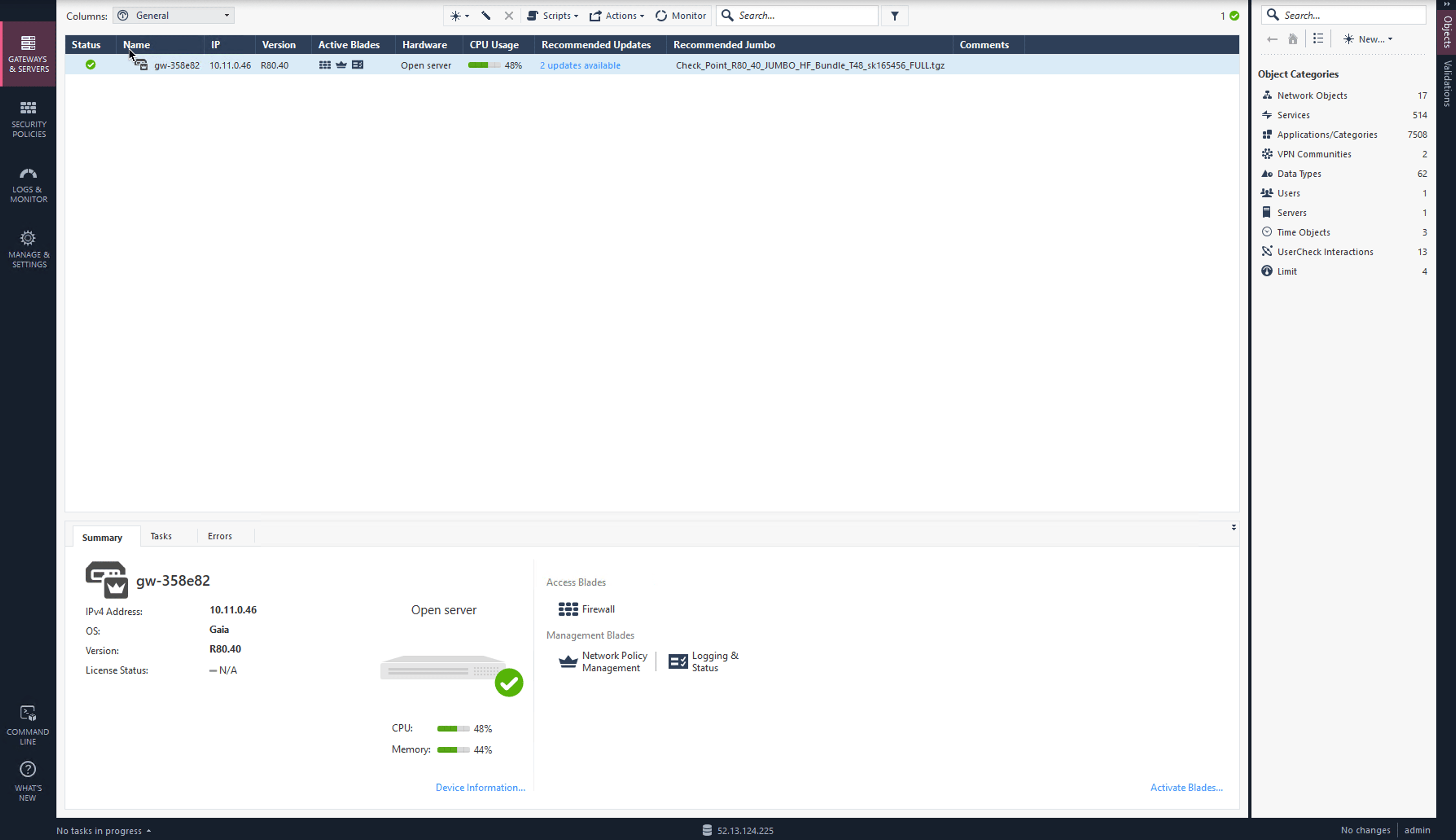

  1. Click Yes.
  2. Review the Get Topology Results which should match to the settings that we have configured via Gaia Portal.
v2_CheckPoint_SmartConsole_syncup_02

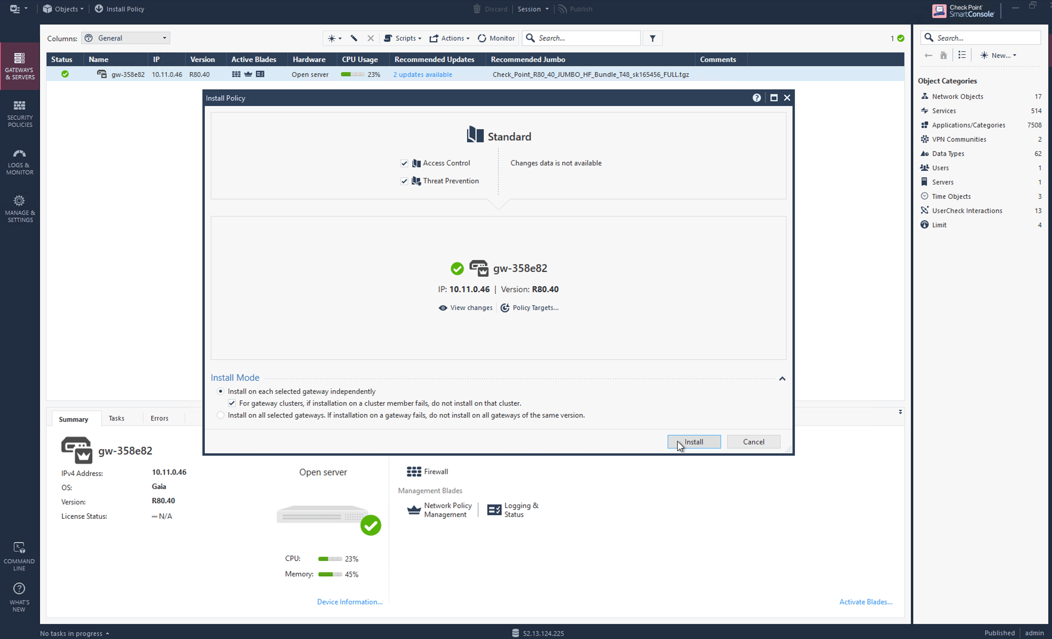

  1. Click Accept.

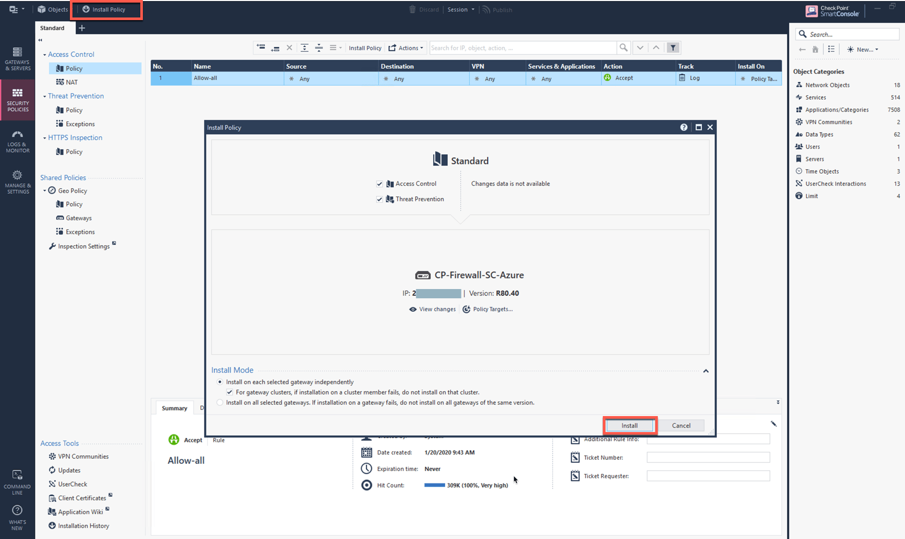

  2. Go to Security Policies > Access Control > Policy and click Install Policy and then Install to commit the settings.
install_policy_aws

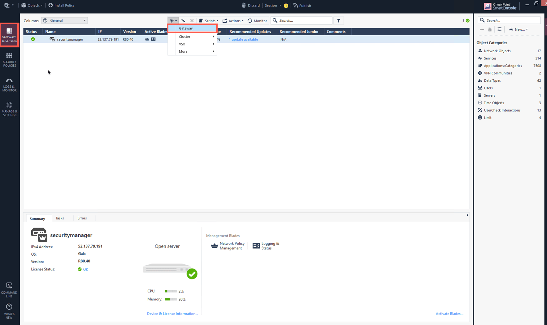

At this point, we have a one-time secure password (SIC Key) which will be used to add a gateway inside Check Point Security Manager. In the SmartConsole add a Gateway as shown below: smartconsole_add_gateway
  1. Click on Wizard Mode.

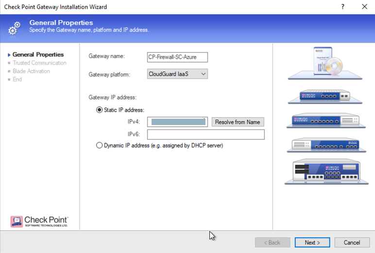

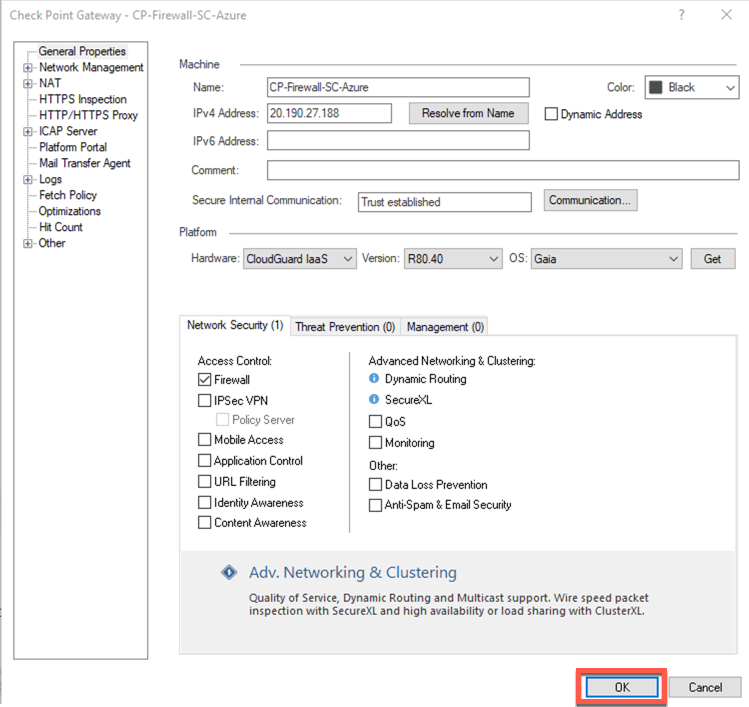

  1. Provide the gateway information as shown in the table:
gw_general_properties

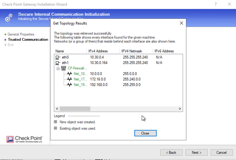

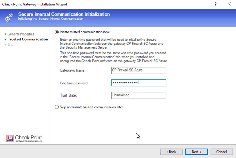

  1. Establish a secure communication with a Gateway.
trusted_communication
If you see an error during communication establishment process that says, “Failed to connect to Security Gateway. SIC has not been established …​”, SSH to your gateway again and repeat the above process.

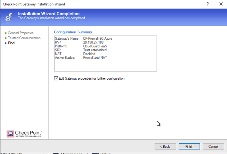

  1. Click OK and Finish.
get_topology

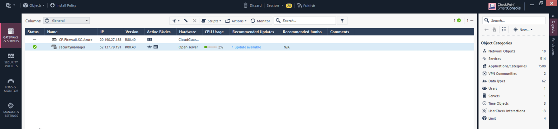

  1. Review the Gateway Summary and click OK.

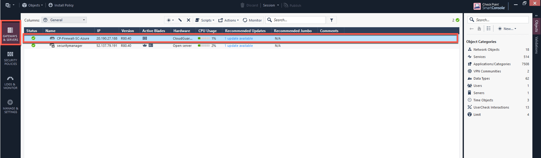

cp_wizard_summary cp_gw_summary At this point you should see a Gateway under the Gateways & Servers tab. cp_gw_added

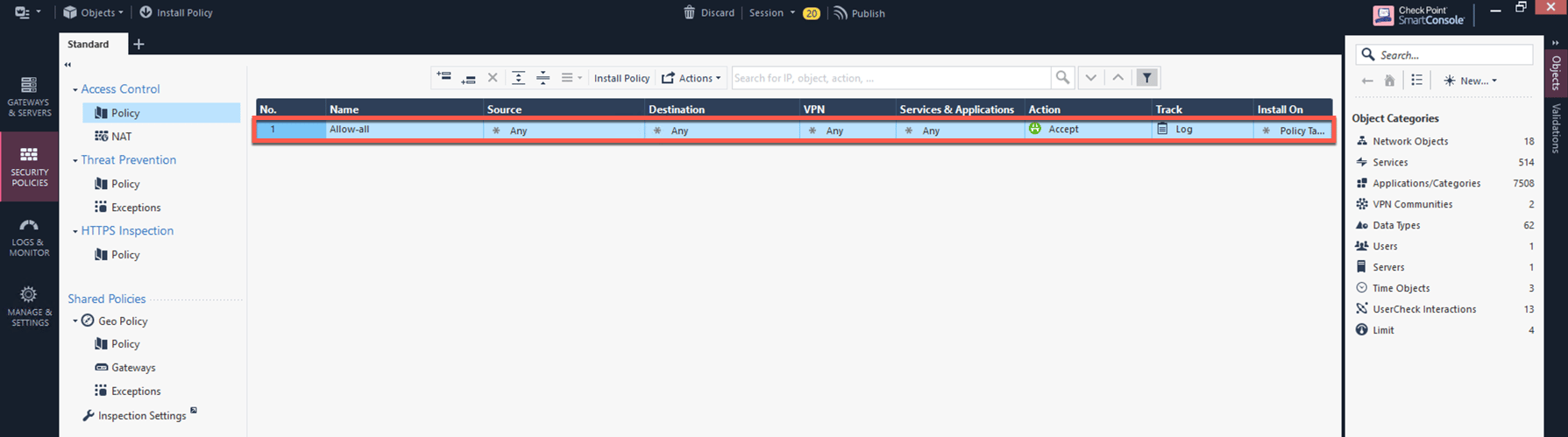

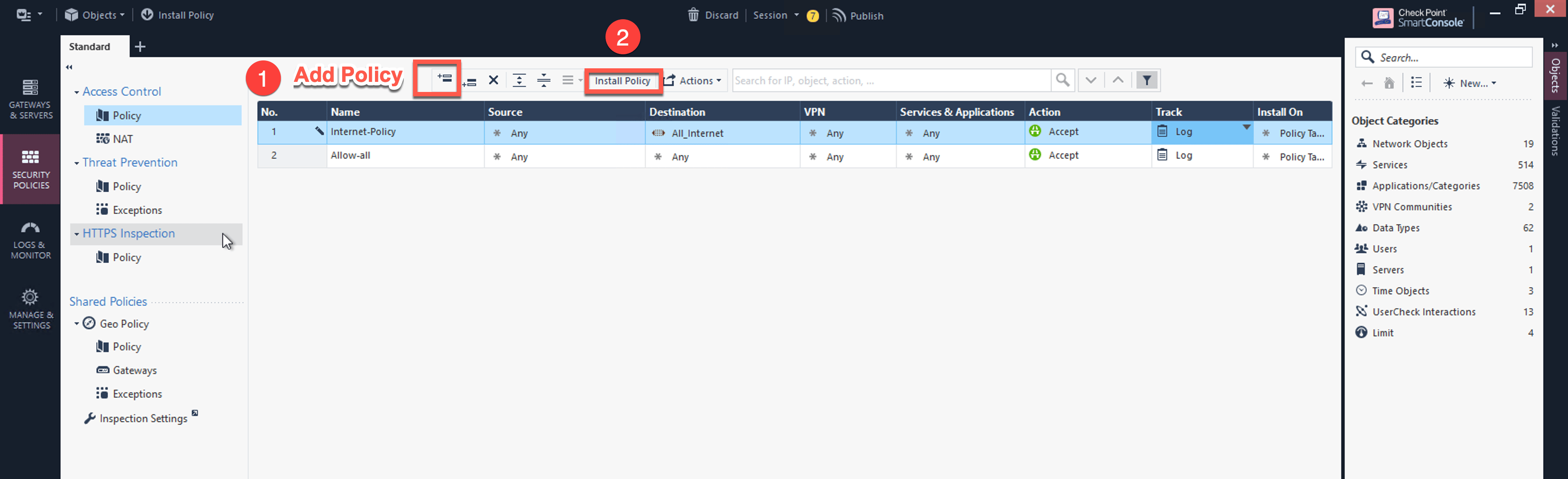

In this step, you will configure a basic traffic security policy that allows traffic to pass through the Security Gateway. In the Check Point UI, navigate to Security Policies > Access Control > Policy and configure a policy by either modifying the default Cleanup rule or adding a new rule above the default rule. basic_allowall_policy Click Install Policy in Smart Console on top left corner, and then Install to commit the settings. install_allowall_policy policy_installed

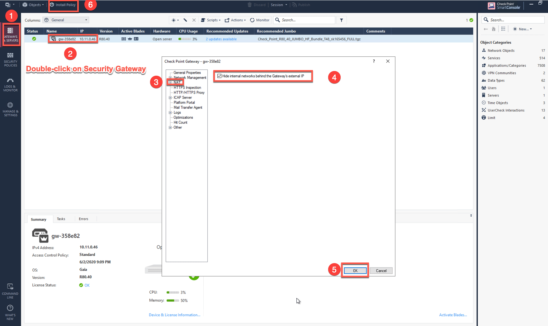

In the Check Point Firewall SmartConsole, navigate to the Gateways & Servers page and then double-click on the gateway to enable NAT function as per the following screenshot.
  1. Click NAT.
  2. Select the Hide internal networks behind the Gateway’s external IP checkbox.
  3. Click OK.
  4. Click Install Policy.
v2_CheckPoint_policy_vpc_to_internet_nat_enabled

(Optional) If you have the default “Cleanup rule”, navigate to Security Policies > Access Control > Policy and inject a new rule for Internet Policy on top of the default Cleanup rule. cp_policy_vpc_to_internet_aws Click Install Policy and then Install to commit the settings.

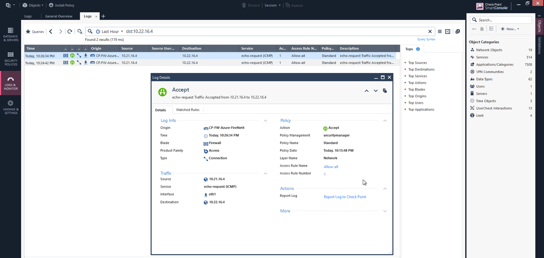

You can view if traffic is forwarded to the firewall instance by logging in to the Check Point Firewall SmartConsole and navigating to the Logs & Monitor page.
For VNet to VNet traffic
To check VNet - VNet traffic in your Check Point for Azure firewall, launch one instance in PROD Spoke VNet and one in DEV Spoke VNet. Start pinging packets from an instance in DEV Spoke VPC to the IP of another instance in PROD Spoke VPC. The ICMP traffic should go through and be inspected in the firewall. cp_view_traffic_log_vpc_to_vpc

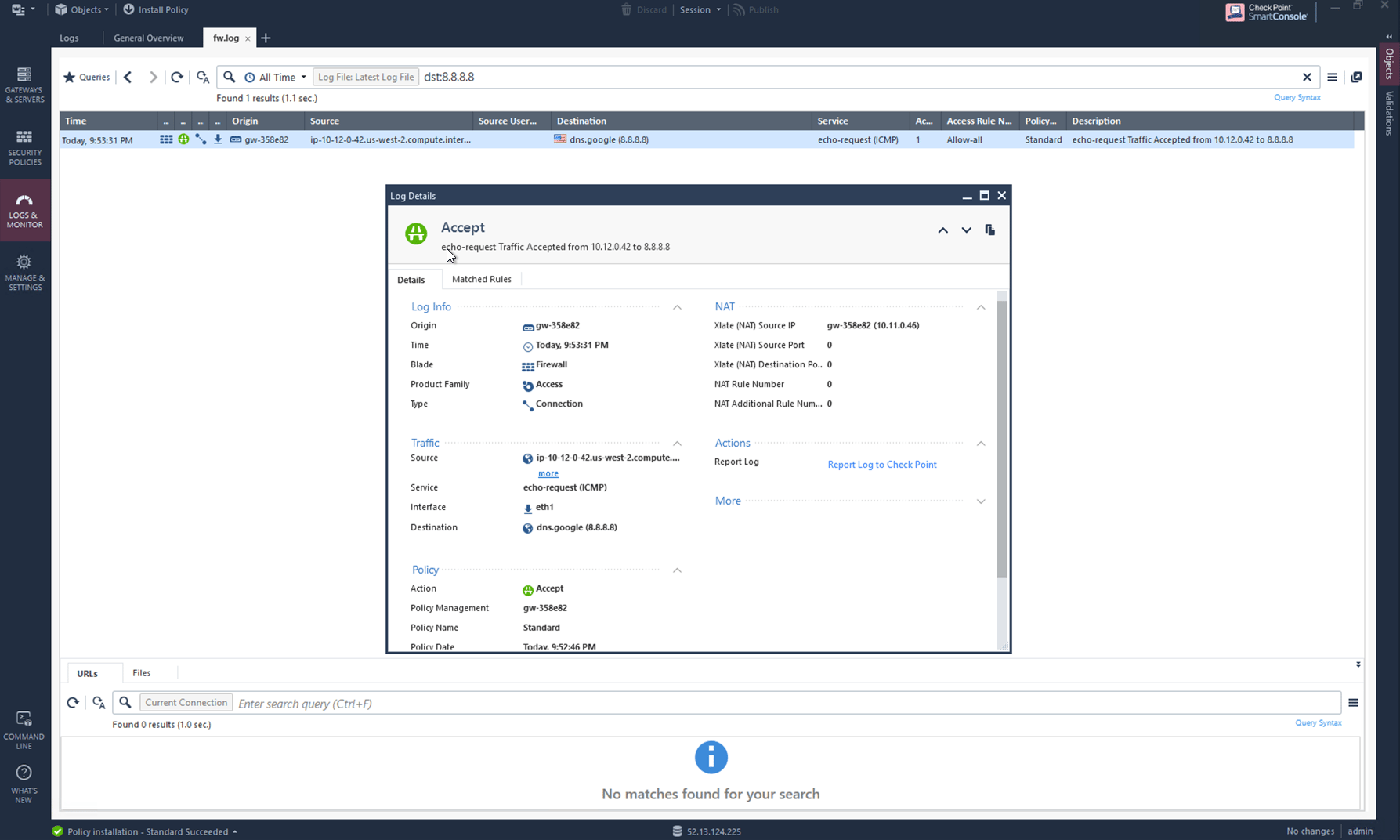

To verify VPC to internet traffic for your Check Point in AWS firewall, launch a private instance in the Spoke VPC (i.e. PROD Spoke VPC) and start pinging packets from the private instance towards Internet (e.g 8.8.8.8) to verify the egress function. The ICMP traffic should go through, and be inspected on the firewall. v2_CheckPoint_view_traffic_log_vpc_to_internet
