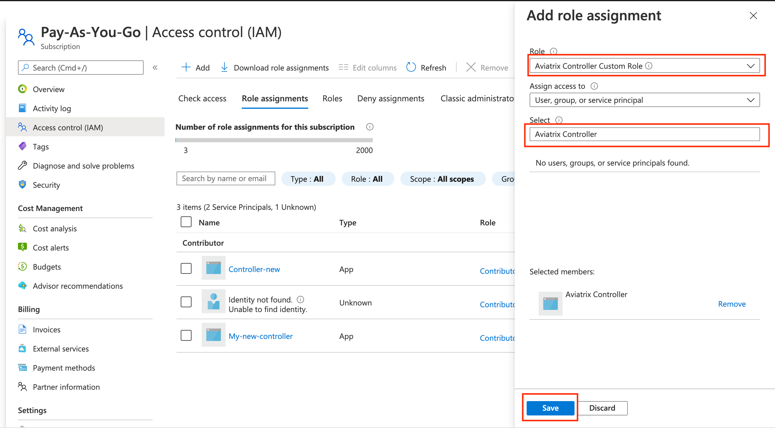

Step 2. Add a Role Assignment in the Azure Portal
In Azure portal > Subscriptions > Access Control (IAM) > Add > Add role assignment. At Role assignment, fill the fields as shown below. Once the above step is complete, you have assigned the My-new-controller (as a service principal) the custom role called “Aviatrix Controller Custom Role.” For more information on how to PowerShell to create custom role on Azure, refer to this link.

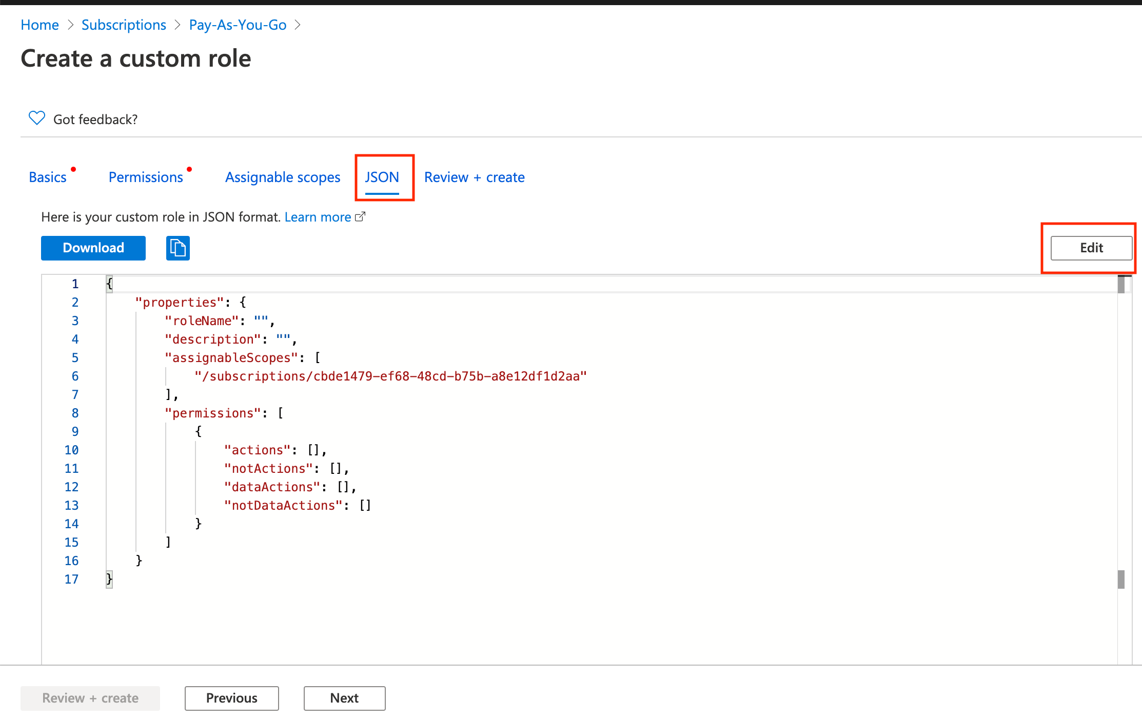

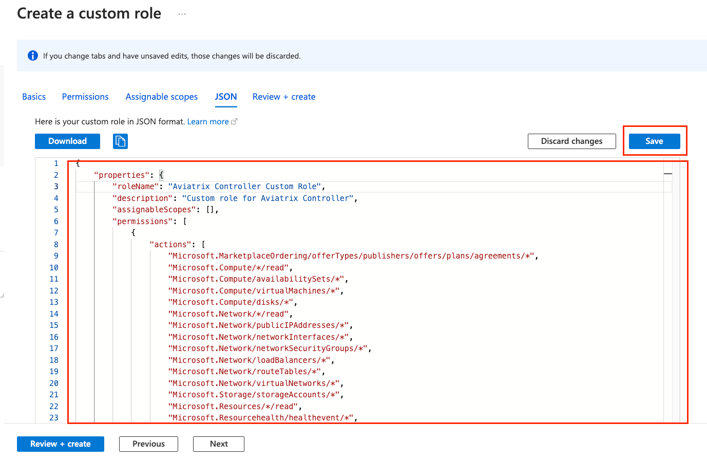

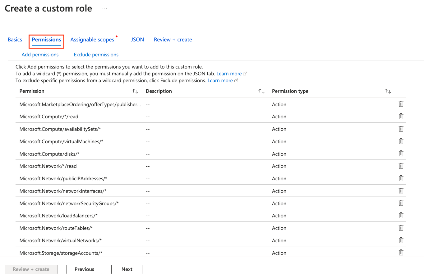

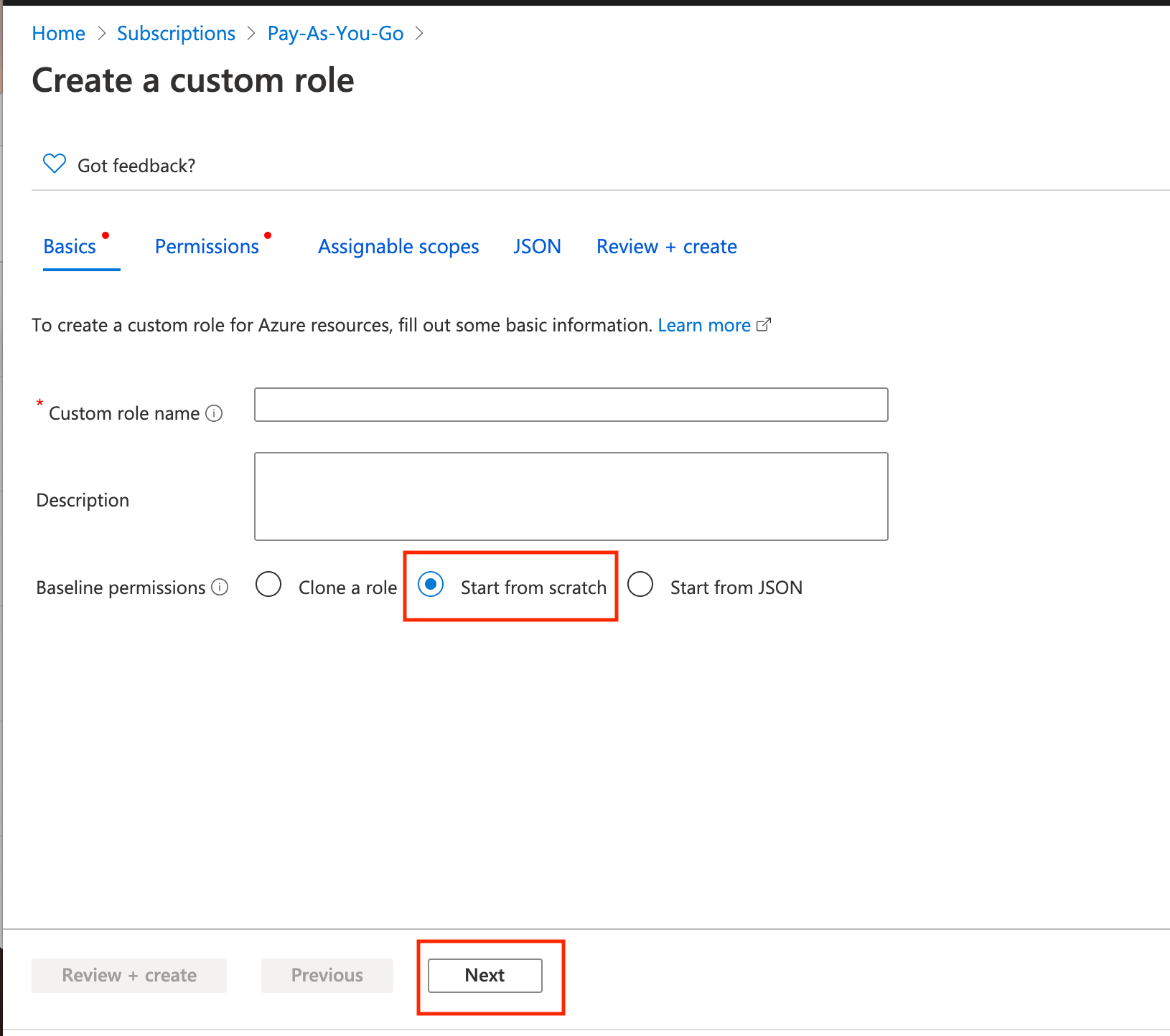

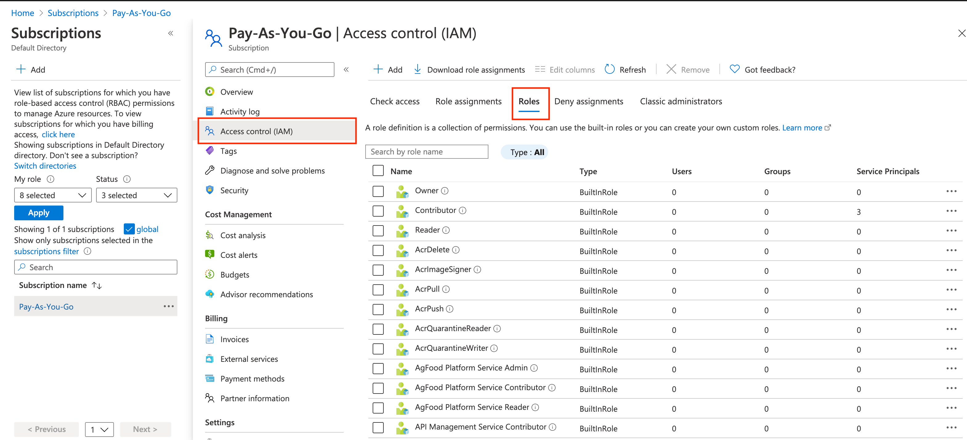

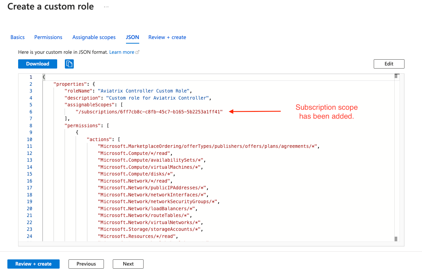

Log in to the Azure portal. Go to Subscriptions. Select the subscription whose network already managed by Aviatrix Controller. Click Access control (IAM). Click Roles, as shown below. iam-role Click +Add and select Add custom role. Select Start from scratch and click Next, as shown below. start-from-scratch Click JSON, and then click Edit. Remove the existing JSON template and copy and paste the above Aviatrix required permissions JSON into the Editor box, as shown below. click-json Click Save. Click Permissions. You should see the permissions have been populated, as shown below. aviatrix-custom-role show-permission Click Assignable scopes and then Add assignable scopes. Select the subscription. Click JSON. You should say the subscription has been added to the assignable Scopes, as shown below. subscription-scope Click Review + create, and then click Create.

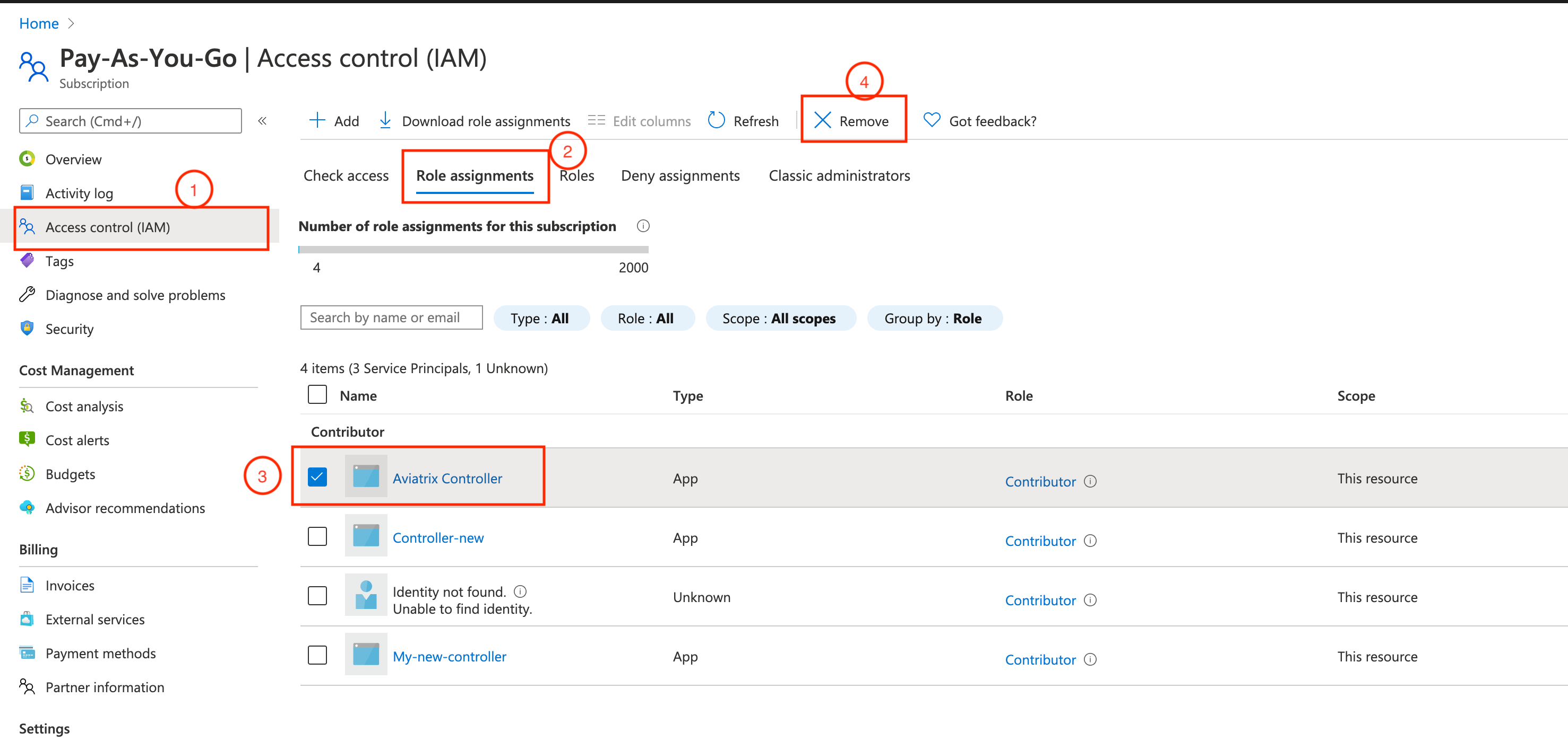

This step is optional. It is only applicable if you have already assigned the “Contributor” role to the Aviatrix Controller service principal. If not, skip this step and proceed to the next step. Now that you have created a custom role called Aviatrix Controller Custom Role, go ahead replace the Contributor role, as shown below. remove_contributor Click +Add, select Add role assignment. Fill in the fields as shown below. replace_role
