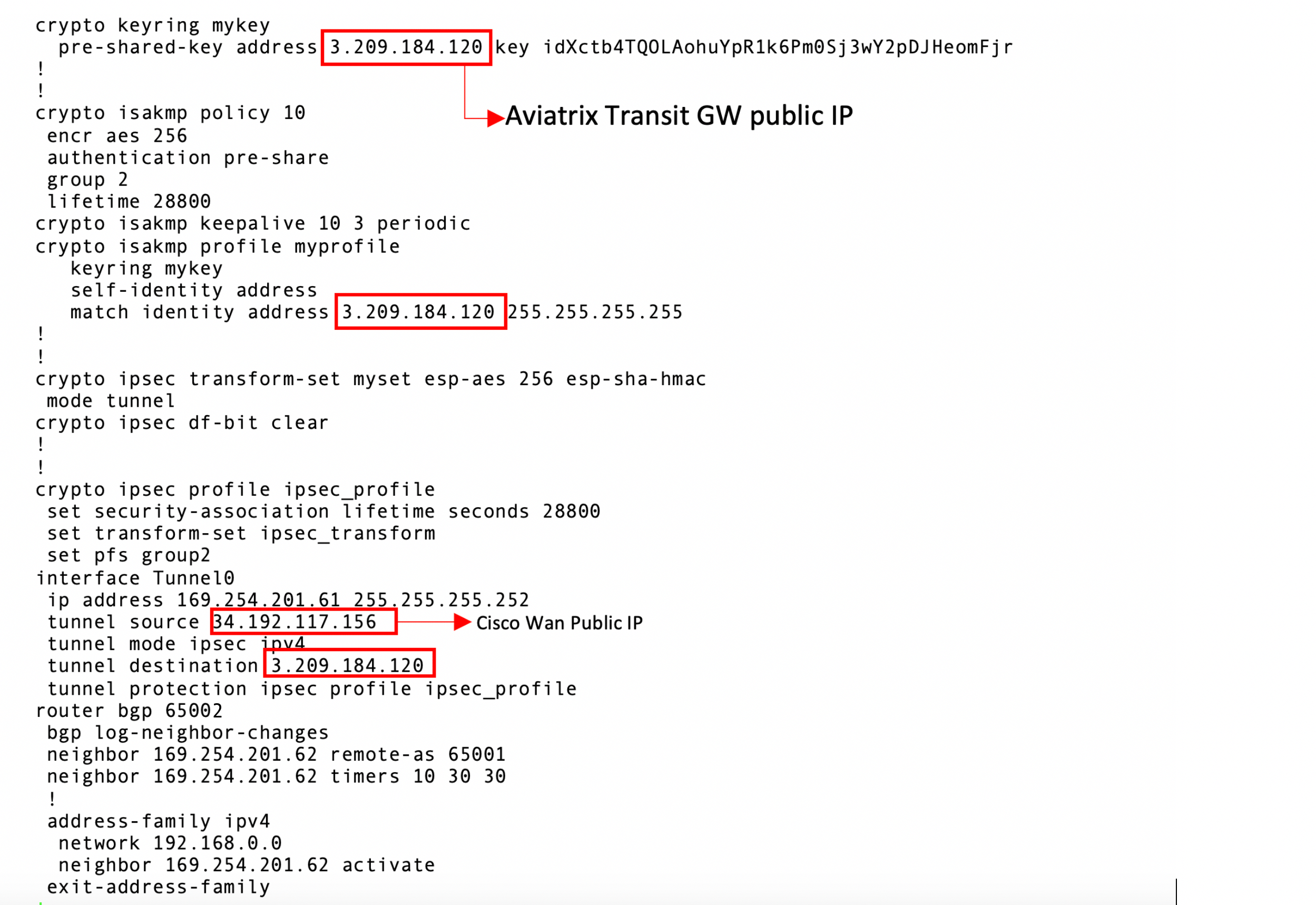

- Ensure that your Cisco Router is configured based on the information in the downloaded file. The following is a sample configuration based on the Site2Cloud configuration above.
The tunnel IP addresses are configured accordingly with the configuration file
downloaded above.
