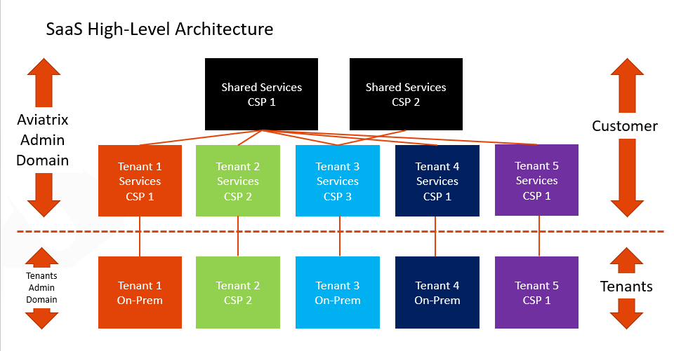

Previously, Software-as-a-Service (SaaS) providers with certain architectures had to deploy Transit gateways for each of their tenants to enable the tenant to connect to their in-cloud network. By using BGP-enabled Spoke gateways in their network architecture, SaaS providers can solve several requirements:
  • Requirement: Connect a large number of tenants (1000+). Solution: Distribute the tenants across Spoke gateways, for horizontal scaling and blast radius minimization.
  • Requirement: Provide both dedicated tenant services, and shared services. Solution: Host dedicated services in tenant-specific Spoke VPCs. Host shared services in common Spoke VPCs.
  • Requirement: Onboard the tenants with BGP: dynamic control plane that fits their operational model. Solution: Terminate BGP on the tenant Spoke gateways.
  • Requirement: Handle overlapping IPs across tenants, and between tenants and shared services. Solution: Use NAT on the tenant Spoke gateways.
  • Requirement: Maintain isolation across tenants. Solution: Use segmentation domains on the tenant Spoke gateways.
  • Requirement: Provide the highest throughput to tenant services. Solution: Horizontal scaling. Tenant services are directly hosted in the Spoke VPC where BGP terminates. They are directly accessed by tenants, without the transit layer to be a bottleneck.

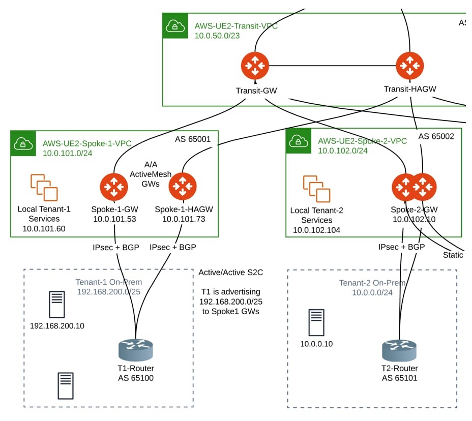

How does using a BGP-enabled Spoke gateway to an external device work?
The Aviatrix Spoke gateway runs a BGP session to an external router to dynamically exchange routes. It also establishes an IPsec tunnel to the router for packet forwarding. BGP is run on top of a S2C connection that terminates on active-mesh Spoke gateways. All Spoke gateways must be active-mesh (no standalone gateway). Each Spoke gateway must have a unique Autonomous System (AS) number. The following features are supported:
  • Fully integrated with ActiveMesh 2.0 control plane.
  • Route-based only.
  • Active/Active HA is supported for ActiveMesh and for on-prem with ECMP across multiple BGP connections. Active/Standby S2C is also supported.
  • Co-existence of BGP S2C with static S2C connections under the same Spoke gateway is supported.
  • FireNet is supported. The inspection policy is the entire Spoke gateway including all the BGP routes (not individual S2C BGP sessions).

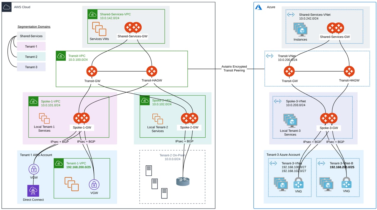

Interactions with Segmentation Domains
When using BGP-enabled Spoke gateways, SaaS providers can use segmentation domains per Spoke gateway to enforce isolation across tenants. When segmentation domains are set per BGP-enabled Spoke gateway, the Site-to-Cloud (S2C) BGP connection respects the domain of the Spoke gateway for traffic enforcement and route advertisement. All S2C connections on a given Spoke gateway belong to the Spoke gateway domain (currently, you cannot have different S2C connections on a given Spoke gateway be assigned to different domains). BGP routes of a tenant are always advertised to all other tenants connected with S2C BGP under the same Spoke gateway. This cannot be controlled with segmentation policies. It is controlled using the Connection Manual BGP Advertised Network List. BGP routes of a tenant are propagated into ActiveMesh based on the connection policies of the Spoke gateway. ActiveMesh routes are advertised over BGP based on the connection policies of the Spoke gateway.
Interactions with NAT
  • Customized NAT under Gateway config is supported (mapped NAT under S2C config is not currently supported).
  • S2C BGP connections are available as option in the NAT connection.
  • ActiveMesh connections are available in the NAT connection but ONLY for non-HPE spoke gateways.
  • Many:1 and 1:1 NAT are possible.
  • Active - Active HA for both gateways and S2C connections (with flow affinity) is supported. This means that return traffic goes to the same Spoke Gateway that performed NAT (not valid for Mapped NAT).

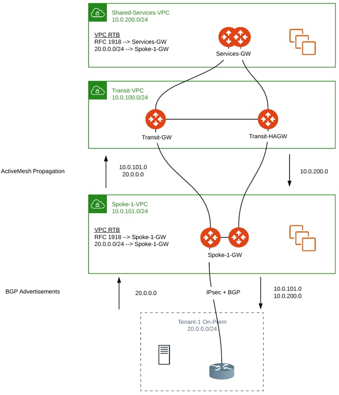

Route Propagation
Spoke VPC CIDR + BGP prefixes received on the Spoke gateway are propagated into ActiveMesh (Subnets outside of RFC 1918 are programmed on the VPC RTBs). All CIDRs known to ActiveMesh (Spoke VPCs for all regions and clouds + BGP prefixes + custom advertisements, etc.) are advertised over BGP on the Spoke Gateway S2C BGP connections. bgp_spoke_route_propagation

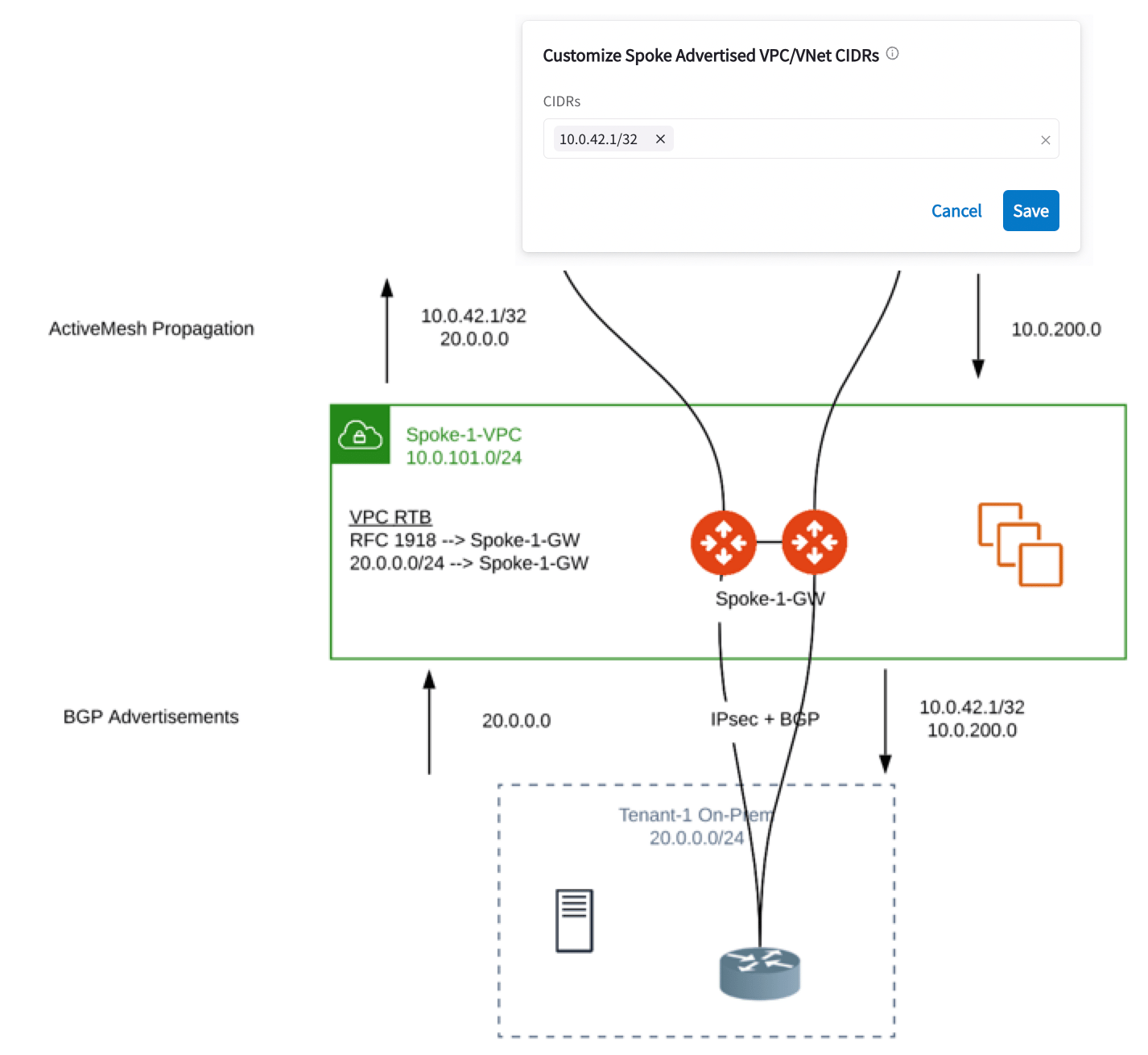

Customize Spoke Advertised VPC/VNet CIDRs
You can customize Spoke Advertised VPC/VNet CIDRs for the Spoke gateway included in this configuration. The CIDRs are propagated into ActiveMesh and into BGP as belonging to the Spoke Gateway shown in the example.
  1. Navigate to Cloud Fabric > Gateways > Spoke Gateways.
  2. Select the Spoke gateway from this configuration.
  3. On the Settings tab, on the Customize Spoke Advertised VPC/VNet CIDRs card, enter the CIDRs to advertise. These will display under Advertised Routes on the Diagnostics > Cloud Routes > BGP Info tab.
  4. Click Save.
spokegw_external_custom_adv_cidrs ActiveMesh propagation: those CIDRs are combined with the BGP prefixes received on the S2C BGP connection(s) of the Spoke Gateway. BGP advertisement: those CIDRs are combined with all other ActiveMesh CIDRs from the Aviatrix Transit.
