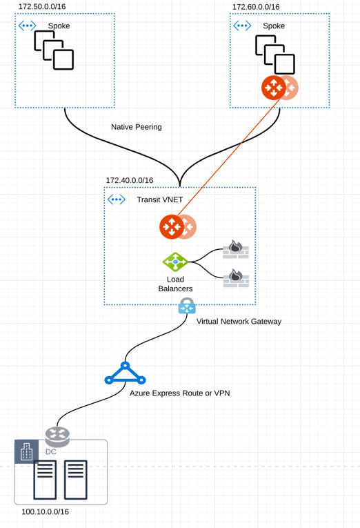

This setup is illustrated by a network design featuring two Spoke VNets: one with an Aviatrix Spoke Gateway (172.60.0.0/16) and one native Spoke VNet (172.50.0.0/16). topology_expressroute The key ideas for this solution are:
  • The edge (WAN) router establishes a BGP session with Azure VNG via ExpressRoute or VPN. The edge router advertises on-premises routes to Azure VNG, while Azure VNG advertises Spoke VNet CIDRs.
  • The Aviatrix Controller periodically retrieves route entries from the Transit VNet VNG route table—these routes are advertised from on-premises. The Controller then propagates these routes to both Spoke VNets and the Aviatrix Transit Gateway.
  • Azure native VNet Peering is configured between each Spoke VNet and the Transit VNet VNG. The Allow Remote Gateway attribute is set on the Spoke VNets to automatically advertise routes from the Spoke VNets to VNG to on-premises.
  • Traffic arriving from on-premises to the VNG is routed to the Azure Load Balancer, which then forwards traffic to both Aviatrix Transit Gateways (for active-mesh deployment). The same Load Balancer also distributes traffic to firewalls for inspection.
  • Traffic originating from Spoke VNet is routed directly to Aviatrix Transit Gateway, which then forwards the traffic to the Azure Load Balancer.

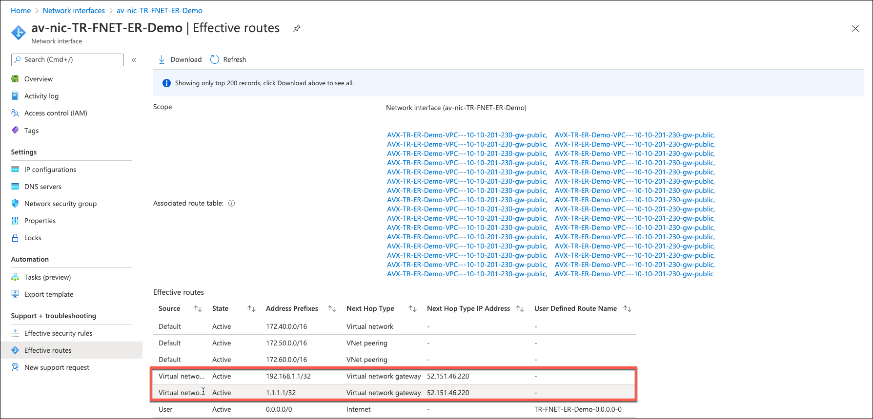

Check Effective Routes Info on Azure Portal
  1. Log in to the Azure portal and search for “Network interfaces” using the search bar.
  2. Select the interface associated with the Aviatrix Transit Gateway.
  3. Go to the Effective routes page by selecting Effective routes under the Support + troubleshooting section.
  4. Review the route entry for On-premises, where the Next Hop Type should be Virtual network gateway. azure_effective_routes_routing_entry
