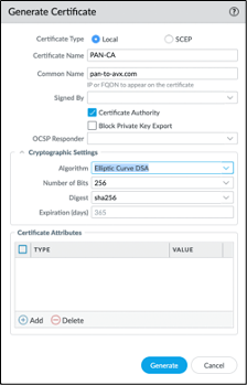

If you are creating a Site2Cloud connection between your Palo Alto VM-Series firewall and your Aviatrix gateway in the cloud and want to use certificate-based authentication, you must generate a CA certificate in the firewall UI that you will upload to Aviatrix CoPilot under Networking > Connectivity > Certificates. See Create a Self-Signed Root CA Certificate for more information on certificates in Palo Alto.
  1. In the Palo Alto VM-Series firewall UI, navigate to Device > Certificate Management > Certificates > Device Certificates.
  2. Click Generate at the bottom of the window. The Generate Certificate dialog displays.
generate cert
  1. Fill out the following information:
    • Certificate Name: a name that makes sense to you, such as PAN-CA
    • Common Name: a descriptor that makes sense to you, such as pan-to-avx.com
    • Signed By: select Certificate Authority
    • Cryptographic Settings:
      • Select Elliptic Curve DSA (ECDSA); this is currently the only algorithm supported by Site2Cloud cert-based authentication.
      • Select 256 bits
      • Select sha256 digest
  2. Click Generate. This creates the root CA certificate that will be used to sign the PAN to Aviatrix certificate you will create in the next step.

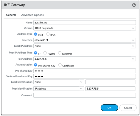

  1. In the Palo ALTO VM-Series UI, navigate to Network > Network Profiles > IKE Crypto, click Add and define the IKE Crypto profile (IKEv1 Phase-1) parameters.
  1. If using PSK (Pre-shared Key) for authentication with Site2Cloud, navigate to Network > Network Profiles > IKE Gateways to configure the IKE Phase-1 Gateway. These parameters should match the Site2Cloud configuration downloaded under Setting up External (S2C) Connection.
According to the Palo Alto Networks official documents, it is not necessary to add the Peer Identification. However, Aviatrix recommends adding it, to make sure the tunnel is working. In the event that the IPsec tunnel is up but traffic is not passing between the Cloud and on-premises, you may want to enable NAT-T in Palo Alto Networks Firewall.
  1. Under Advanced Options, select the IKE Crypto profile created in step 1 of this procedure.
ike gw 2

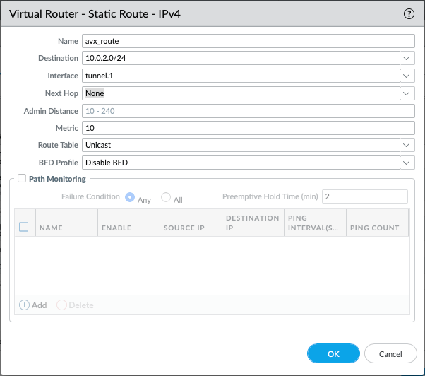

  1. Under Network > Virtual Routers, click on the virtual router profile, then click Static Routes > default, and add a new route with the VPC1 private subnet as the destination.
  1. Commit the configuration. The IPsec tunnel status turns green.
  1. If using certificate-based authentication with Site2Cloud:
    1. Go to Network > Network Profiles > IKE Gateways. These parameters should match the SIte2Cloud configuration downloaded under Setting up External (S2C) Connection.
    2. In the IKE Gateway dialog enter the following:
  1. Click OK.
