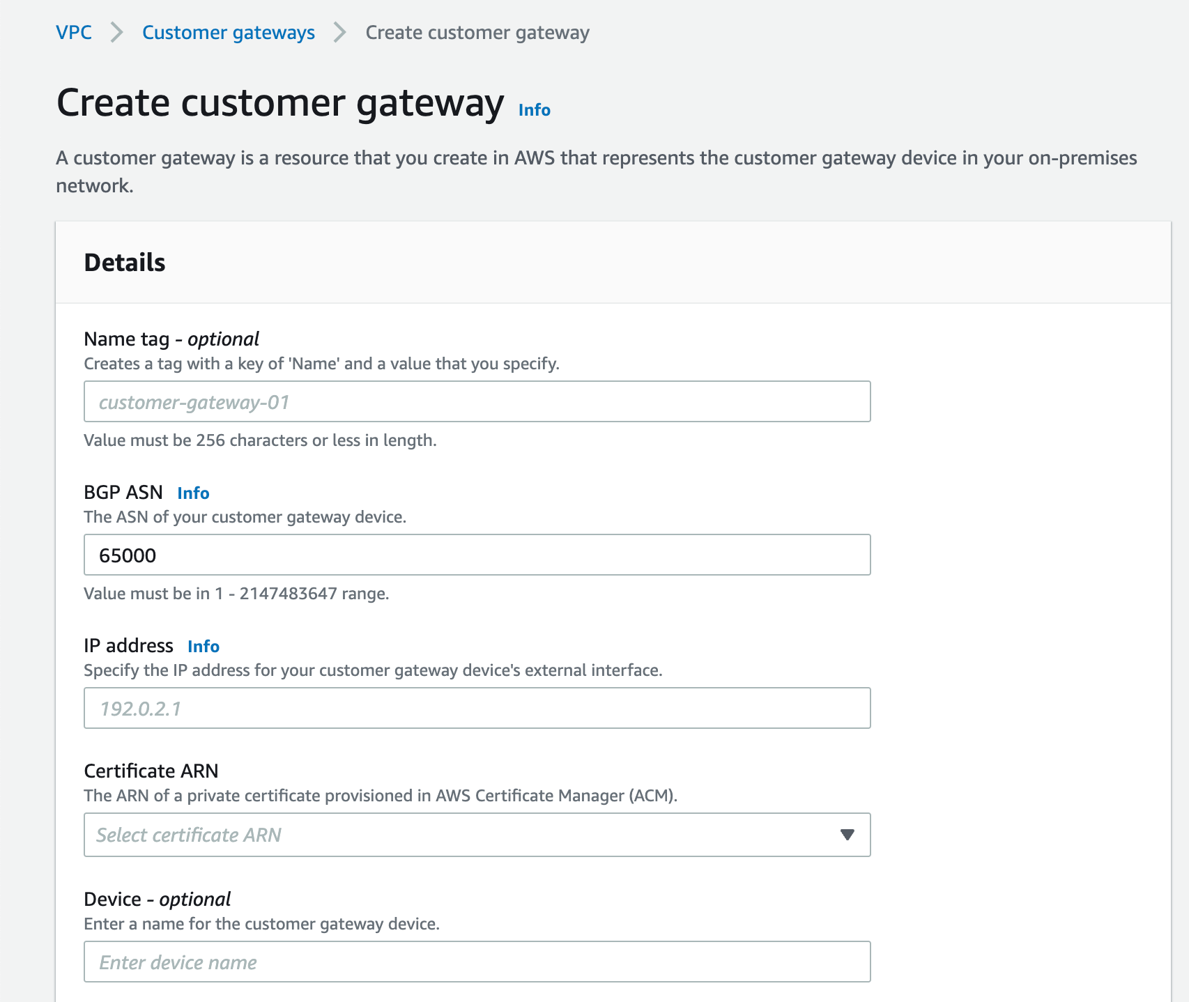

  1. Log in to your VPC Dashboard in the region where your VGW is located.
  2. Create a new Customer Gateway. In the IP address field, enter the public IP address of the Aviatrix Gateway. awscg

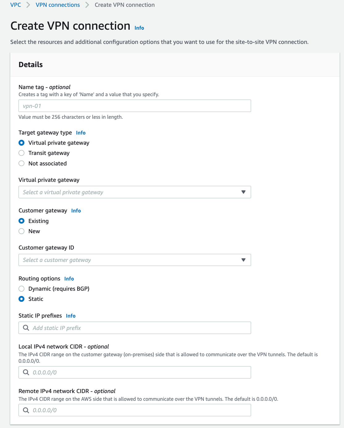

  1. Create a VPN Connection. aws vpn connection
  2. You can leave the Tunnel 1 and 2 options as their defaults. Click Create VPN connection.

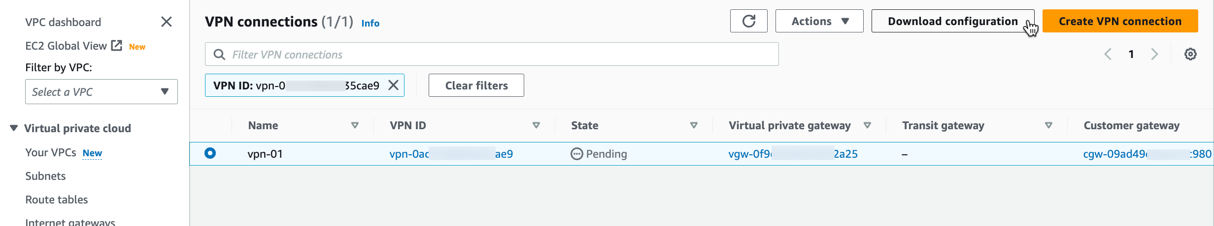

  3. Select the VPN you just created and click Download Configuration. download vpn configuration

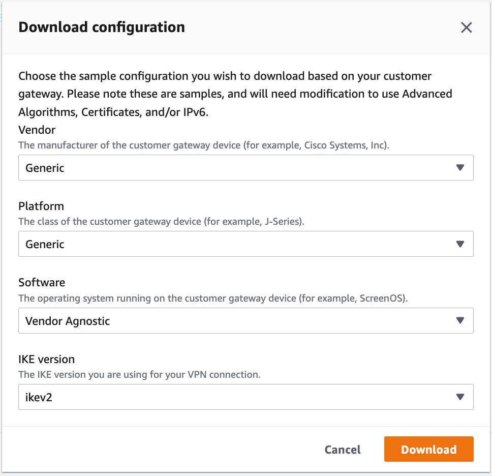

  4. At the dialog, select Generic for the Vendor, Generic for the Platform and Vendor Agnostic for the Software.
  5. Click Download. You will use this file to create the other side of the tunnel. download vpn configuration dialog

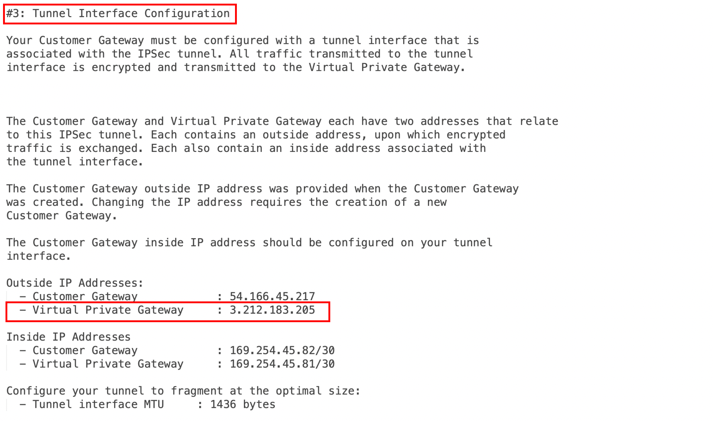

  • Remote Device IP: Enter the value that matches #3: Tunnel Interface Configuration > Outside IP Addresses > Virtual Private Gateway from the downloaded file (in this example, 3.212.183.205)
