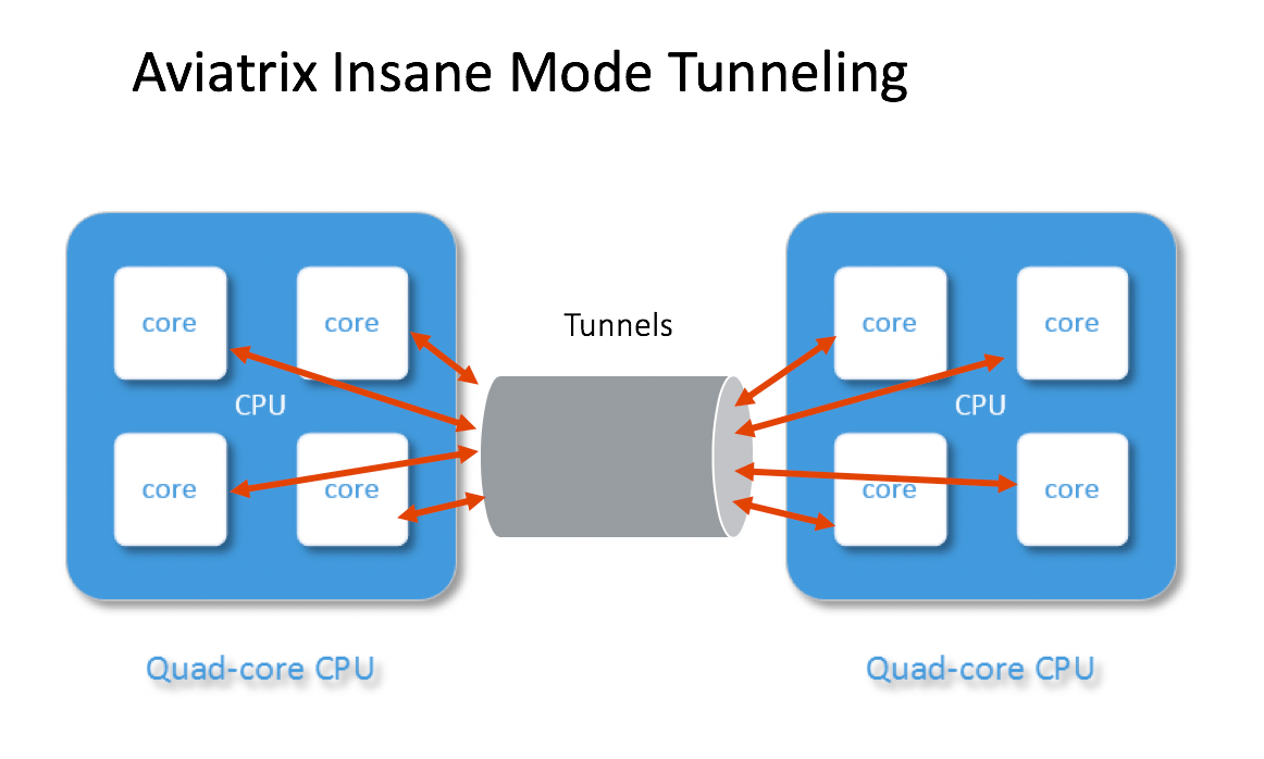

Aviatrix High Performance Encryption tunneling techniques establish multiple tunnels between the two virtual routers, thus allowing all CPU cores to be used for performance scaling with the CPU resources, as shown below. insane_tunnel_diagram With Aviatrix High Performance Encryption Mode tunneling, IPsec encryption can achieve 10Gbps, 25Gbps and beyond, using the multiple CPU cores in a single instance, VM or host.

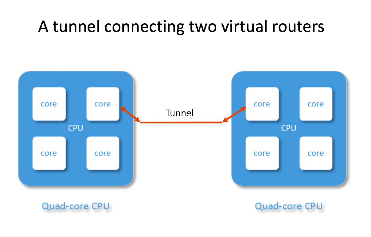

In the current Transit VPC/VNet solution, the throughput is capped at 1.25Gbps regardless of whether you have a 10Gbps connection between an on-premises network and the cloud (Direct Connect (DX)/ExpressRoute/FastConnect/InterConnect) link. This is because the Transit VPC/VNet deployment relies on an IPsec session between the Virtual Private Gateway (VGW)/VPN Gateway and Transit Gateway, and the VGW/VPN Gateway itself has a performance limitation. AWS VGW and other Cloud Service Providers’ IPsec VPN solutions have a published performance cap of 1.25Gbps. Most virtual routers or software-based routers are built with general purpose CPUs. Despite the vast CPU technology advancement, why does IPsec performance not scale further? It turns out the problem lies in the nature of tunneling, a common technique in networking to connect two endpoints. When two general purpose server or virtual machine-based routes are connected by an IPsec tunnel, there is one UDP or ESP session going between the two machines, as shown below. tunnel_diagram In the above diagram, the virtual router has multiple CPU cores, but since there is only one tunnel established, the Ethernet Interface can only direct incoming packets to a single core, thus the performance is limited to one CPU core, regardless how many CPU cores and memory you provide. This applies to all tunneling protocols, including IPsec, GRE, and IPIP.

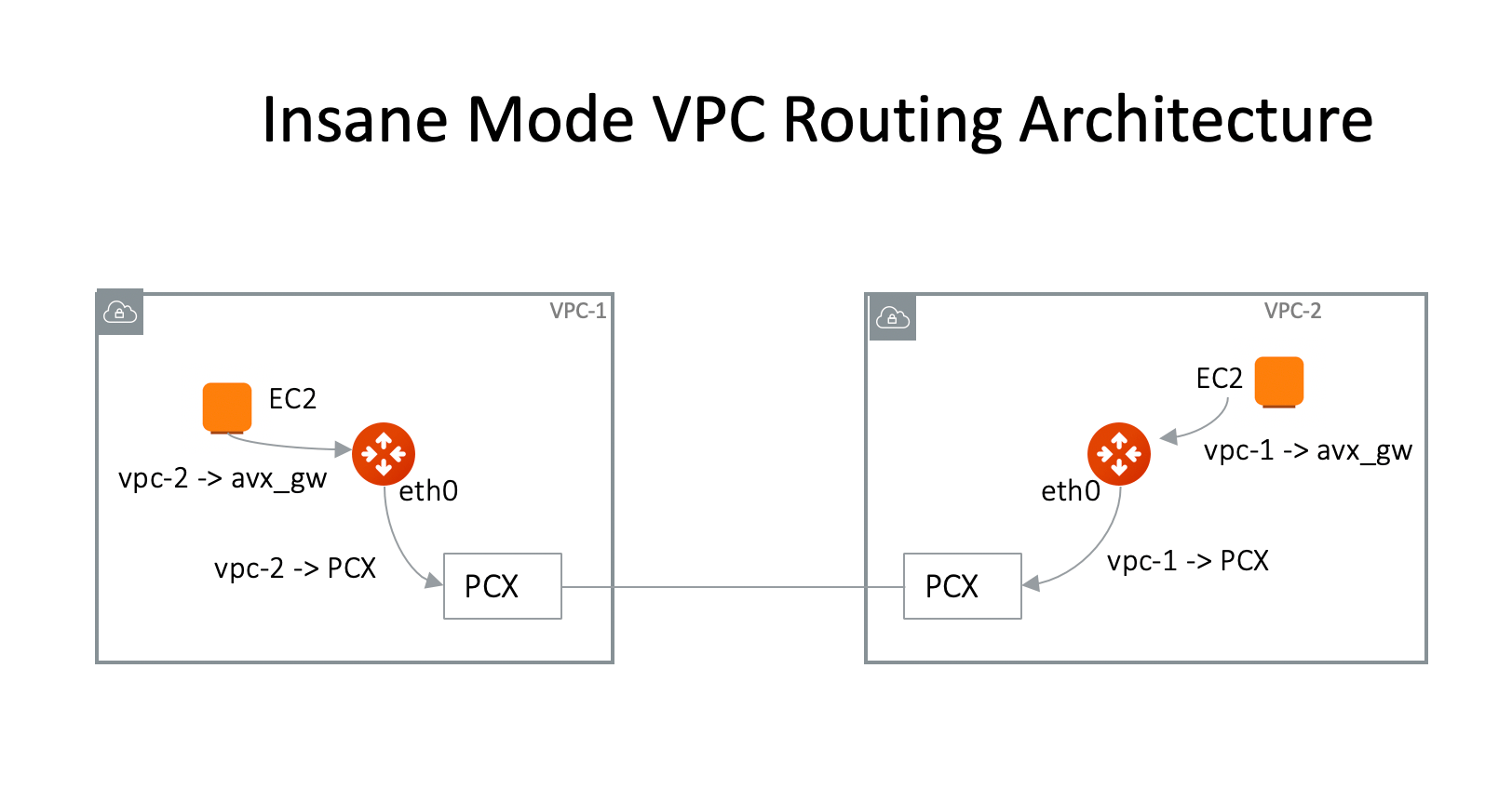

When a gateway is launched with High Performance Encryption enabled, a new /26 public subnet is created where the High Performance Encryption Mode gateway is launched on. Aviatrix High Performance Encryption builds high performance encryption tunnel over private network links. The private network links are Direct Connect (DX)/AWS Peering (PCX), Azure ExpressRoute, GCP FastConnect, and OCI InterConnect. For High Performance Encryption between two gateways, between a Transit Gateway and a Spoke Gateway, or between two Transit Gateways (Transit Peering), the Aviatrix Controller automatically creates the underlying peering connection and builds the tunnels over it. Since High Performance Encryption tunnels are over private network links, the VPC/VNet route architecture is described as below, where virtual machine (EC2/GCE/OC) instances associated route entry to the remote site point to Aviatrix Gateway, and the Aviatrix Gateway instance associated route entry to remote site points to PCX or VGW. insane_routing

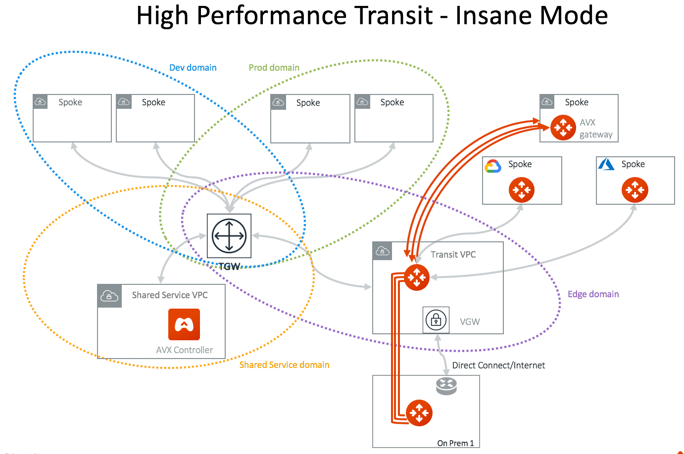

Aviatrix High Performance Encryption Mode is integrated into the Transit Network solution to provide 10Gbps performance between on-premises networks and Transit VPC/VNet with encryption. For VPC/VNet to VPC/VNet, High Performance Encryption Mode can achieve 25 - 30Gbps. High Performance Encryption Mode can also be deployed in a flat (as opposed to Transit VPC/VNet) architecture for 10Gbps encryption. The diagram below illustrates the high performance encryption between Transit VPC/VNet and on-premises networks, between Transit VPC/VNet and Spoke VPC/VNet. insane_transit
