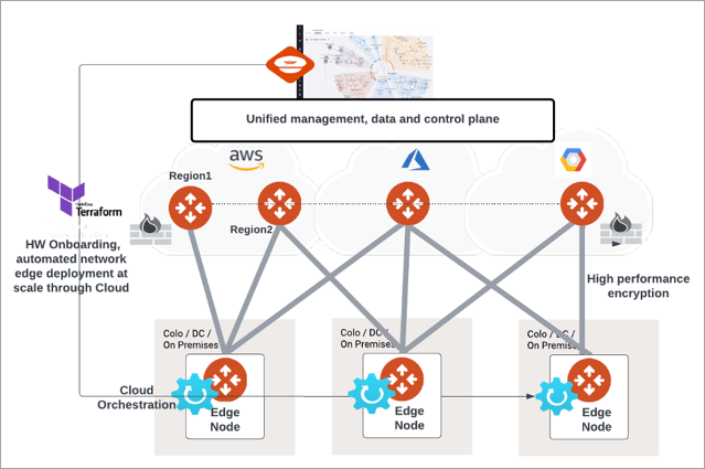

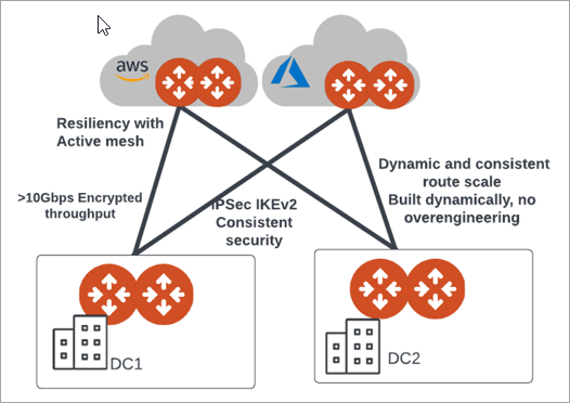

Extend Aviatrix to Edge Locations
This diagram illustrates Aviatrix Edge Gateways deployed at multiple edge locations.
Aviatrix Edge Spoke Gateway for On-Premises
Cloud Orchestration and Simplified Onboarding
Ease of onboarding- Instantly onboard HW orchestrated via Cloud
- Manage and operate the Edge HW and network software via cloud
- No IT expertise required to connect and deploy the Edge HW
- Simplified deployment with automation
- Deploy Edge network software to multiple devices at scale via Cloud
- Single automation stack across cloud and on-prem
- Faster deployment and onboarding of connectivity from on-prem to cloud and on-prem to multi-cloud

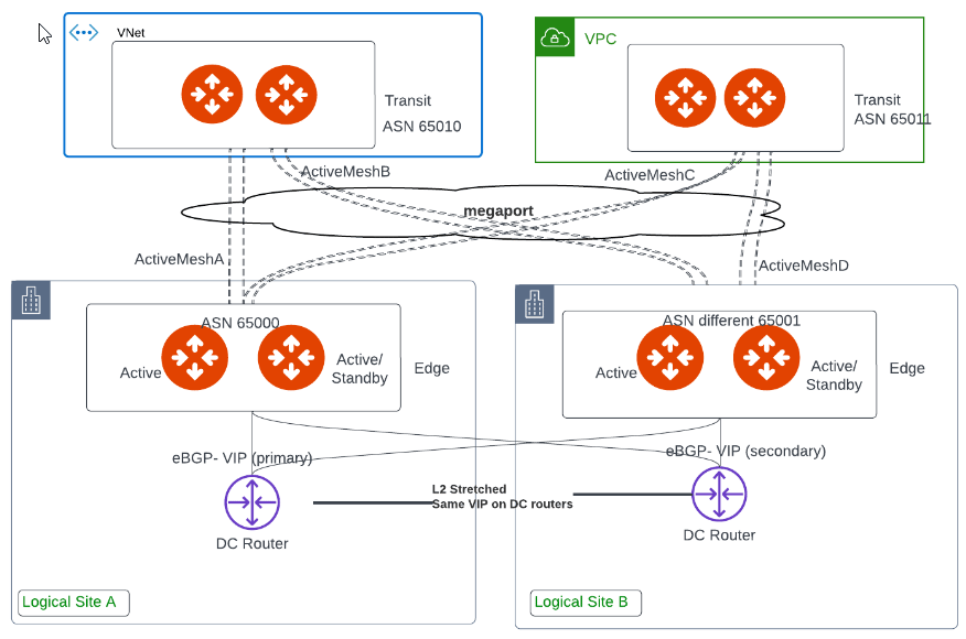

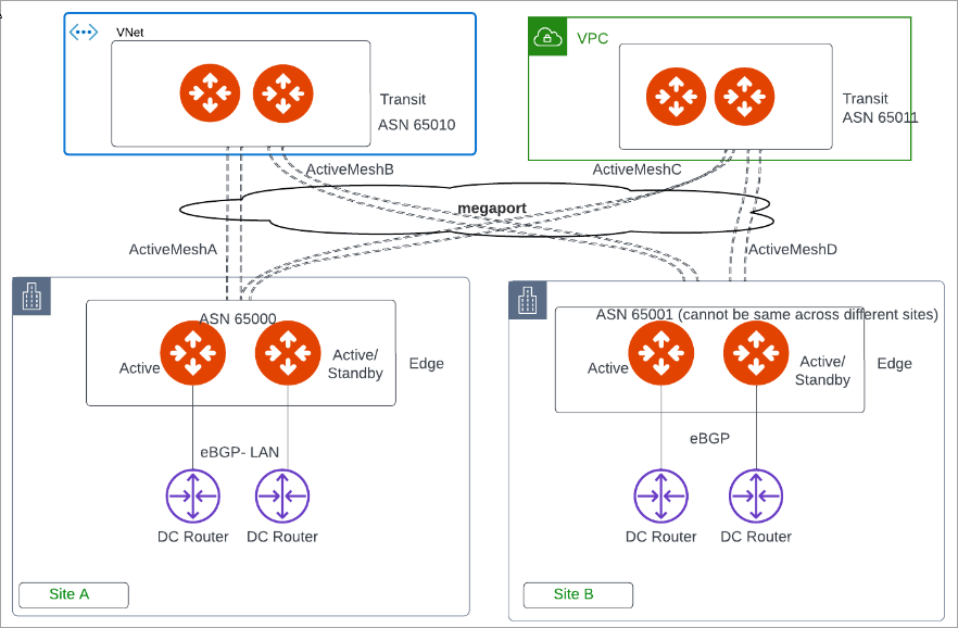

Multiple Edge Spoke Gateways for Multiple Edge Sites
This use case illustrates Edge Gateways with BGP connection to a VIP. The Edge Gateways can be set up at multiple edge sites as shown in the diagram with Site A and Site B.

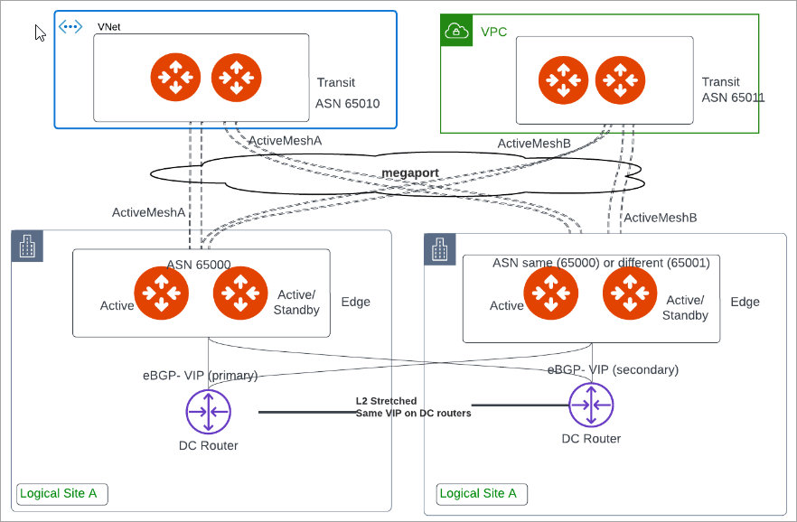

Multiple Edge Spoke Gateways for Single Edge Site
This use case illustrates multiple Edge Gateways on the same edge site for horizontal scaling or multiple Active-Active connections from cloud to edge.

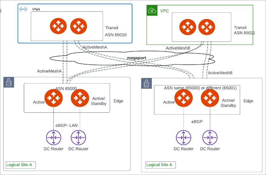

Edge Spoke Gateway Connectivity to Different LAN Routers (Multiple Sites)
This use case illustrates Edge Gateways on different edge sites with active and standby peering connections to different LAN routers.
Edge Spoke Gateway Connectivity to Different LAN Routers (Single Site)
This use case illustrates multiple Edge Gateways on the same edge site with peering connections to different LAN routers.Only Active-Active high availability mode is supported with more than two Edge
Gateways on the same site.

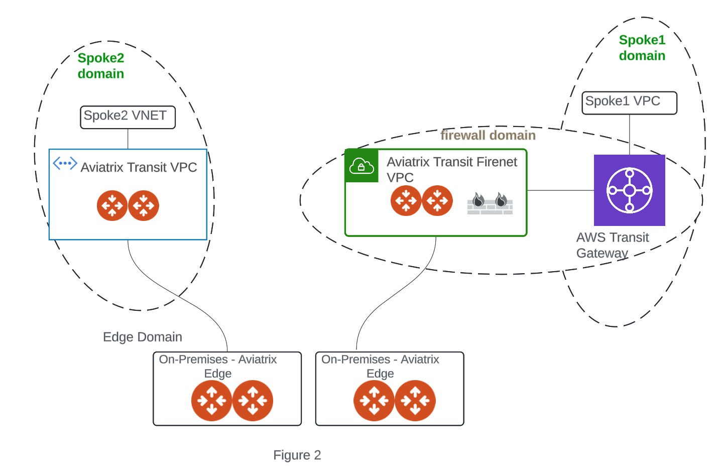

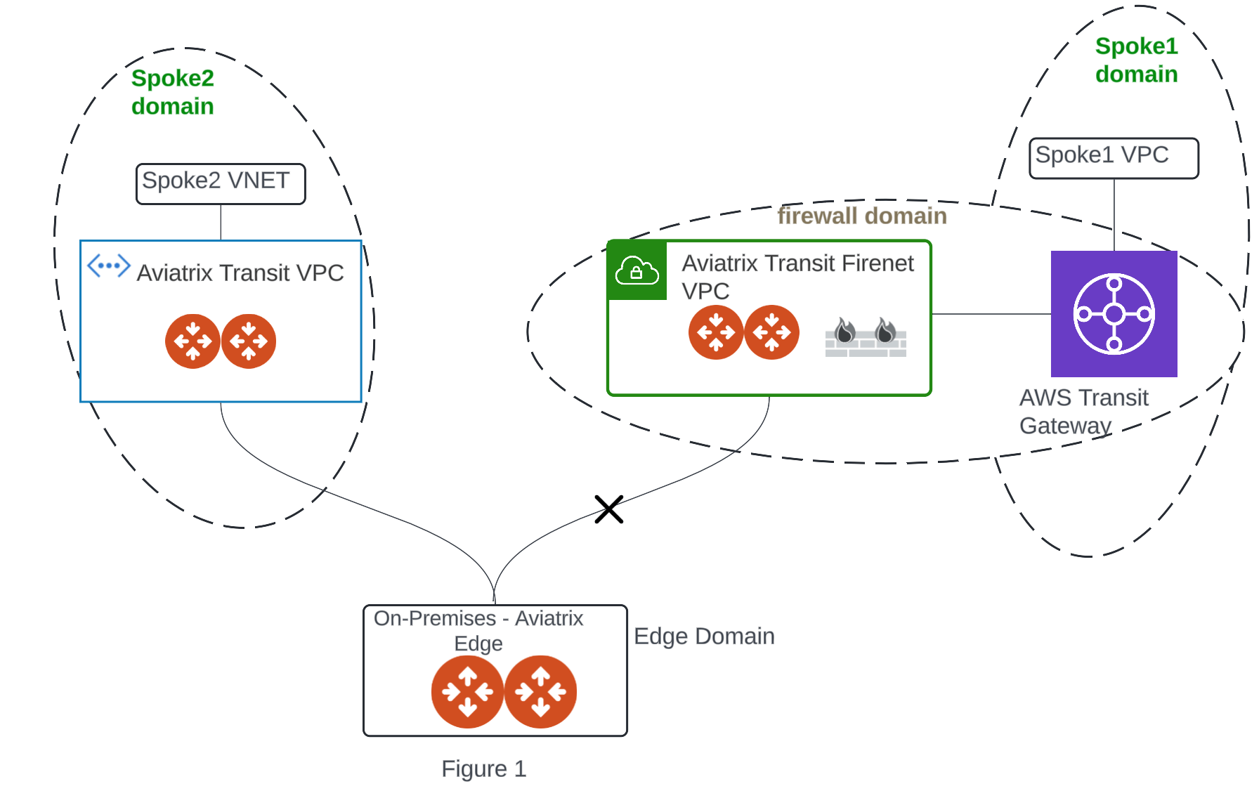

Edge Spoke Gateway to AWS TGW Domain with FireNet Enabled
When FireNet inspection is enabled for an AWS TGW domain, the Aviatrix Edge domain cannot be associated to that domain. Because of a limitation that is attributed to how AWS configures its TGW domains, the on-premises routes from the Edge domain are not installed in the Spoke TGW route table via the Aviatrix Transit Gateway.
