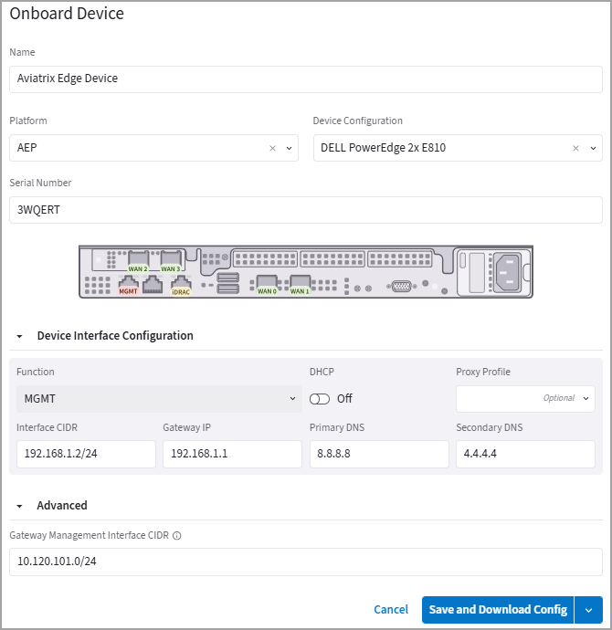

2. Onboard Edge Device onto Aviatrix Edge Platform
  1. In Aviatrix CoPilot, go to Cloud Fabric > Hybrid Cloud > Devices tab.
  2. Click Onboard Device, then provide the following information.
  1. Expand Device Interface Configuration and configure the device’s Function MGMT (Management) interface.
    1. If you plan to use DHCP for the device Management interface, turn DHCP toggle to On.
    2. If you plan to configure a Static IP address for the device Management interface, leave DHCP toggle to Off.
    3. If DHCP is Off, enter the Static IP address for the Management interface.
  1. If you are using a proxy server to route internet traffic, from the Proxy Profile dropdown menu, select the proxy profile to upload to the edge device (see Using a Proxy Profile on the Edge Device ).
  2. Under Advanced, specify the Edge Management CIDR that will be used on the Edge gateway interface. If a CIDR is not specified, the system auto assigns 10.100.101.0/24 CIDR range and assigns 10.100.101.2 IP address on the interface.
If the auto assigned CIDR is used, ensure that this range does not overlap with any other network.
  1. Save the configuration.
    • When DHCP is selected for MGMT interface, click Save.
    • When Static IP is selected for MGMT interface, from the Save and Download Config drop-down menu, click Save.

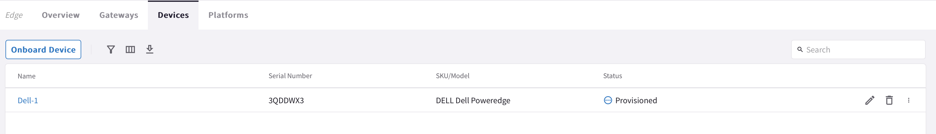

This will download a bootstrap-config.img file (for example, 3QDDWX3-bootstrap-config.img). Your device will show up as Provisioned in Copilot. edge-onboard-device-provisioned.png
  1. If you need to change the management interface’s configurations (from DHCP to Static or vice versa), you can click Edit icon and update the configuration. Save the changes you made to the device.

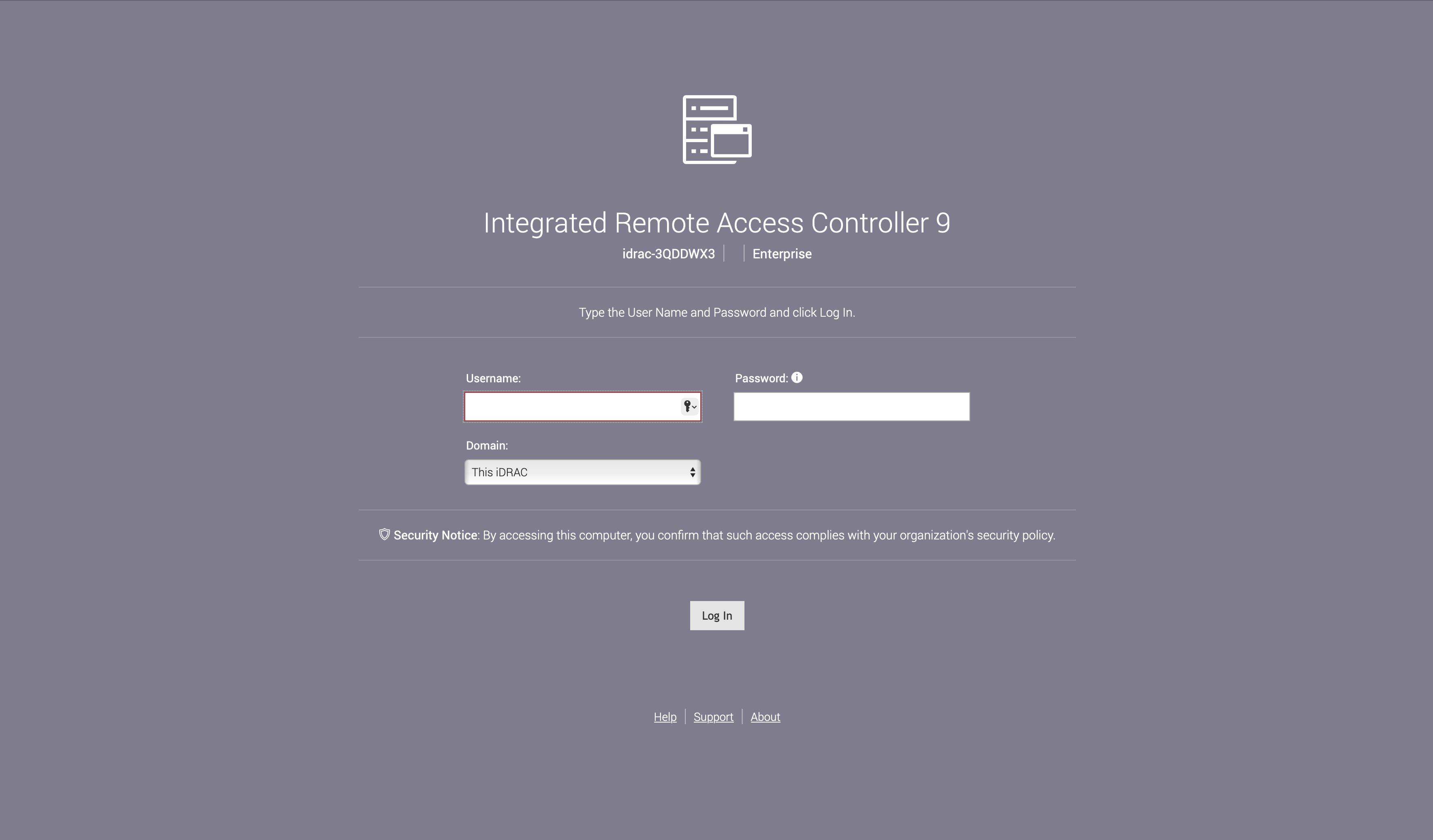

  1. From the jumphost, log in to the Dell server’s iDRAC UI.

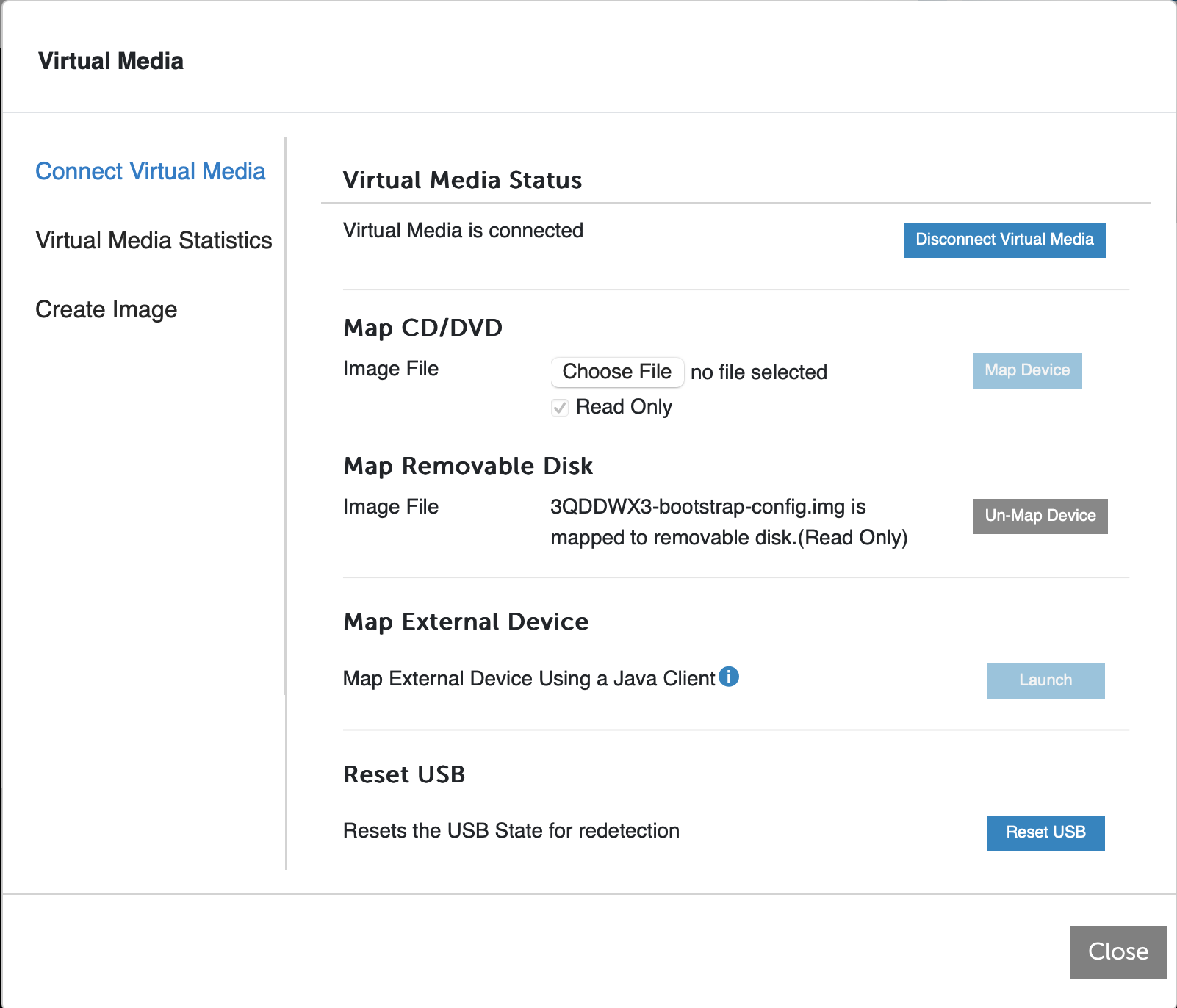

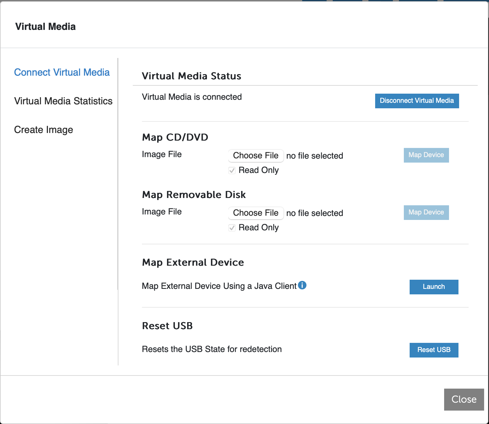

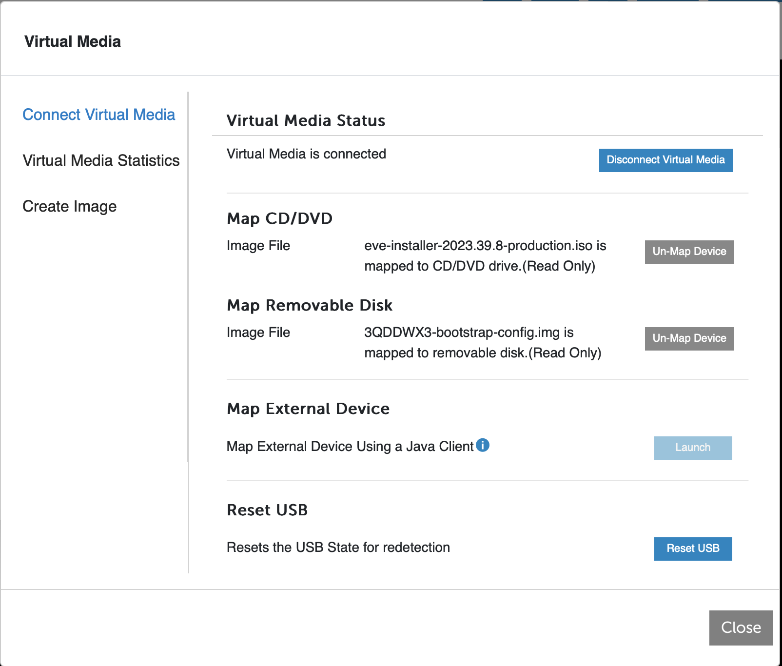

  1. Open the Virtual Console to the server. On the Virtual Console window, click Virtual Media > Connect Virtual Media > Connect Virtual Media. Virtual Media should show up as connected.
  1. Under Map CD/DVD, choose the Edge OS ISO file and click Map Device. Under Map Removable Disk, select the bootstrap-config.img file and again click Map Device. The removable disk is a virtual USB.
If you selected DHCP for the device’s management interface, you do not need to map a file to the removable disk. You only need the Edge OS ISO file.
Your virtual media dialog box should look like this: edge-idrac-virtual-console2.png Close this dialog box.

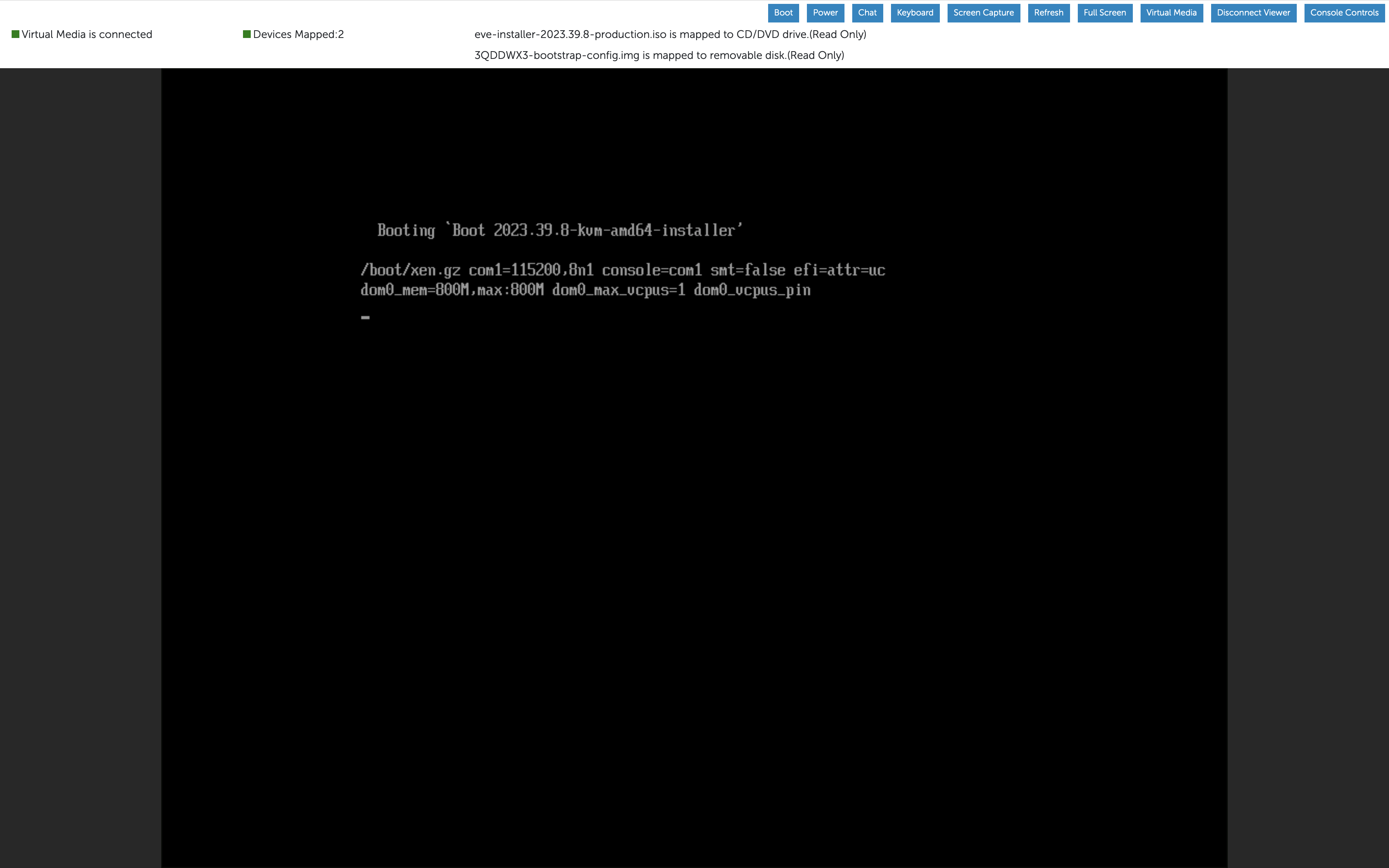

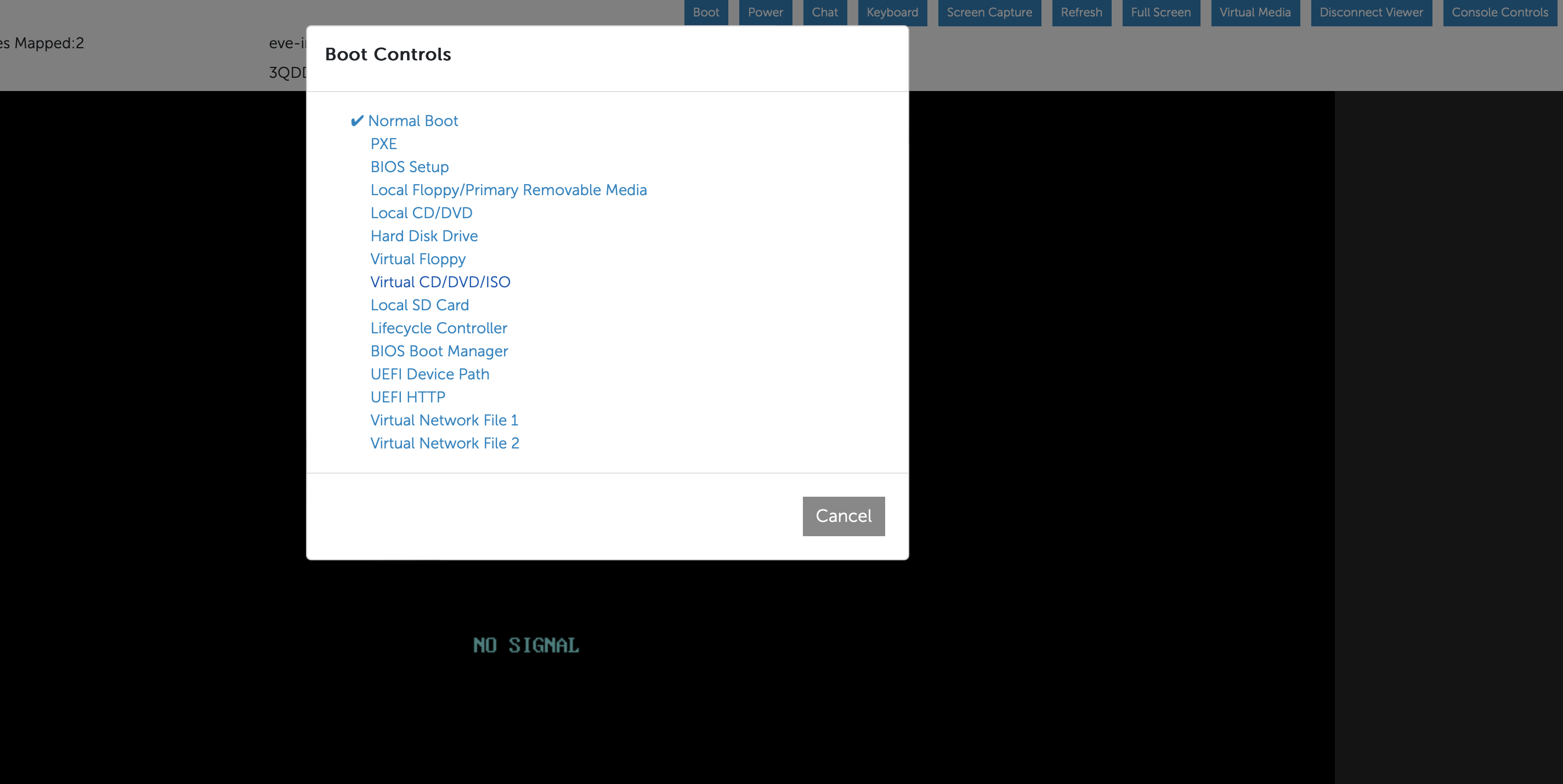

  1. From the Virtual Console, click Boot and under Boot Controls, and select Virtual CD/DVD/ISO. A dialog box will open, asking you to confirm the boot action. Click Yes.

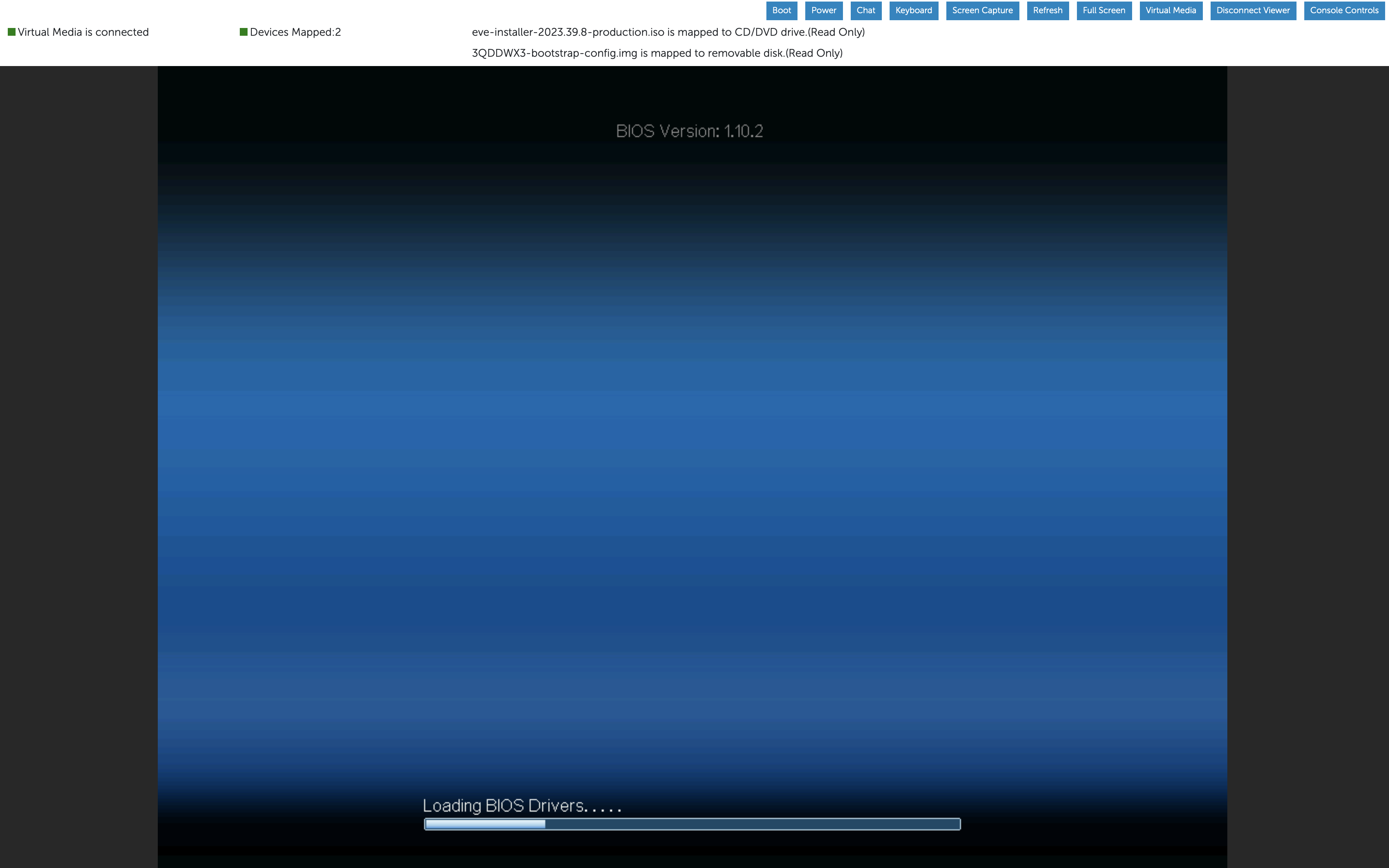

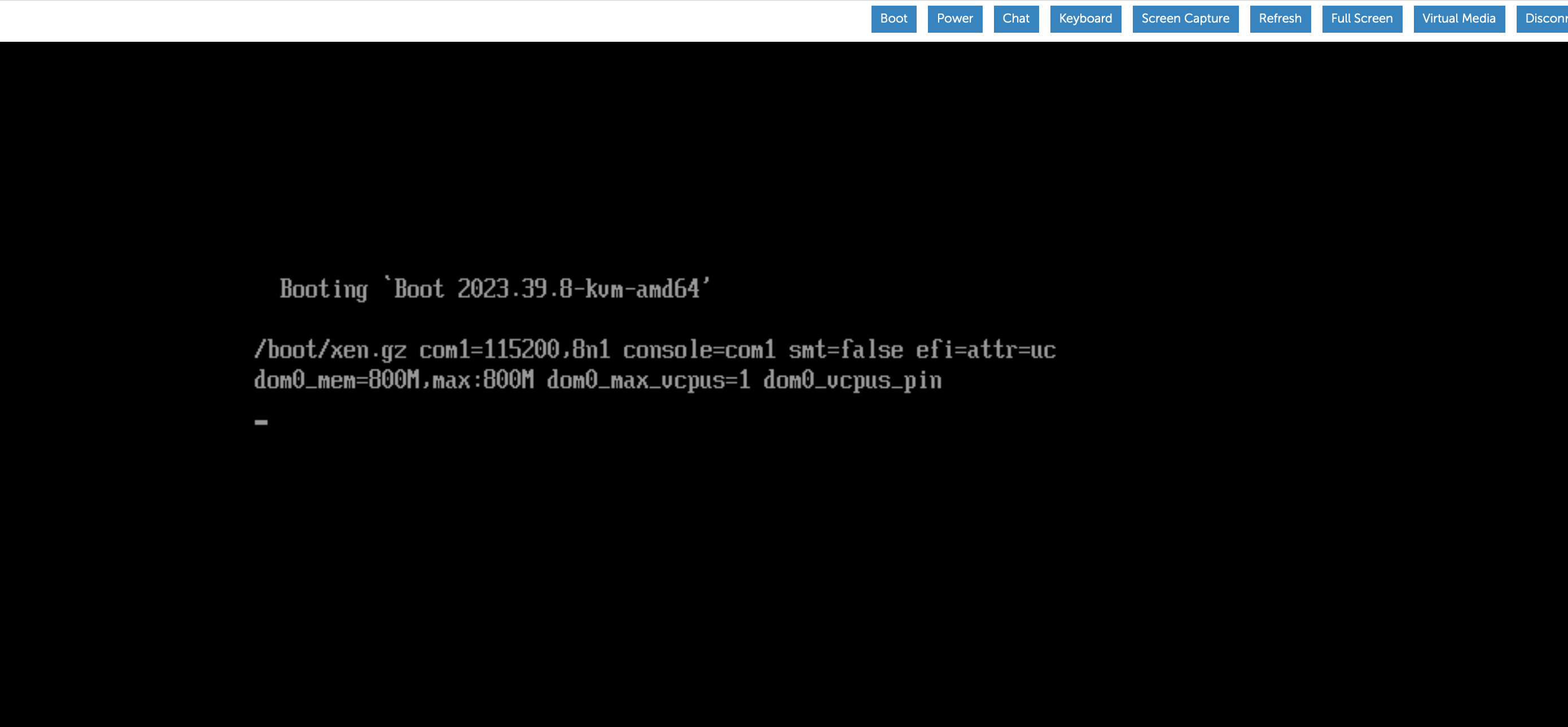

  1. From the Virtual Console, click Power and select the Reset System (warm boot) option. This will start the installation of Aviatrix Edge OS (AEP EvE) on the server.
Do not close the Virtual console window.

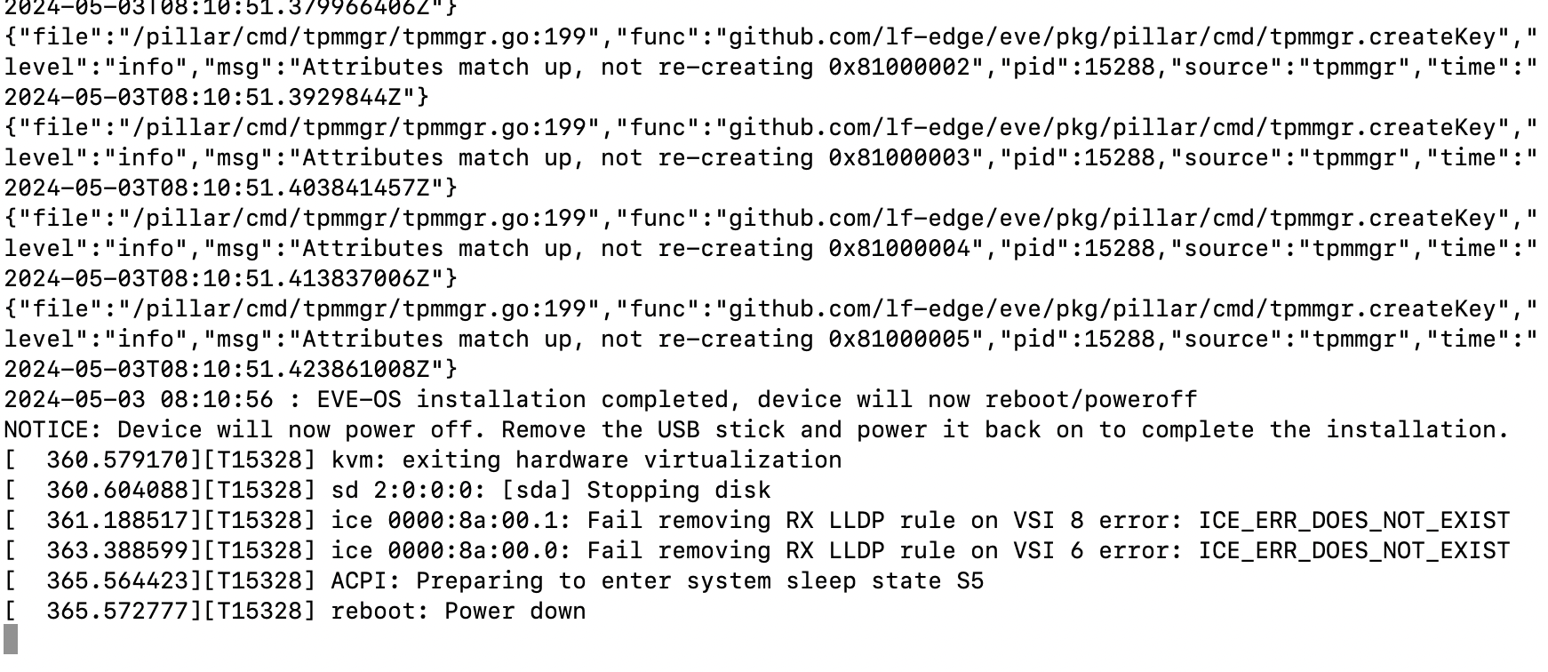

  1. The installation typically takes 10 to 15 minutes. It may vary depending on where the ISO file is being uploaded to the server via the Virtual Console.

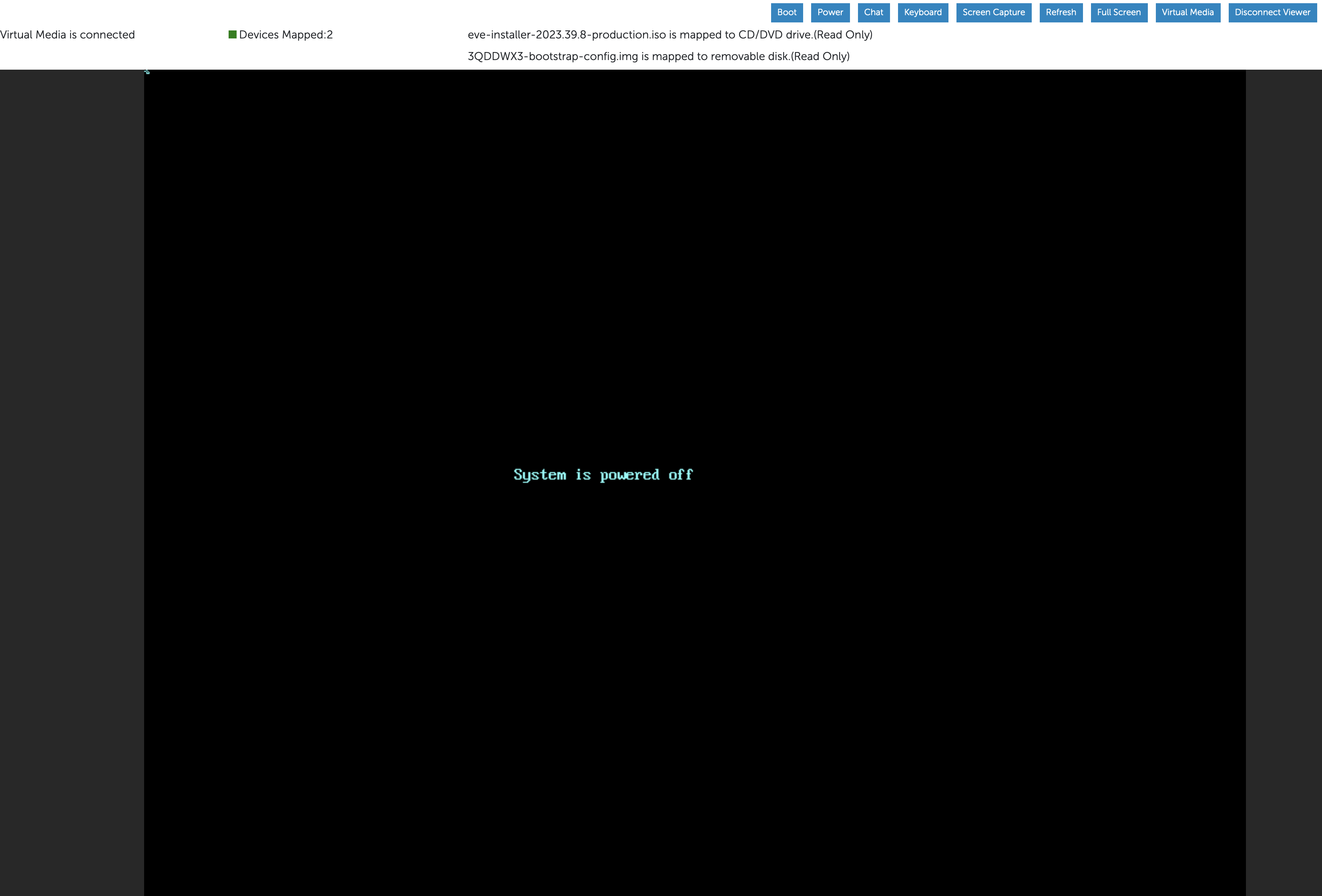

Once the installation is complete, the server will automatically power down. This can also be confirmed from the EvE installation logs in the serial console. edge-idrac-install-log2.png edge-idrac-power-off.png
  1. From the Virtual Console, go to Virtual Media and under Map CD/DVD, click Un-Map Device. Confirm the un-map action by clicking Yes. This will remove the ISO file from the Virtual Console.
If you had mapped a bootstrap-config.img file to the removable disk/virtual USB, keep it as is. The system will configure the server’s management interface with the static IP information in this virtual USB. edge-idrac-virtual-console6.png Click Close to save the changes.

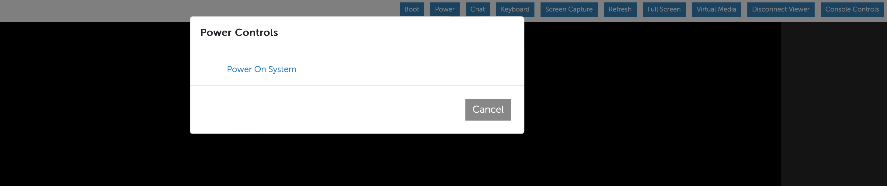

  1. From the Virtual Console, go to Power. You will see only one option this time, Power On System. Confirm the power action by clicking on Yes.

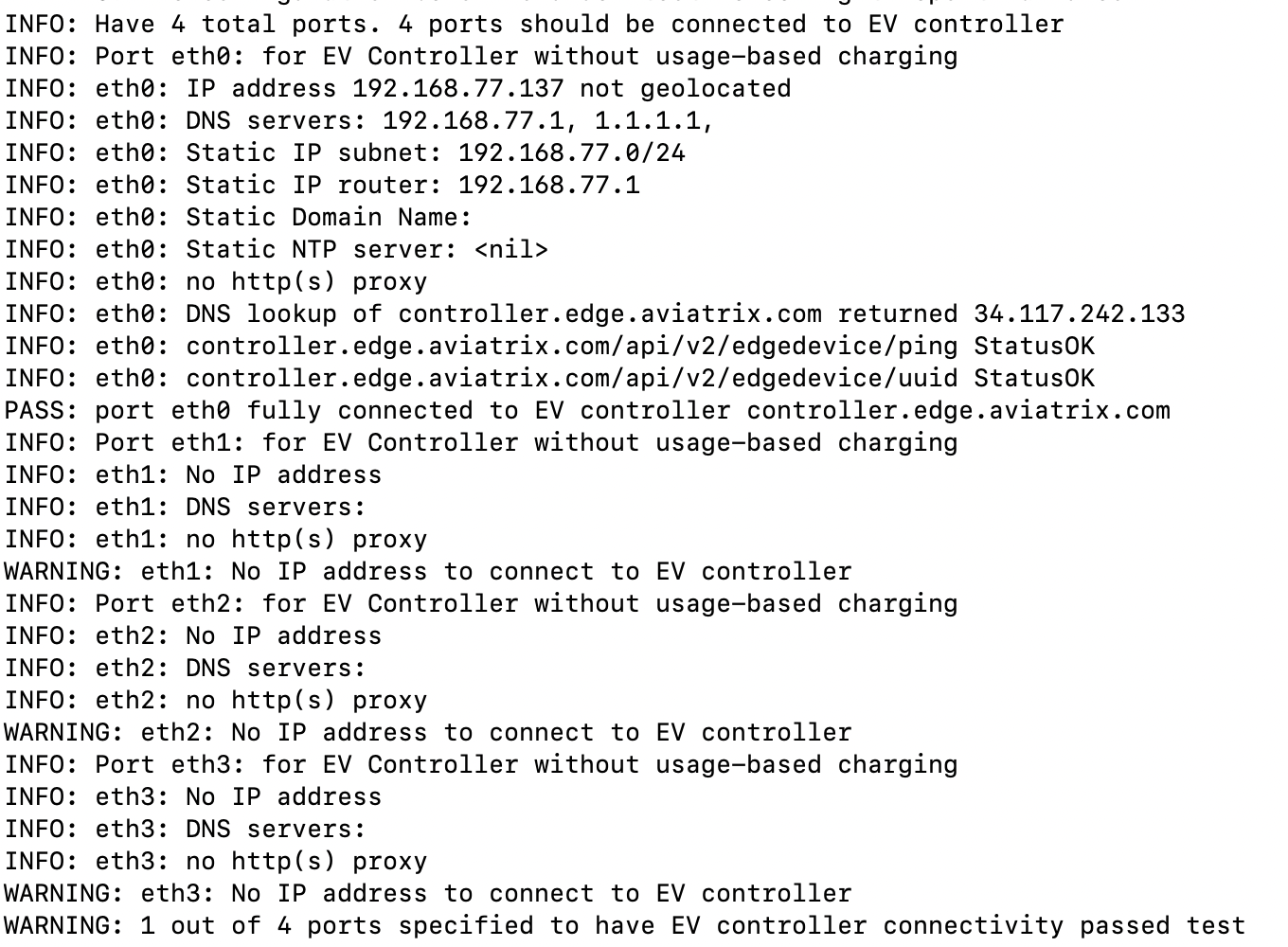

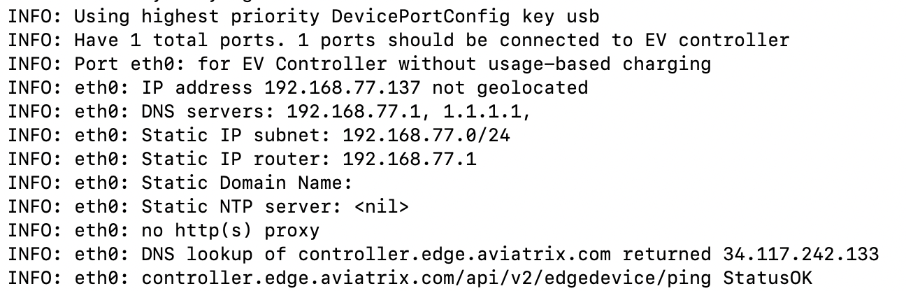

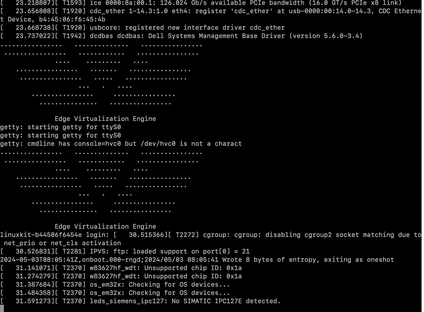

  1. Allow the server to power on. It will boot AEP EvE.
  1. If you have access to the server’s serial console, you will see the boot logs. Aviatrix Edge OS will read the static IP configuration from the virtual USB and configure it on the server. The server will dial out to AEP (controller.edge.aviatrix.com) and connect to it. Look for logs (the actual log text may vary) with these entries: PASS: port eth0 fully connected to EV controller controller.edge.aviatrix.com and 1 out of 4 ports specified to have EV controller connectivity passed test.

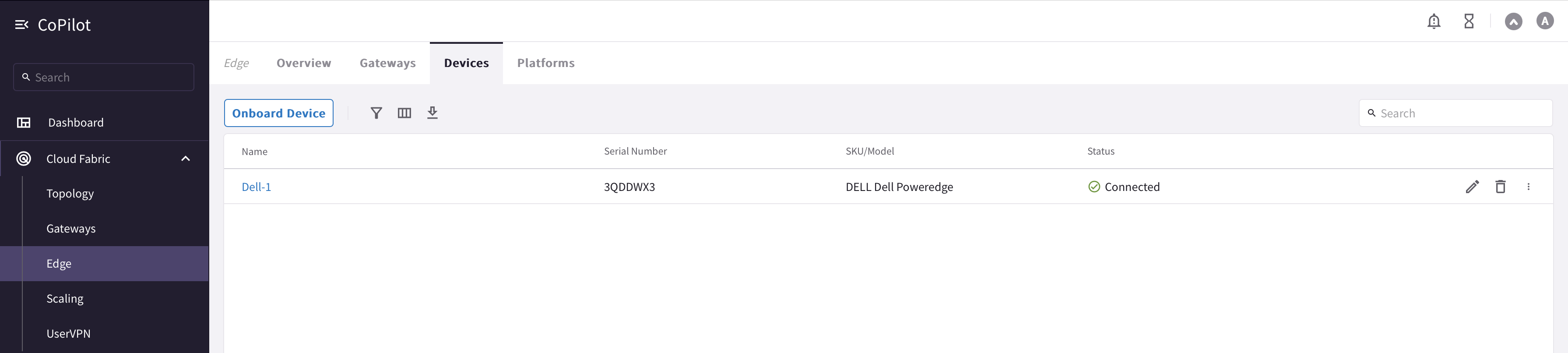

  1. The Dell device will show up as Connected in Copilot (go to Cloud Fabric > Hybrid Cloud > Devices) and can now be used to launch an Edge gateway. For details on how to launch an Edge Transit or Edge Spoke Gateway, see Hybrid Cloud Connectivity.
